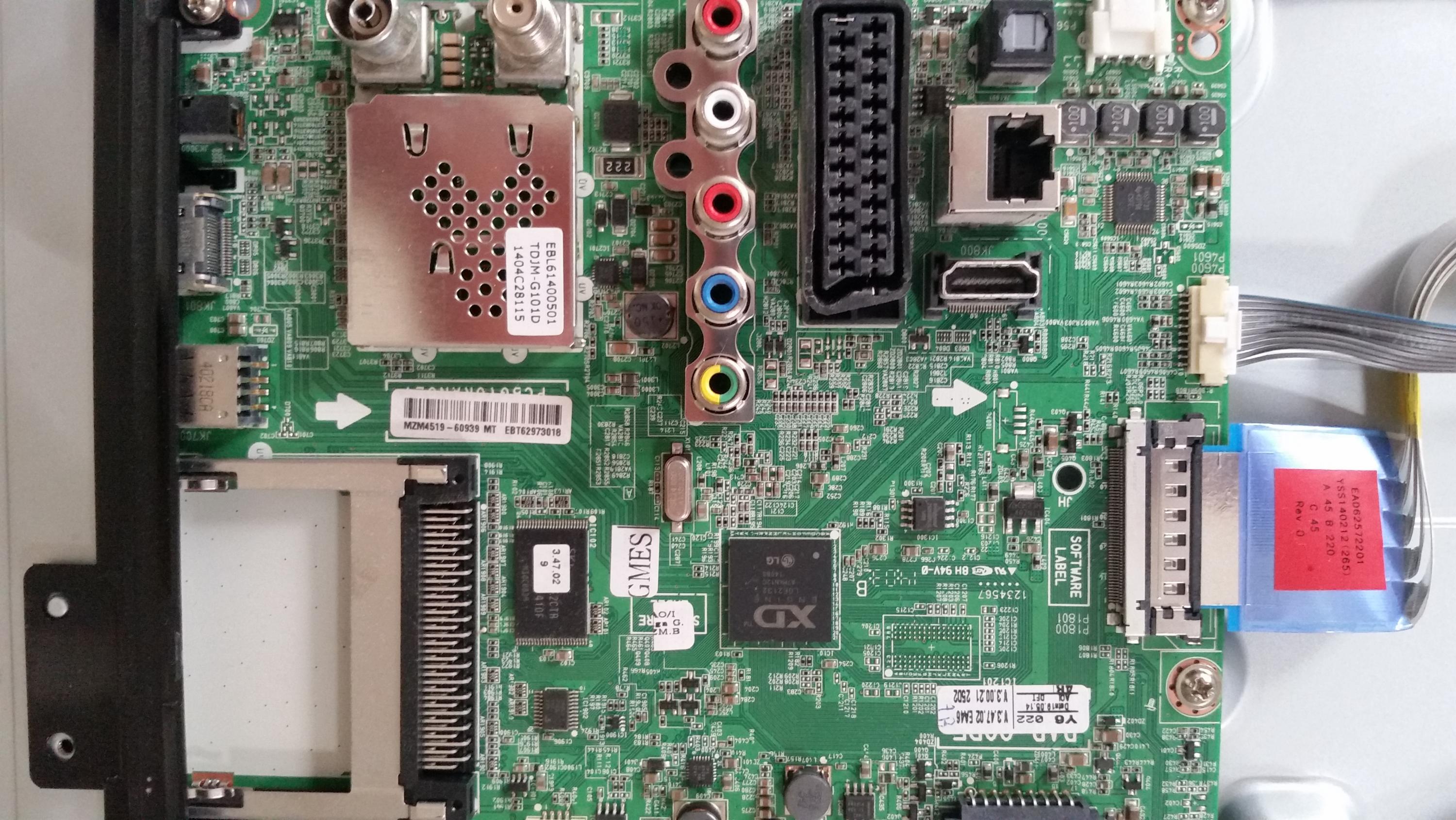

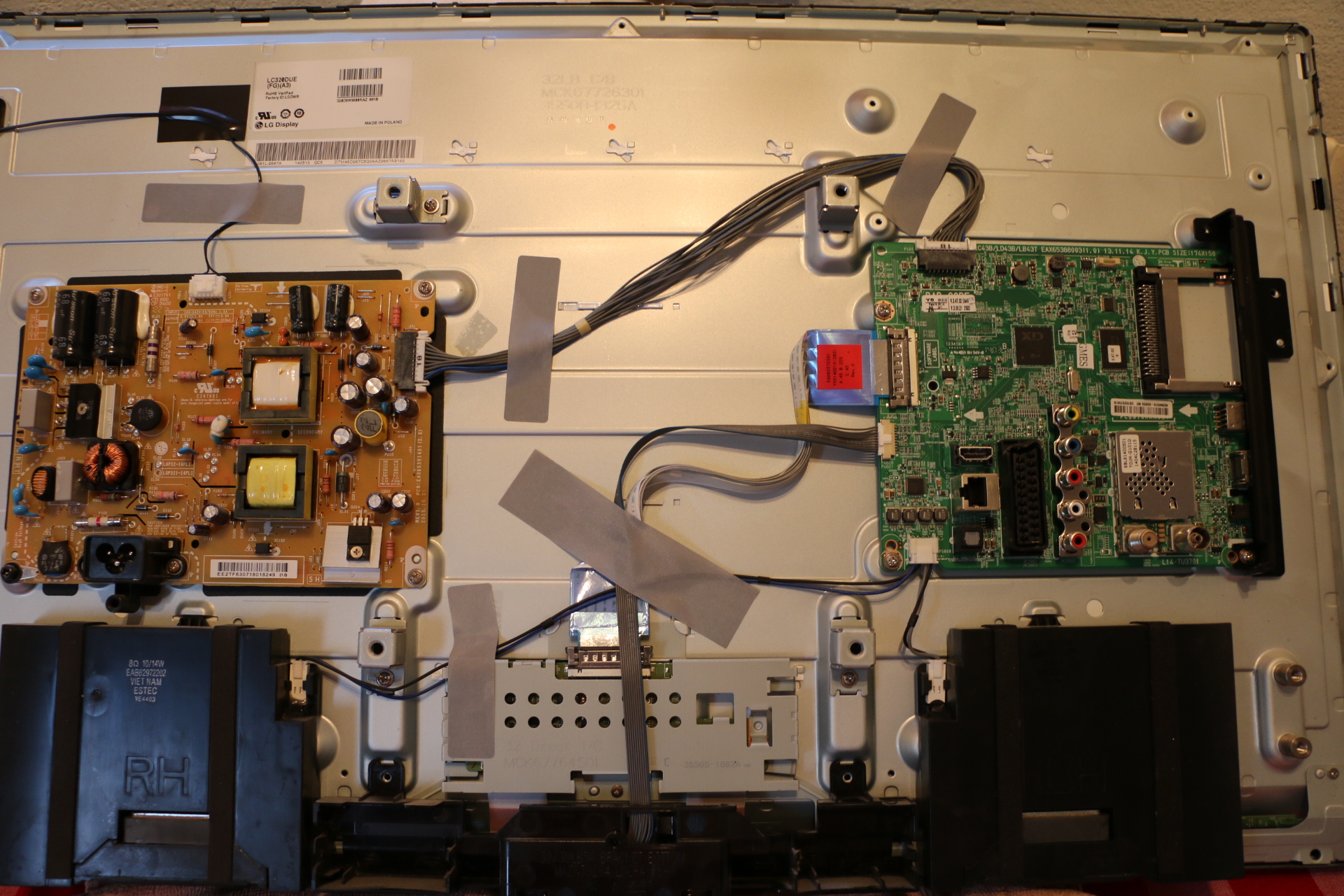

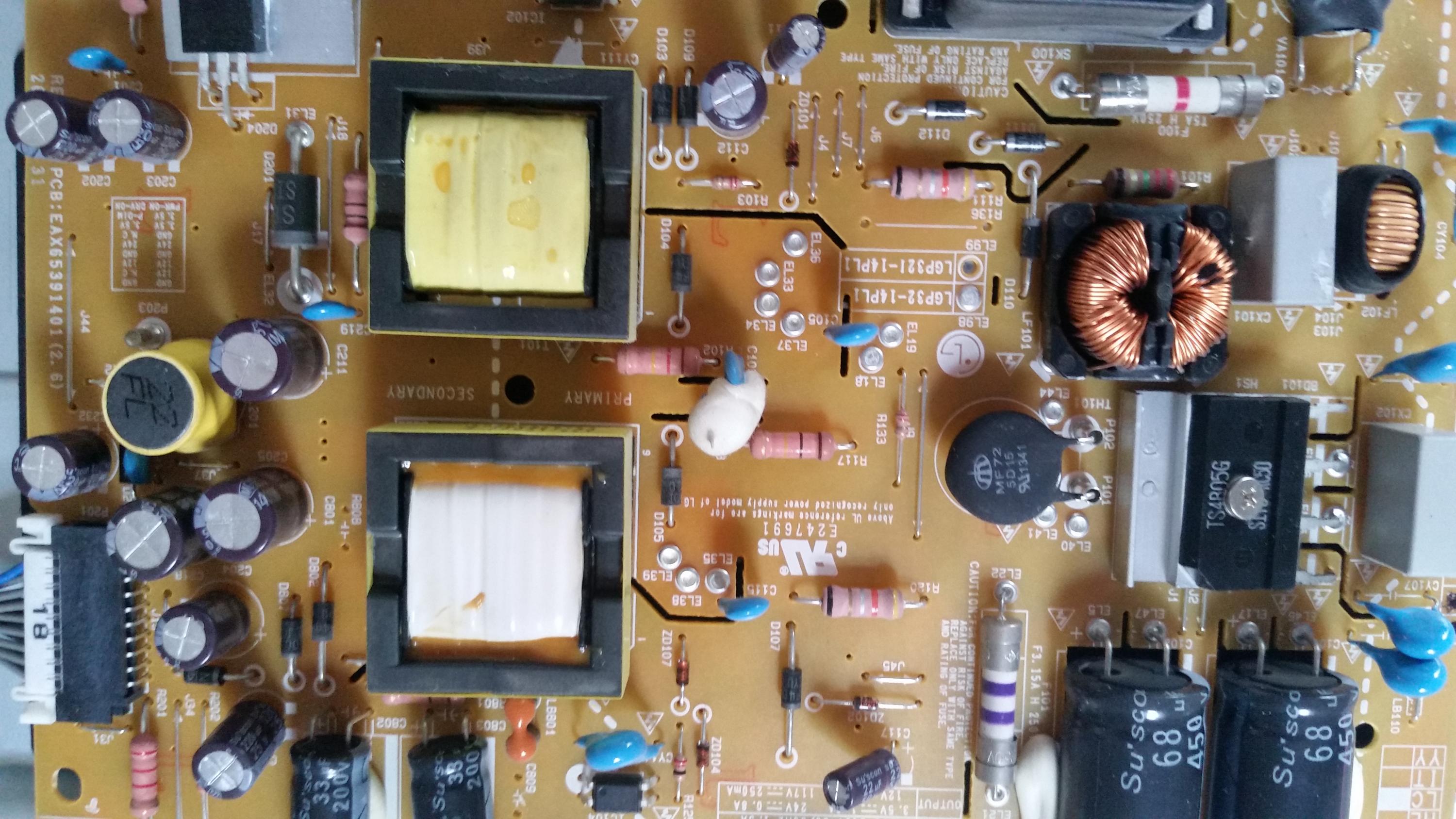

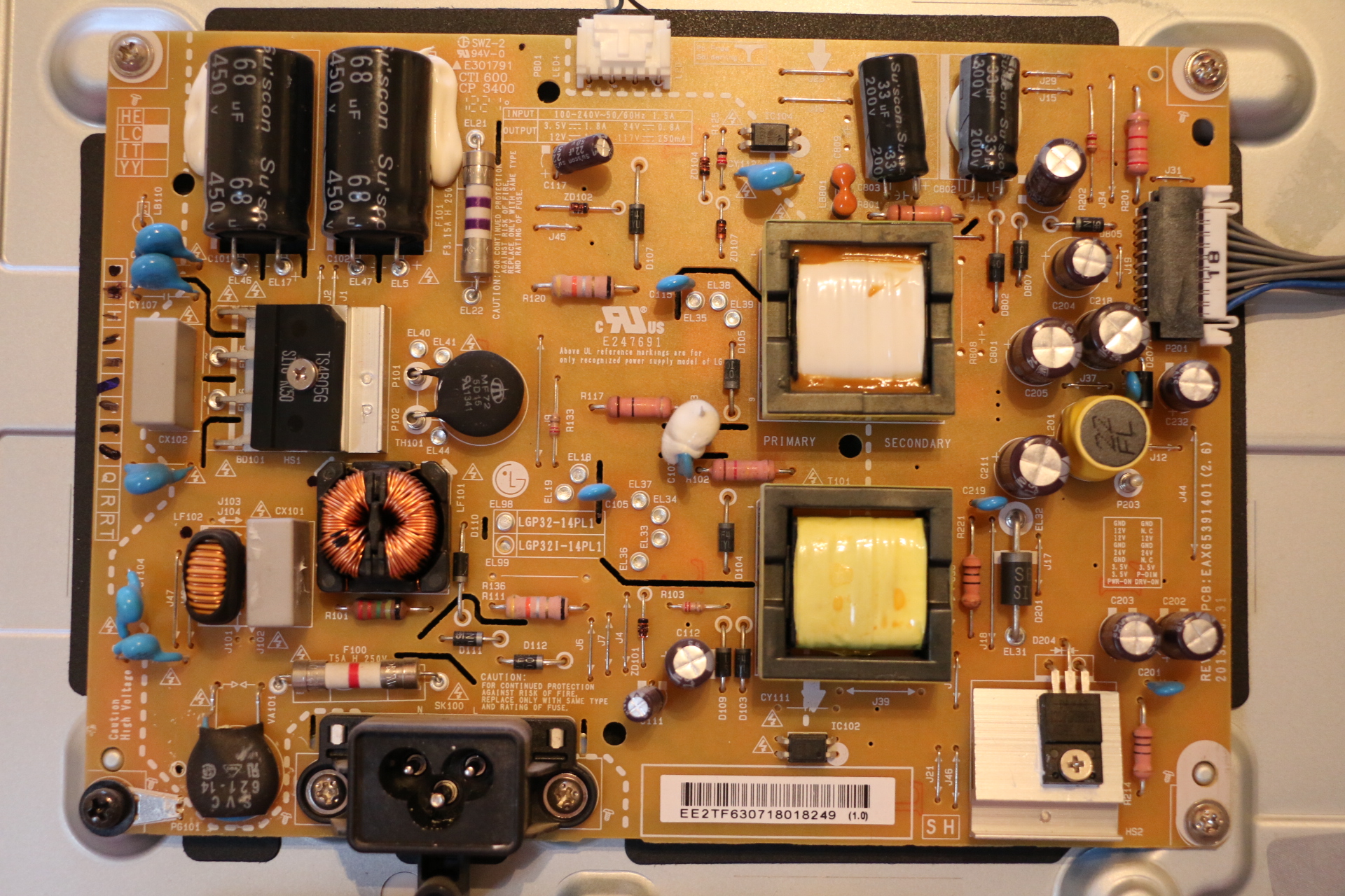

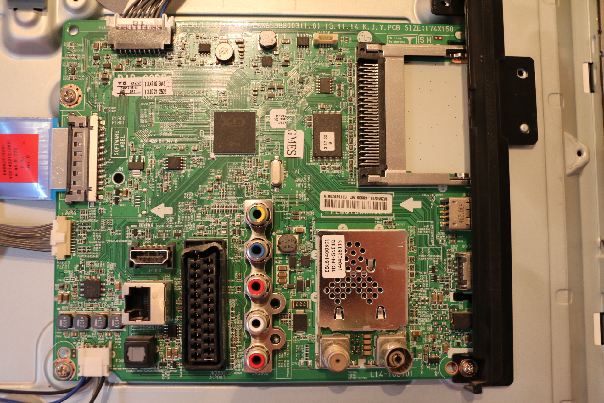

    My mate has asked me to look at this for him as he has some daft notion that I actually know what I'm doing. So to help me impress him I thought I'd turn to you guys
    So the problem is the display is completely black, but the TV is switching channels as you can hear the audio of the different programs.
    Below are pictures of the 2 PCBs inside the set, the T-Con board is covered by a plate, which it seems to be attached to somehow.
    Any help appreciated.
    Re: LG32LB561V Black Screen with sound
    Please show the pictures of the whole backside of the TV so we see all the boards including the T-CON board.
            New set of pictures of PCBs, I can't work out how to get the metal bracket seperated from the T-Con board. Do they solder them to the PCB, there appears to be 2 contact points connecting the metal shield to the PCB.
            A little more info that might help. When the set is powered up, the red standby button comes on, when a channel is selected this slowly flashes red and then goes off. This is with no input connected though as I can't hook it up to anything at the moment.
            Have now added the T-Con board picture
