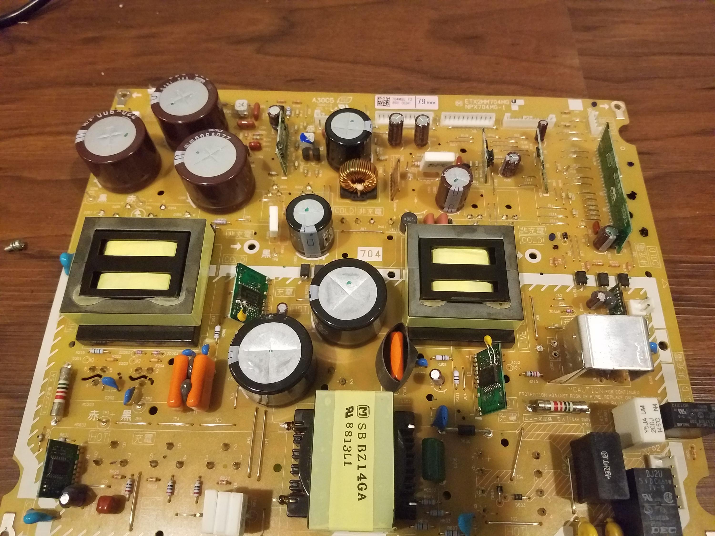

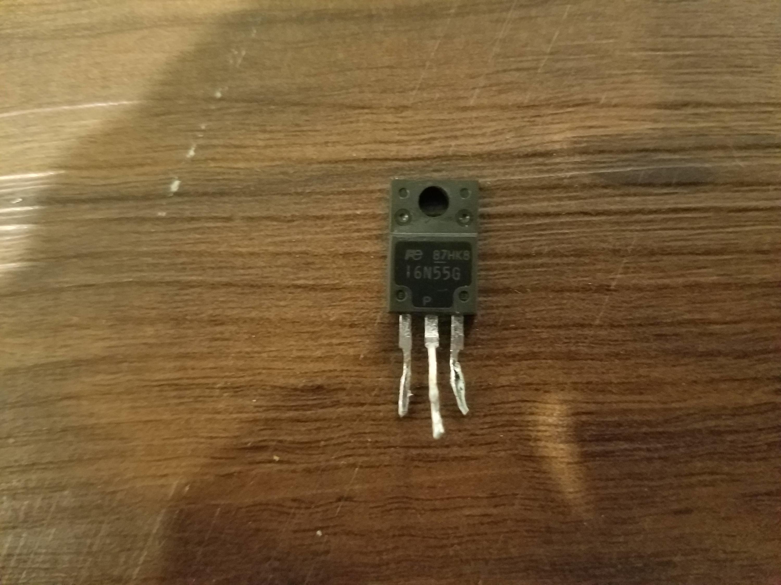

    Sorry if this is in the wrong topic. Im testing a panasonic power supply board with 10 blinks. This is my first time testing circuit boards. I am trying to test the transistors currently. I believe I have an PNP transistor. With my meter in diode mode, I get OL on every pin no matter how i test them. If I switch to Ohms I get a reading only on the middle and right pins. Is this a bad resistor? They are out of circuit. Getting the same readings on three transistors.
    Thank for the help
    Re: Testing transistor on power supply
    Uploading good clear pictures of the whole top and bottom side of the board and the suspect Transistor will help.
    What is this product any way? TV?

        Yes, 2008 50" panasonic TV. I have Youtubed as much as possible but Im not seeing anyone show the same results I am getting. I apologize Im very new to this so I may be overlooking something very obvious.
        I can upload pics if you'd like, Nothing looks burned or obviously bad to me. Only testing these transistors cause a few youtube videos said these can go bad.

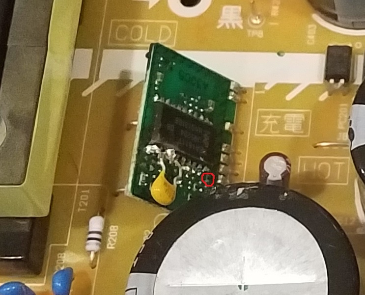

                        Ill go over the solder points again. Also one other possible culprit, There are a few small surface mount resistors, at least i think thats what they are. About the size of an ants head. Very small and on one of the boards i got too close to one and unsoldered it. I attempted to resolder it but was impossible. Then lost the resistor due to the small size. I need to replace this yet i believe but not sure what size or rating i need to get and how to reinstall. Thanks, again!

                                First off, getting a little side tracked, no one has answered the first question about my transistors im testing. Please advise. Secondly here is a picture with what I believe is a 1K Ohm resistor that i need to resolder to the board. can anyone confirm the identity of this?
                                Thanks for all the help!
                                PS please ignore the solder of the capacitor as i have cleaned that up since taking the photo.
                                  I still do not see the pictures of the Transistor, and how did you figure out it is PNP Transistor? May be it is MOSFET?

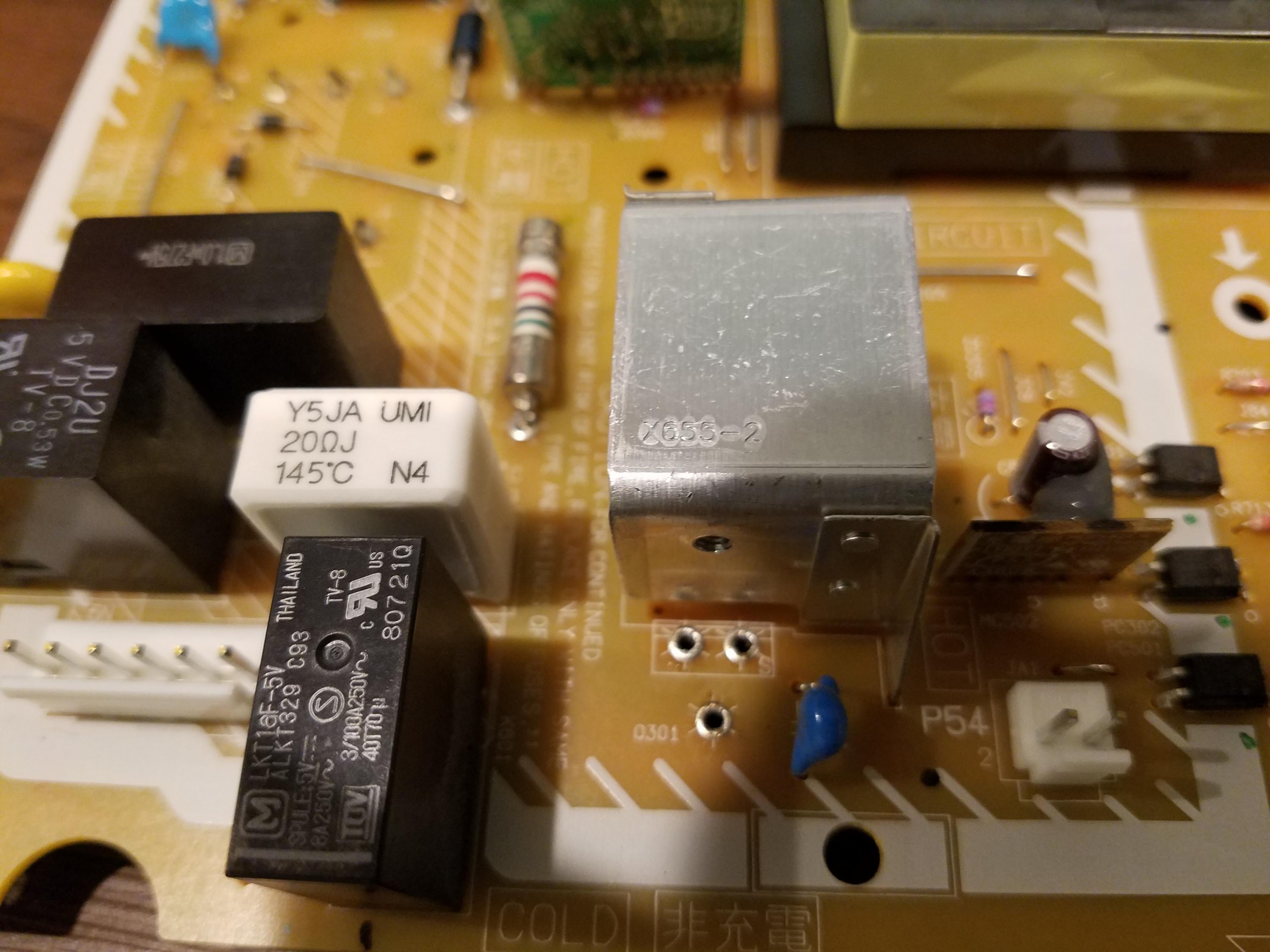

                                      There are two of these mounted to the heat sink in first picture. You can see the three points where it attaches to the board.
                                      Thanks for the help
                                        i think thats a mosfet this video may help you test it correctly
                                        https://www.youtube.com/watch?v=RkWy1EirEu8
