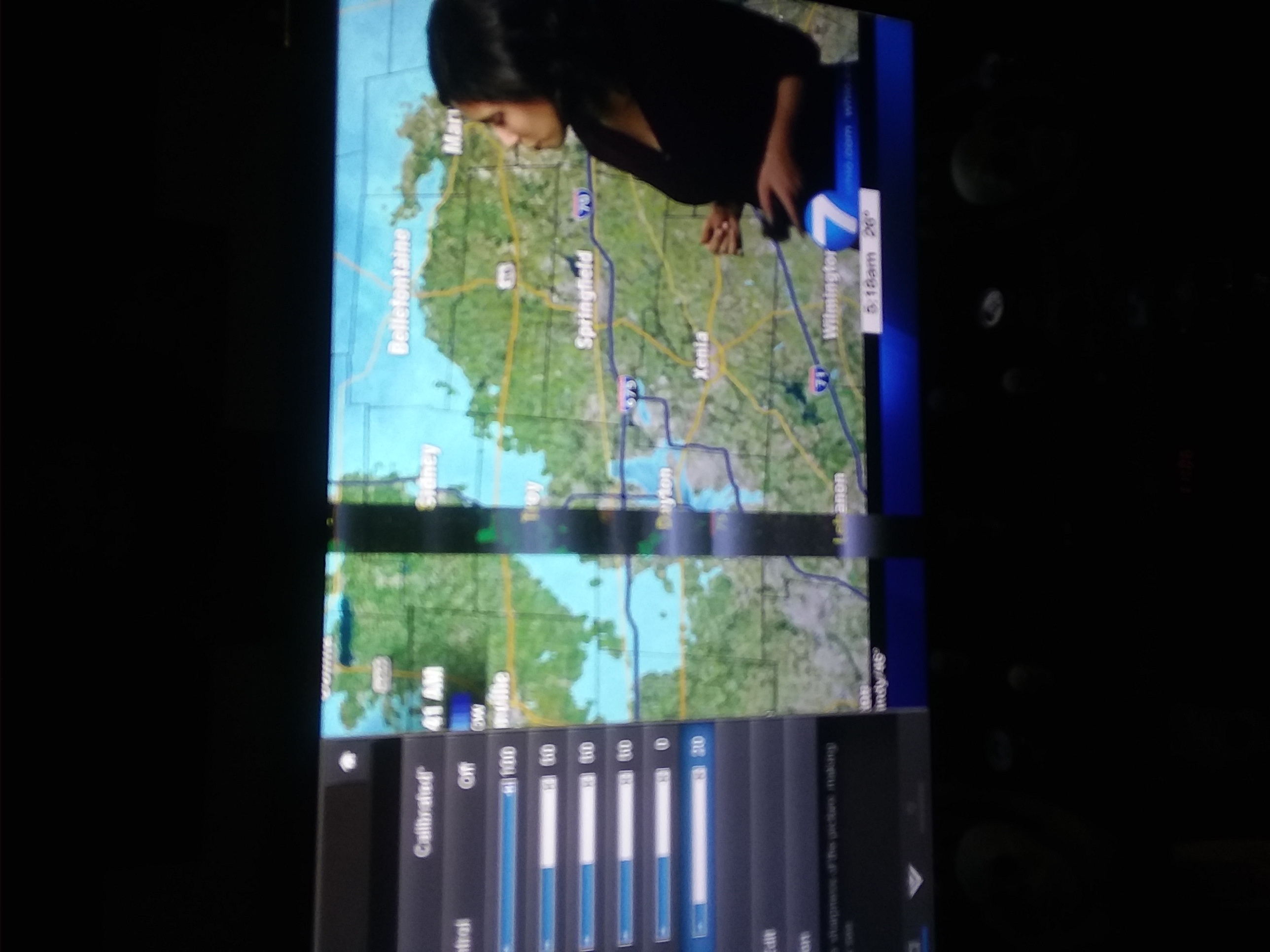

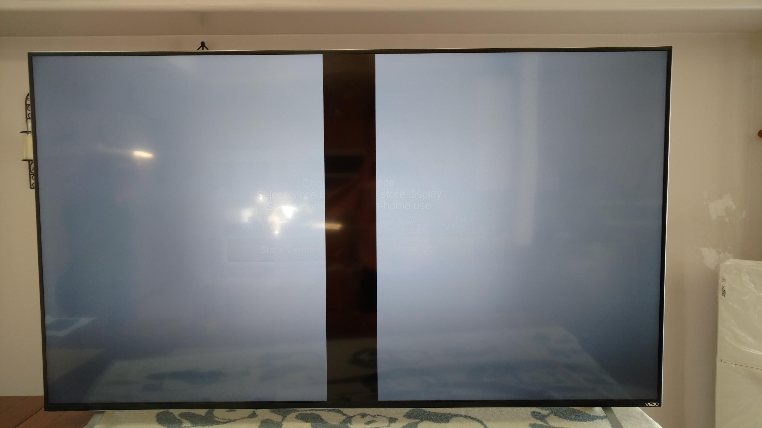

    Quick update...the issue is a 6" wide black line down the center of the TV (vertical). Right and left of the line everything looks fine. Going to take some getting used to with this 4K screen. didn't plug anything in, but did add it to my WIFI and the images from the network look like negatives. Normal?
      Re: Vizio M70-C3
      A pic of the black line attached. A quick scan of the boards and cards and don't see anything disconnected, etc.
      Any ideas where to start?
      Note...hard to see in the pic but there is another vertical line/section the same size right to the left of the solid black one that is flickering (similar to how my laptop screen would show lines and you could press on it to make them go away...pressing doesn't do anything here :-)).

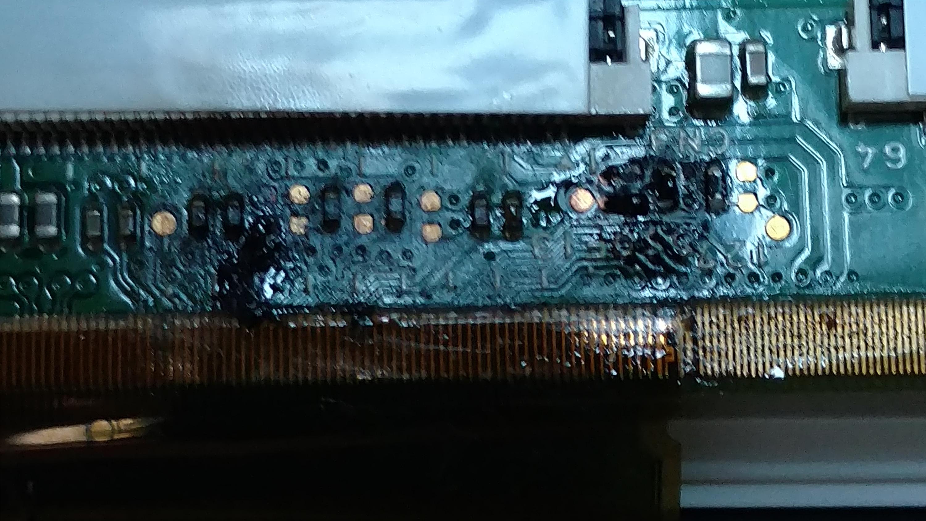

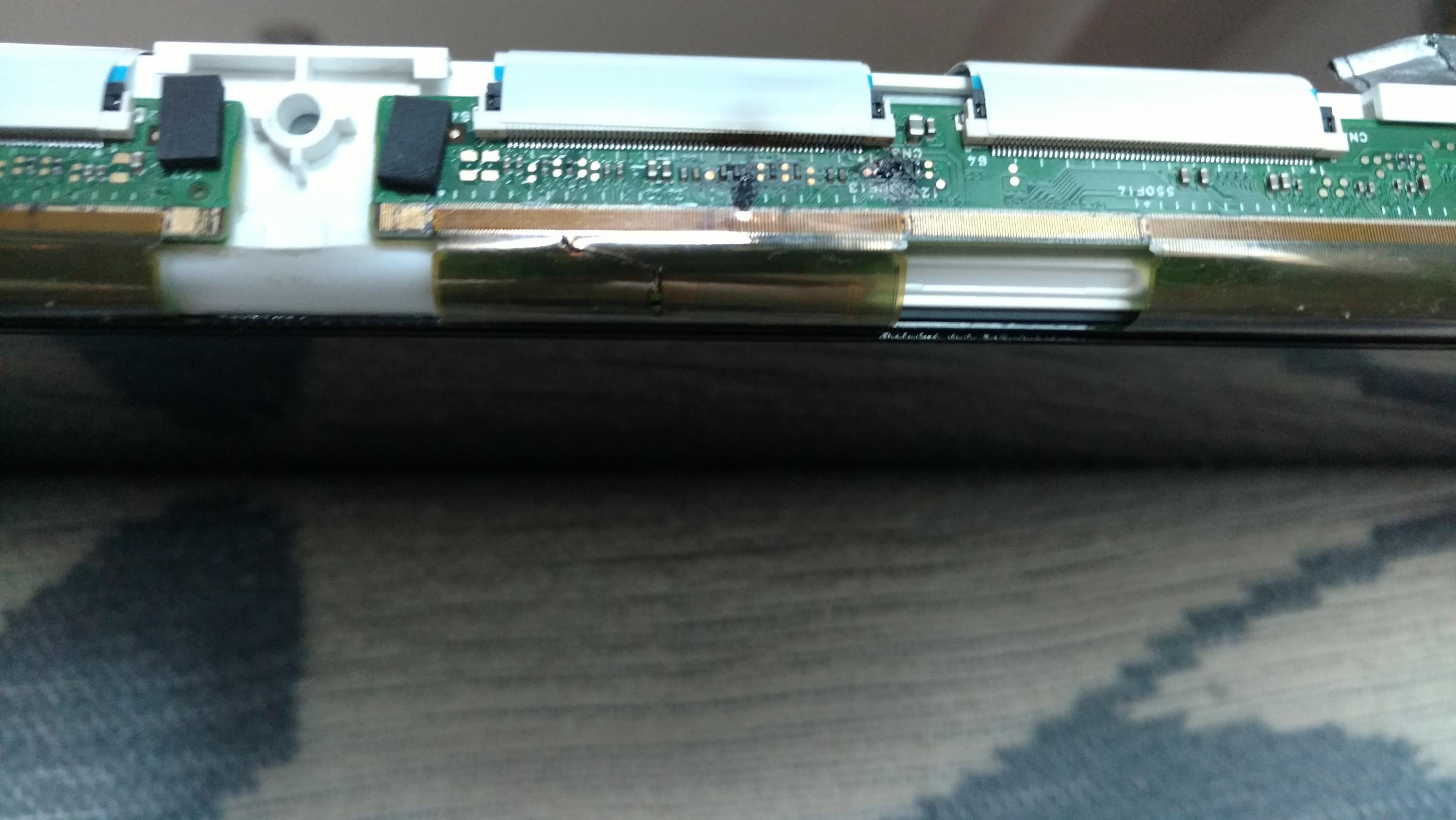

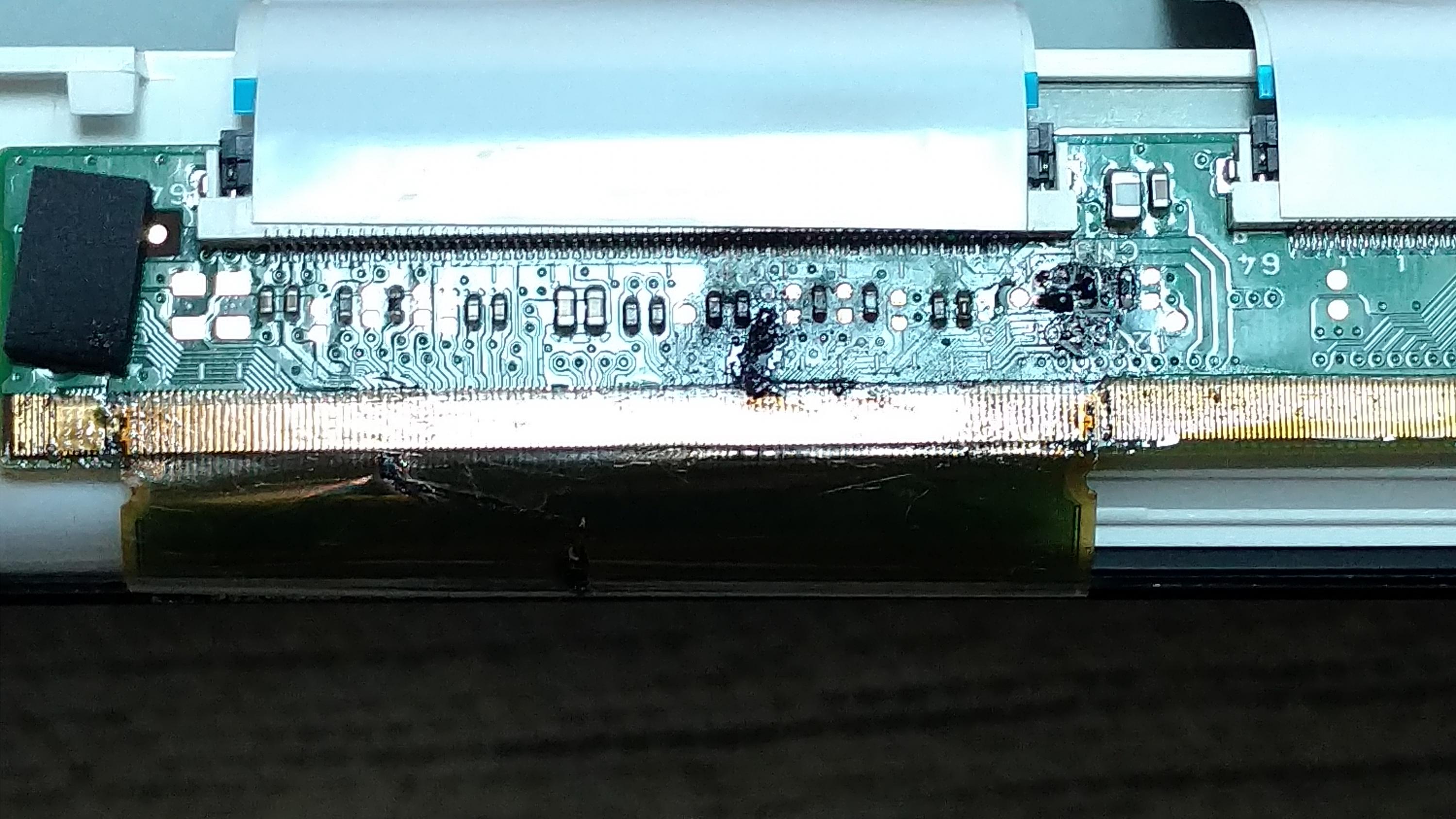

        Found the issue...looking for advice from the experts if it's repairable.
        I had to take the frame off to get to the green circuit boards that I assume power LED strips. The cable from the green board to the LED on the black vertical line is cracked. There is some sticky substance on that piece of the board and the one next to it (the vertical line that is intermittent), and it looks kind of burnt. I haven't pulled the panel off, where the cable with the crack leads to. Is the other end similar? How are these connected...it doesn't appear to be soldered, rather glued or ???
        The board in the pics has a number on it, Y1K00735A0013, if it helps.
        Asking for comments/suggestions from those in the know or anyone that has experienced this.
        Can this be saved and at what cost?

          Those boards can't be replaced but you can repair by replacing bad components and repairing broken/burnt traces. The cost is effectively nil except what you may lose in hair and sweat by remembering what the set is worth lol.
            Re: Vizio M70-C3

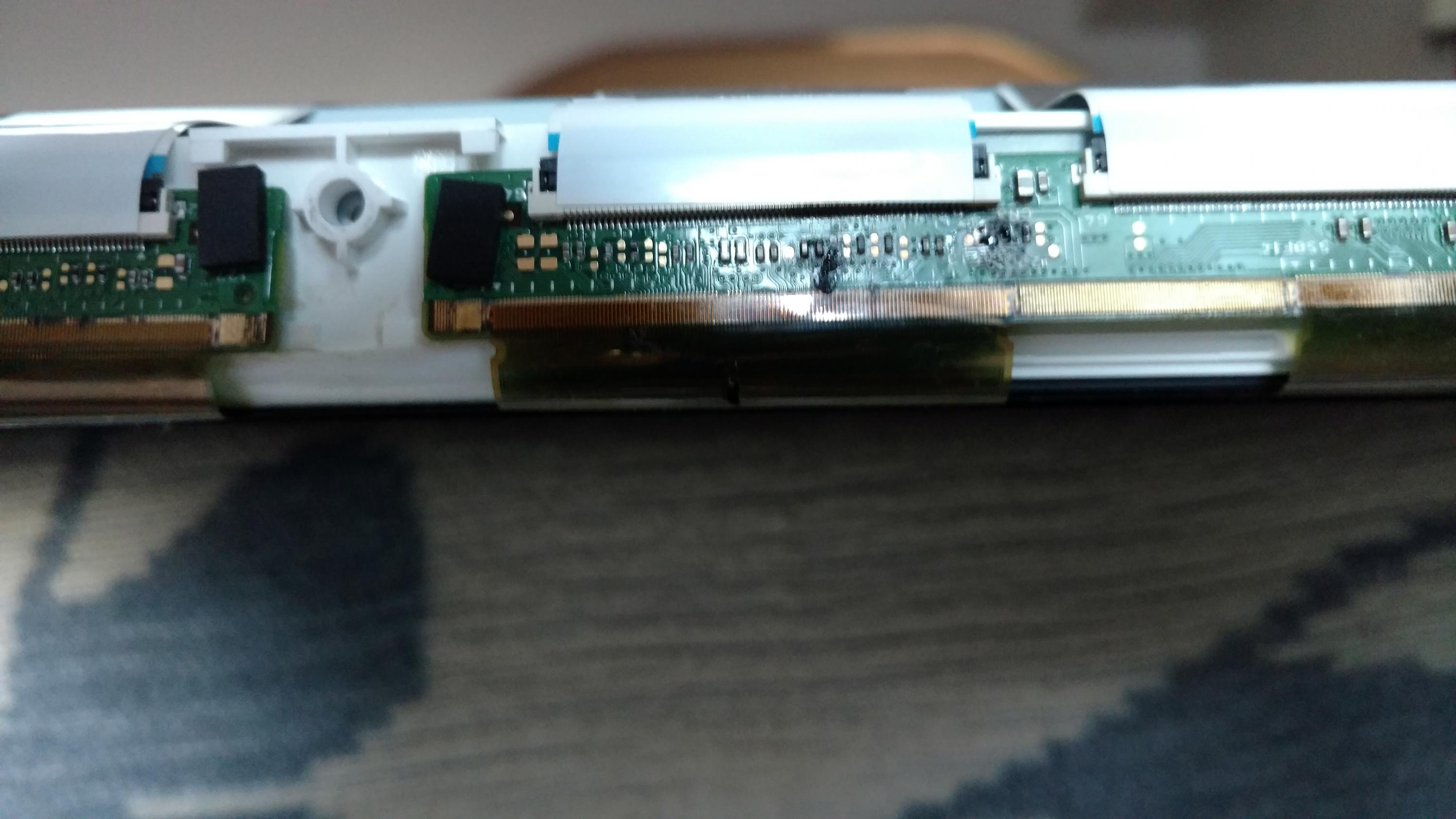

            Be very carefull with those boards and ribbons. Tape them down so they do not move while you work on it. They connect to the LCD panel and you would not be able to repair the joint to the panel if they were damaged.
              Re: Vizio M70-C3
              picture #4 show the ribbon is damage, I see a cut in the ribbon. its cant be repair unless you can replace the ribbon
                Re: Vizio M70-C3

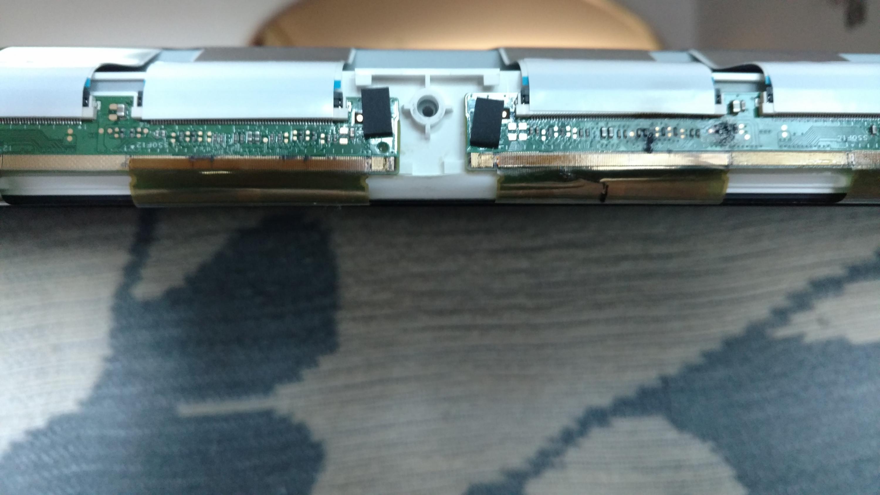

                Yeah...I couldn't see any way to deal with the cut ribbon. To bad they don't make the ends on the LCD end with female adapter where the ribbons could be pulled/replaced.
                After very close inspection, the panel does separate that spans two of those ribbon lengths, where the vertical line are. the crack is about a 1.2 in long across the ribbon and I've never been successful with ribbon issues (had to throw an Asus tablet away for a similar reason (after hacking it to hell). Once a panel starts separating like that is it repairable (meaning can you apply some glue or epoxy and apply very light heat to the parts separating to seal it?
                A 70" screen not cracked but basically unusable...what a shame.
                Don't think I'm going to worry myself and lose any sweat...it does make one think though...a $1500 TV if it were in working condition...(and I'll be thinking about it all day at work today).
                If there are no other ideas I guess this one goes to e-waste.

                  I've successfully tinned the traces on a ribbon with chip quik. Same TV but it was a side tab that was broken. I wasn't able to fix it. Threw it away.

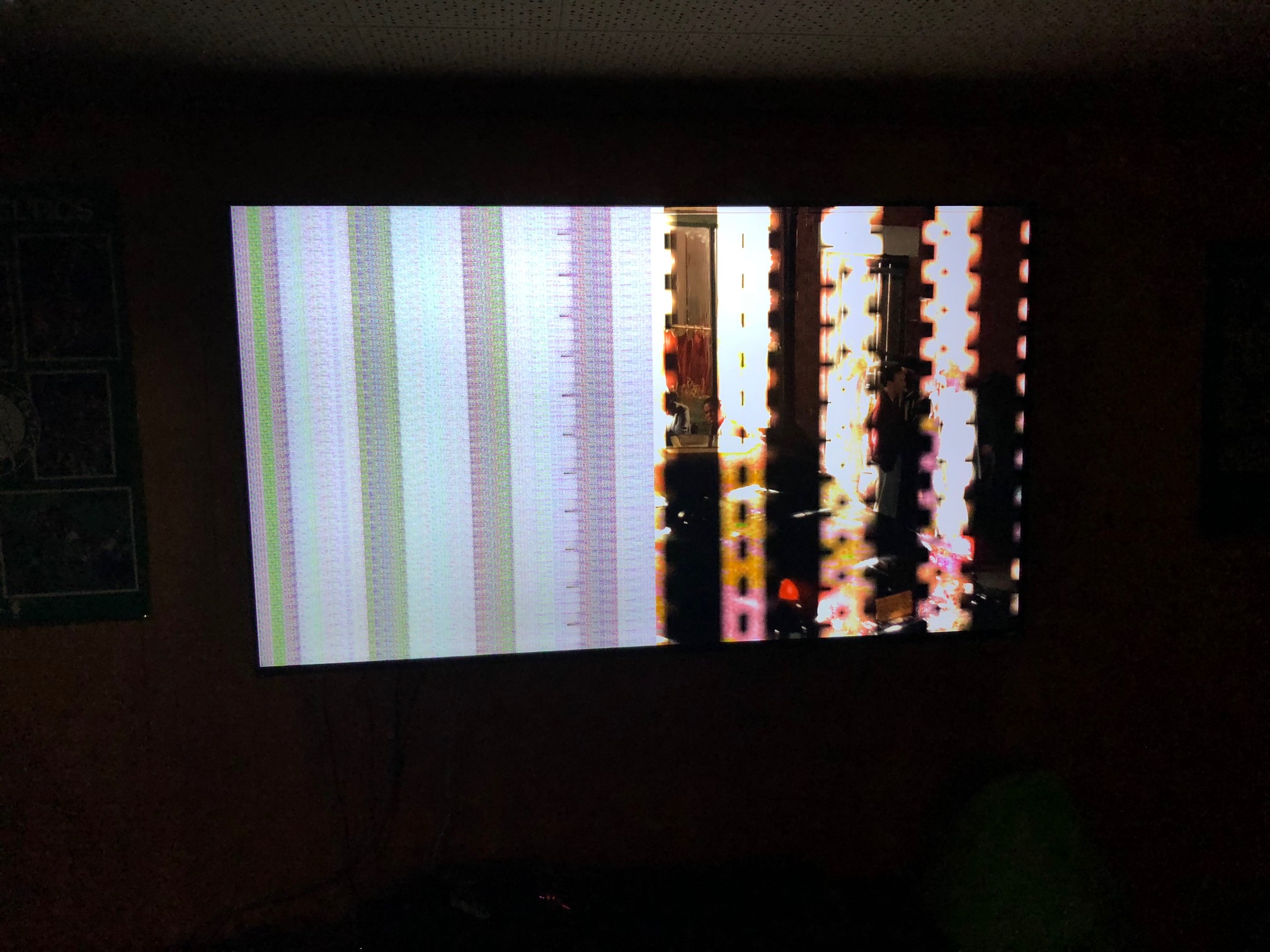

                      i have this problem with my m70-c3 70" vizio as you see goes down middle of picture,, its in front of menu,, can anyone help me here ? or lead me in right direction to fix or get fixed?
                        Re: Vizio M70-C3
                        I have a similar issues going on as well, except the tv will also turn off sporadically I don't know if I need to replace the power board or tcomm
                          Re: Vizio M70-C3
                          Thats a tcon problem. Heat up the ram modules on the board then power up.
