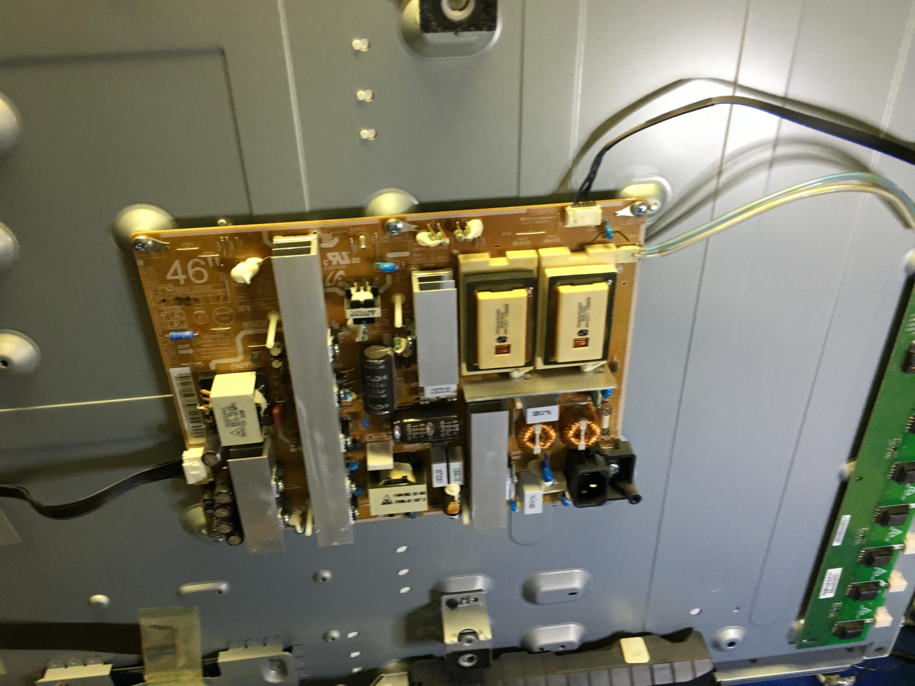

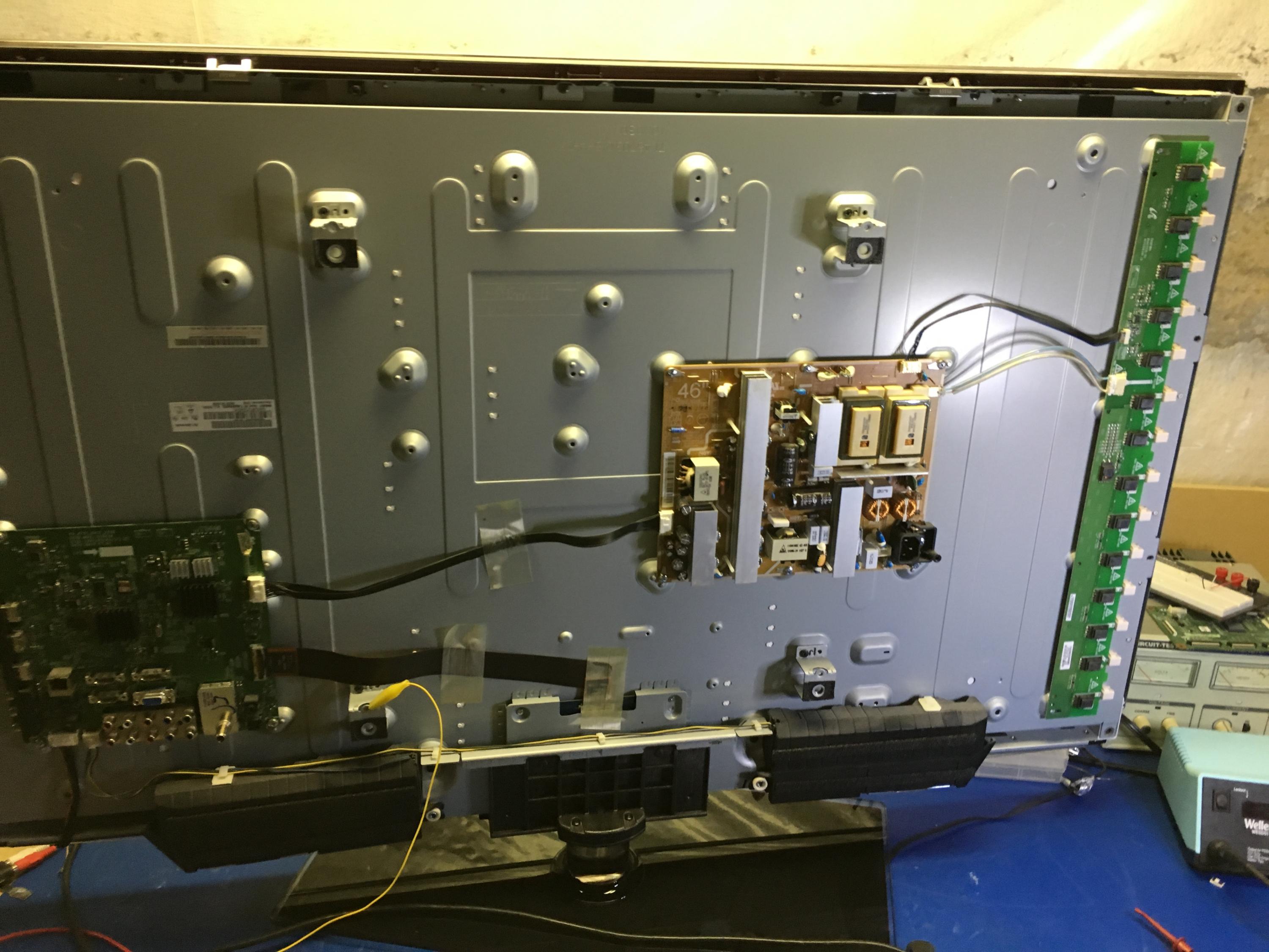

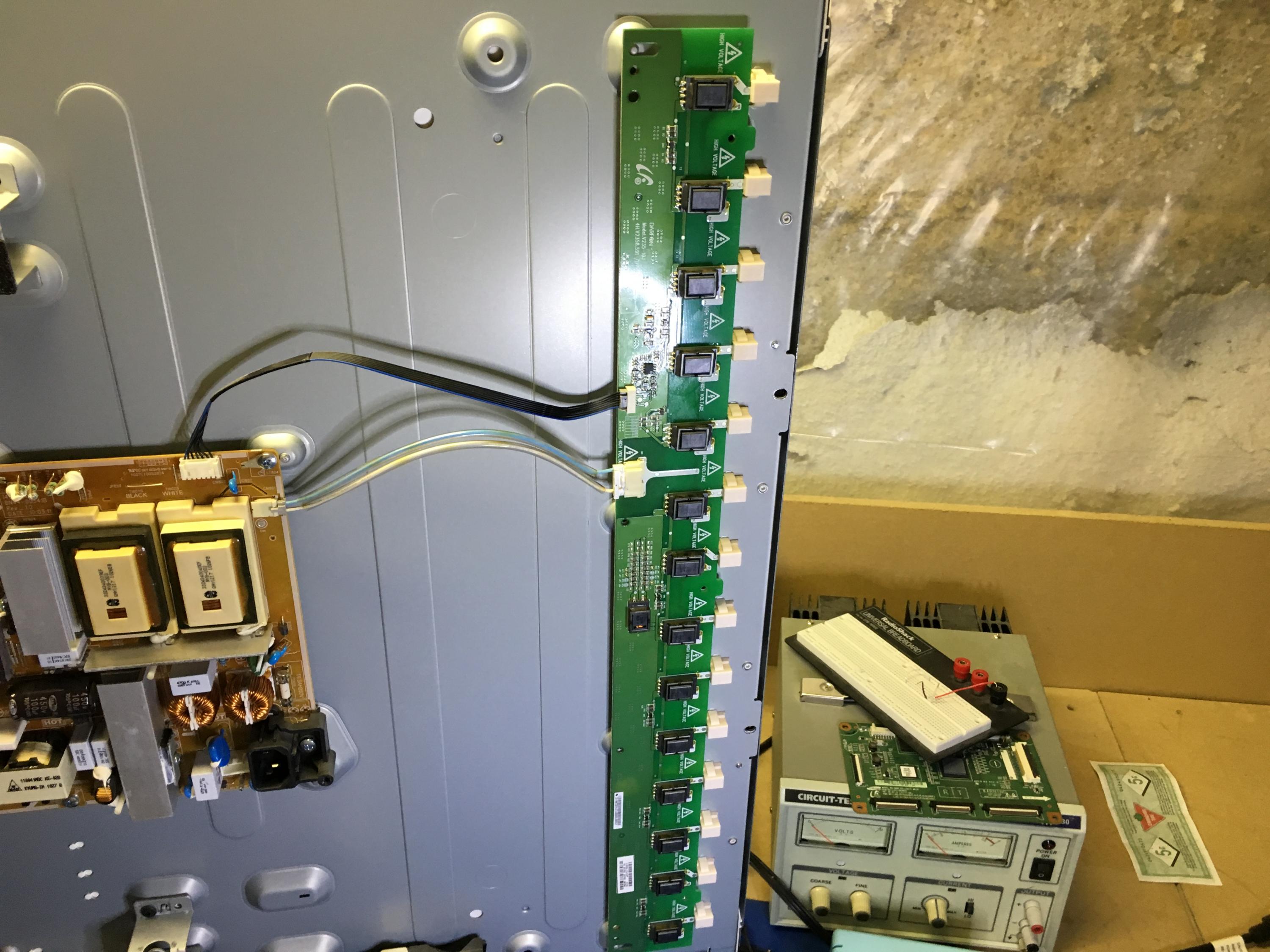

    I can see video if I shine a flashlight on the screen, but I get no backlight. It doesnt even come on for a second. The fast track manual said to remove connector off main board and the BL should turn on as soon as power is applied. I still get nothing. Here are my voltages off connector CNi802 from the backlight inverter board to the power supply, I get the following voltages:
    CN802-
    Pin 1- VCC 12v=12v
    Pin 2-FB=0V
    Pin 3-FB=0V
    Pin 4 and 5 are GND
    Pin 6 and 7 LD=8.84V
    For PW dimming out on CN802 of p/s, I get 2V and H_out=1.66V
    I tested the PFC voltages and I get 388V on filter cap so PFC is good. I am suspecting the 2 large inverter transformers on the PS or the inverter board is bad.

    What is the board P/N BN44-XXXXXX? Samsung BN44-00341B? I suspect bad coupling cap, white rectangular cap CI818 0.47uF 450V POLYPROPYLENE in the middle of the board next to the heatsink for the MOSFETs that drive the inverter transformer. Look real close to see if is has bulge on the body.
    BTW, the fuse on the middle of the board is OK?

      Bn44-00341b and fuse is good. I removed the capacitor and tried measuring the capacitance and get no reading, just OL.

          It will be PANASONIC POLYPROPYLENE type from DIGIKEY with 630V rating instead of the 450V rating.

                  I had a Samsung LN46C630K1FXZA with the same issue. Power on, works normally if you shine a light at the screen, no backlight at all. All electrolytics looked ok. Power supply is the same BN44-00341B. The poly cap was bad, completely open. It even had the little bulge on the side of it. Replaced it with DigiKey P/N: PCF1574-ND - Panasonic / ECW-FA2J474J CAP FILM 0.47UF 5% 630VDC RADIAL and the TV is back to normal.
