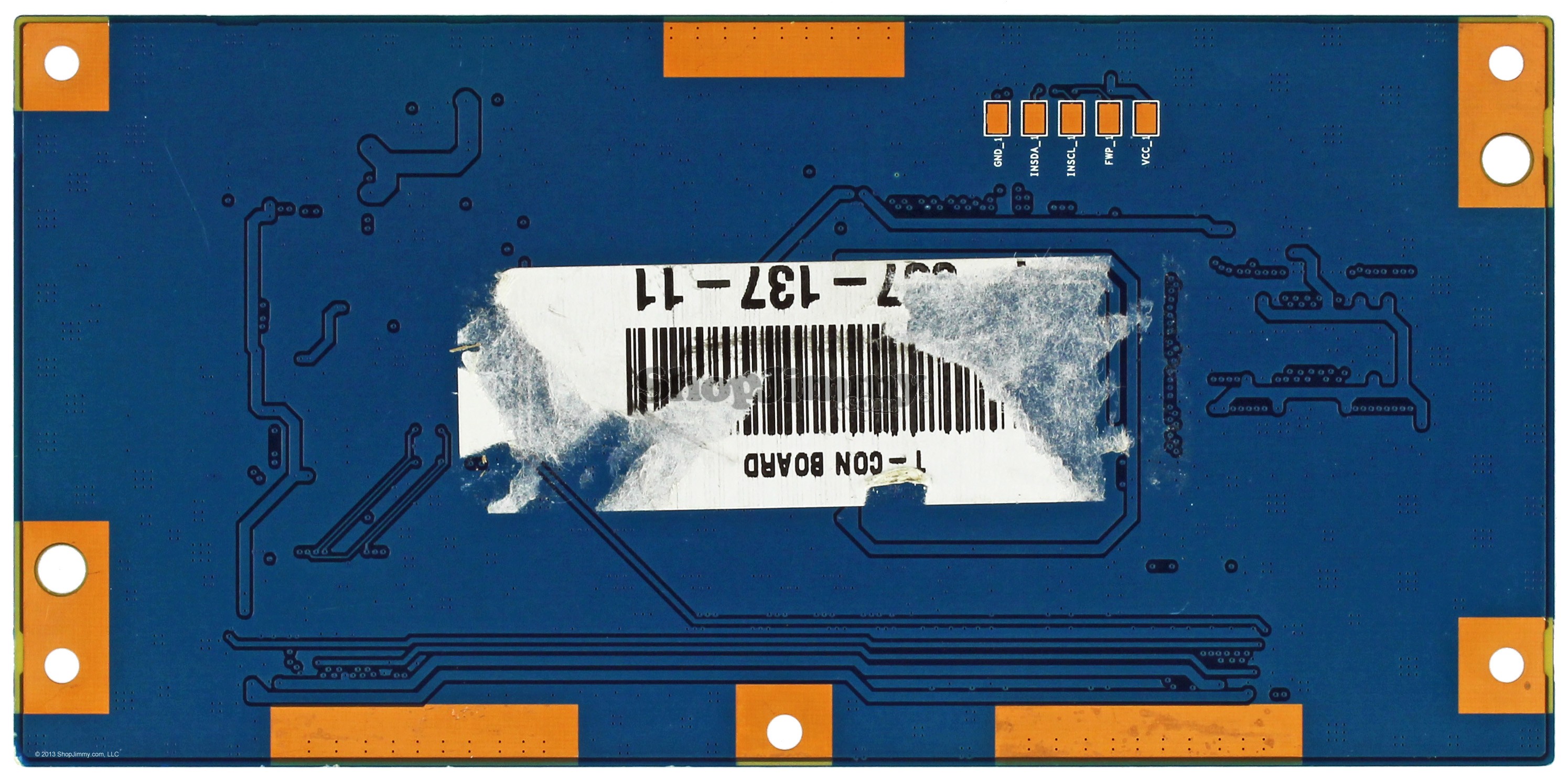

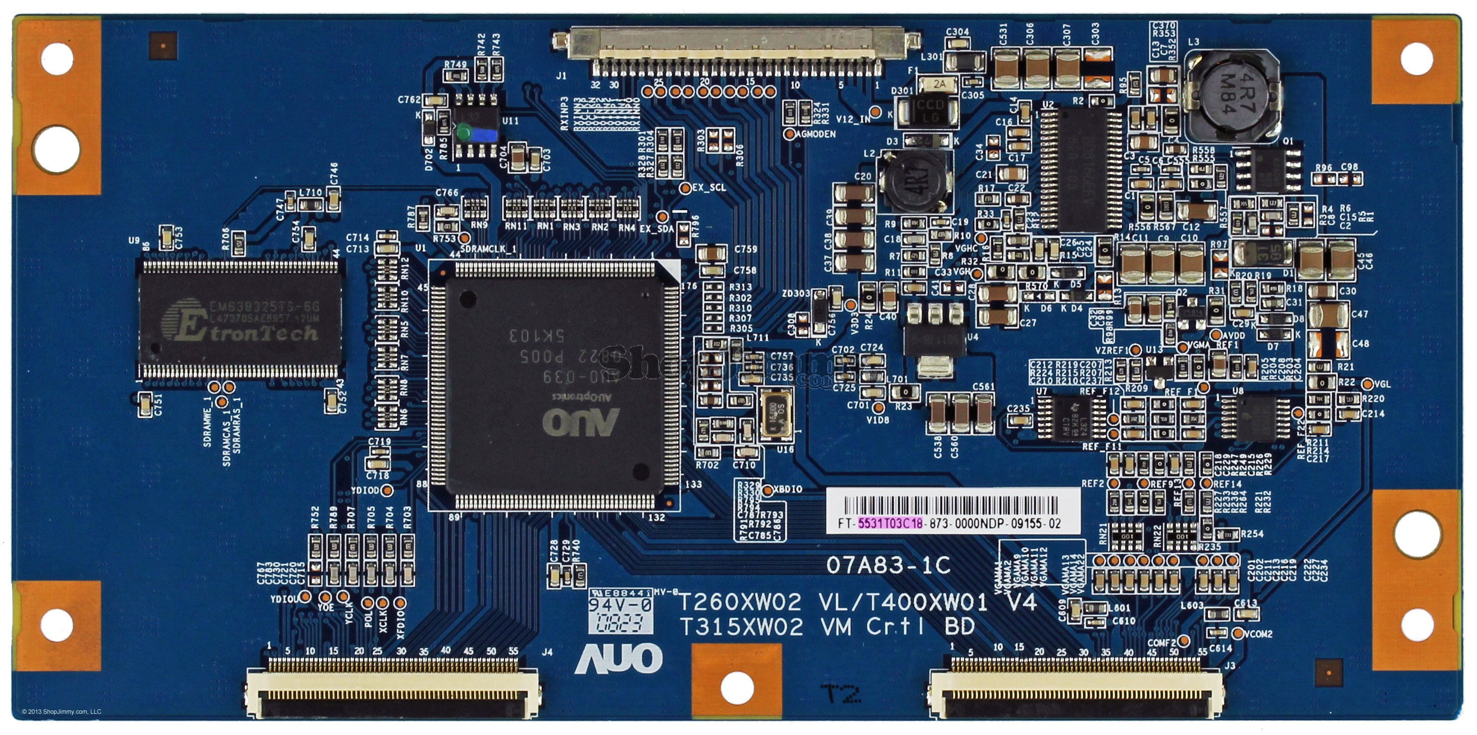

    Attached are the top and bottom pictures of the TCON from ShopJimmy (not enough light right now to take decent photos of mine). Readings are as follows:

    On the bottom on the TCON are measure points. They are as follows:
    GND
    INSDA_1 3.32
    INSCL_1 3.32
    FWP_1 3.33
    VCC_1 3.33

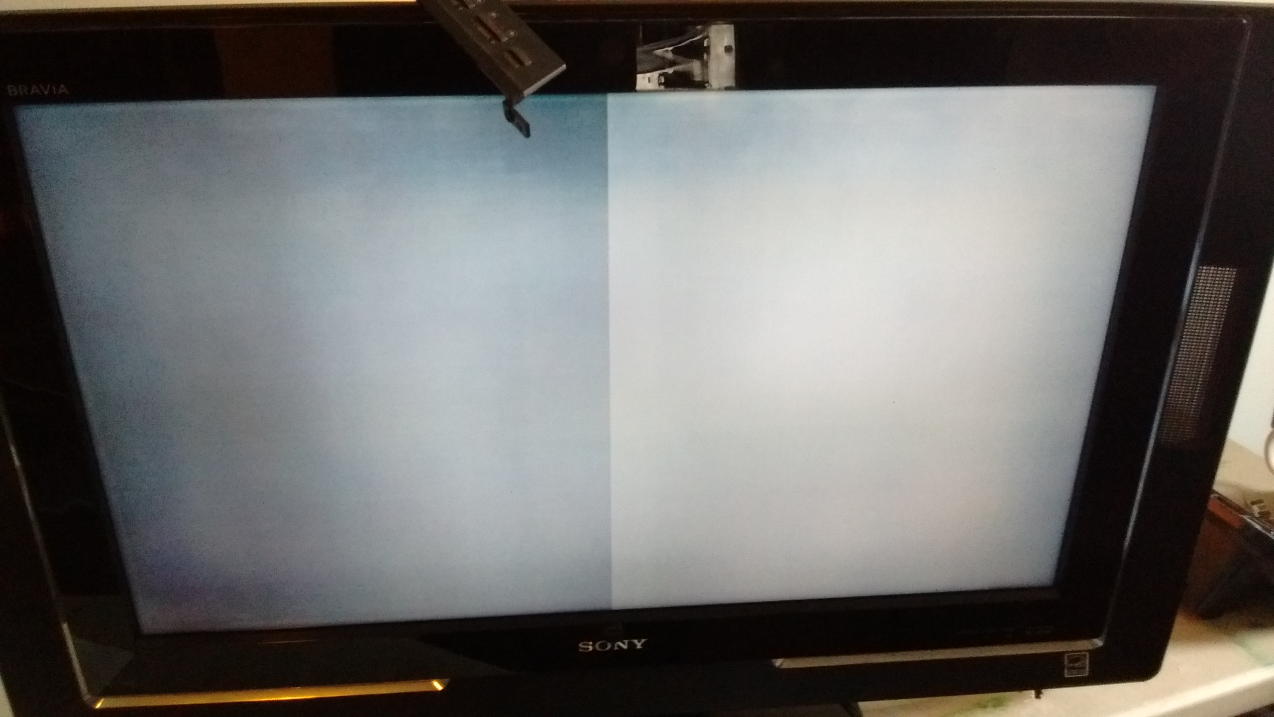

    Removing the left one shows a screen of gray on the left, white on the right. At first, it almost looks like denim jeans. After a minute,
    both sides become smooth with the gray side almost on par with the white side.

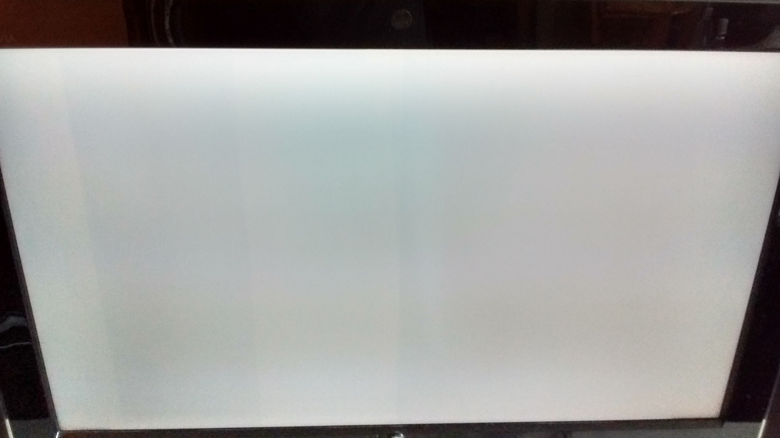

    Removing the right one shows a 2 inch white vertical bar on the left side, followed by gray until the middle,
    then another 2 inch white vertical bar, ending with gray til the end of the screen. No "denim" effect is shown.
    Ordering a new TCON is around 20 bucks. I'd like to rule out a bad panel first.

    Two threads ? Also got image of the grey area on the screen ?

              Re: Sony KDL-32NL140: Powers On w/ Backlights, Black Screen - Bad TCON?
              Please see attached.

                        TCON arrived, installed, no change. I took the TV apart further and have access to the panel circuit boards if you'd like to for to test certain points.

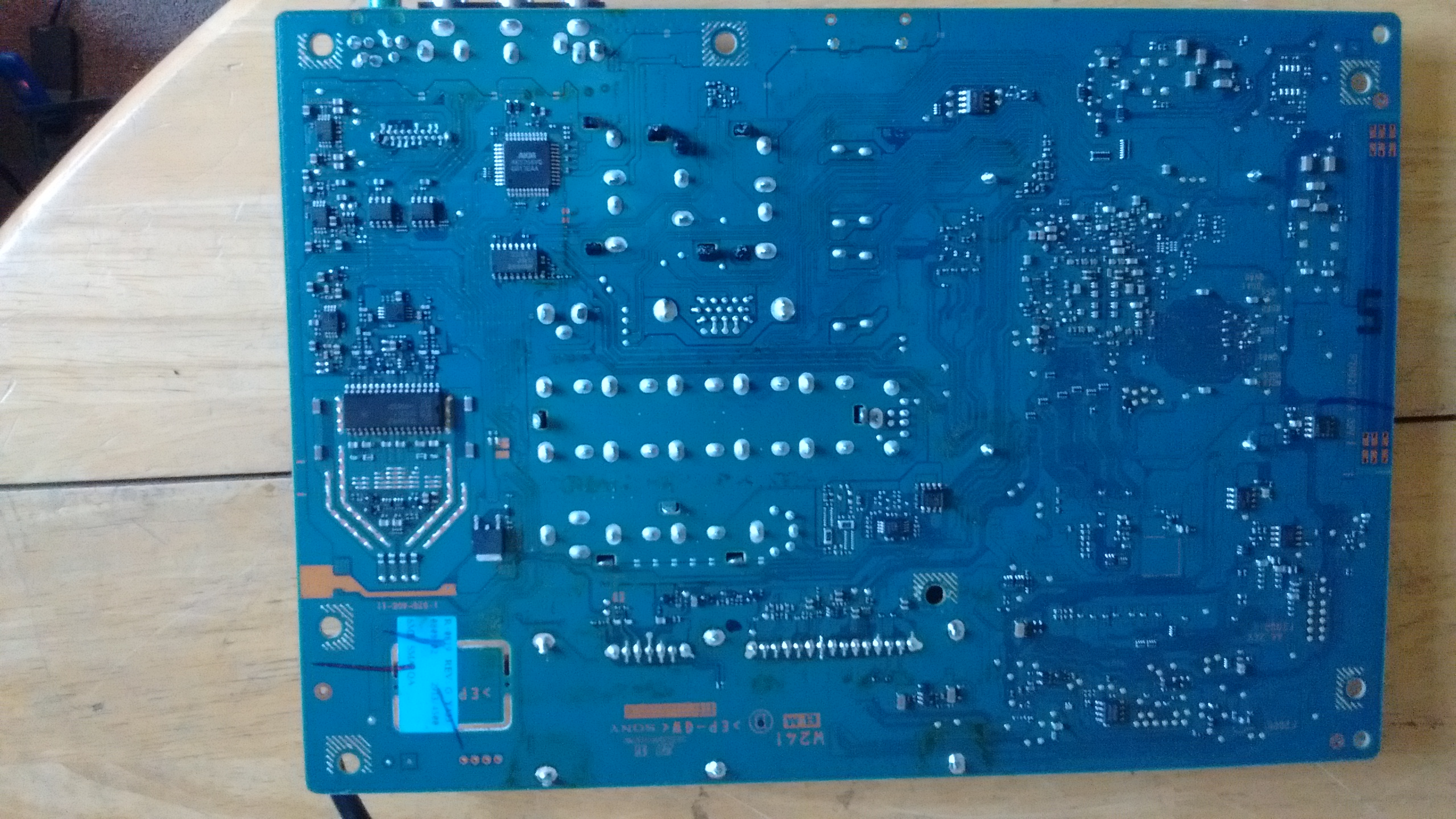

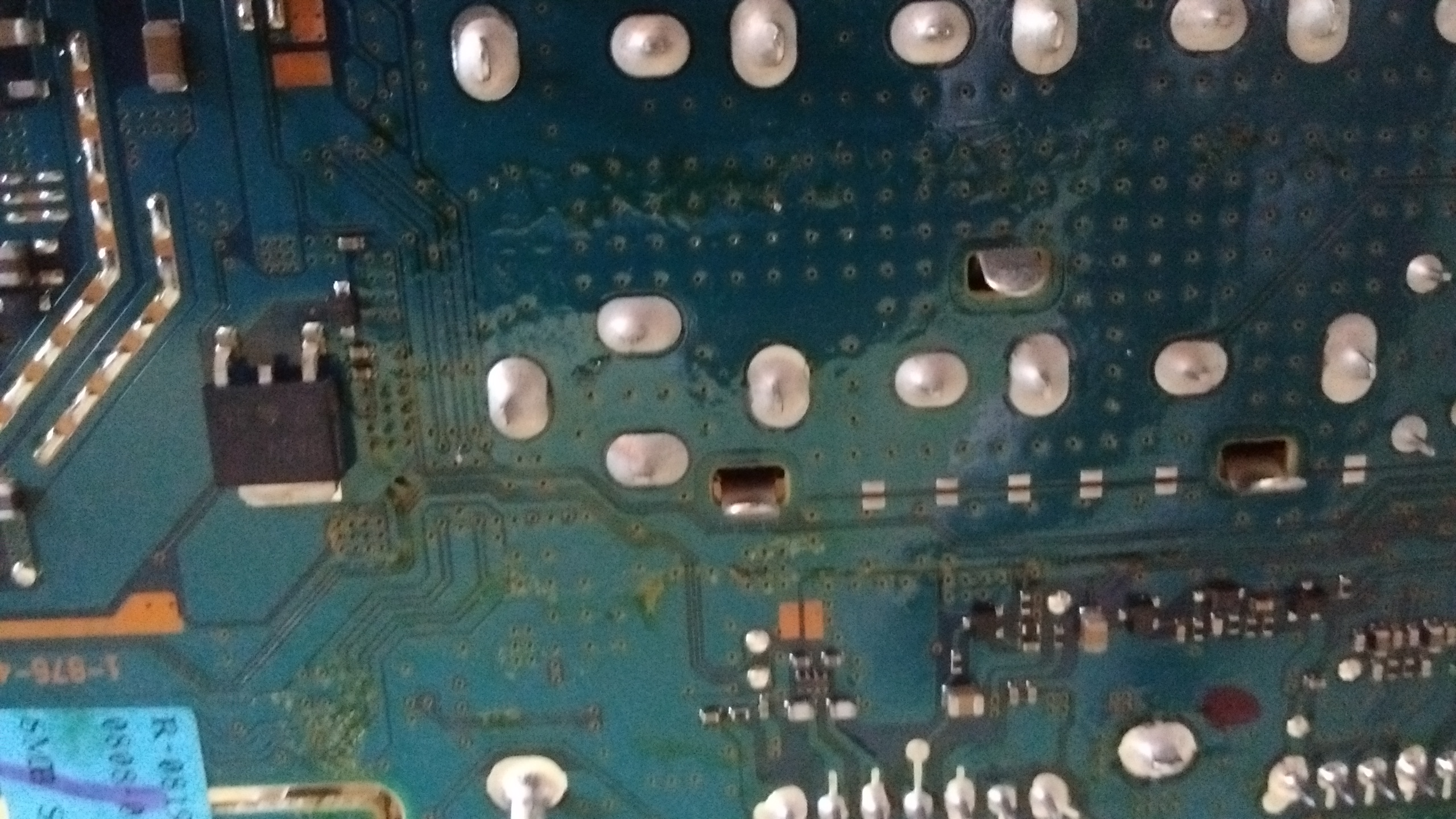

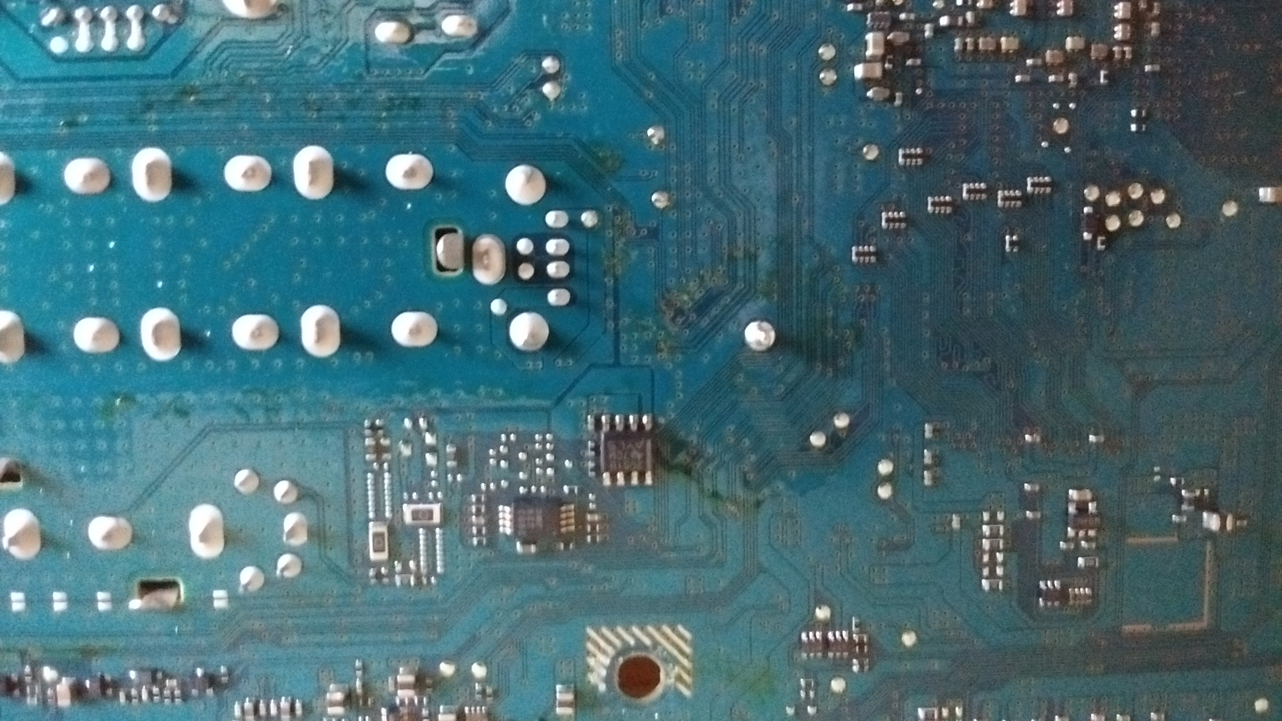

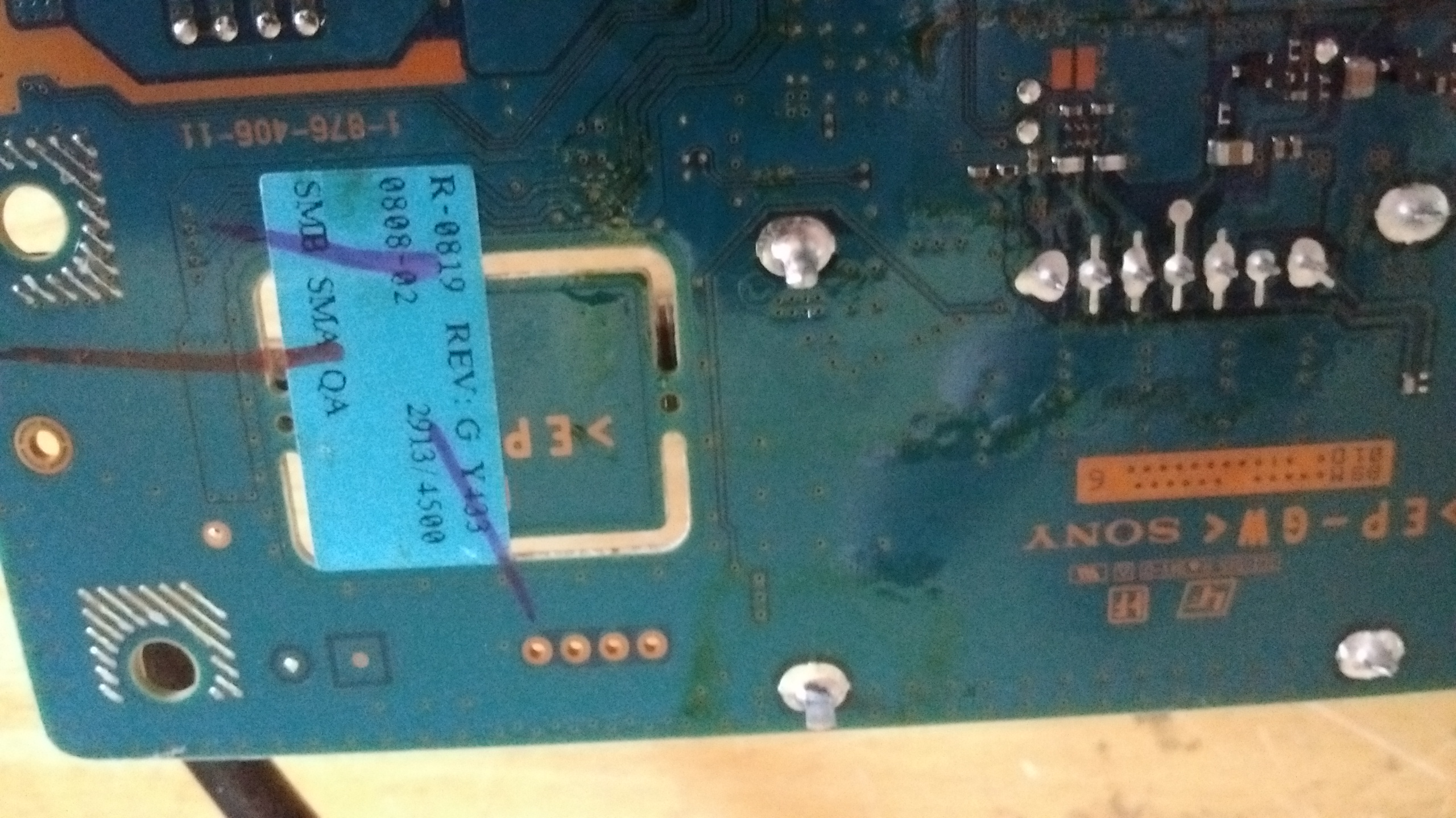

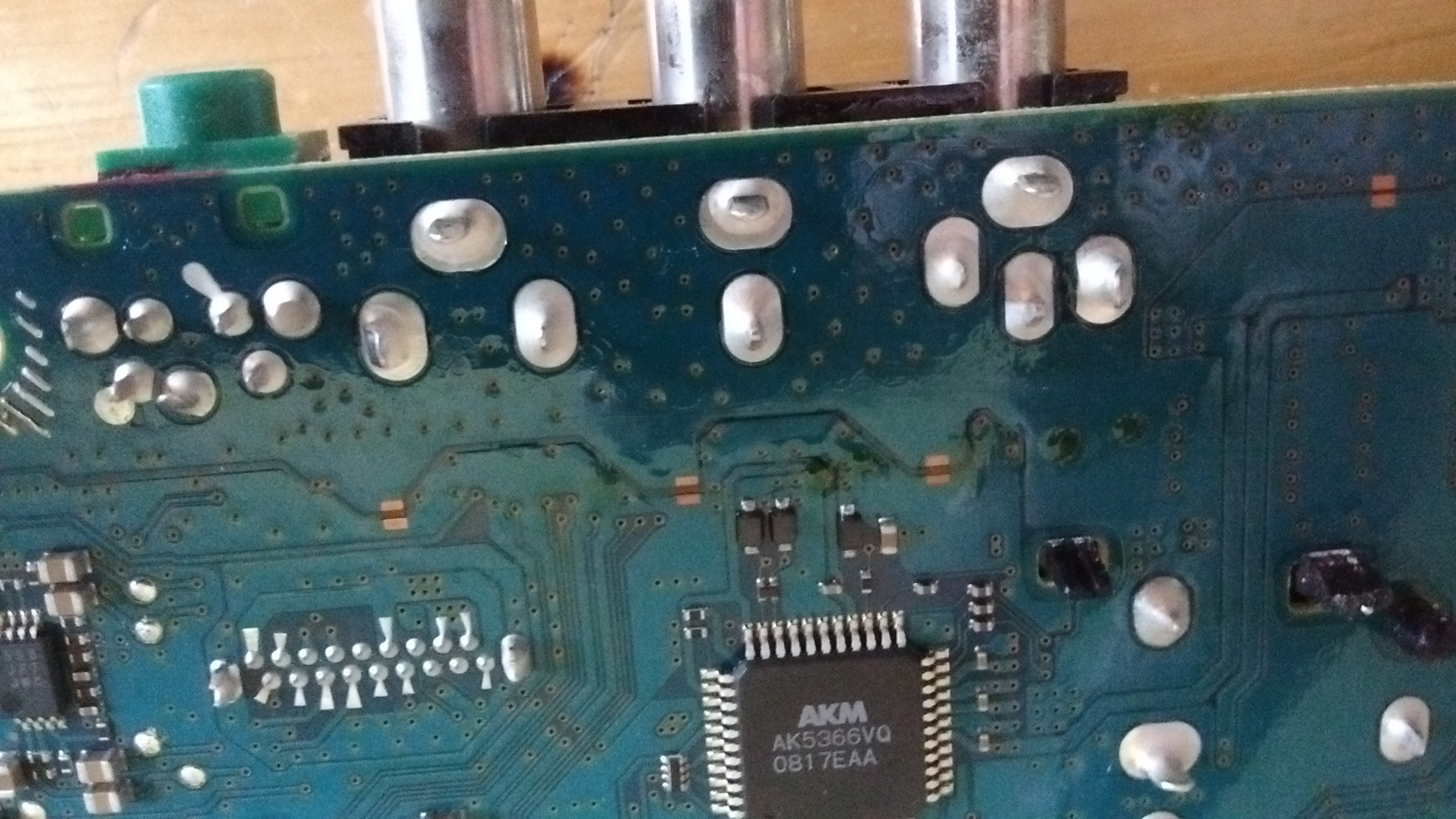

                                Took the main board off and noticed multiple areas of discoloration. This isn't normal, is it? The set is from 2008, so...
                                  at yor first post you wrote No picture and No sound to be heard.... then why you go to T-CON. Video Process at main boards. faults.
                                    Live and learn, my man. I don't have a problem with getting another main board but I am interested in if there is a way to test panels that aren't cracked. Is there a method?
                                    EDIT: Actually, I can clarify why I went with TCON: My last TV repair adventure didn't have a picture or sound either. Turns out it was stuck on an AUX input; I never thought to hit the INPUT a few times to see if it would go a static channel. I did that with this one but to no avail.
