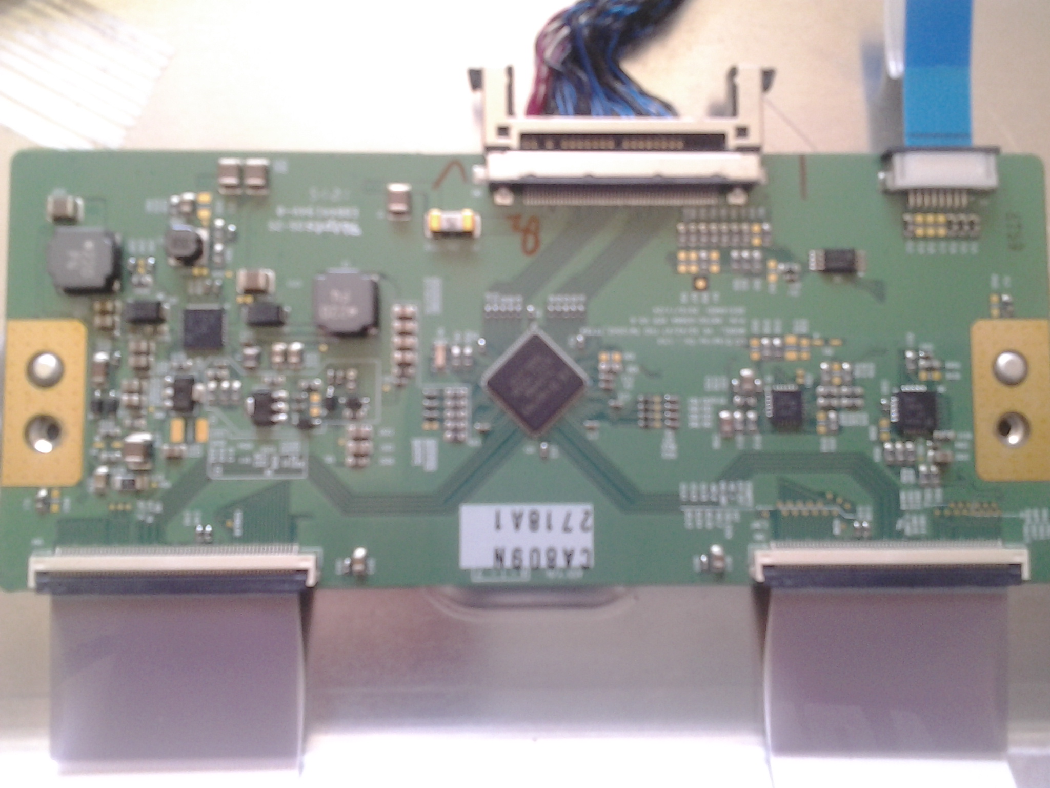

    Hi
    Picked up the above tv today and initially the picture came on but appeared washed out, lacking greens.

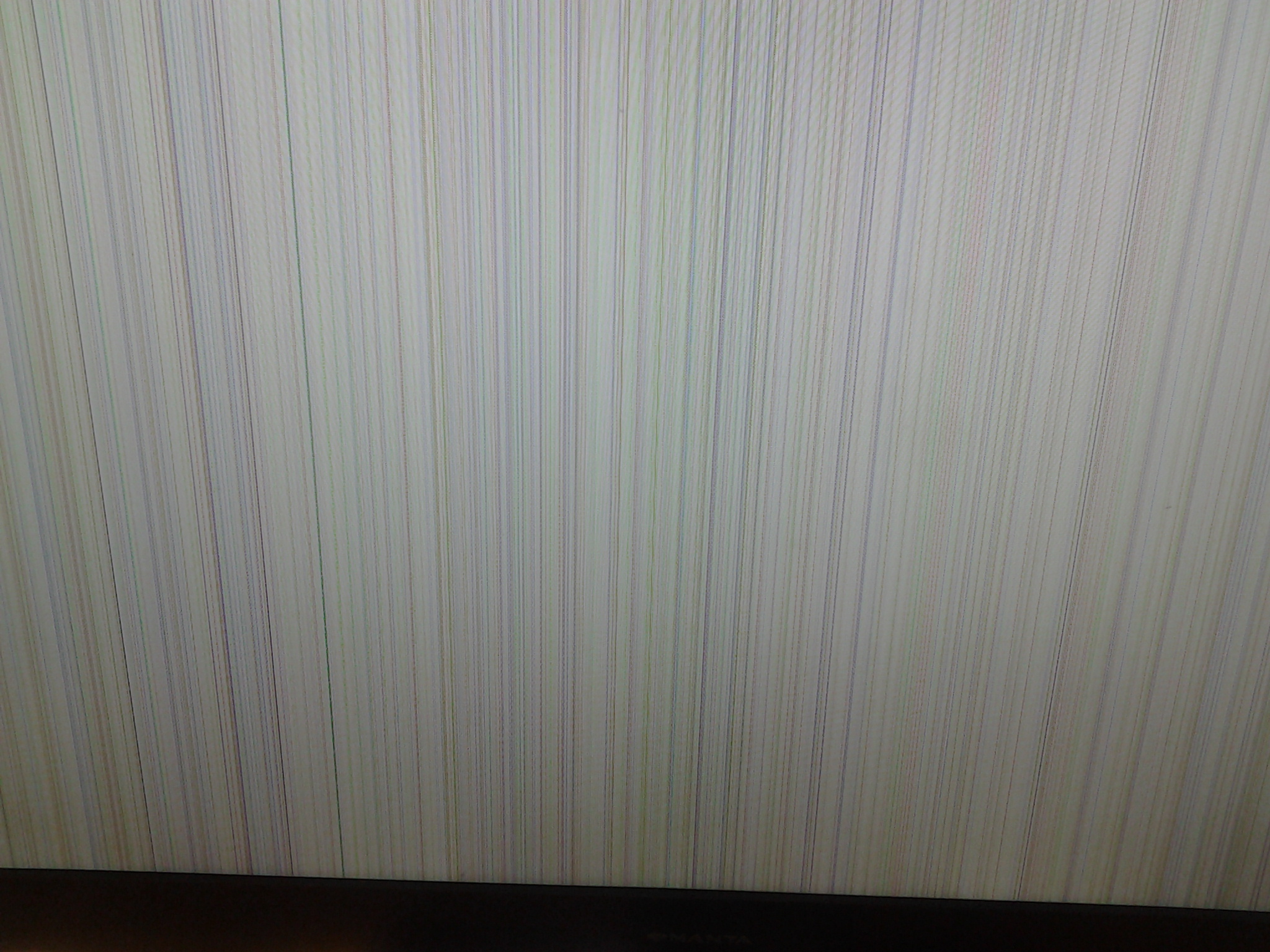

    Suspected the Tcon so reseated all connections and much jiggling later all the screen displays is a screen full of multicolour vertical lines. Sound is fine.
    Im having probs uploading fotos from my tablet but does this sound like a tcon fault before I try to track down a replacement or a bad panel? Cheers
    Andy

    Re: lines on screen Manta LED4201
    Got images please mate of the screen and boards ?

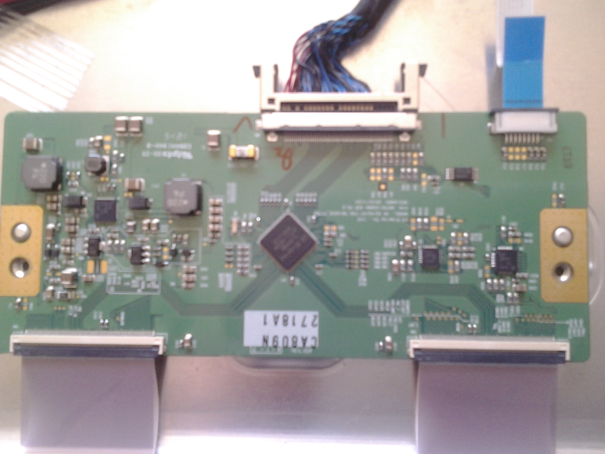

              • andyfitz48
                • Feb 2016
                • 17
                • united kingdom

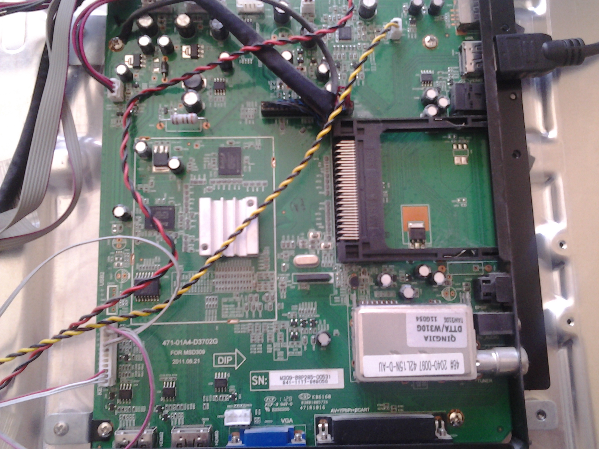

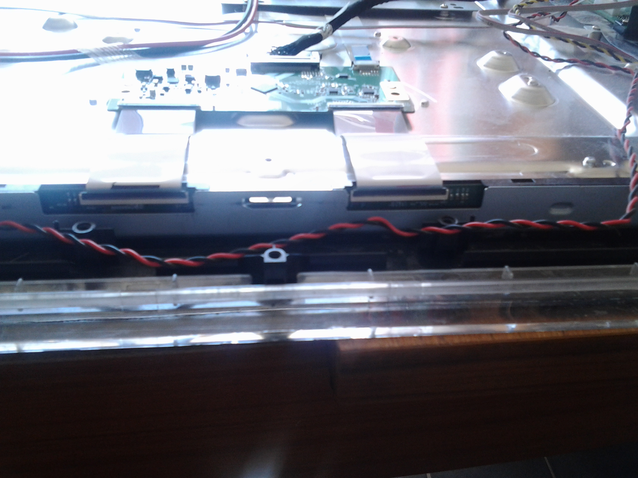

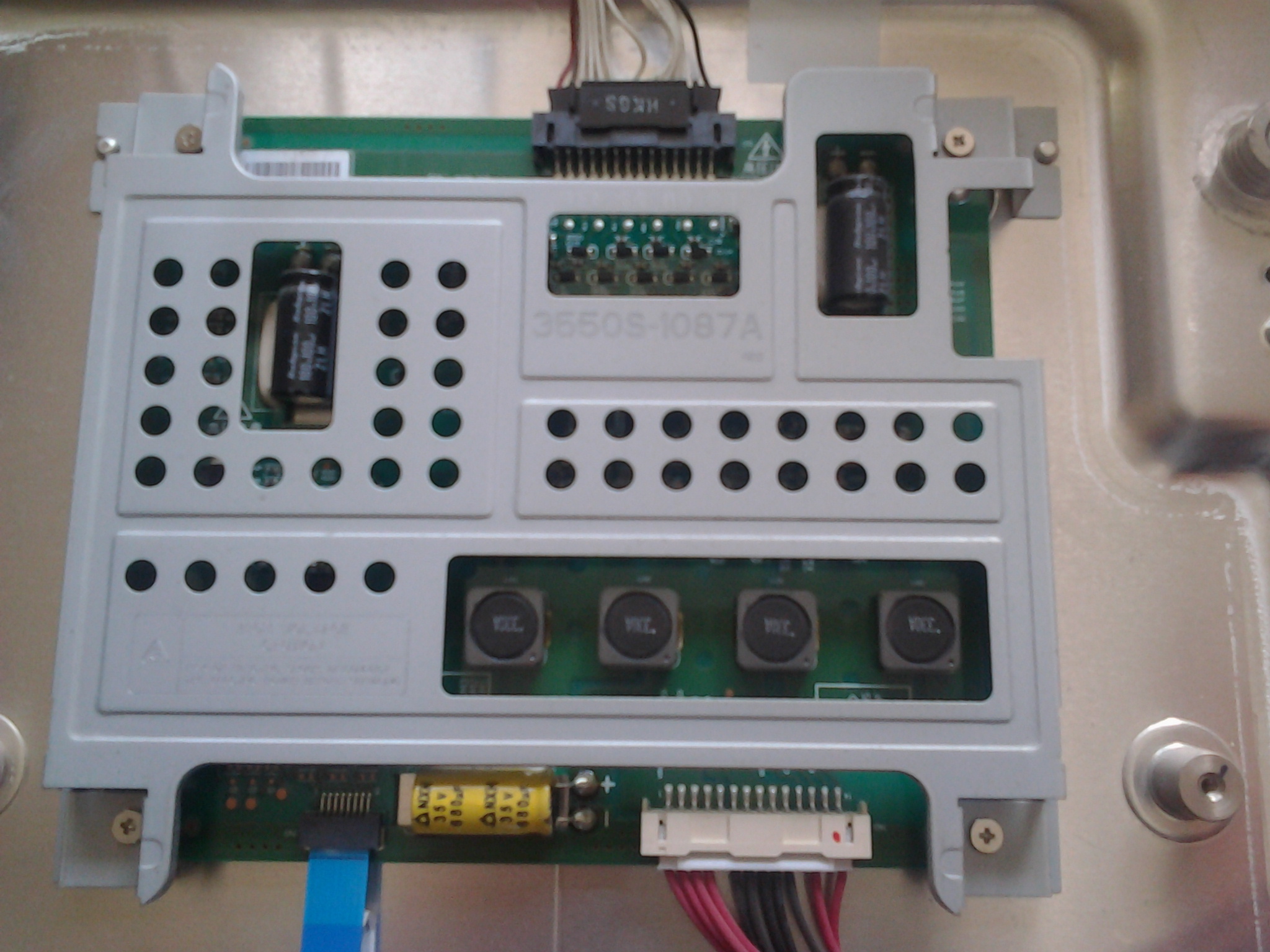

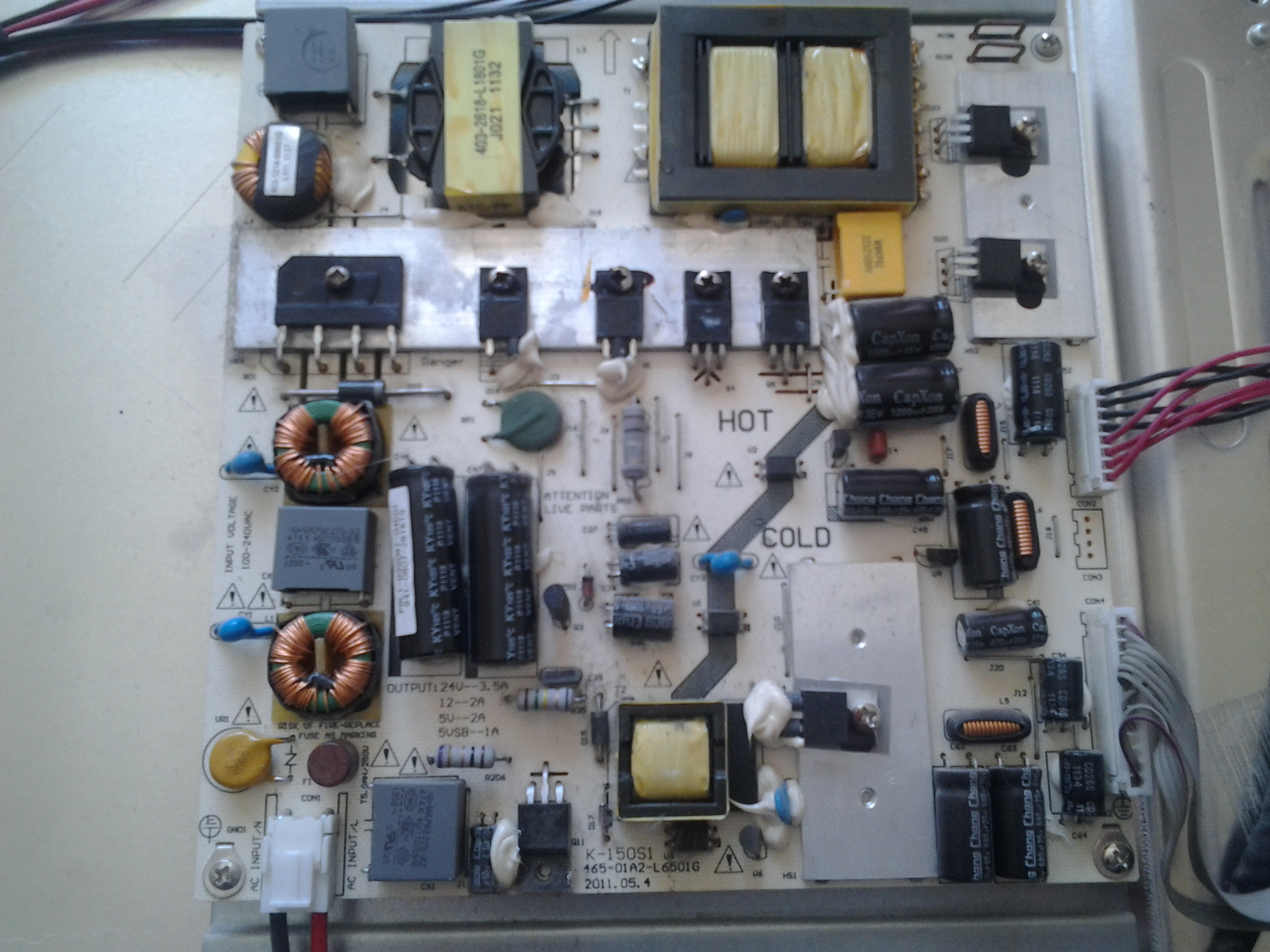

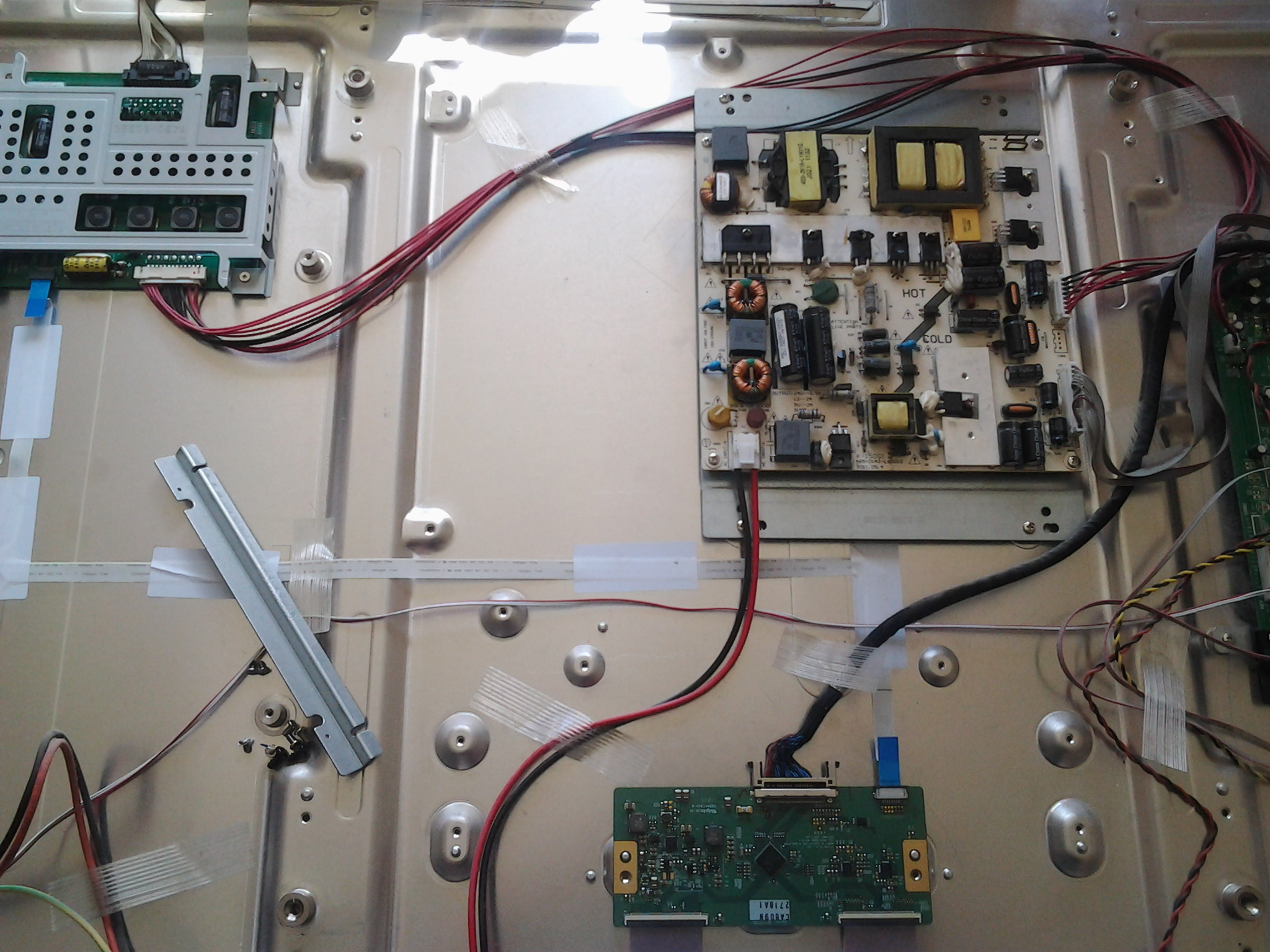

                Fotos attached but may need more detailed ones as only took these for spares comparison
                thanks
                Andy
                • ReeceyBurger123
                  Never Give Up !
                  • May 2014
                  • 7325
                  • Britain
                  I would likely say panel failure on that tbh bud.
                  • andyfitz48
                    • Feb 2016
                    • 17
                    • united kingdom
                    Thanks for the suggestion though I still think I'll try a new tcon - if I can find one.
                    Scoured ebay and they seem to be rarer than hens teeth so can anyone suggest where else I can try? Also tried flattvparts, spares2repair etc.
                    Cheers
                    Andy
                      Are you getting steady 12VDC at the T-CON fuse? and standby Voltage is steady and not low? I have seen this symptom before due to border line standby Voltage or the switched 5V.
                      • andyfitz48
                        • Feb 2016
                        • 17
                        • united kingdom
                        Yes, I was when I 1st opened it up and the picture was displayed though washed out.
                        Didnt test it after id jiggled with the ribbon cable and the screen went to just vertical lines.
                        Andy
