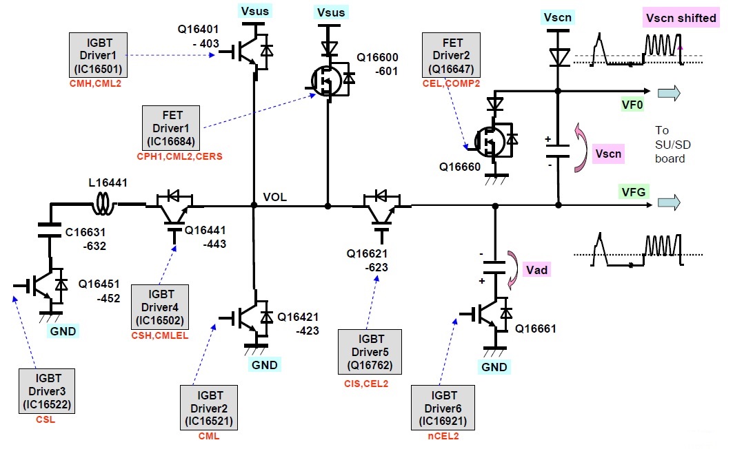

    I'm struggling to fix Panasonic plasma TX-P50UT30B.
    TV doesn;' turn on and LED blinks 6 times.
    Faulty is SC board like usually it this case it's TNPA5351 AF
    I have changed already Q622, Q623, Q600 and Q661 which all were shorted.
    After that TV still doesn't turn on showing 6 blinks, no shorts fortunately after powering up.
    Later I swapped from my other death boards PC685, PC581 and IC921 but it didn't change situation unfortunately. Both buffers I swapped from my TX-P50ST30B.
    I have found no other shorts.
    I will appreciate any help to solve this problem.

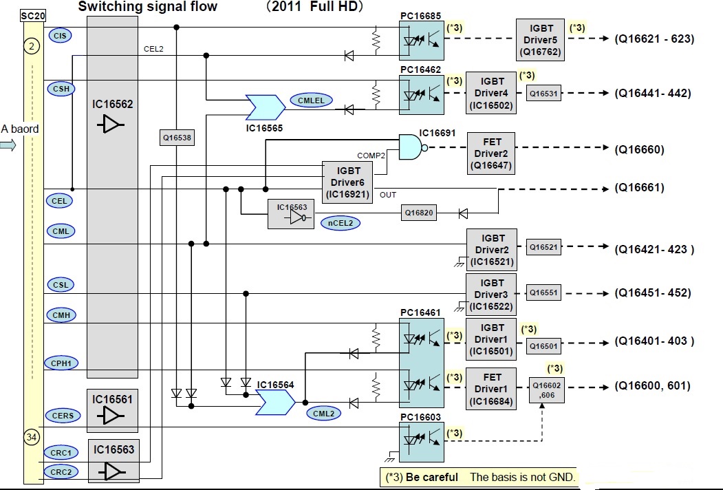

          maybe check all the drive ccts.

            Thank you very much for those slides, I haven't seen them before.

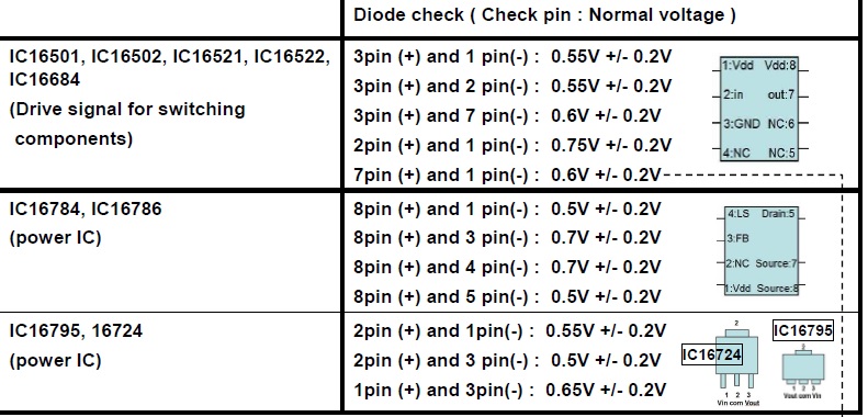

              Neither have I, wish i had them when i struggled with the TNPA5335 which I'm still not 100% sure which bit I did fixed it.
              Really interested to see how you go in diode checks on those 8 pin driver buffers.
              I always think when bits stop blowing up you're close.
              It seems to me if you get 621, 622, 623, 661 etc are bown it's a dificult repair.
              Also I don't see any 6 blink repair kits for the 5351 or 5335 so it would be good to see what it is we're missing.

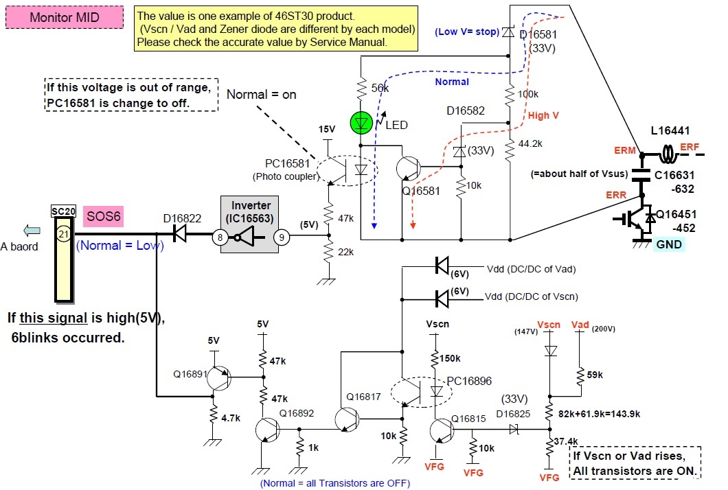

                Just fixed this same model TV.
                I thought I would post up what I found for other people.
                TV had no blink code at all. Just a solid green light and no panel discharge.
                The 30F131 transistrors on the SC board were shorted only.
                Replaced them, now I get a 6 B blink error code.
                Replaced both DG302 transistors and a hole heap of the small 5 and 8 pin ICs and transistors. Everything that came up in a search, still no go.
                Turned out to be the green LED D583.

                  :-).... that's rather interesting. Did the LED actually light and then go out or didn't even light?
                  • BigPete
                    • Jul 2012
                    • 76
                    • New Zealand
                    Re: Panasonic TX-P50UT30B 6 blink error
                    I never noticed it lighting during the multiple tests.
                    I only found it because I was testing the whole SOS6 circuit in diode test mode.
                    Looking back Tom did mention in one of the posts to see if it was lighting briefly, but I was focused on all the common faults that I didn't even think to check.
