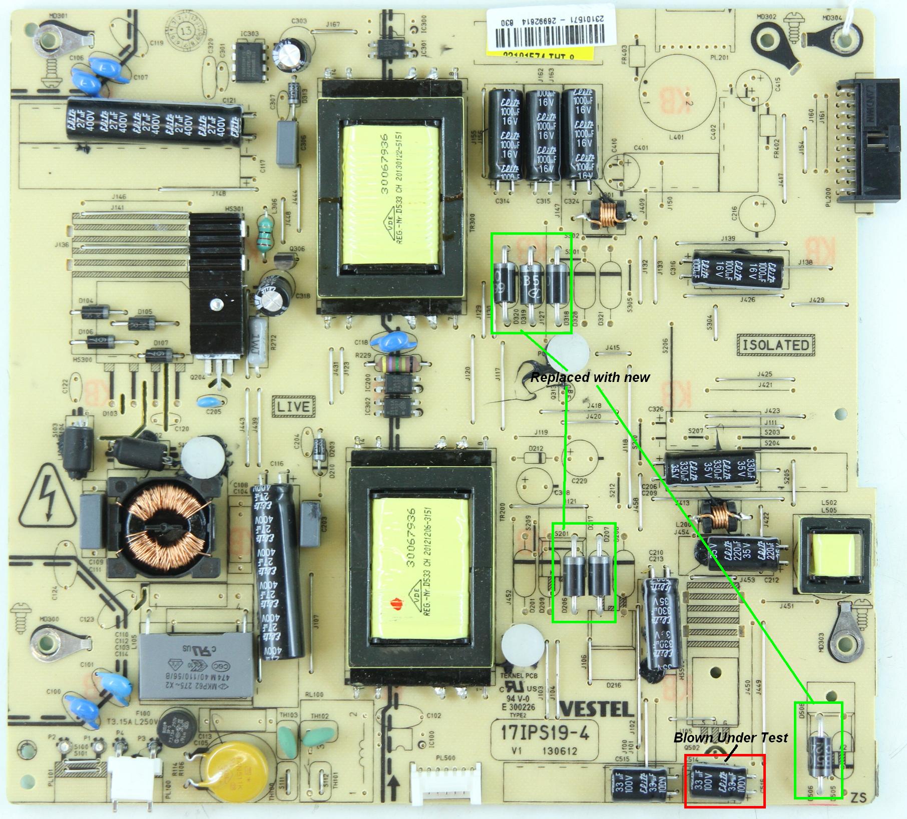

    Hi There,
    Looking for a bit of help with a Polaroid 32" LCD TV which uses the Vistel 17IPS19-4 PSU Board.
    Fault :- Tv switches on out of standby and the lcd backlights power up and then power down and keep doing this untilll i switch the set back to stand by.
    You can hear the PSU under pressure while its doing this.
    I bought two of these sets from the same person who had bought them at the same time and both failed 14 months later two weeks apart.
    The first of them i have repaired using some of the parts from this set.
    I have now replaced these parts with new.
    D320,D319,D318
    D206,D207
    D506
    Mosfet and LCD Driver chip on the under side were also replaced as used on the other set.
    Having replaced these I now have the set back to what it was doing first off
    The set just keeps powering up the back light and off again - In the end i left it doing this in the hope something would show up.
    After about 20mins C514 gave a puff of smoke and failed.
    This however is not the faulty part as i replaced it and still have the same problem.
    Any suggestions would be great.

    Re: Vistel 17IPS19-4 V1 Backlight Flashing On & Off
    Have you checked the Smd diodes in the Led drive circuit ? They also can fail. Also is there a short across that cap that keeps blowing ?
      PSU Board and Main Board swapped out with other working unit and still same issue .
      Pulsing whistling sound and screen back lights light up and off thrn on again ?
        Hmm maybe there is a lose connection between the Led strings and the branch Pcb, I can link my video on how to test this if you want ?
