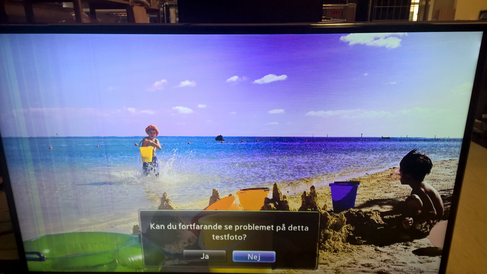

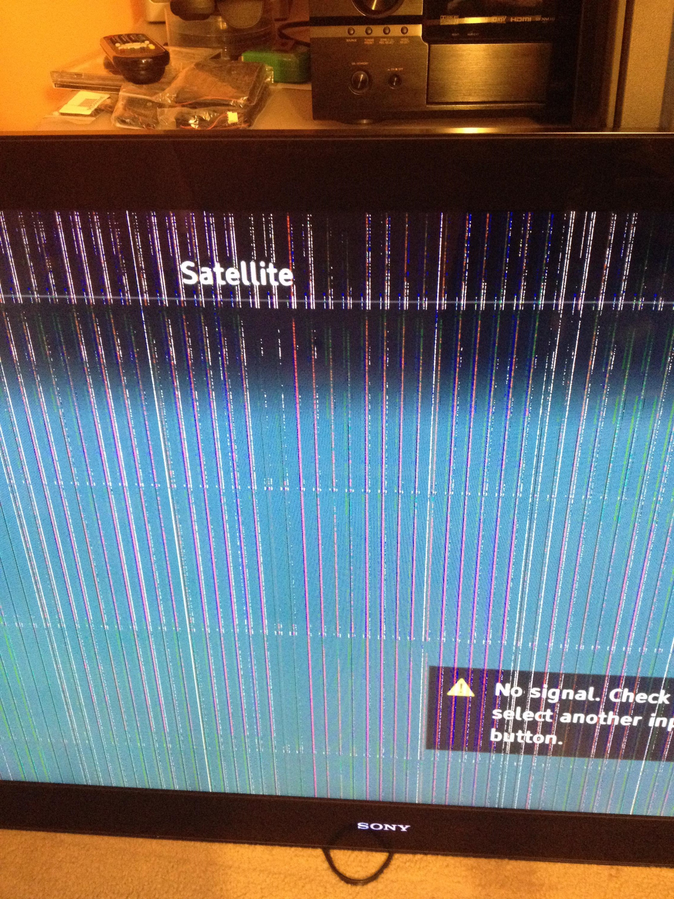

    Please see the attached pictures.
    Is this a panel problem or perhaps t-con ?

    Maybe the pics is hard to judge, but let me explain in words.
    Many of the upper lines are "doubled" and exists in at least two lines.
    Mind this is a panel failure, or what about the ribbons t-con / panel ?

      if the lines were across the screen, then it might be something other than the panel. You can try cleaning connectors / reseating between tcon and panel and tcon and main board.

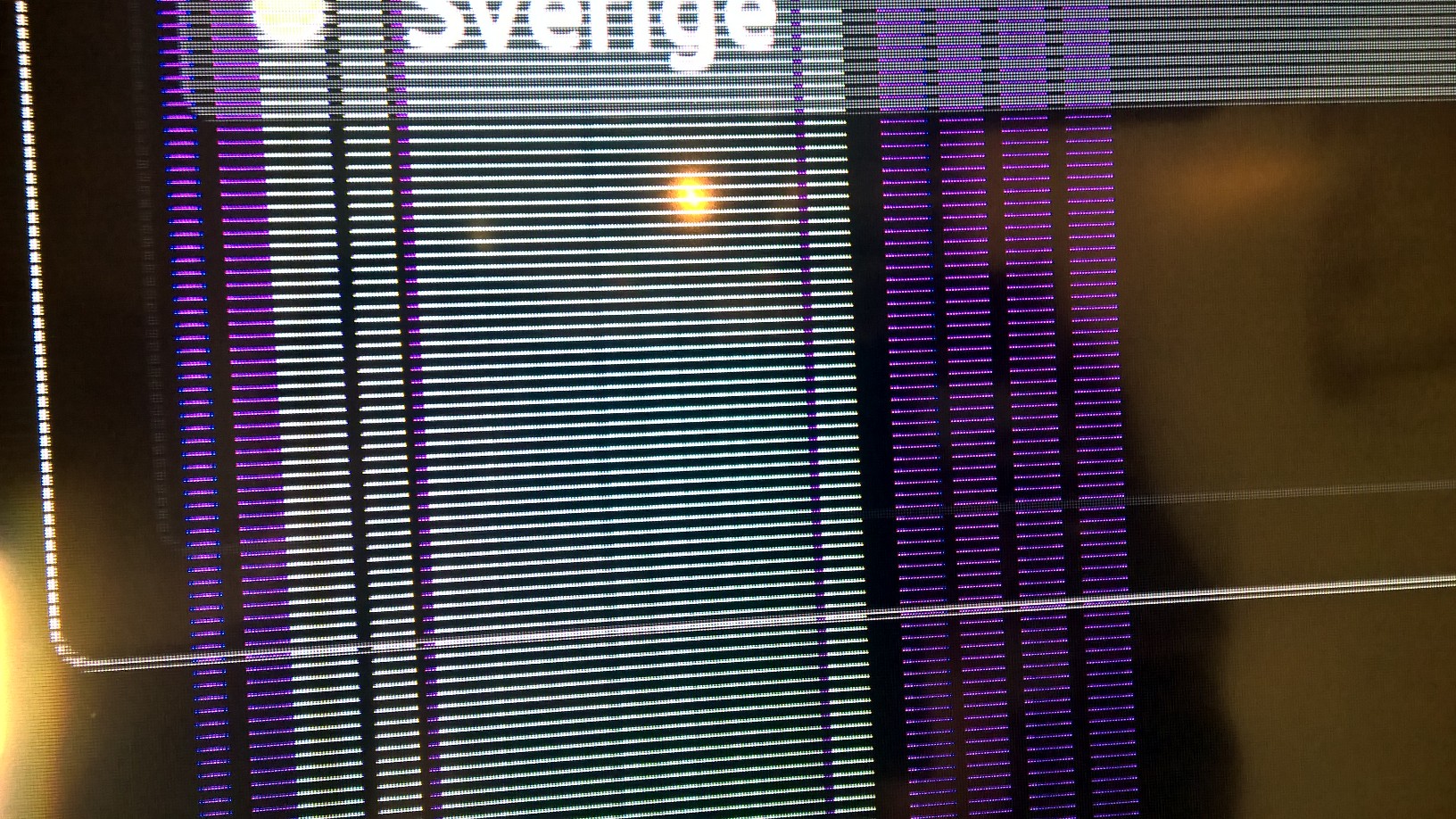

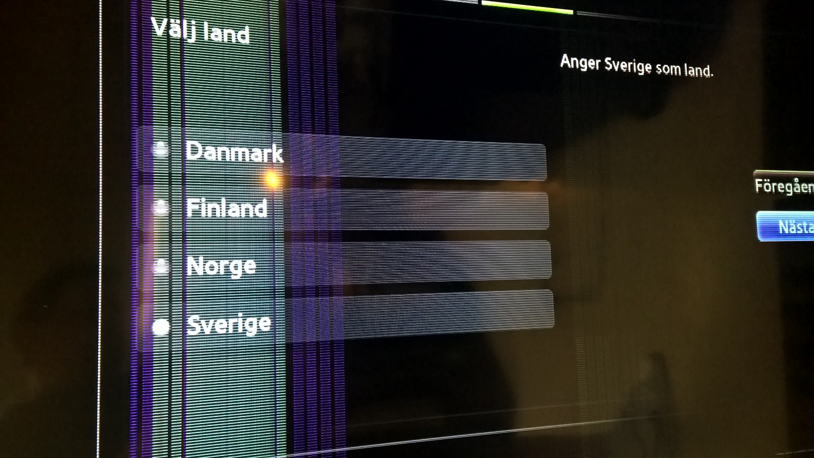

        Here's two more pictures of the failure
        Ribbons re-seated and cleaned, not the slightest difference.
        What do you say , is this a lost mission ? Bad panel ?
        It appears it cannot erase lines that were previously on.

          If you disconnected one of the TCON cables to panel does that half of the picture clear up?
            Re: Samsung UE55ES6805 lines
            It does not look like panel problem, to me it is either the main board or T-CON hard to 100% sure.
            Strange to see dash lines symptom like that.
              Panel problem IMHO.

                  From the photo's posted it does not look like the menu is affected by the lines.

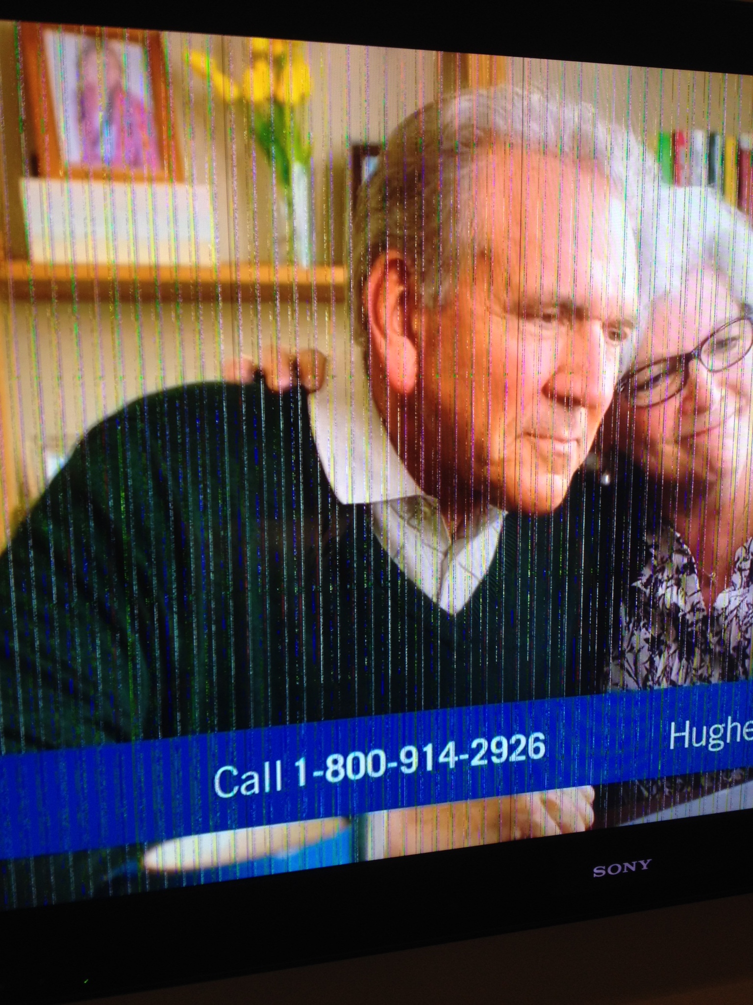

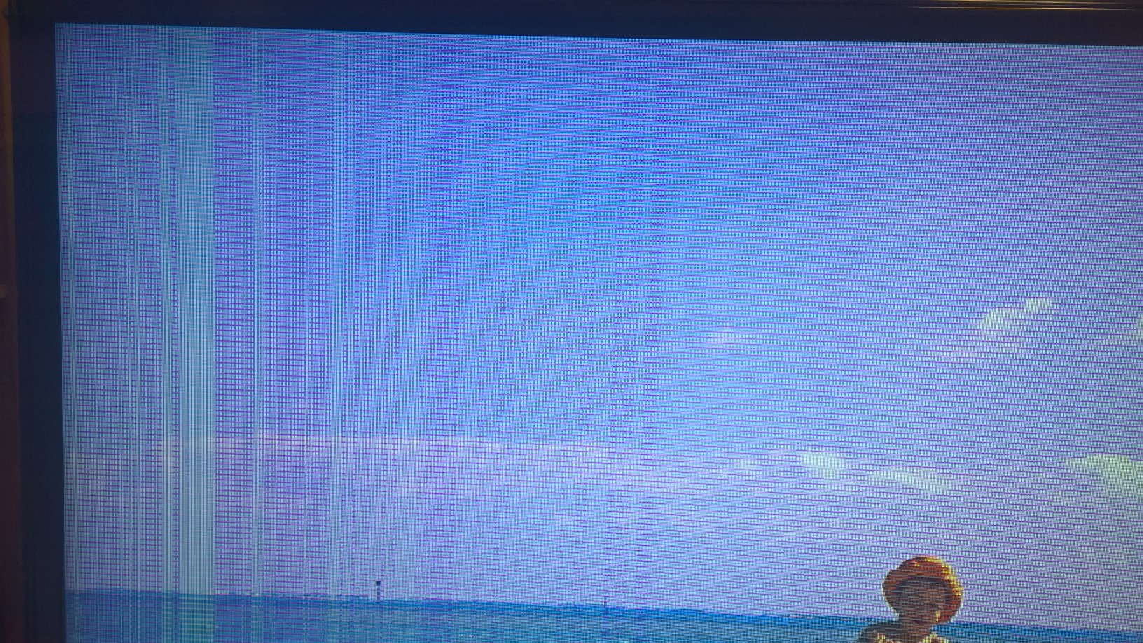

                    Some of the pictures I collected from B.C. and what OP did to fix the problems, first two are due to bad T-CON, the third is main board.
                    I do not know if it is same as in this thread or not but it looks pretty close to the problem here.
                      Update:
                      When disconnecting one of the ribbons between t-con and panel , half the screen is all good. When testing other ribbon , picture is at fault.
                      This is then a panel failure I suppose ?
                        Thanks for the info, I will add these pictures to my collection of what the cause of the failures are, in this case it is the panel.
