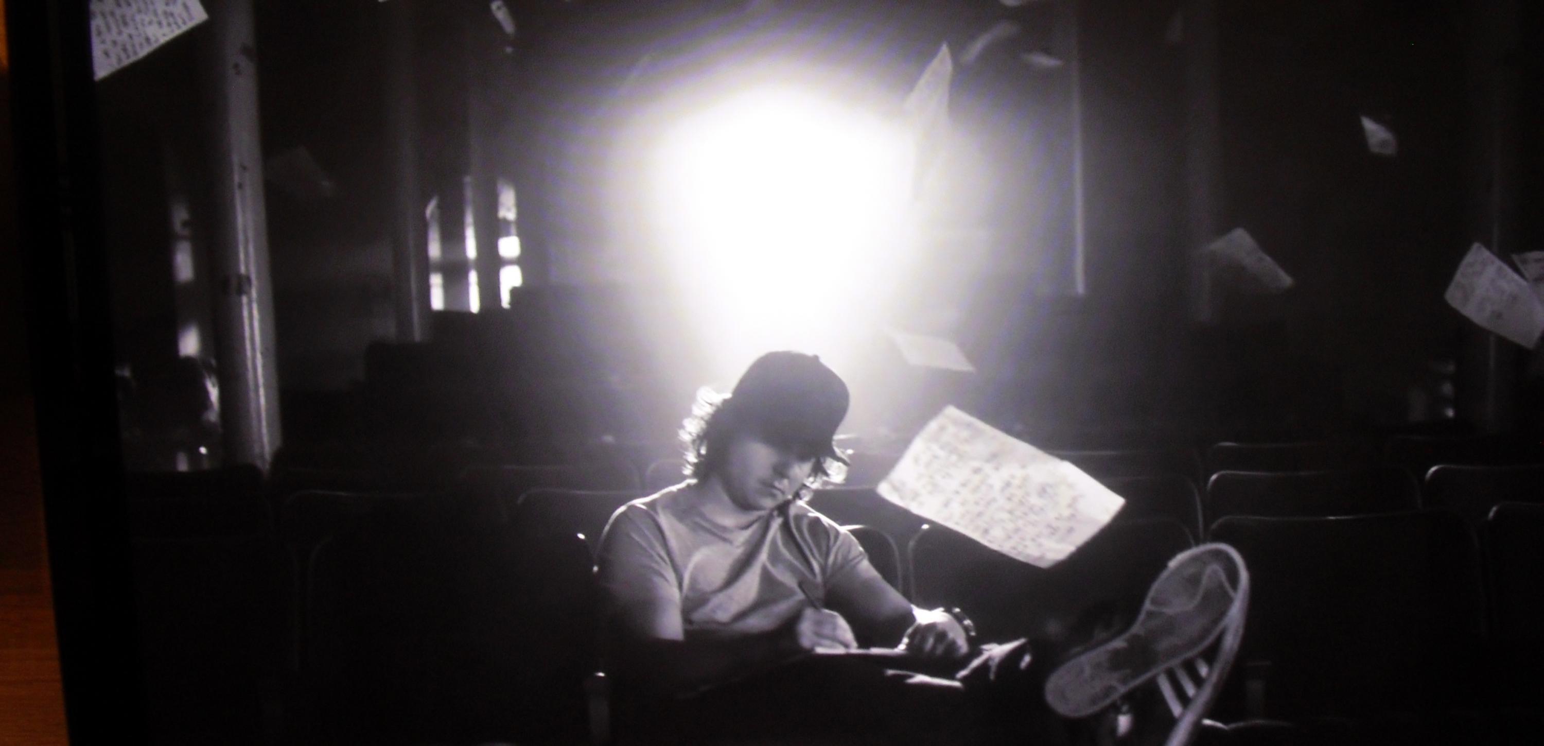

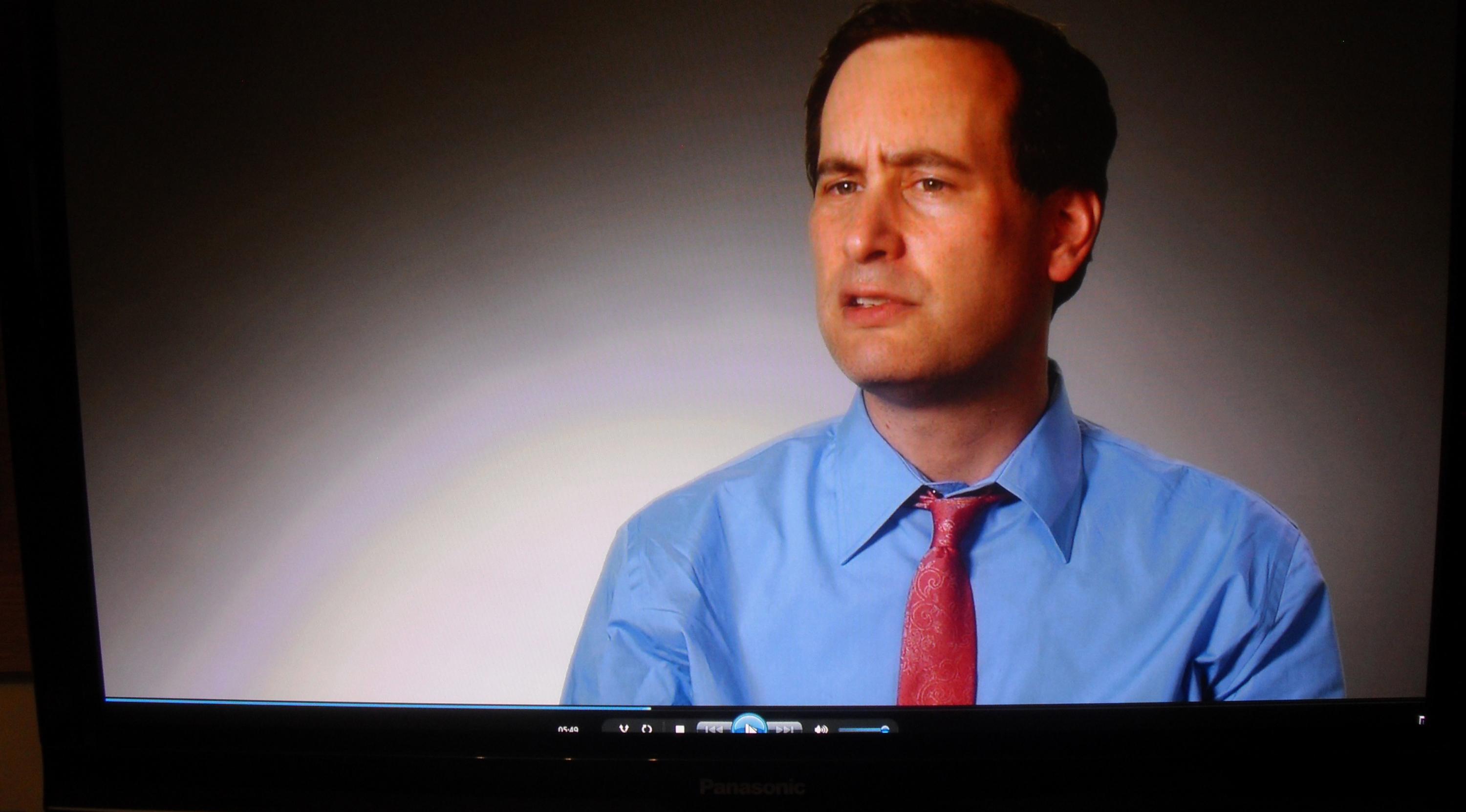

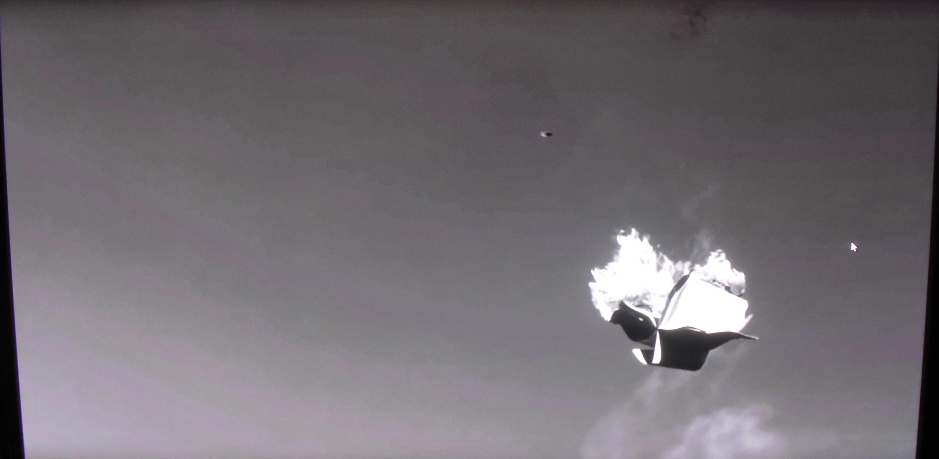

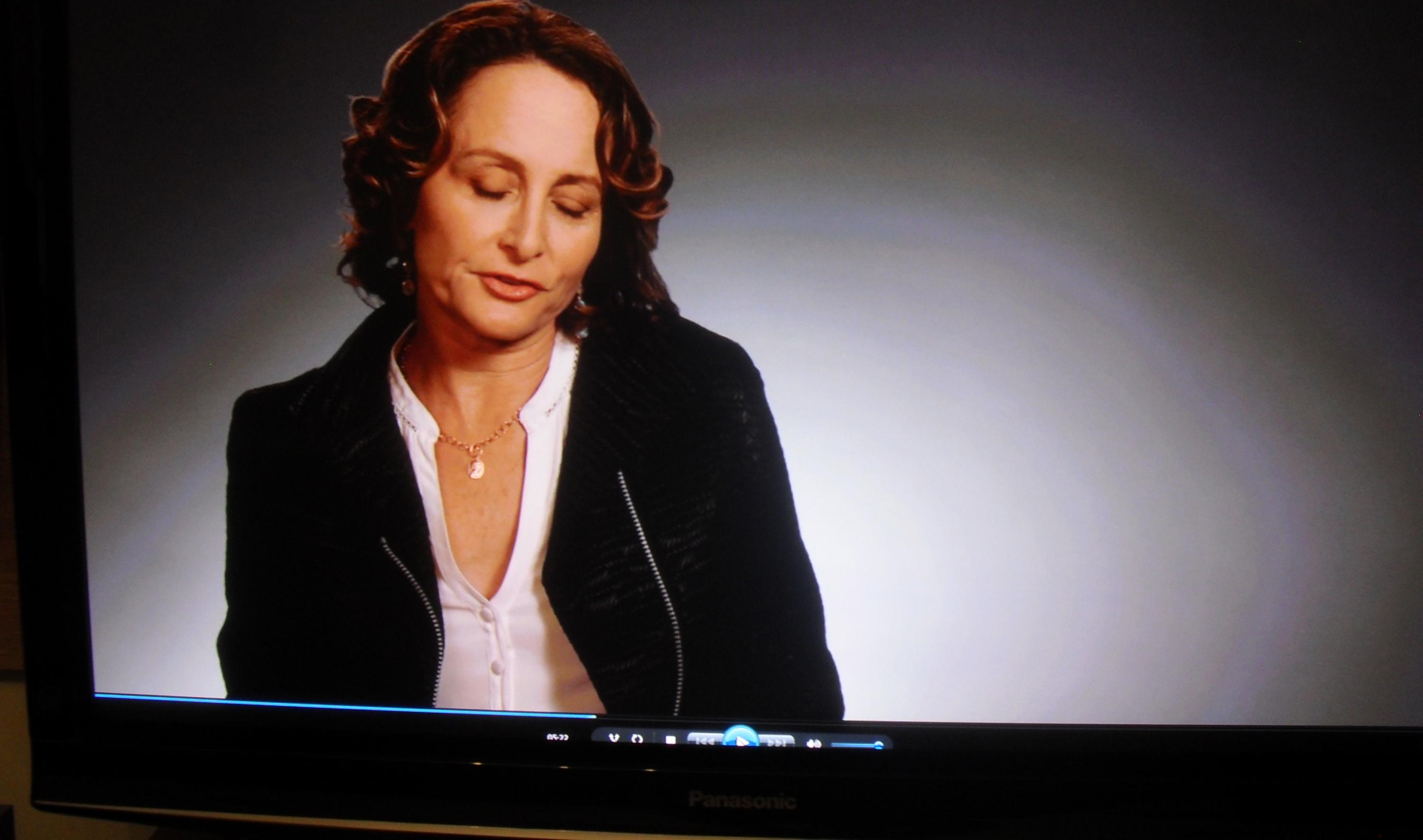

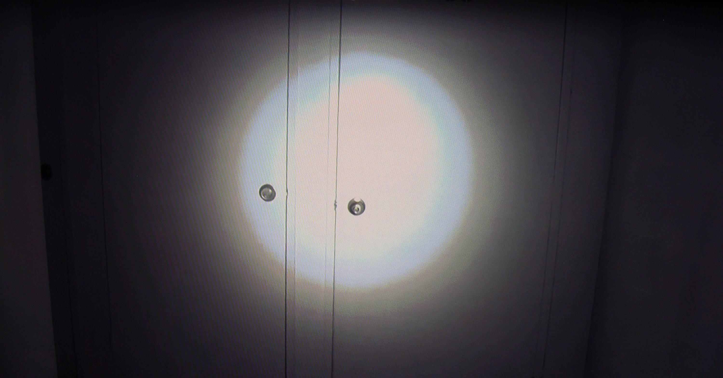

    I have Pansonic plasma TX- P42G10E since october 2009. Since couple of weks
    I noted strange changes in picture and sam flickering on motion especially on movie TV channels. It seems the refresh rate is not 100hz,something like that.
    Also there are problems in some background like rings around or twirl, especially when is flashlight on scene.
    There are some pictures of problems:

    I have had some issues out of the mainboards on these sets. This uses the TNPH-0784 board which is prone to developing issues with the Bga solder breaking on the processor Ic's can cause symptoms like this or 14 blink error. Will link my thread if you want. Have you tried resetting the Tv ?

      Thanks for the quick answer. Yes, I was resseted and install a new firmware but the problems are there, all is the same.

        Hmm maybe take the back off and push on the Bga Ic's see if it improves. You cant really run test patterns on these either as the control board is built into the mainboard so it might still be distorted. Link to my thread:
