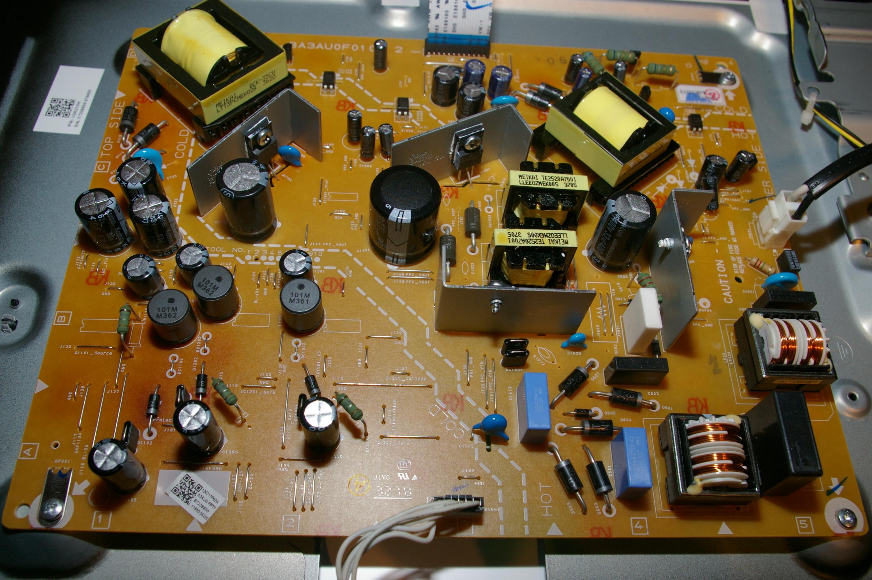

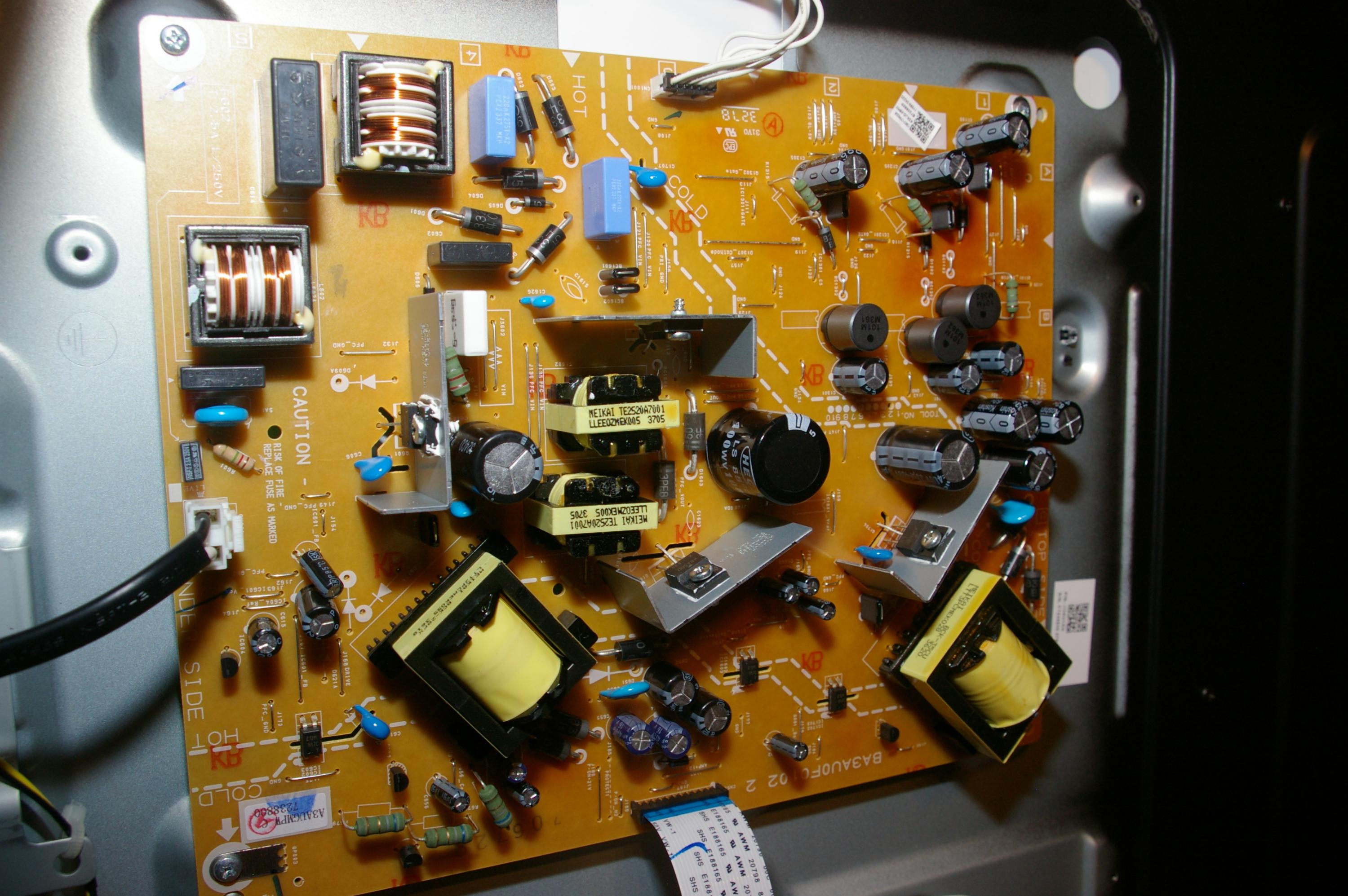

    I've been doing some research on this, and it seems it may be a shorted diode. Not sure on how to check all that right now, but I have a decent VOM now (bk precision).
    I've attached pictures of the PS, and I believe that's where the chirp noise is coming from.
    I've noticed others have posted similar problems with these funai/emerson sets. Thanks much for any help!

            Can we see the closed up pictures of this diode? D??
            Any good straight shot pictures of both sides of the board?

                Re: Funai lf501em4f chirping psu. no power on
                The picture of the board where the diode is, both sides of the board.

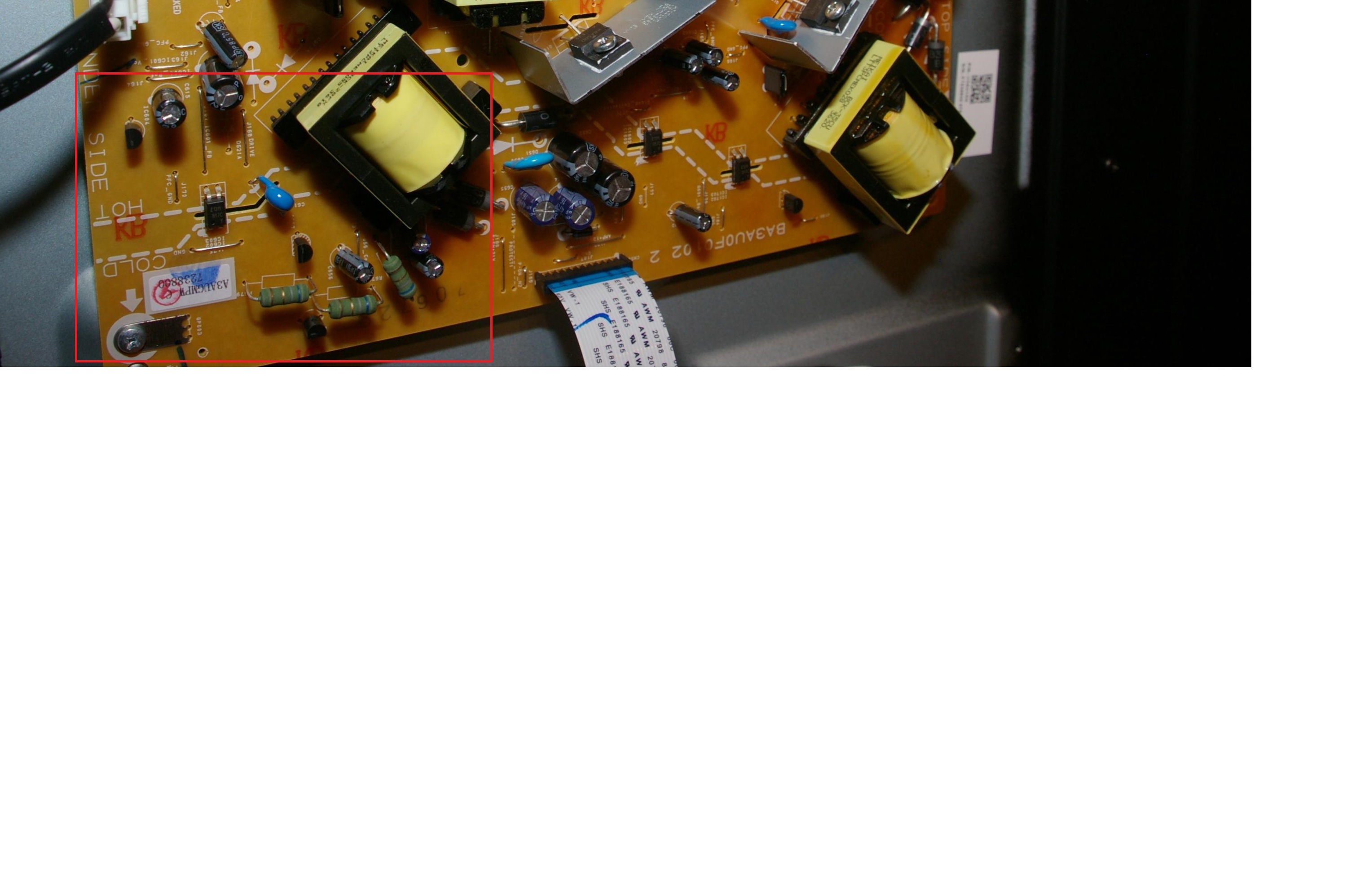

                      I'm dealing with one of these now with the same problem. I have marked where the noise is coming from on my unit in his photo. I haven't had the opportunity to check too much of it out yet. Seems what is marked AMP+13v only receives 6.5v and the P-on+21v only receives 11.3v on this supply. This is with nothing else connected to the power supply. I can take better photos tomorrow if needed.

                        sounds like a bad cap, a feedback problem of the 21V/12V rail or the PFC. Search badcaps for "emerson" there are tons of threads.
