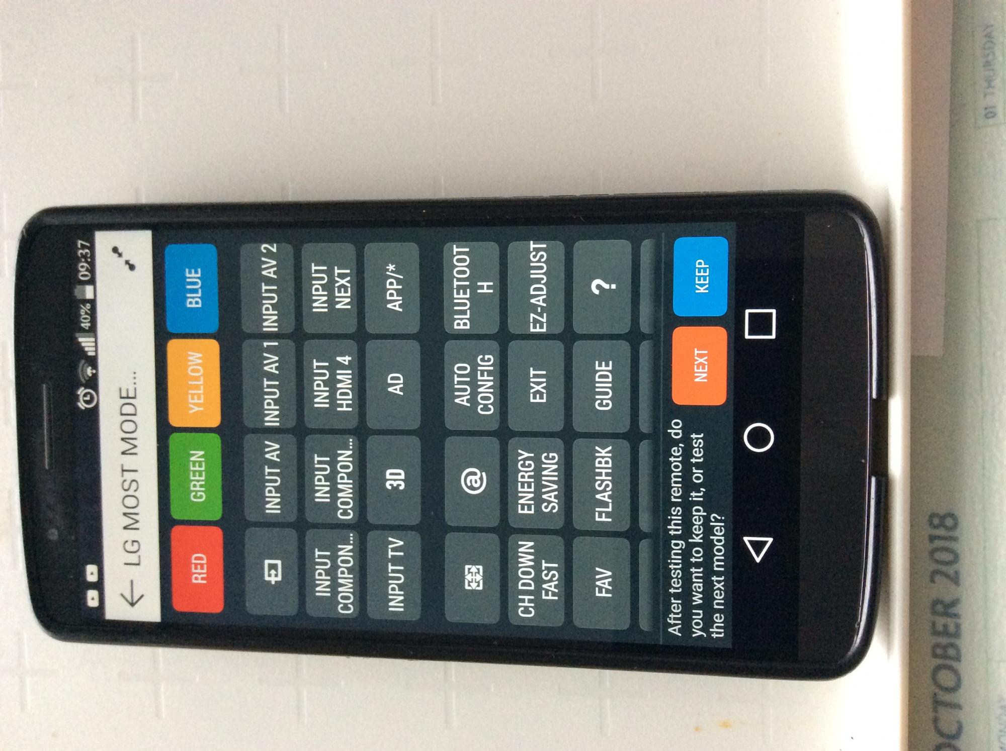

                I had a 42” smart LG 42LS575T it had the image upside down paid £35 for it and thought its worth a try, used my phone (Android) and went onto google play store and downloaded an app called “ ANYMOTE “ smart remote app, opened it up once downloaded searched for LG let it do its thing, then you will see
                (pic-1) .........

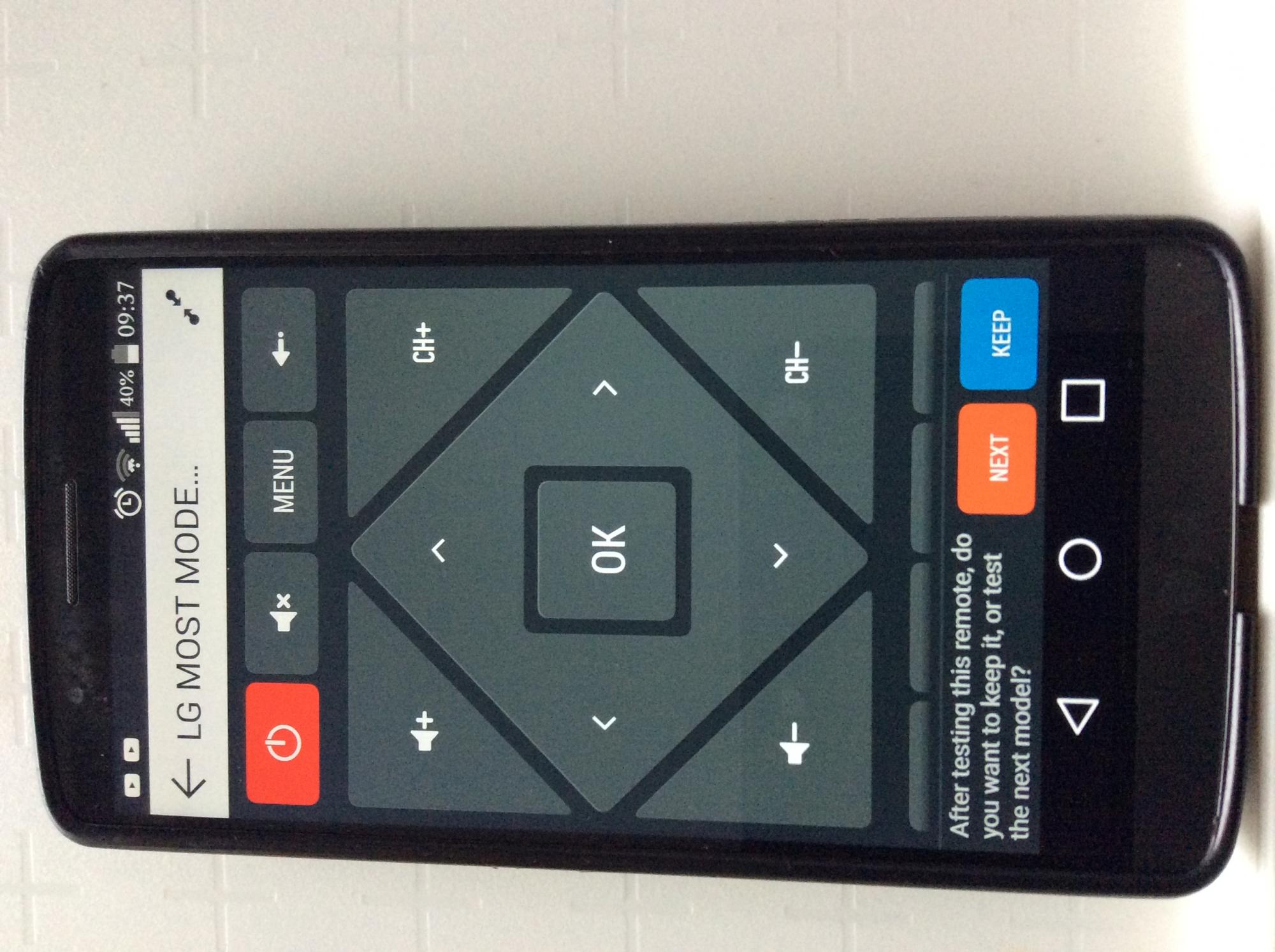

                Then grab the right nav arrow on screen and swipe to the left then you get
                (pic-2) ........
                Then press “EZ-ADJUST” then follow the instructions on this YouTube video passwords vary but (0413) seems common enough
                https://youtu.be/56GzjTsdeyg
                You may need the normal LG remote.....
                all the above is for those like me with no LG service remote...
