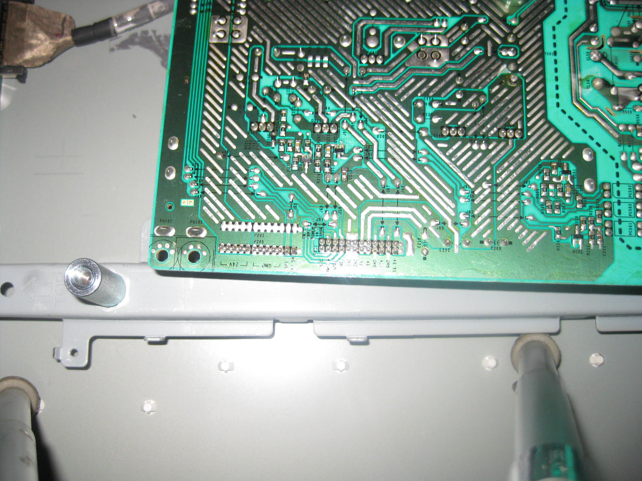

    I am having a hell of a time getting a clear image of this for some reason. But if you zoom in this picture you can see the pin names match the front. The ACD is the 4th pin and retesting showed 0. I can't unhook those two cables on that side to center this power supply for a better picture.

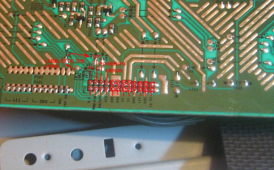

      See that chart for the 4 pins?

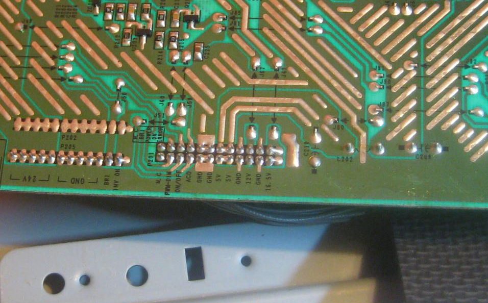

        Now I see what your after and the discovery came too late, my camera battery died. lol I was able to grab 2 more shots before it did. If these aren't good after zooming in I have to wait about 30-45 minutes for the battery to charge to try again.

          So now you have ALL the pin names, and now you can test all the Voltages of all the pins (except GND pins) from the top side since you can see what those 4 pins are now.
          You must provide the pin names and follow by the Voltage readings, you can skip the GND pins.

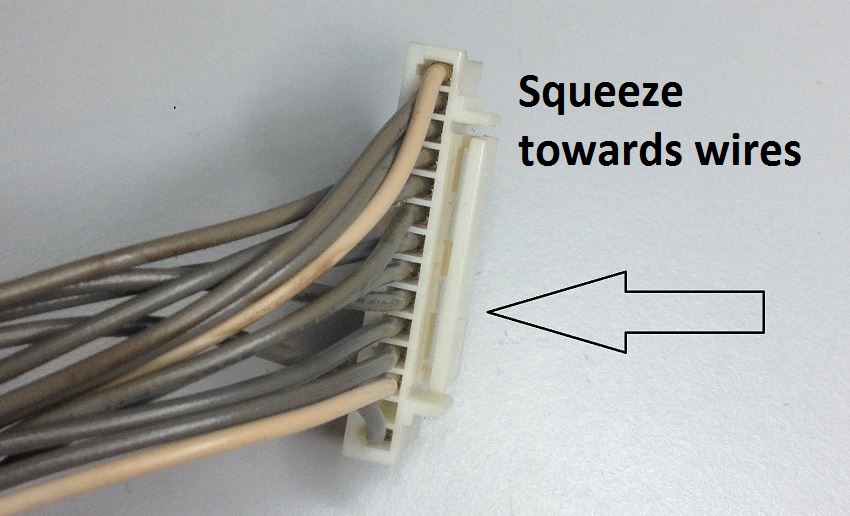

                  In the meantime Stormyme, grasp the white connector across its body and pinch it hard. That should release the clip holding it tightly in place so that you can pull it out of the socket.

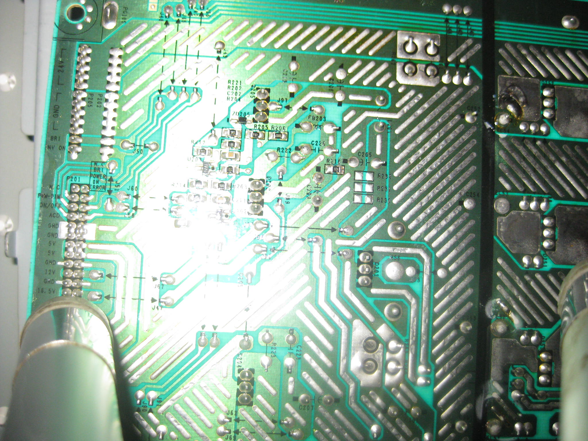

                                      It's a pity I can't find the schematic for the power supply. I've seen quite a lot of posts saying the resistors in series tend to be a problem.
                                        #79
                                        Re: LG42lg50 UG power on and off
                                        there is one in one of my posts but its hard to read you can just make it out with a magnifyer glass so not much good.
