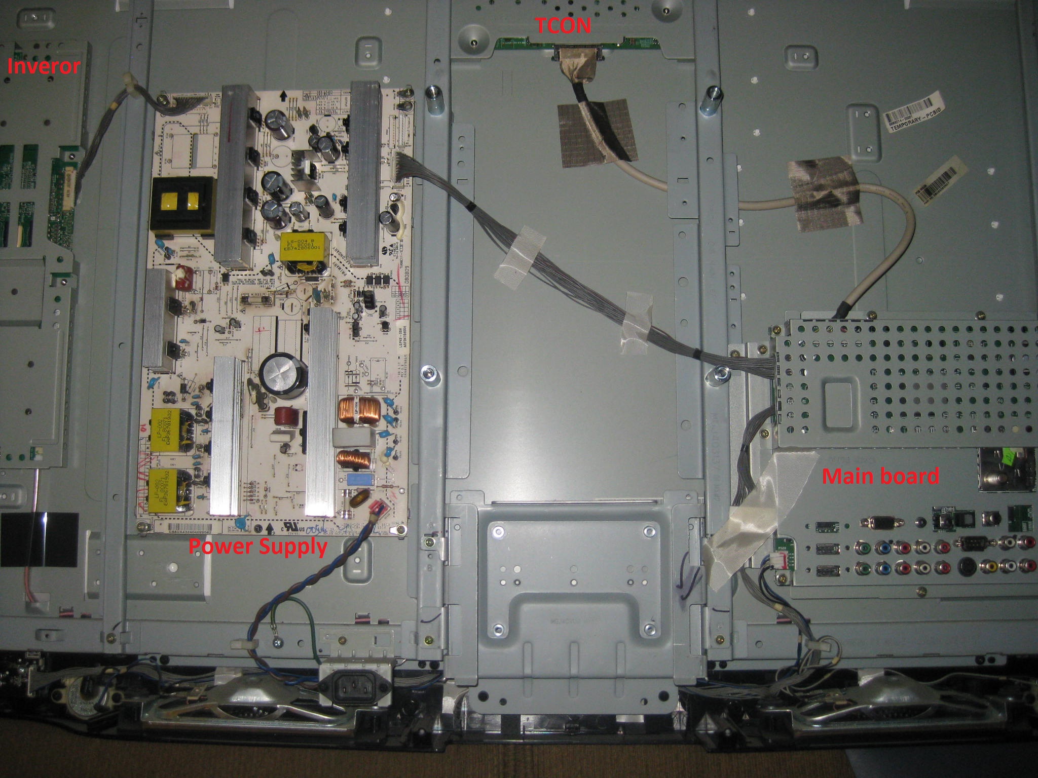

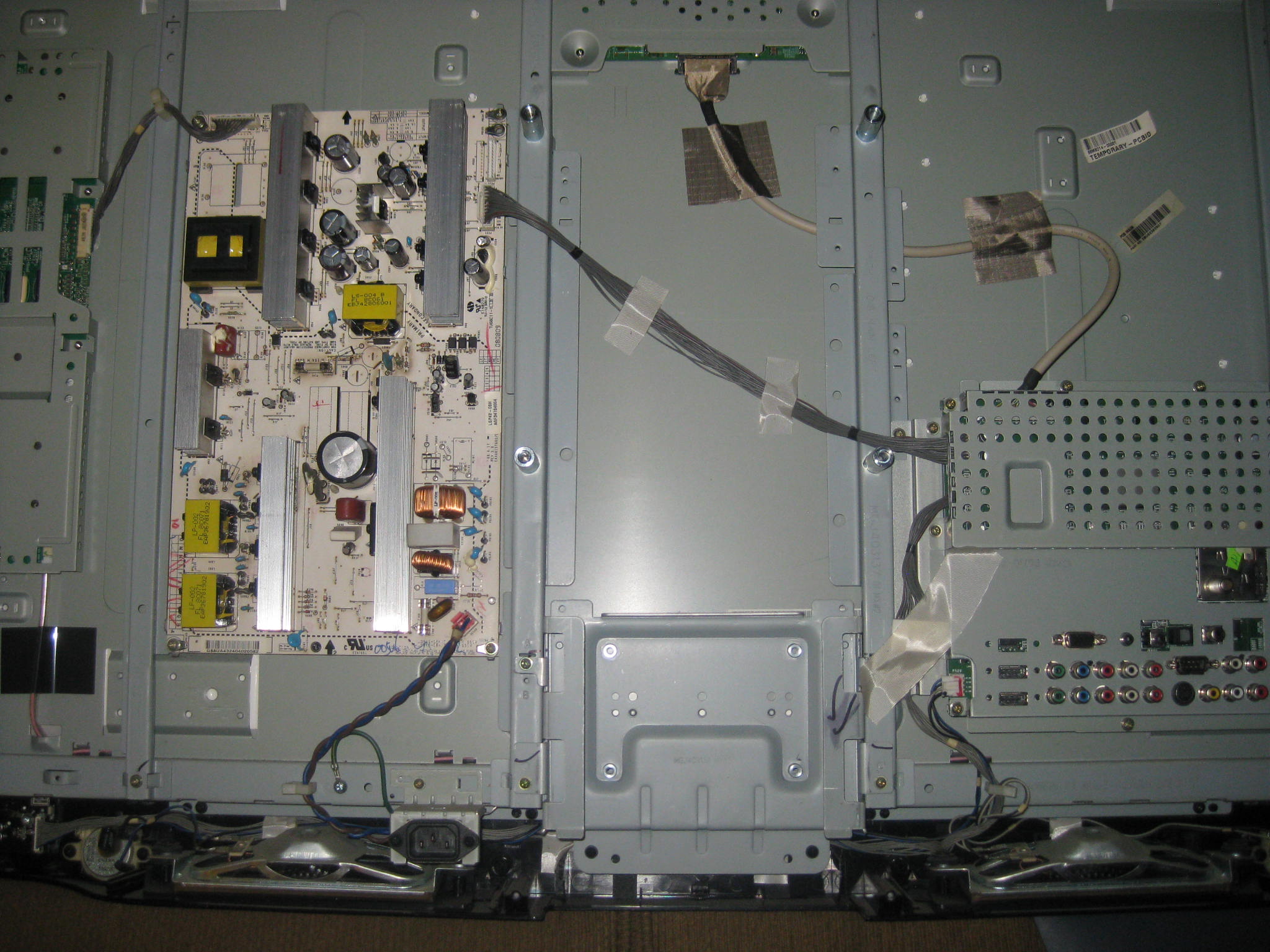

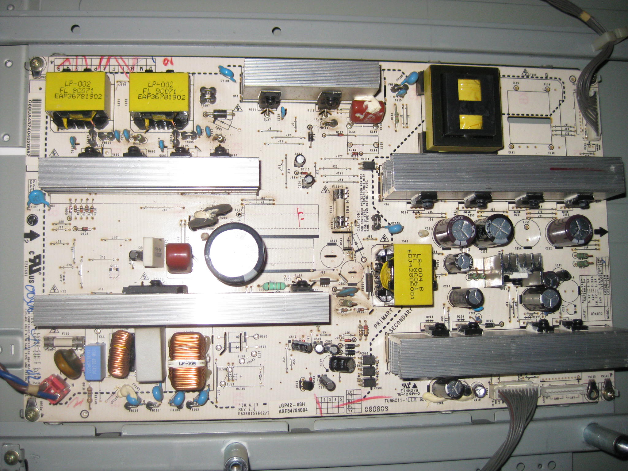

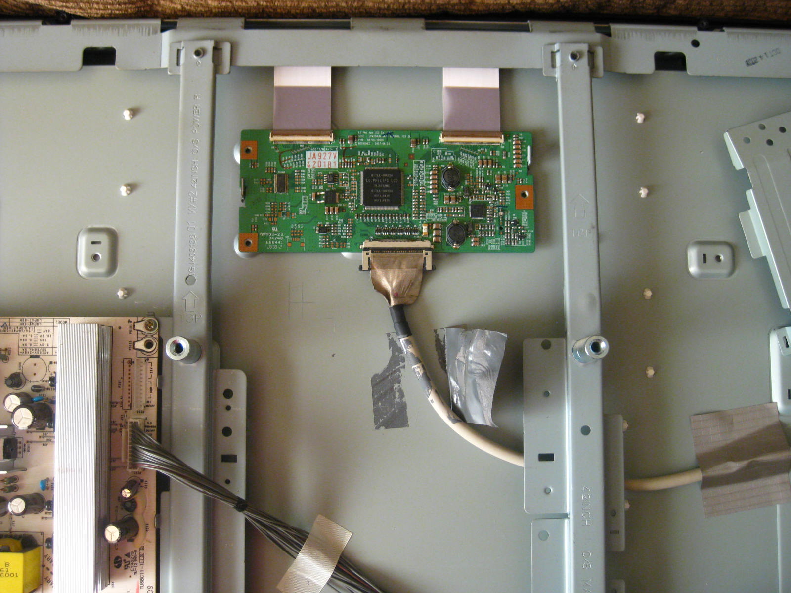

    I am about to order a new power supply for my LG 42 TV and wanted to get a second opinion before I do. The problem I am having is , I recently hooked up a PS3 to my tv and after a couple months the tv started to power down and flash on and off with "No signal". Occasionally it would start up after being shut down as well. I replaced the power cord and HDMI cable in case that had anything to do with it. I also did a reset. From what I have read all over it sounds like its the power supply. I have attached a few snapshots and an AVI of what it is currently doing. The AVI is dark because I wanted you to see the lights on the tv lol The first jpg shows model of tv. Does this sound like a power supply issue? Can I test the boards to narrow down which one?
    I guess I can't upload the avi. I am trying to improve the pictures. It is 4 am here though, so 1 at a time lol

    Does it atually "shut down" or is it just losing the signal? If it's flashing "no signal" it is not shut down.
    Have you tried other input sources? (other hdmi port, rgb, coax)
    Let's see a pic of the whole backside of the TV please.
    IMO this sounds like it could be a main board issue.

      It goes into standby mode for a second then flashes "no signal" and continues to do that. I switched HDMI ports and it fixed it for a day, then it did the same thing. When I would hold the power button down on the tv for 5 seconds, it would fix it for about an hour. I felt the back of the tv for overheating and nothing felt warm. I turned off the PS3 and set the input to antenna and that worked for a couple hours.

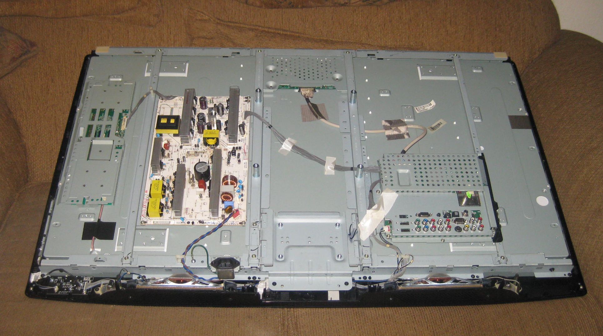

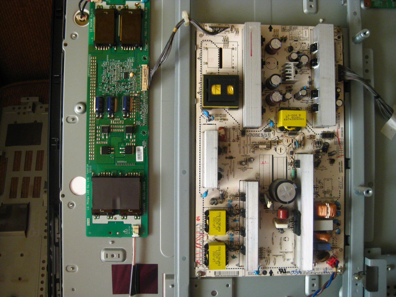

      Its a very large tv, I hope these pictures are what you were after. I had to back a distance to get the whole thing in the window

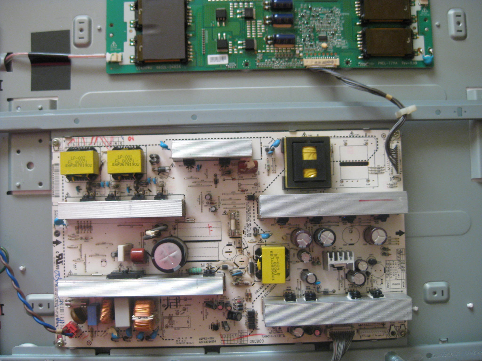

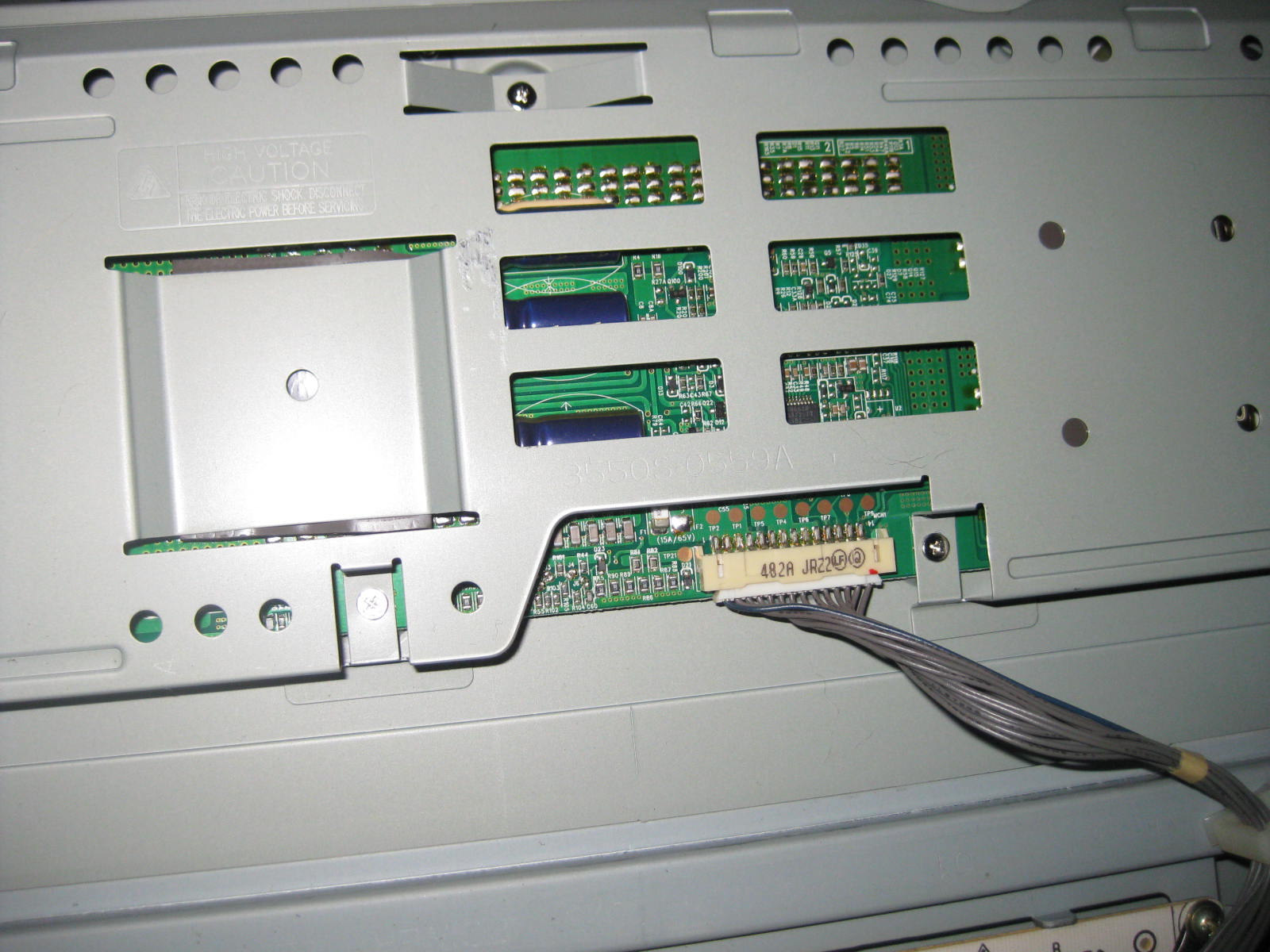

        What are the voltage readings on the edge connector? I can't make out what the board number is but it's alongside the 24V supply connector.

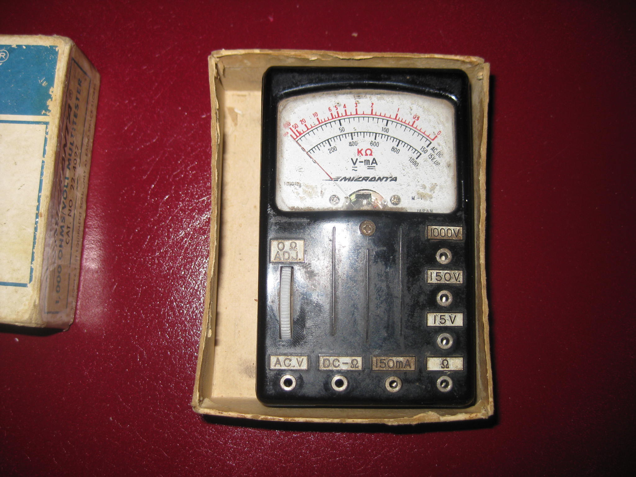

          Brace yourselves for some vintage, but can I use my fathers old meter for this? see picture below. If so can you refresh my memory on where the red and black wands get plugged into? lol Sorry it has been a while since I have used it.

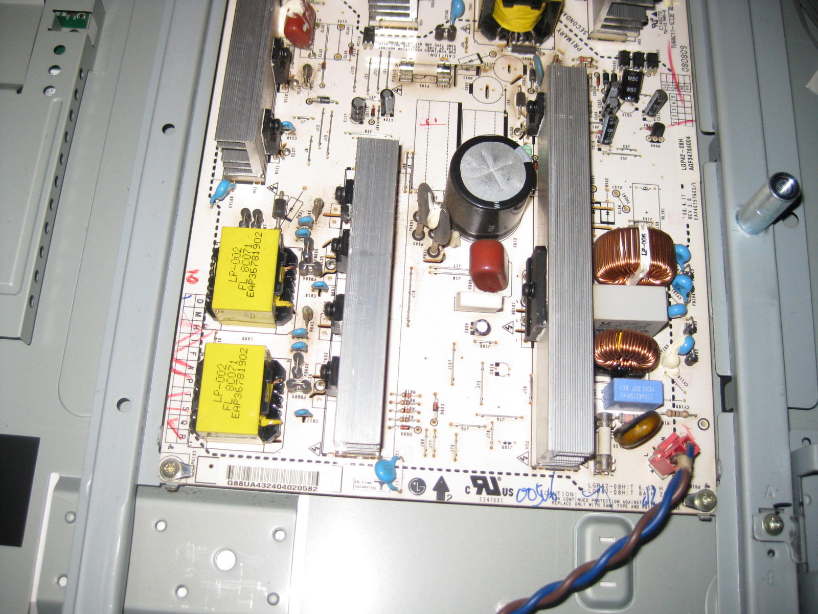

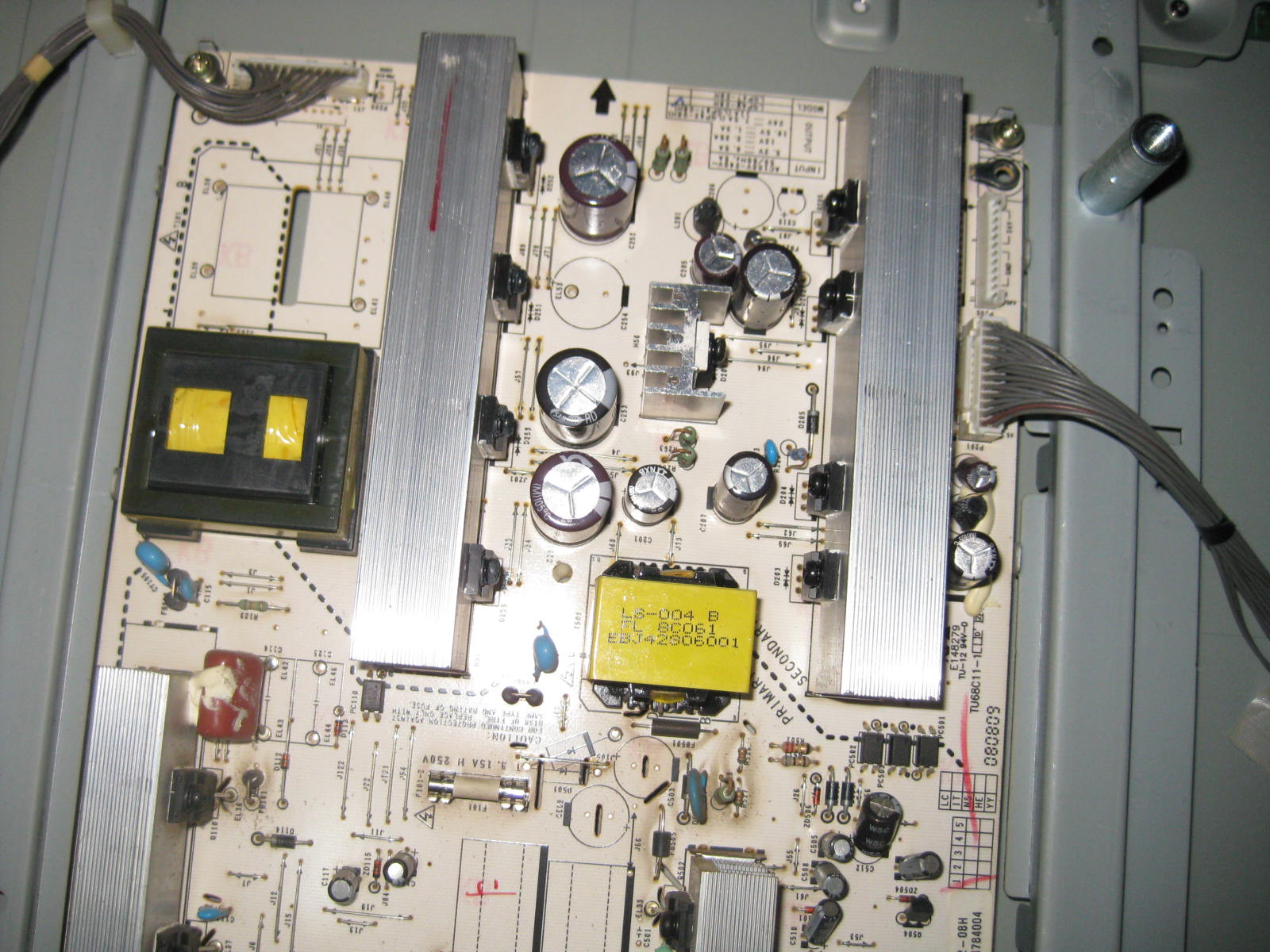

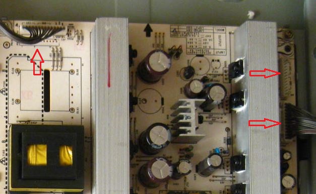

            Which connector were you wanting tested? I have attached closer images.

                Your power supply board shown on the 1st picture right hand side has connectors. Top left and top right. Normally they have a legend along side saying what the pins are and / or what voltage should be on each pin.
                If you can test those connections it may give a clue as to what the problem is.

                    So which one is the Motherboard? The T-Con or Inverter?

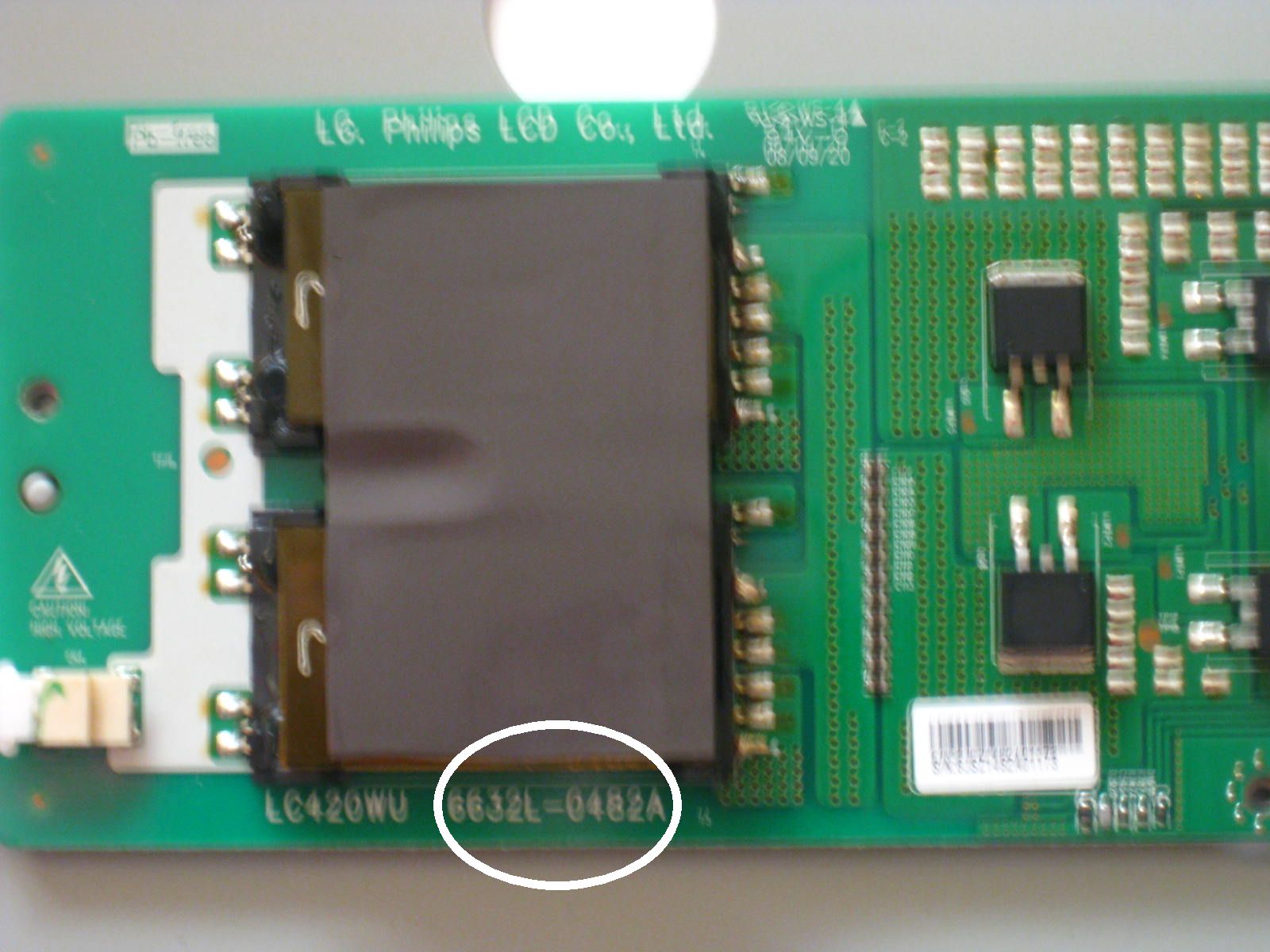

                        So the inverter board is the board they are calling the motherboard? If so is the number I have circled in my picture, the correct part number on my board?

                          Example of main board (mother board if you want to call that) where HDMI circuits are and other inputs.
                          http://www.shopjimmy.com/lg-ebu49009...ua-bushljm.htm
                          Inverter board is Inverter board.

                            Black lead on metal chassis. Red lead to read dc voltages on connector.
                              Re: LG42lg50 UG power on and off
                              I hope he is not going to use that Old Micronta meter with 1000 Ohms per Volt.

                                She won't now that you said something I have my sister bringing hers over tonight.
                                  Did you look at the link to SJ?
                                  Yes I did and it took me to a page of inverter boards.
                                  I did not know there was another board hiding under these three I see.
                                  Thank you for clearing that up.

                                      My brother dropped off his Radio Shack Auto Ranging "LCD Digital Multimeter" CAT no. 22-163. Will I be able to test the edge connectors with this? I would love to move forward on this today if I can.

                                        It looks as though it should do the job. Black lead (-V) on chassis, red lead (+V) to test voltages along edge connector. Set meter to 20V DV or higher as needed. Be careful as there are high voltages on the HOT side of the power supply which can be lethal.
