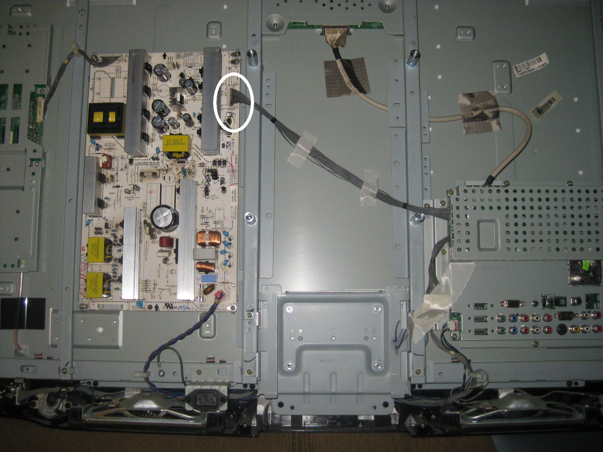

    Re: LG42lg50 UG power on and off

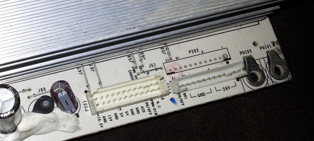

    Ok I have tested the one connector that runs from the power supply to the main board. I have attached pics of my meter settings, the connector tested is circled in white and the results. That was scary good for sure lol I like this fix it yourself stuff lol
    Awaiting your next instruction
    I forgot to add that the tv was powered on when I did it.

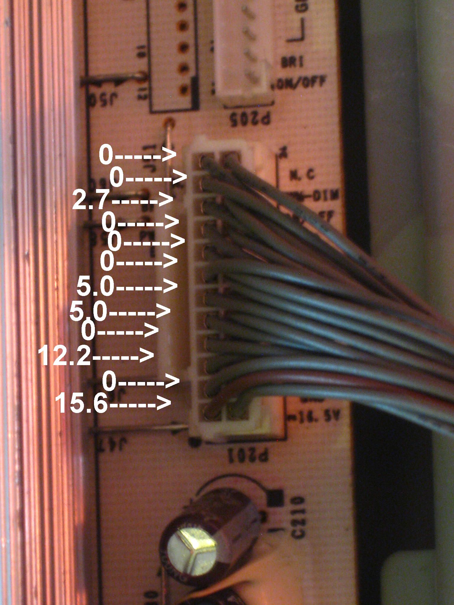

                in post 21 last picture it looks like you have only tested one side of the connector looking at the picture ive uploaded it looks like you need to test both sides of the connector and take voltages.

                      #30
                      with your black multi meter probe on metal tv chassis get the red probe and place down the side of each wire there a metal pin on the end of the wire so you should get a reading ok maybe do the left hand side of the connector first starting top to bottom then move to the right hand side take voltage readings of all pins (hope that makes sence)

                          • Stormyme
                            • Mar 2016
                            • 52
                            #33
                            The right side of that connector results
                            0
                            0
                            0
                            04.1
                            04.1
                            0
                            5.0
                            5.0
                            0
                            12.2
                            0
                            15.6

                            • Stormyme
                              • Mar 2016
                              • 52
                              #34
                              Stormyme - Can you also check you still have 24V on the other connector after the screen goes blanks.
                              Vinceroger69 - I'm wondering if it's a backlight fault.
                              Results are
                              24.3
                              but when the back light flashes it reads 23.8

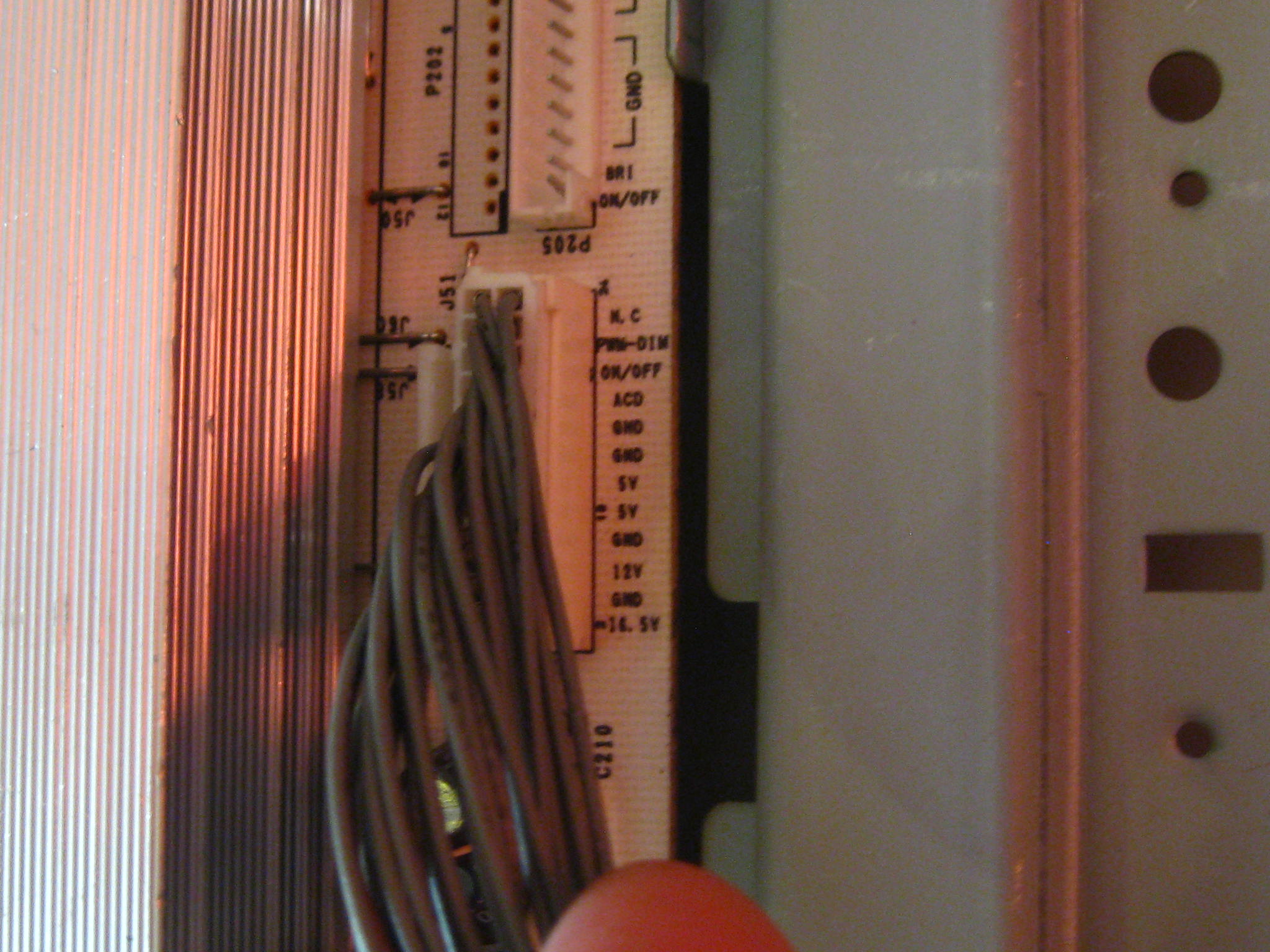

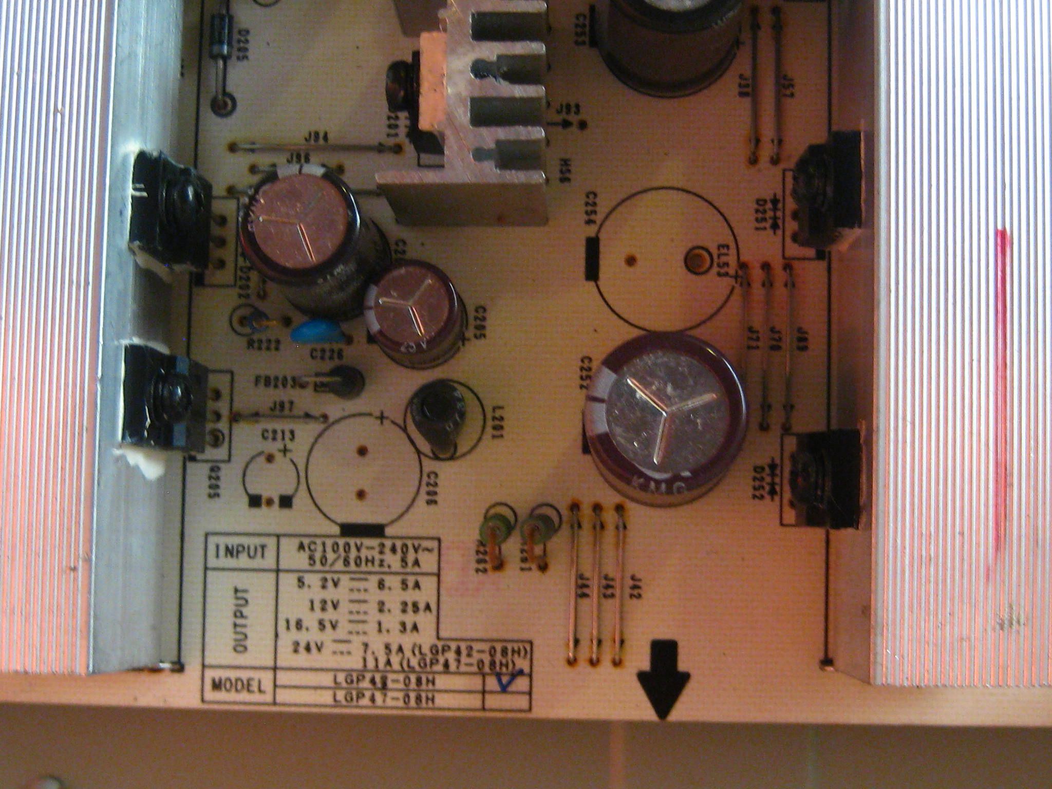

                                  #36
                                  There are only 11 in your list but there are 12 pins on that side. Can you retest and send.
                                  Can you take a picture of the P201 with the cable removed so I can see what the legends are written at the sides.
                                  Looking carefully at the back of the set when you switch on, can you see the screen lights shine through some of the holes in the chassis, and does the light stay on.
                                  Is the 04.1V = 4.1V or just a low reading 04.1mV??

                                    #37
                                    "Yes correct. Flashing "no signal" as if it were trying to power up from stand by." That means the power supplies are on to provide the 24VDC for the inverter circuit to have backlights to see the "NO SIGNAL' on the screen and the main board is getting the Voltage to run to send the signal to the T-CON to show'NO SIGNAL' on the screen. It will go into standby after 5 seconds or 2 minutes (depend on the TV) due to lack of video signal.
                                    If you look at the power supply connector on the bottom side of the board you will see more labels for the pin of that 24-pin connector.

                                      • Stormyme
                                        • Mar 2016
                                        • 52
                                        #39
                                        I corrected the results above to add the missing result.
                                        What happens when I plug the power cord in........a blue light comes on on the T-con board, then I see the red stand by light come on. A white light flashes when the red light flashes. The tv is laying face down on my couch so I'm seeing all this from the back.

                                          #40
                                          I am having a hard time removing the connector. I hope these two images give you what you need.
