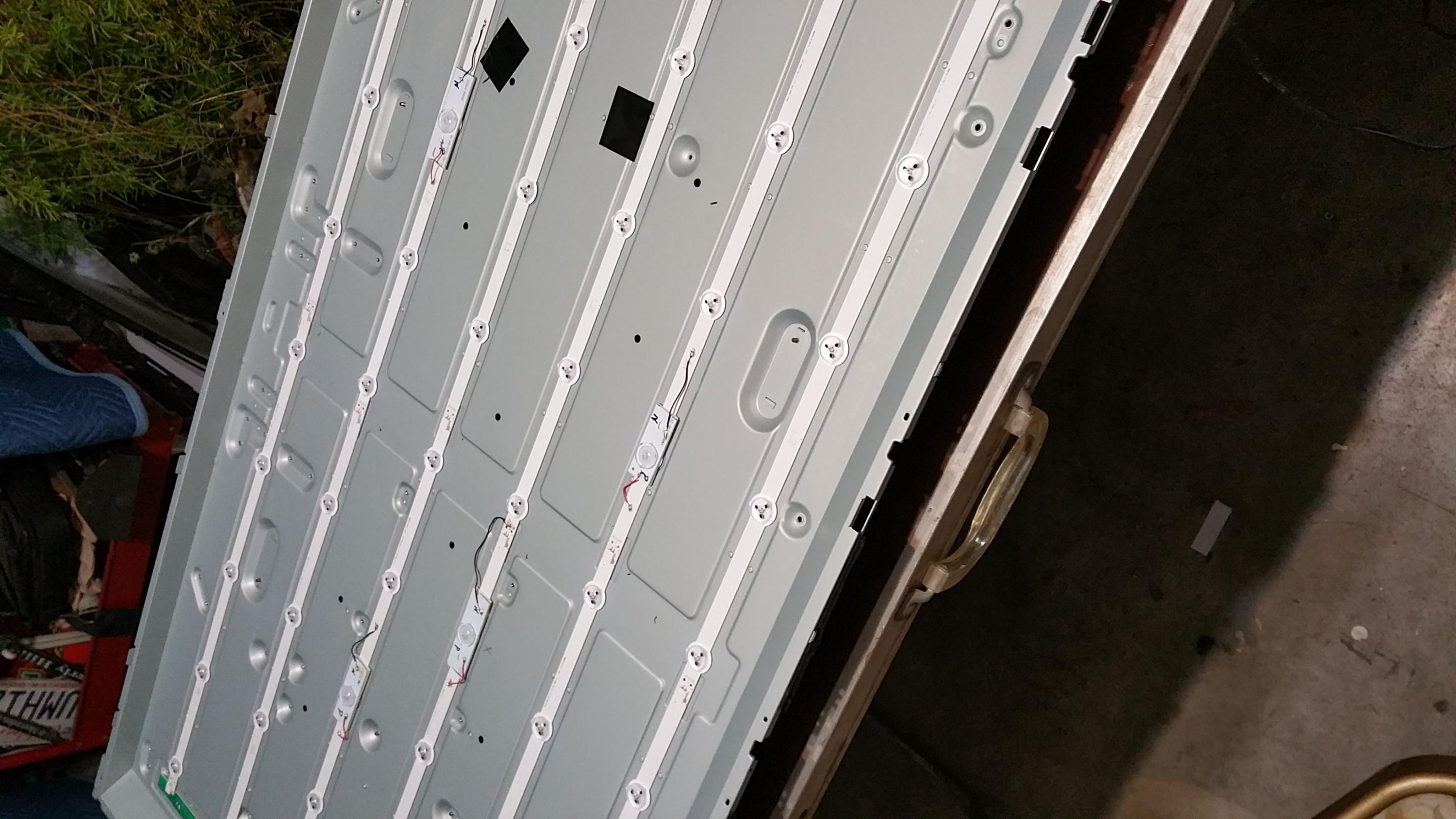

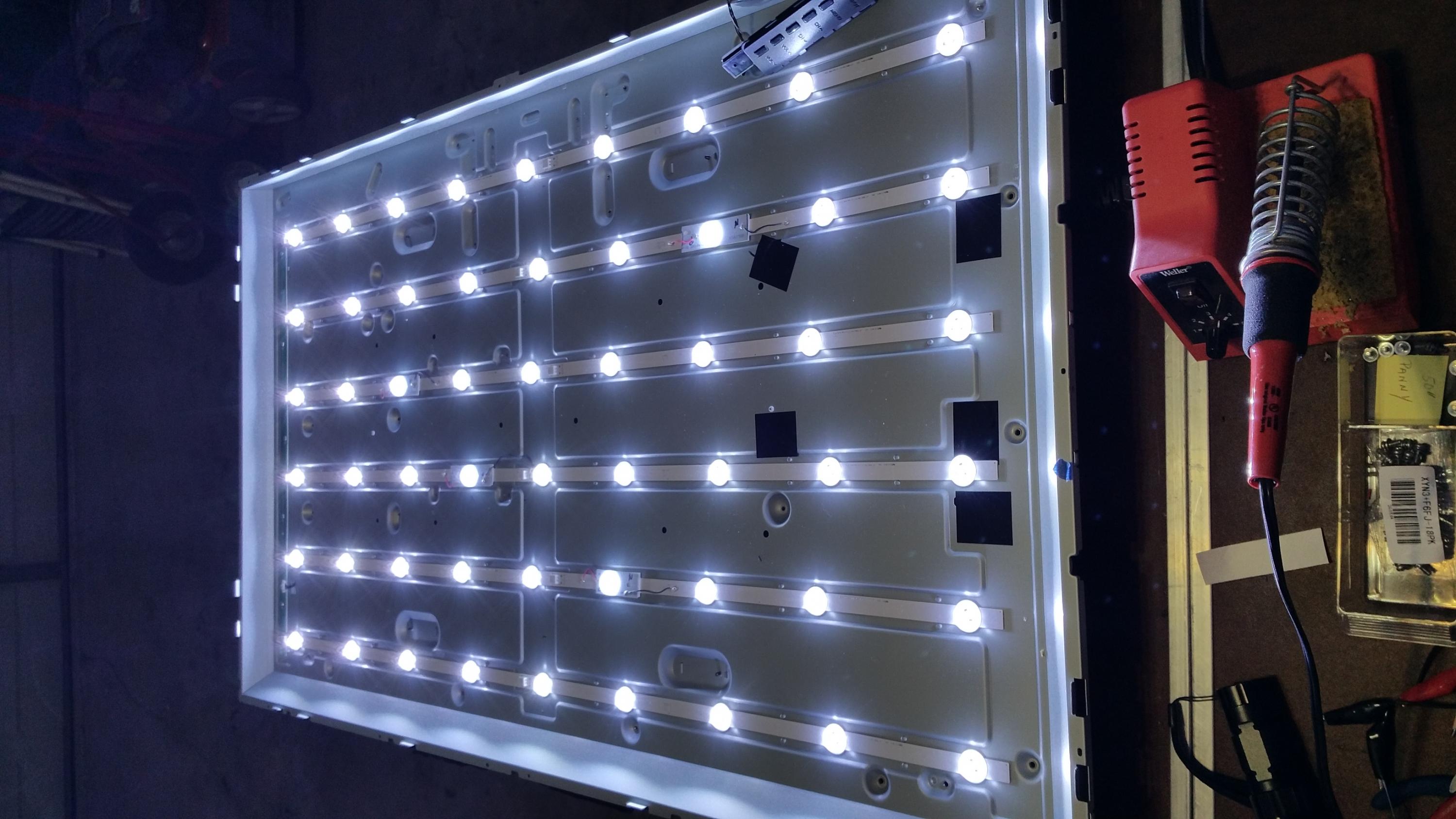

                  Saw this post awhile back and thought I would try the stacking method on a vizio 47" I had laying around. Tested individual leds and had four that had failed. Took some leds off a new 32" seki with broken screen and used double sided tape to secure. Will be interested to see how long it lasts before another fails. Will use TV as a backup if my Panasonic plasma breaks down. Thank you all for giving this old man the courage to give it a try.

                    #29
                    Re: Led Backlight Stacking Repair Video
                    Isn't that what it's all about
                    Congrats on the successful repair

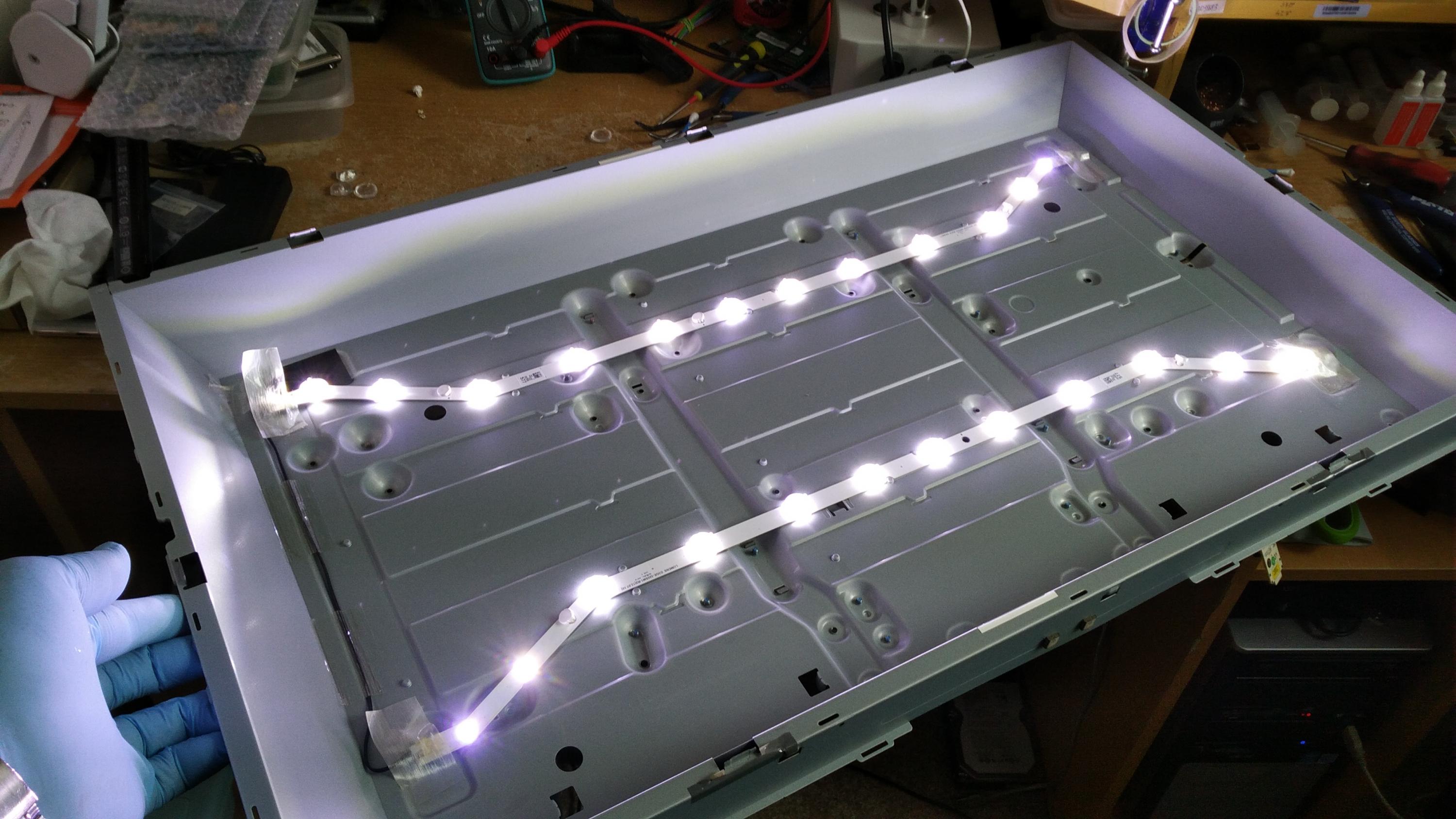

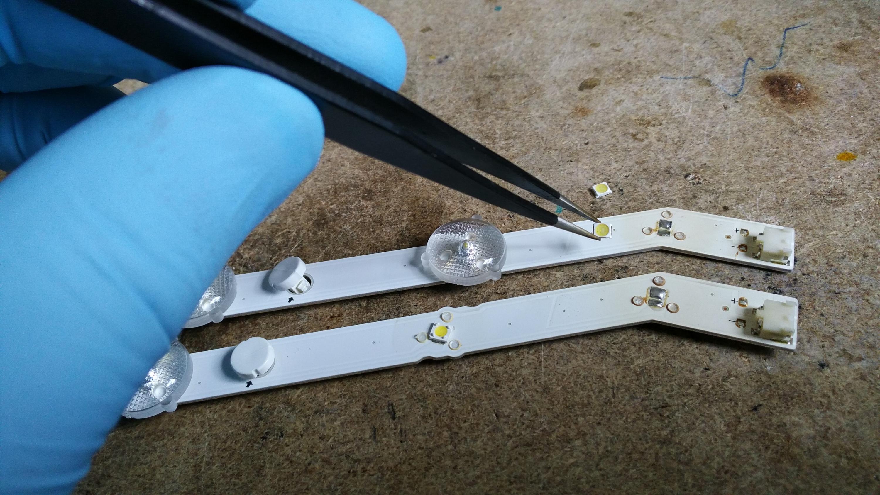

                                  I did my first LED swaps on a Toshiba 40" yesterday.
                                  I replaced rather than stacked. Used hot air to remove and replace and it went well.
                                  The trickiest bit was getting the diffusers stuck back down at the correct height.
                                  I used a piece of cardboard to hold them at the correct height whilst the super glue gel dried.

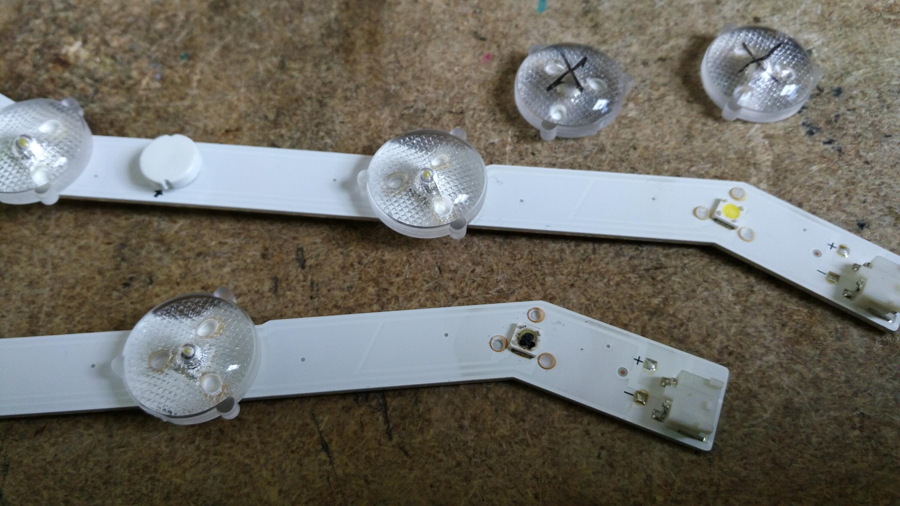

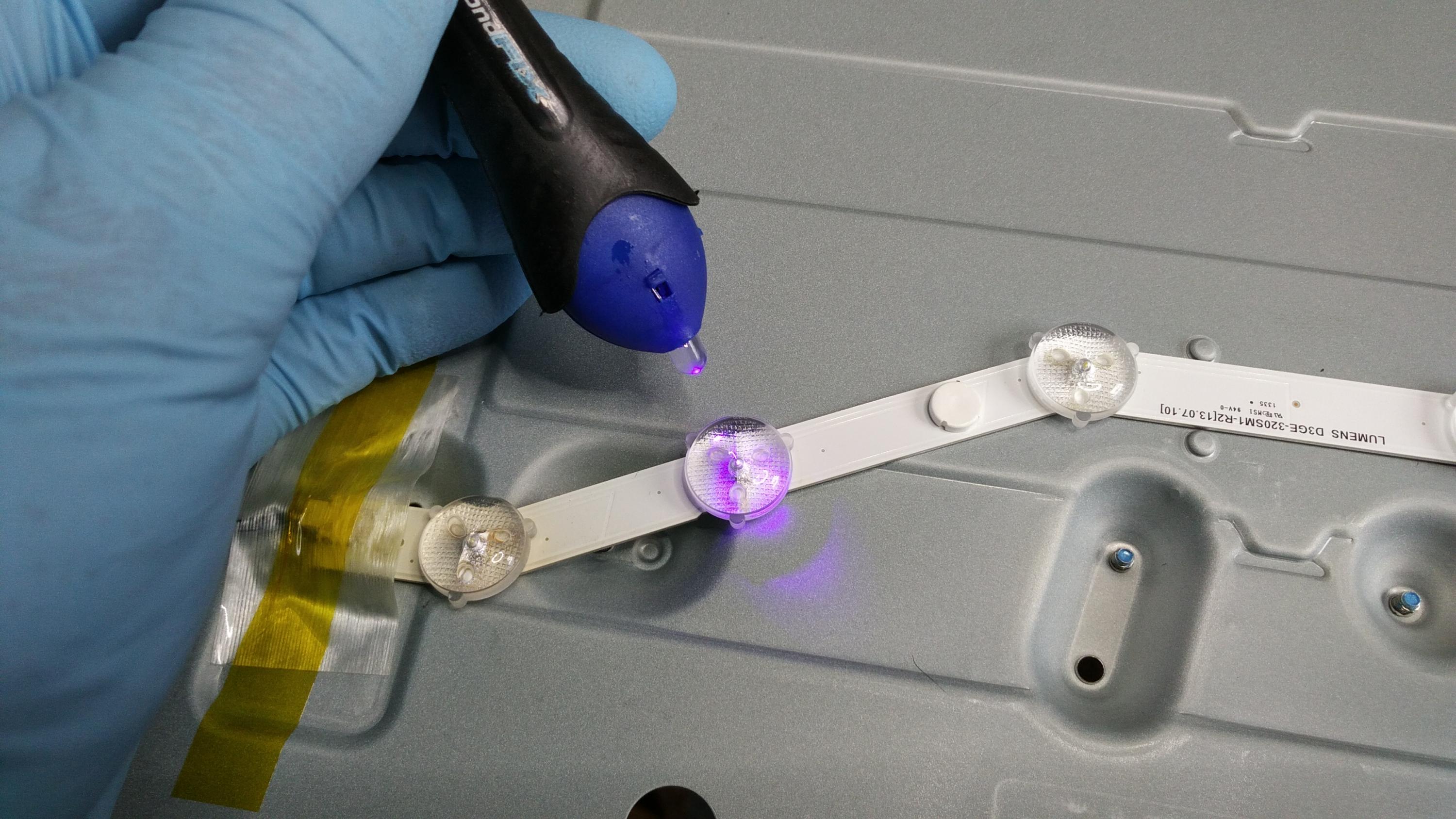

                                        Just finished BL repair on Samsung UE32EH5000K today. Done with hot air and hardly fixed with 5secondFIX glue. BL settings down to 30%. Should last longer...
                                        • dskall
                                          • Oct 2016
                                          • 2905
                                          • usa
                                          #40
                                          What glue did you use for lens?
