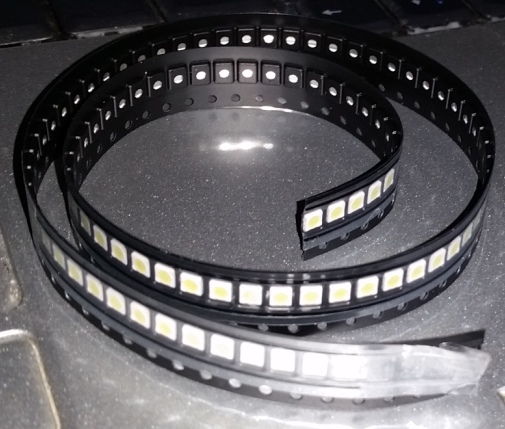

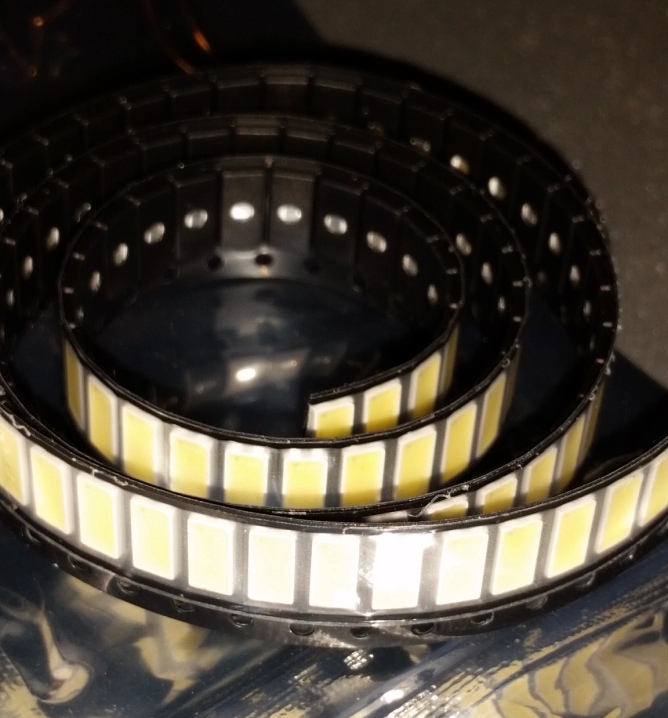

                                    I tried some of those LEDs....
                                    They made bright Yellow Splodges on the screen--Even though supposed to be 8000k LED's
                                    Completely useless! Got 200 of em--Anyone want 'em!
                                    Gone back to cutting up old strips and sticking in place of originals--'legal' or not!!
                                    --You'll be saying you cant use leaded solder next!....
