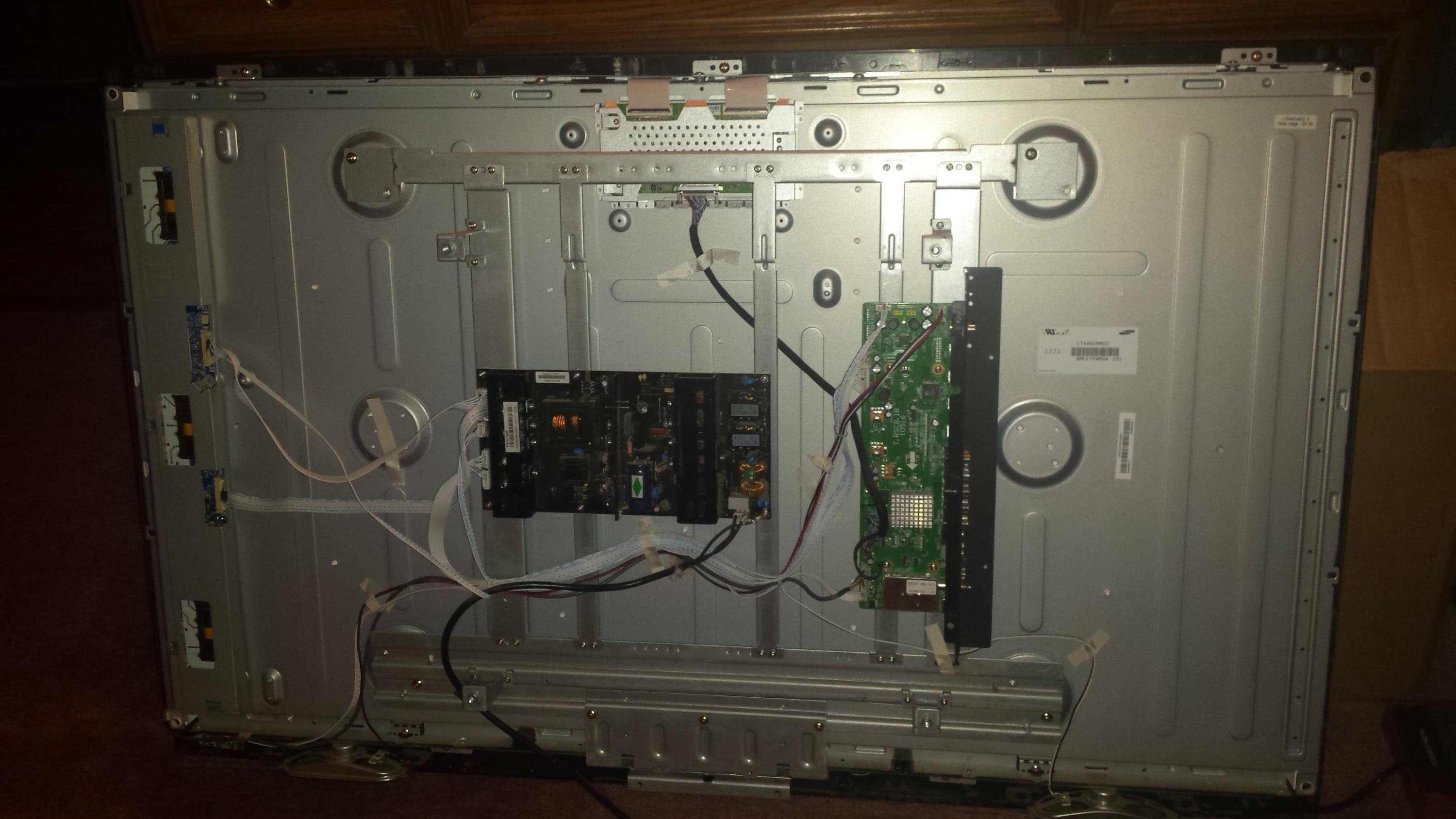

      I don't have a remote for it. When turned on, the led turns blue and the back light comes on. I also noticed a faint buzzing from the inverter board (which might be normal). I haven't checked the power output but I'm sure I could with some basic instructions. I am familiar with a multimeter but usually use it on cars.
        Re: RCA TV no picture, replaced all boards. Backlight ok
        Where are the pictures of the whole back side of the TV so we can see all the boards?
          yes,pics from whole back and a close up from the T-con board.

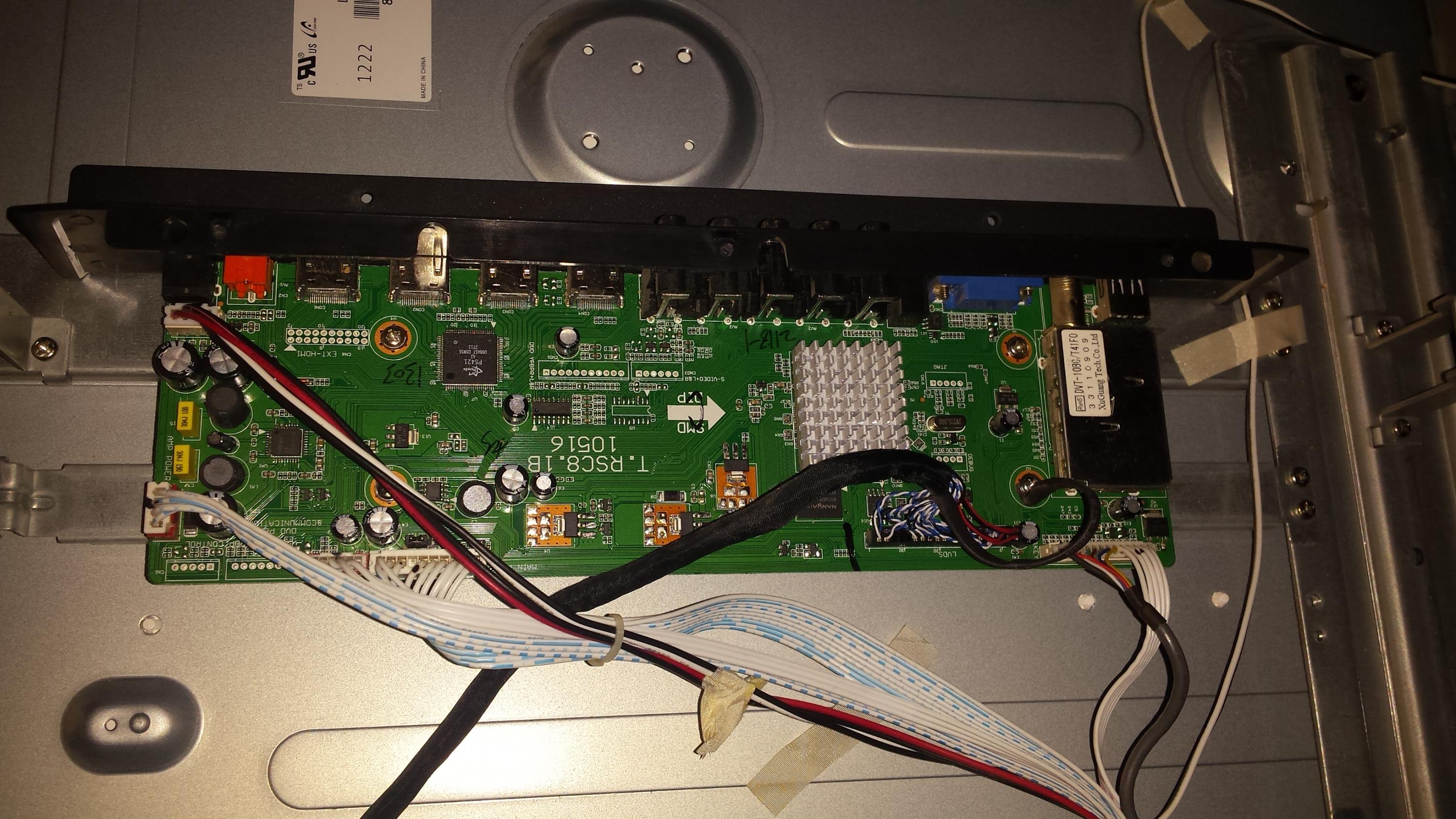

            Here is the overall picture. The tcon board requires some disassembly to get to so I will try to get a picture when I have time tomorrow.
              You will need to find out if you get DCV at both ends of the SMD fuse on the T-CON board with ref. to the chassis GND.

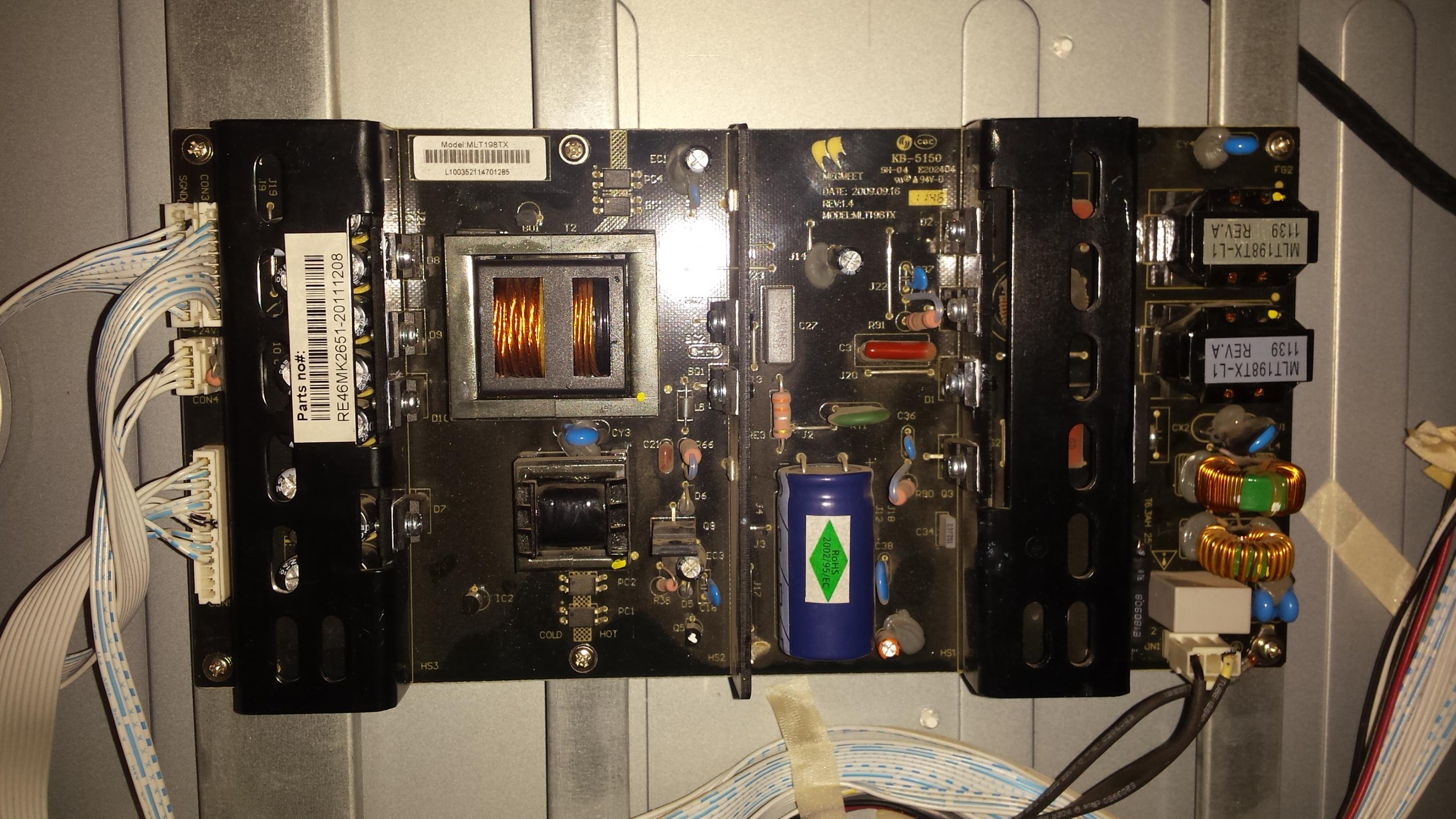

                          Update:
                          I found voltage markings on the power supply (next to the connector to the main board). All of the pins had what was written (5v or 12v respectively). I then followed that cable to the main board and checked the voltages again. I found 4 pins with 5v and 1 with 12v, so everything seems good there. I then checked the voltages at the LVDS cable at the TCON board. There was nothing higher than 1.4v on any of the pins.
                          So I suspect the main board is no good, but is there anything else I can do to confirm this?

                            I would measure the voltage of the lvds cable at the mainboard side,then unplug lvds cable and measure again,see if its the tcon dragging the 12 volt down or not.Or a break in the cable itself perhaps.

                                  If there is no +12V on the Tcon then you need to find the reason why. There is an AM1117 (U3) voltage regulator on the main board which may be worth checking out.

                                    I checked the voltage at the main board with and without the LVDS cable connected. There was not 12v anywhere. (The highest was about 2.3v) The cable is not damaged or pinched.
                                    I found the U3 voltage regulator. How could I test that? There are 3 terminals on one side and one large one on the other.
