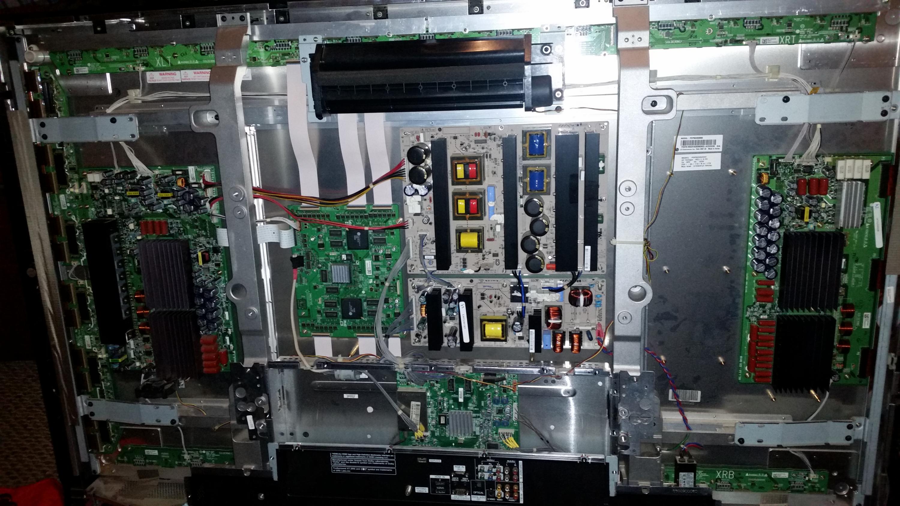

    Lg plasma tv will not power up. 60pc1d

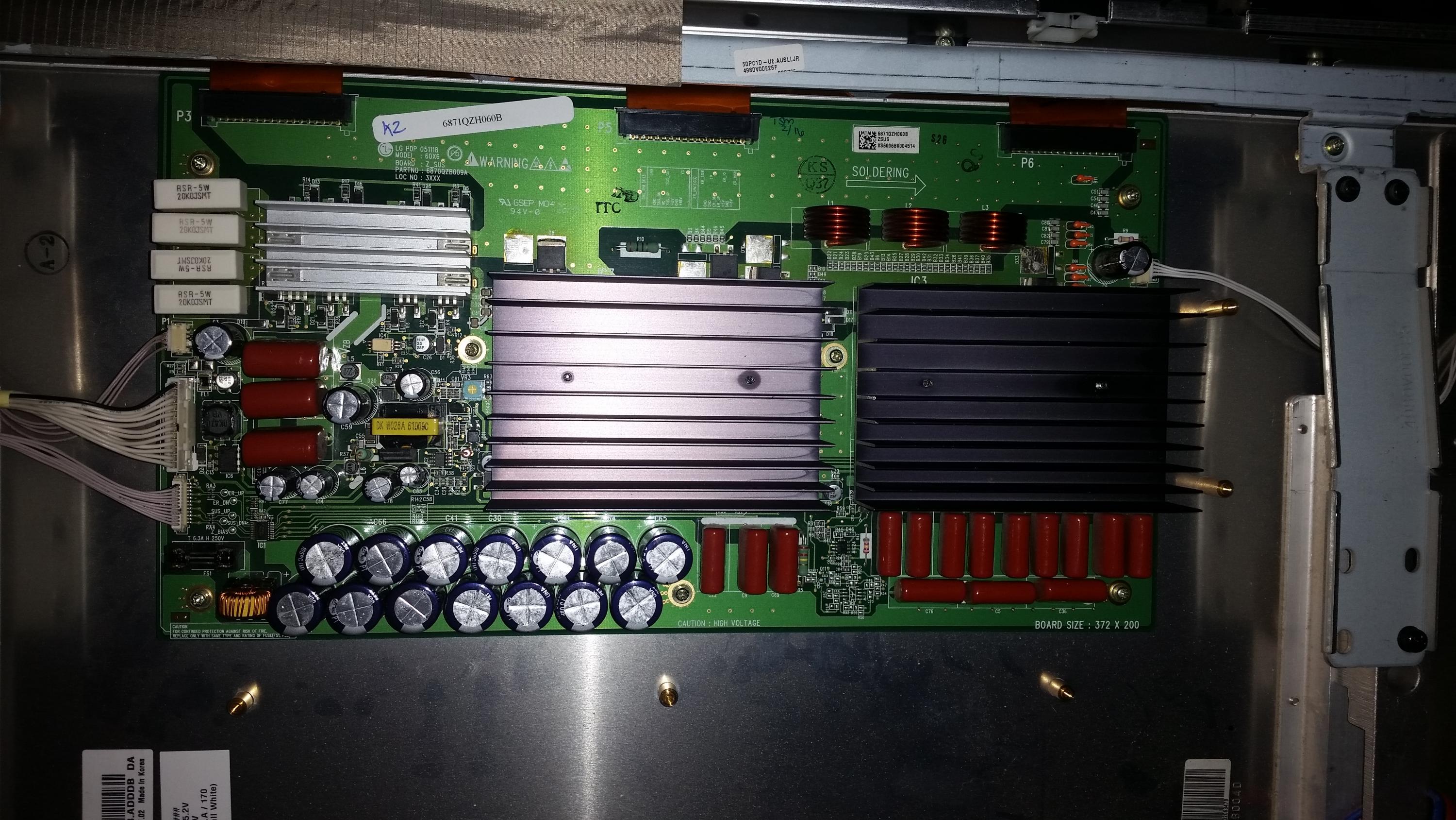

    Hello I have a tv that will not power up. It simply clicks on twice and then two clicks off. I am in need of someone to help guide me on what test points to try with my DMM. I need step by step help with the DMM ie... what setting to select when i test a certain circuit. I have a basic DMM that does not have an audible s/c. Thanks in advance.
    I have spent hours reading through different forums and I am at whits end. What am I missing? HEELLLLPPPP?
    Items Replaced through verified/legit companies:
    1. Power Supply Board
    2. ZSUS Board
    3. YSUS Board
    4. YSUS Buffer Boards (2)
    So, $250 later, my thought is for some detailed component level checks ie... voltages with your help/guidance.

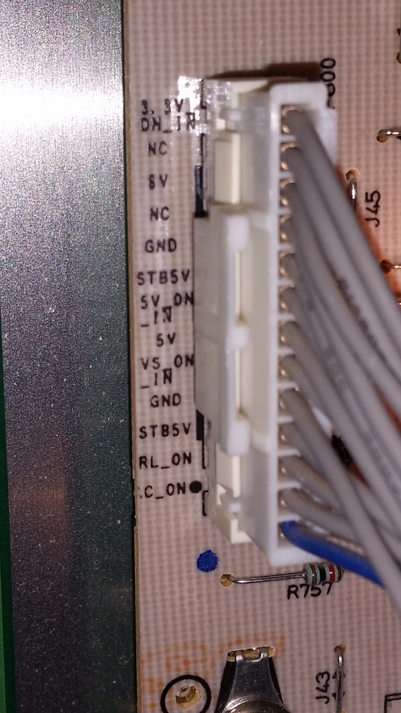

        Re: Lg plasma tv will not power up. 60pc1d
        Its on the main plug from the motherboard to the Psu. Its labeled next to the pins.

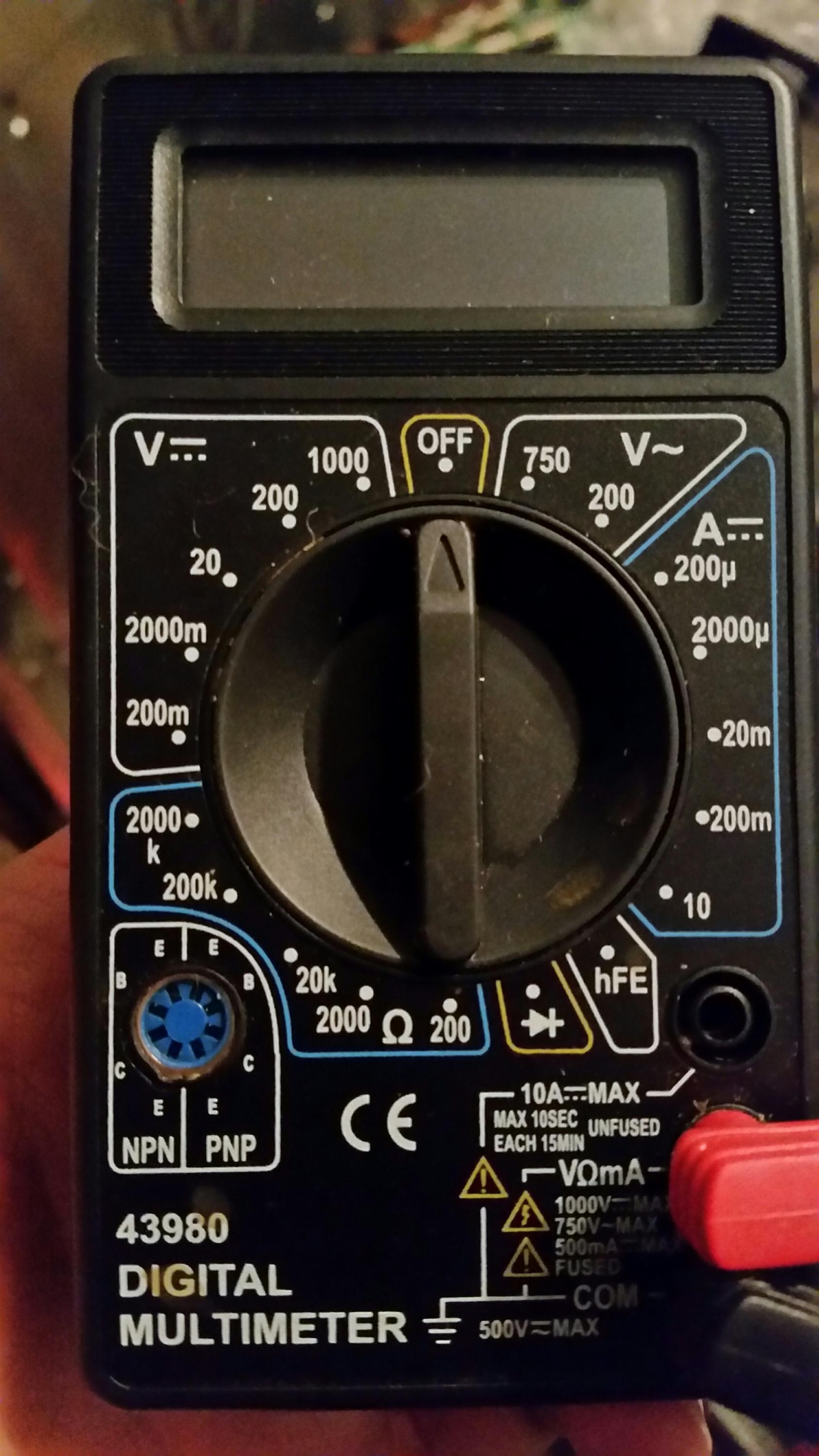

                      I am a novice with the DVM so what setting do choose to check for short. My DVM does not have audible capability so Im not sure how to check thx.
                      • clublex
                        • Feb 2016
                        • 57
                        Originally posted by Alastair E
                        Have you checked the Vs line to chassis for shorts?
                        OK so i put the DVM ON DCV 200 selection and checked the VS Lines (3)
                        Remember the tv clicks on twice and off twice.
                        1.when the tv clicks on the DVM is all over the place.
                        2. when the tv clicks off the DVM shows 23-24
                        The VS label on the tv shows
                        VS= 193V
                        VA= 63V I checked this and its shows to be correct.
                        What do I check now that is seems the VS lines are not showing the right Voltages?

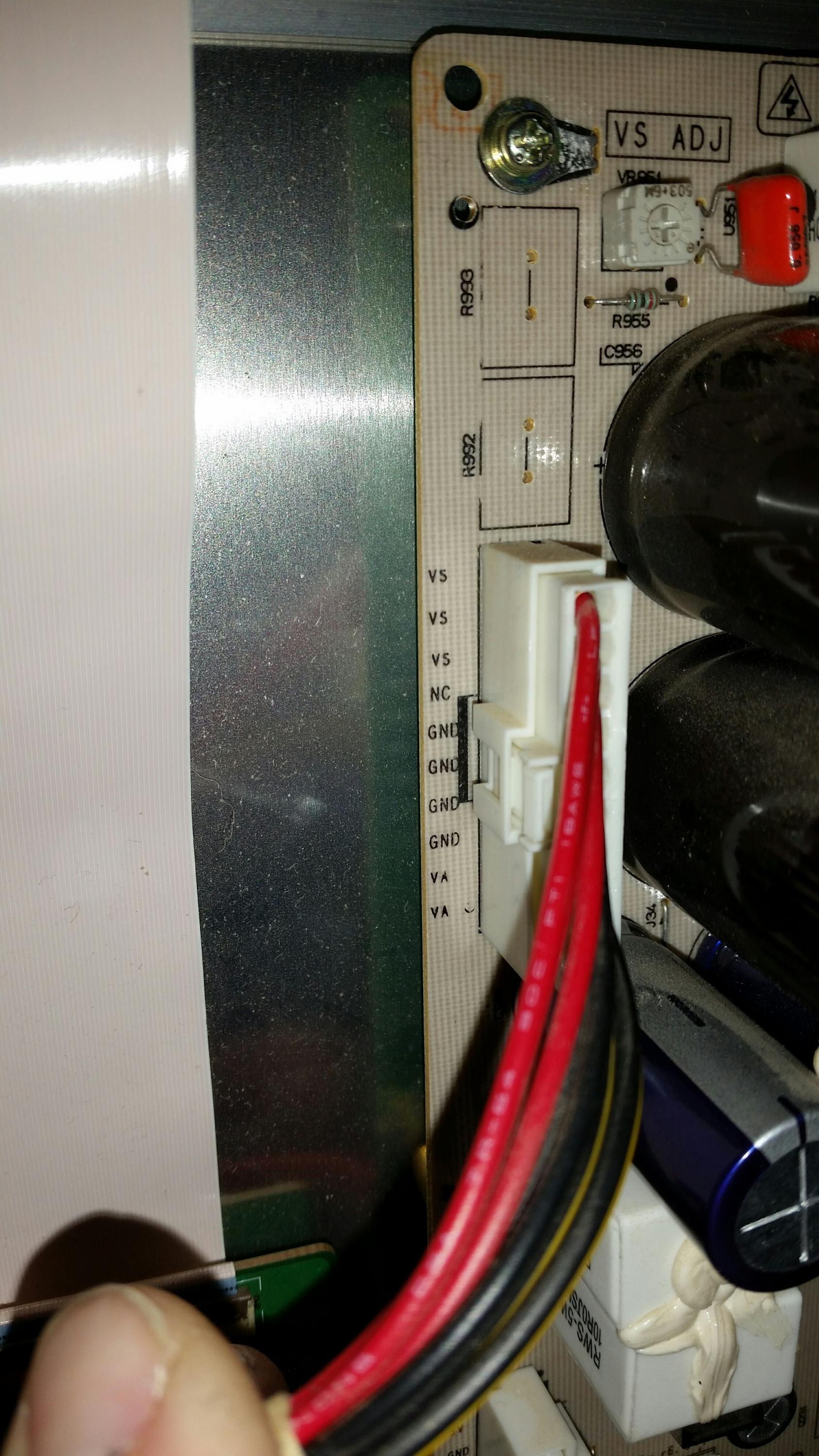

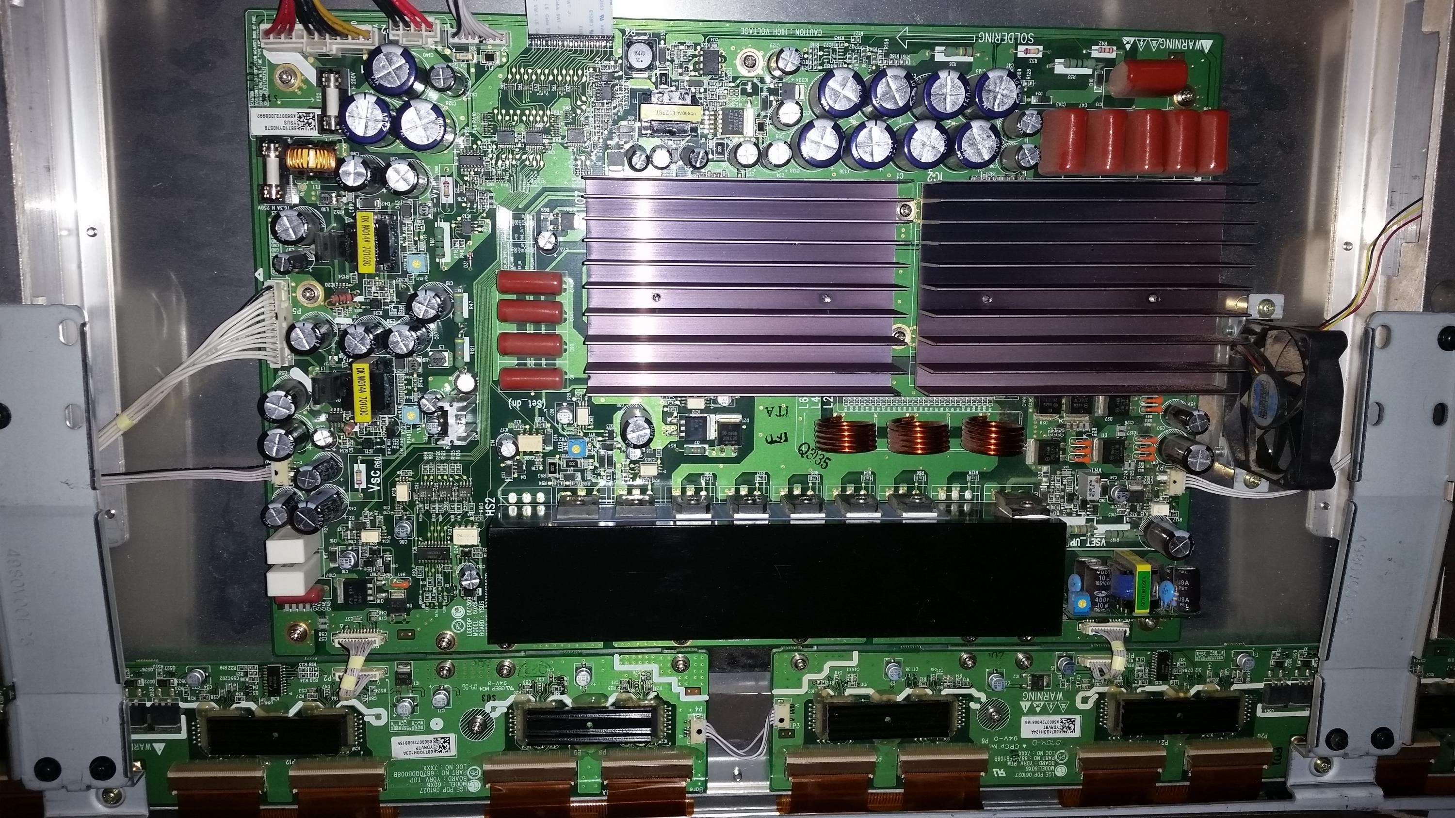

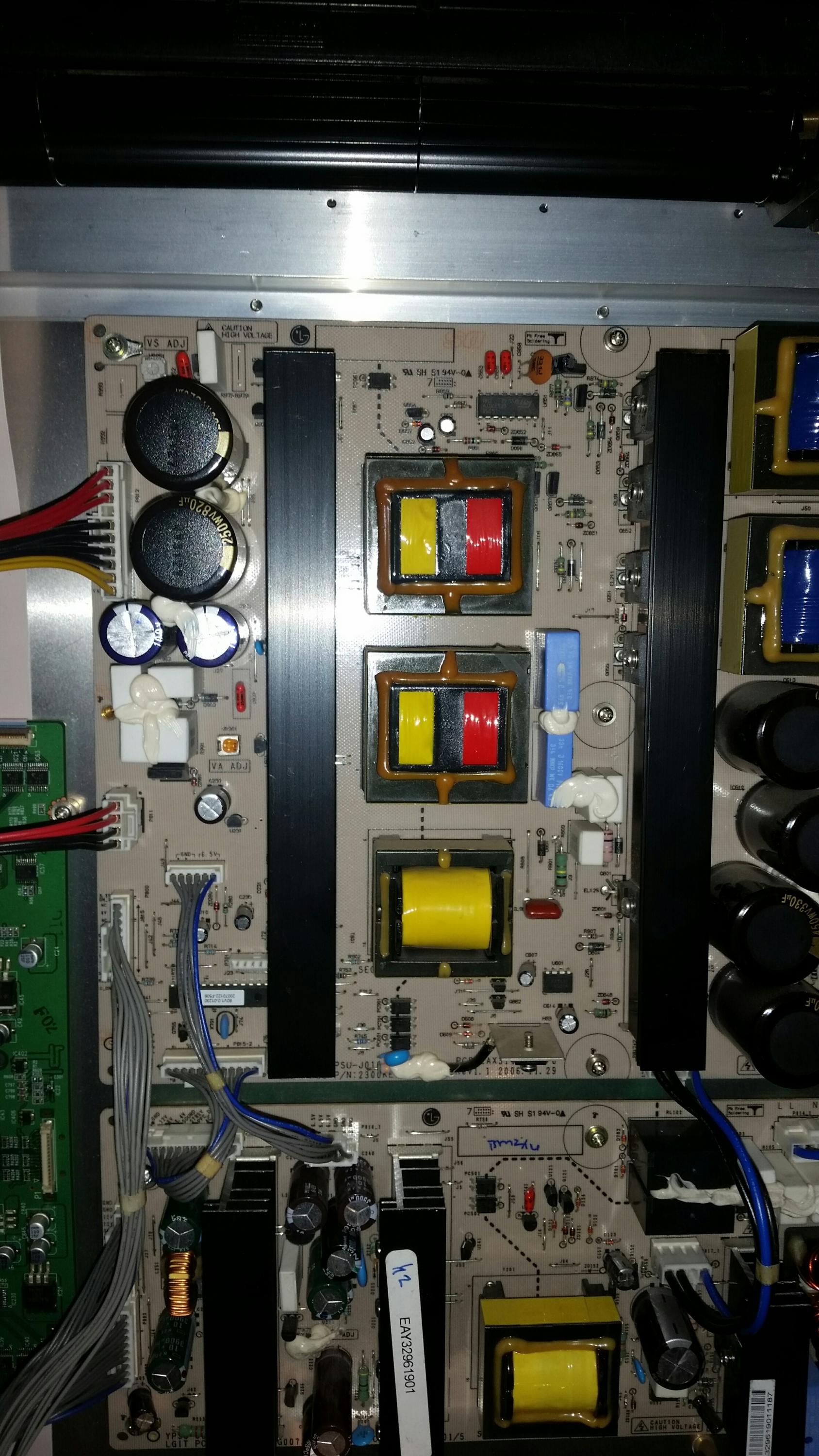

                          Look at the two large connectors in pic3 of post1 for one of the pins labelled VS. Remove power from set. Put dmm in resistance or ohms mode. Put one lead to that pin and another to chassis ground and report the reading.

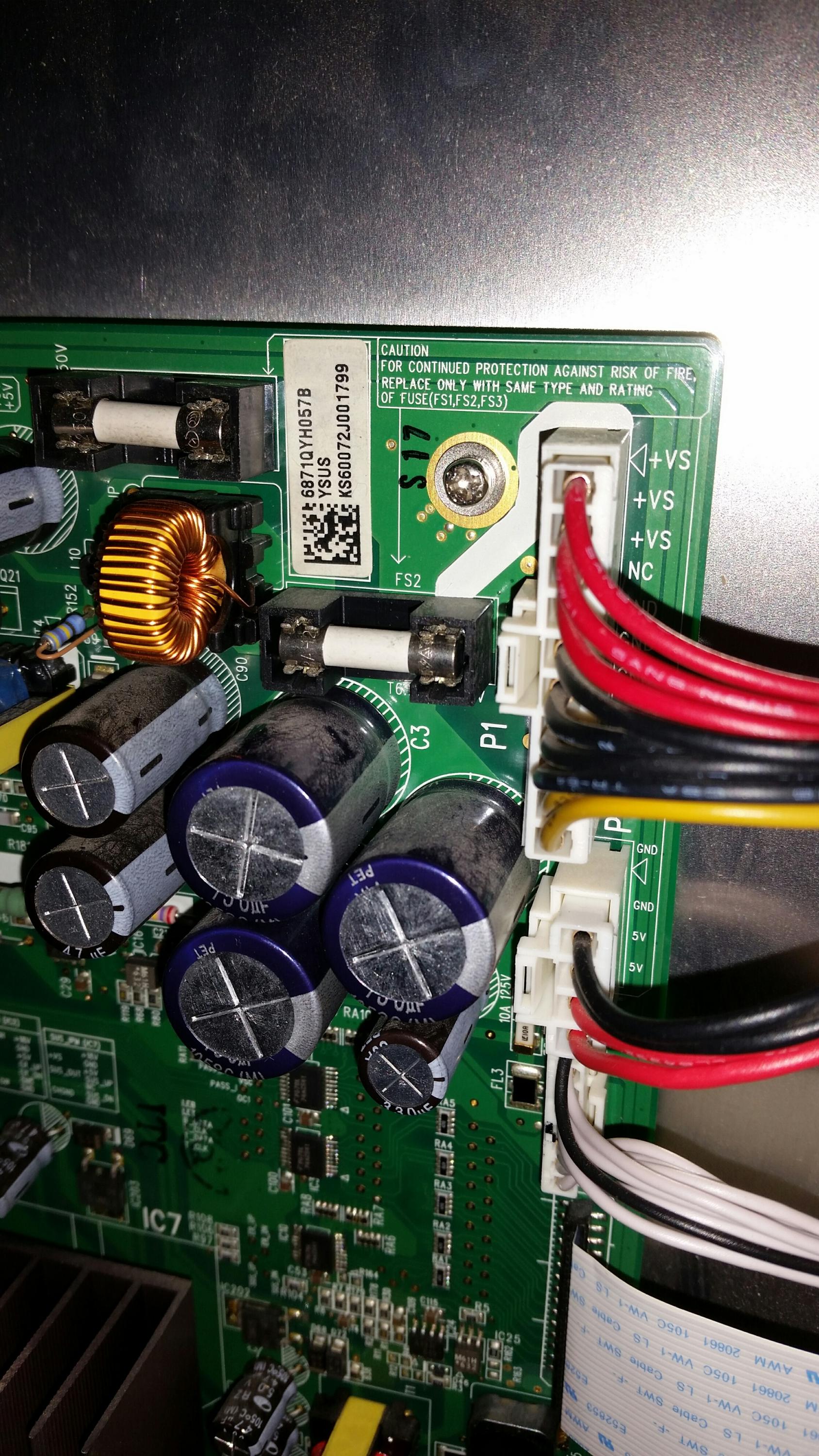

                            You could also check those two ceramic fuses by the connectors to see if they're blown by putting a meter lead on each end and checking the resistance.

                              UPDATE; With the power off,I selected diode mode and put the black lead on the chaSsis and the RED lead on VS (THERE ARE 3 VS OR RED CABLES)....
                              1. VS READING = 1
                              2. VS READING = 1
                              3. VS READING = 1
                              i attached a pic. Thx

                                I checked the fuses in diode mode.
                                Both read = 0
                                Attached is a pic of the correct board that you suggested that I check.
                                I checked the VS lines and all readings = 1
