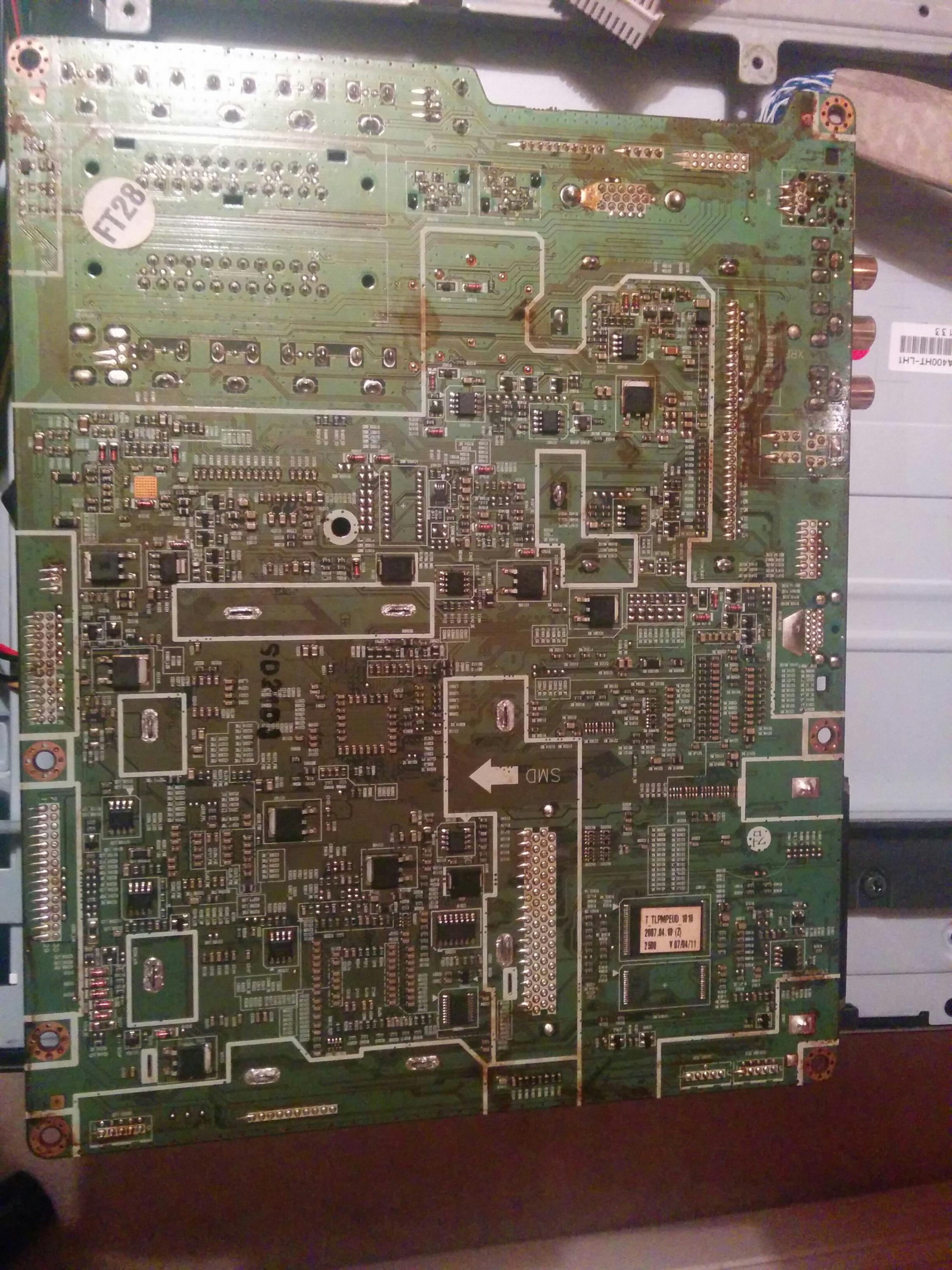

      So I cleaned the motherboard and baked it for 10 mins. After testing it again it now turns off and stays off rather than turning back on. The motherboard also exhibited more discolouration too, see in this picture:
      Looks like its gonna have to be a new board after all. Running out of things to do with this one and if anything with it not turning back on the problems got worse!

        Just thought I would update to say I fixed the issue by buying a replacement motherboard.
        It was a different board number from mine but was for the exact same model and size tv. All I had to do was plug it in and the TV has been working great since.
        Thanks everyone for their help getting this sorted.

            Thanks Vince. I linked the board I bought from ebay above, but in case the link doesn't work too well in the future here is the details of the item:
            Samsung LE40M86BD ( BN41-00813B-MP1.0) AV Board
            The original board in the TV was: BN94-01264b
            As Alastair said in his post earlier the board is actually quite common and even if its from a different size tv, you can alter the size in the service menu.
            For clarity it was the motherboard/logic board I replaced, not the power board.

              This is becoming a extremely common problem-the issue is caused by the freeview dtv decoder ic needing a reball-and oddly enough it's the only IC under the tin that doesn't get very hot either.A wedge behind the board,near the top,can usually provide a few weeks of happy viewing,until the inevitable happens again.

                Which IC under the heatsink plate is the freeview dtv decoder?

                    it's IC 3101, stI5105a

                      To follow on from this there is a setting in the service menu that turns off the freeview which is a bit of bummer but it does stop the TV turning on / off

                          Just for posterity: If the caps in your le40m86 are okay but it still turns off out of the blue, your DVB-T chip might be overheating. This happened to me even while I haven't used DTV for years. To disable the chip and keep it cool, enter the service menu
                          Power off -> Info -> Menu -> Mute -> Power on
                          For navigation use only up and down!
                          Left/right changes the values or activates an entry (reset, calibration, don't go there unless you know what you're doing).
                          The DVB-T chip is disabled in sub menu 'Option Table(Service)'. The first option 'Ready' has to be 'ON'.
                          Exit the service menu with power off. After this TV/DTV should show 'Not Available' and the TV should stay on. Not very intuitive but it worked for me. All the details can be found in a thread on avforums

                            Thank you x1000. This solved the 2nd issue with my Samsung LE40M86BDX TV. The modularity of this TV amazes me.
                            To be more specific, I had the issue with the capacitors, had them replaced but the TV still clicked after approx. 40 minutes and made a 2nd click approx. 20 seconds after that. Now it works fine.
