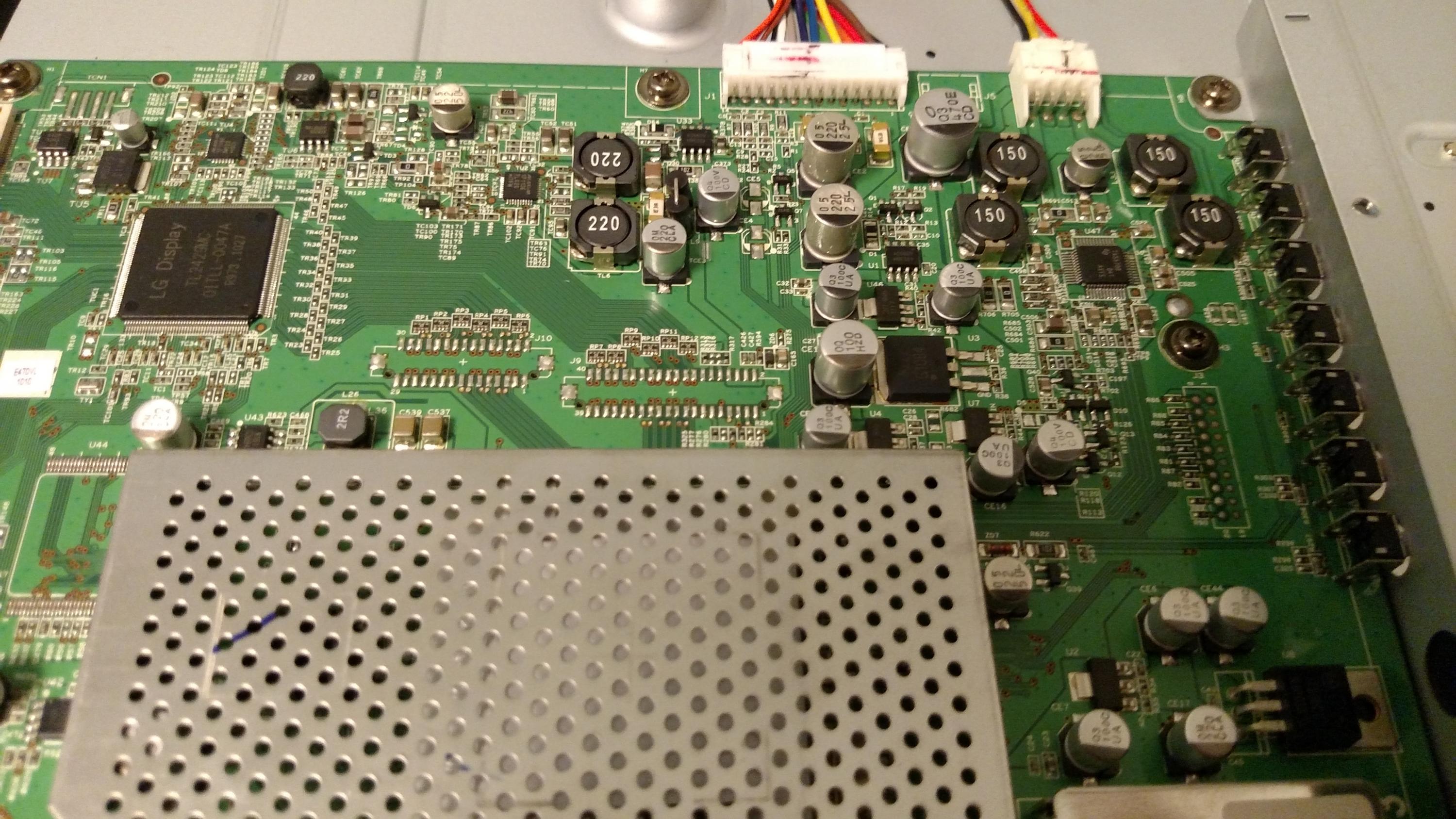

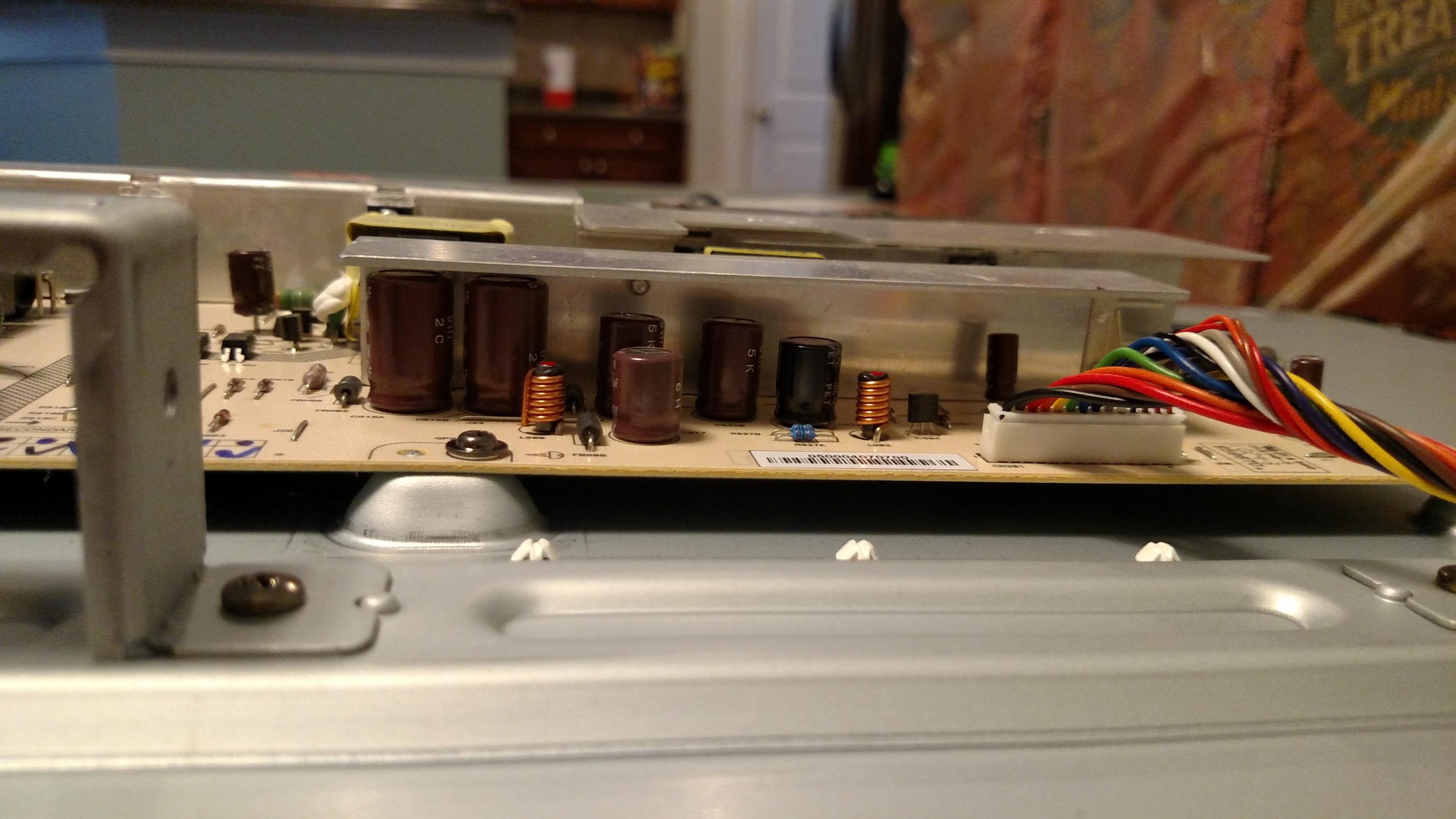

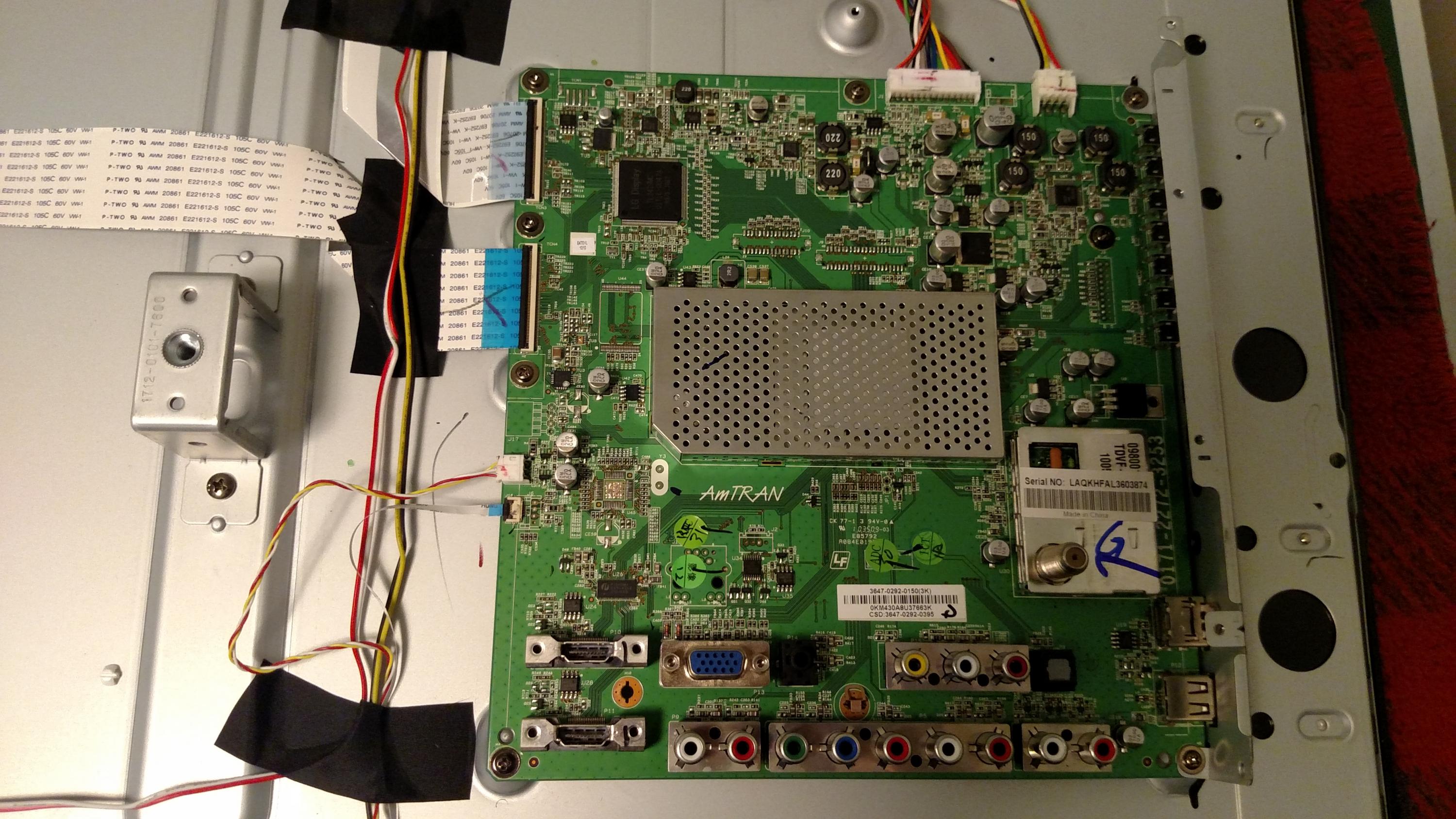

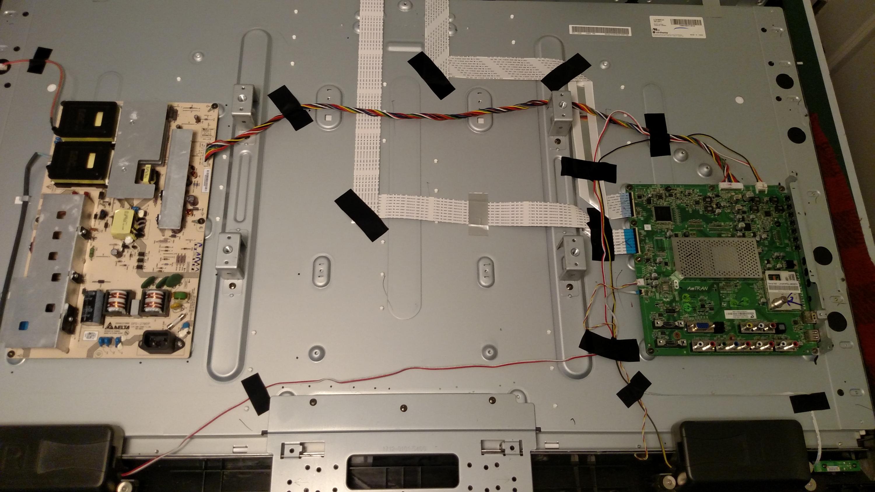

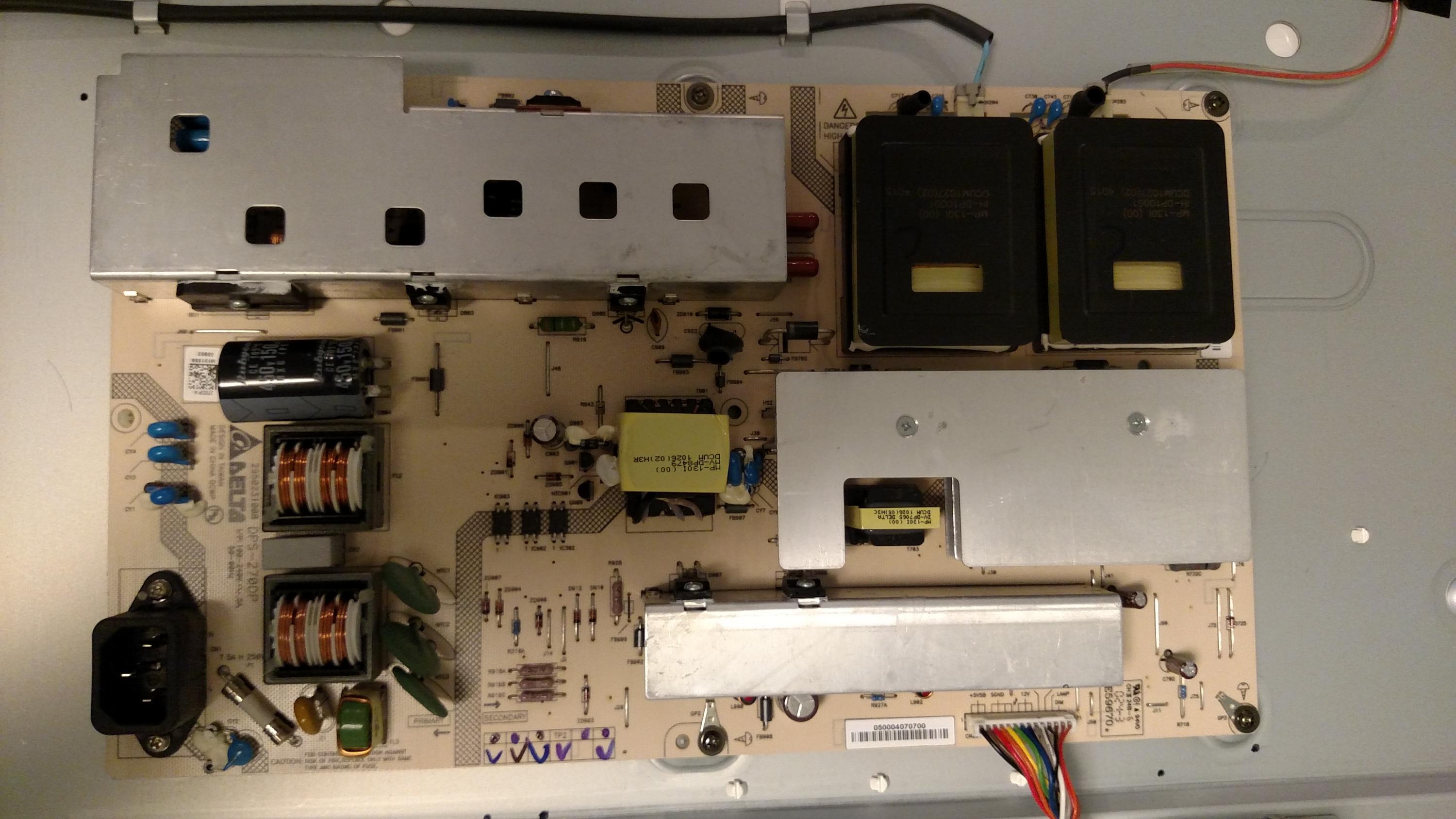

    Hello all. Have an E470VL that has a common problem with no resolution yet. When the power button is pressed on the side of the TV, it infinitely cycles in this manner: on with the front logo turning white and the white vizio logo displaying on the screen for about 2-3 seconds, then off and back to amber, rinse and repeat... When the power is pressed on the remote, however, it only power cycles once in this manner.
    All 5v standbys are present with the power cord attached. When the power is pressed, all 12v pins also read correctly when the TV is attempting to power up. I have replaced the U14 eeprom after ordering the correct part from shopjimmy, but the TV behaves the same. No caps appear to be bulging or leaking. I've also tried unplugging the IR board ribbon cable, but same results. I have some decent troubleshooting experience and have fixed a couple Samsung sets prior to this, but I'm stumped on this one.
    Pictures attached. Thanks for any help you all can provide!

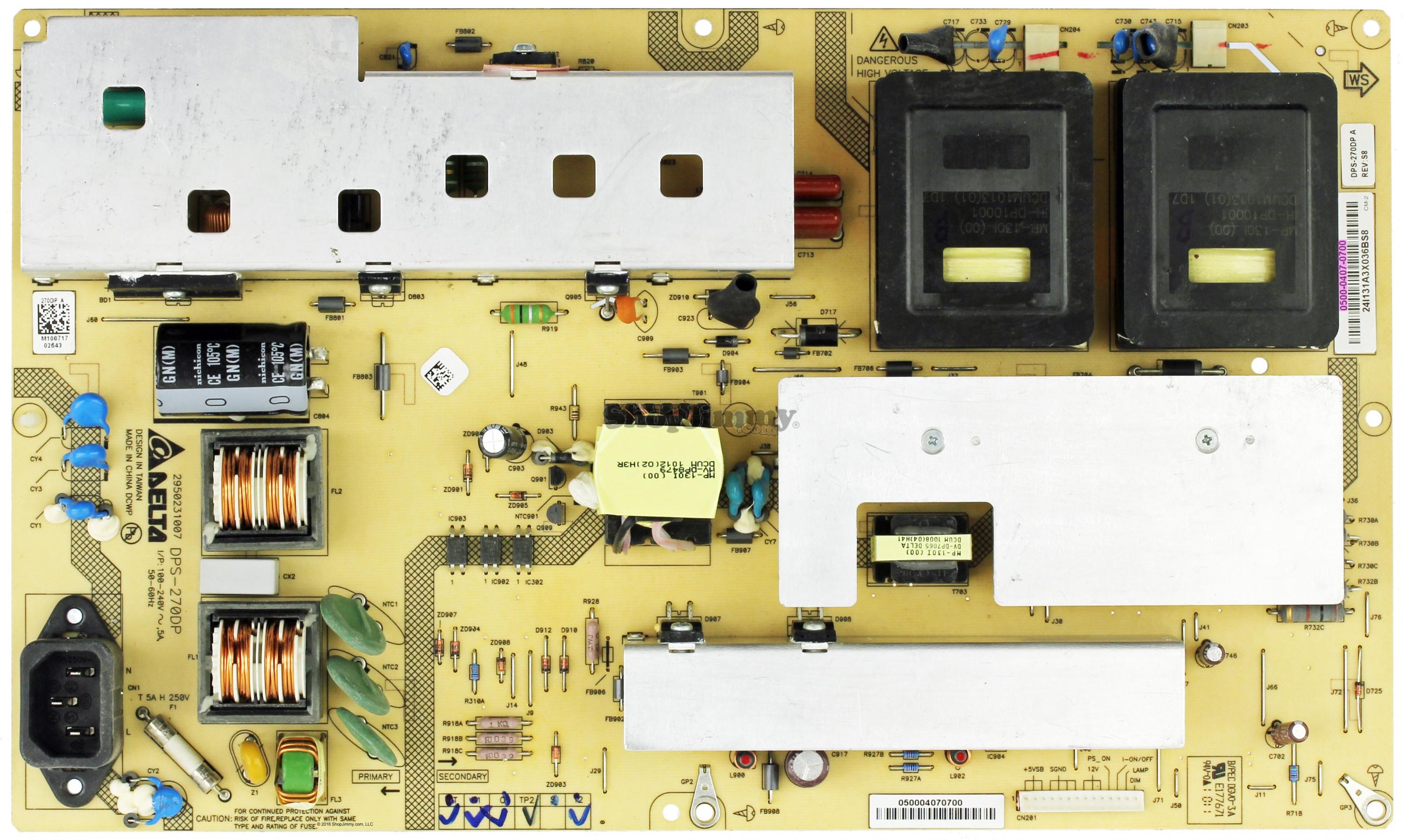

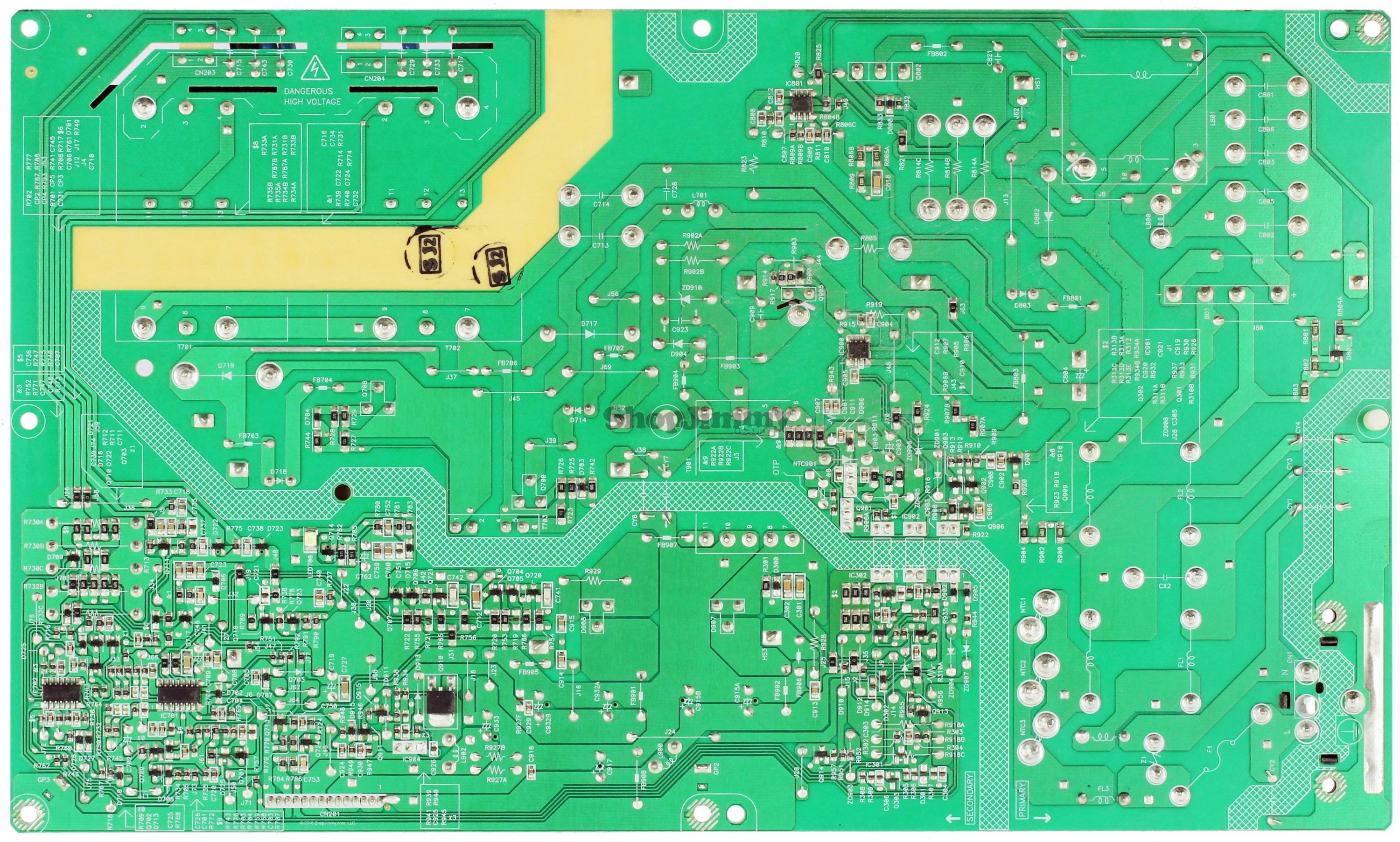

      Vizio 0500-0407-0700 Power Supply / Backlight Inverter
      DELTA DPS-270DPA
      http://www.shopjimmy.com/vizio-0500-...pply-unit.htm#
      Pictures provided by shopjimmy.
      We need you to report the DCV readings of the pins (except the GND pins) of the connector CN201.
      Please report them in this format so it will be easy to see if the command signals or Voltages are missing or not when power switch is activated.
      CN201:
      Pin 1, 2, 3: +5VSB = xxxV
      Pin 3, 4, 5, 6: SGND
      Pin 7, 8, 9: 12V = xxxV

        Pin 1, 2, 3: 5.12V each
        Pins 4-7: 0.00V each
        Pins 8, 9, 10: 12.25V each
        Pin 11: 2.24V
        Pin 12: 3.24V when logo is white and attempting to power up, 0.00V when amber
        Pin 13: 0.05V when logo is white, 0.00V when amber
        Pin 14: 3.24V for half second after logo is white then 2.92V until logo goes amber when it drops to 0.71V

          Pins 1-3: +5VSB
          Pins 4-7: SGND
          Pins 8-10: 12V
          Pin 11: PS_ON
          Pin 12: I-ON/OFF
          Pin 13: LAMP
          Pin 14: DIM
            Re: Vizio E470VL "2 seconds to black"
            Well it has the correct control signals from the main board.
            Can you try unhook the cables to the panel buttons board and use the remote to turn on the TV?
            I see SJ is selling EEPROM and the ICs for the main board repair kit.
                            Yeah the other component in that kit fixes a different issue. Well that sucks, those are like $150. No other way to do component level troubleshooting on the main board?
                              It will be tough without the diagram.
