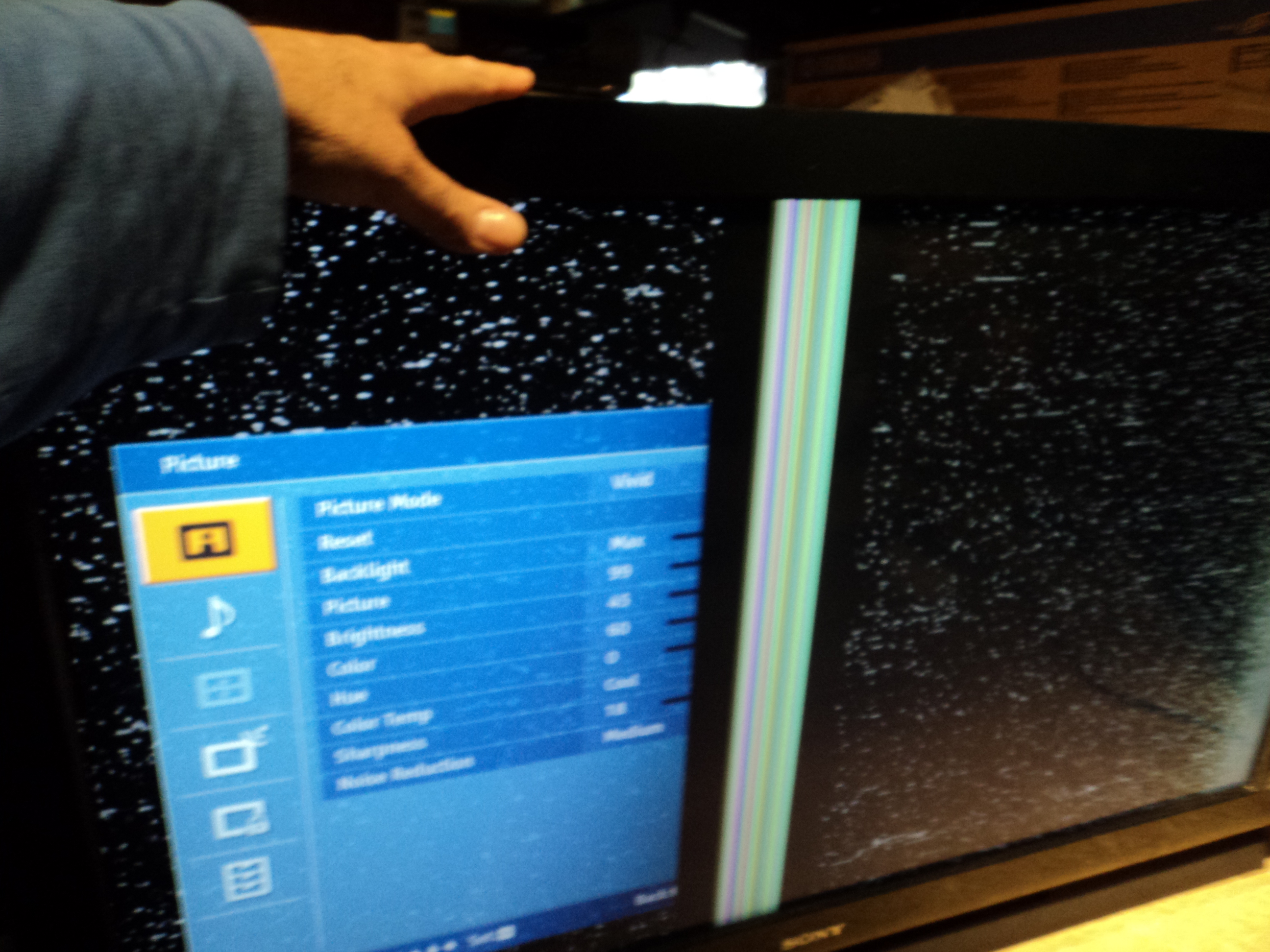

      Re: Sony KDL-46S4100 no pic or sound help.
      Hi guy; Update on KDL46S4100, i got the new T-con Board and installed same stripe on the screen,don't you think i'm screwed Panel is bad?now i have all good boards parts for this model and no screen panel?, what a bad luck,please say something,at least a word of comfort thanks for you help and patience, at least it's no all loss,i keep learning more and more everyday, with Badcaps forum,the best there is,i learn alot.thanks
        Panel problem, you can try pressing on the tab bonding or try flexing the panel to see if the condition will change.

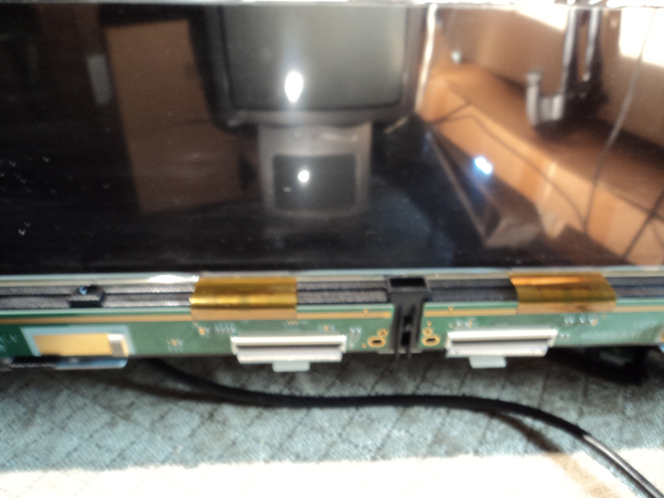

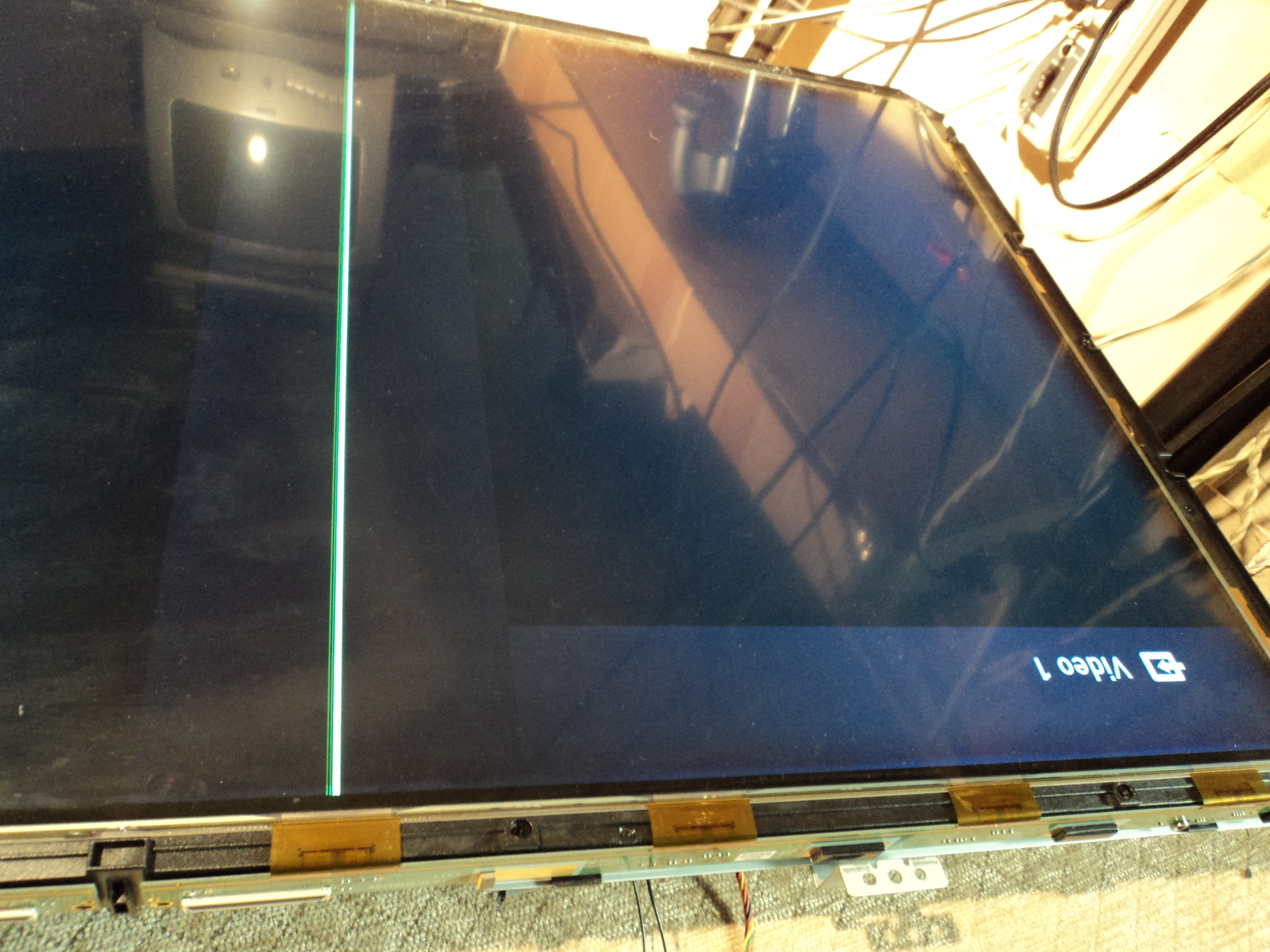

              #46
              Originally posted by budm
              So you open up the LCD panel to get to the Tab bonding then? Unless those driver IC in that section of the screen is bad.
              Thanks budm;when i take off the medal frame i get a diferent stripe line see first pic,on the panel flex boards i only see Resistors and caps,see pics.
              all the flex tapes seem not to be bad like cut traces like i see on some Utube videos everything seems to fine at naked eye!
              Budm do you know what other LCD tv might have this LCD panel?
              i was thinking if i could get an used cheap 46 LCD tv that the panel fit in this Sony , i could make an offer,i think Samsung old lcd tvs use to have same Screen panels,
              i have taken this #'s,i don't know if there are the panel #'s, can you advise on that.thanks

                #47
                It seems to me that since the Vertical lines have changed, I would suspect bad bonding of that brown flexible PCB which is attached to the rigid green PCB, that is where you applied pressure on that section to see if the vertical lines changed from more line to less lines or lines are gone when pressure is applied.
                Example of vertical lines due to bad tab bonding.
                https://www.badcaps.net/forum/showth...LN52A530P1FXZA

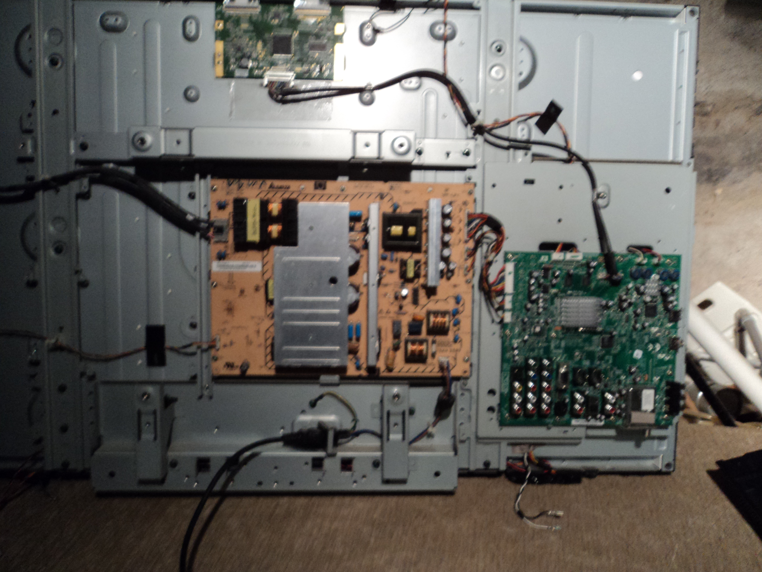

                        #51
                        Pictures of the whole back side of the TV?

                          #52
                          thanksbudm; is this what you want, not very good pics, i'l try on day light,cause i have tv in the cellar has poor light. ?,camera is not very good.
