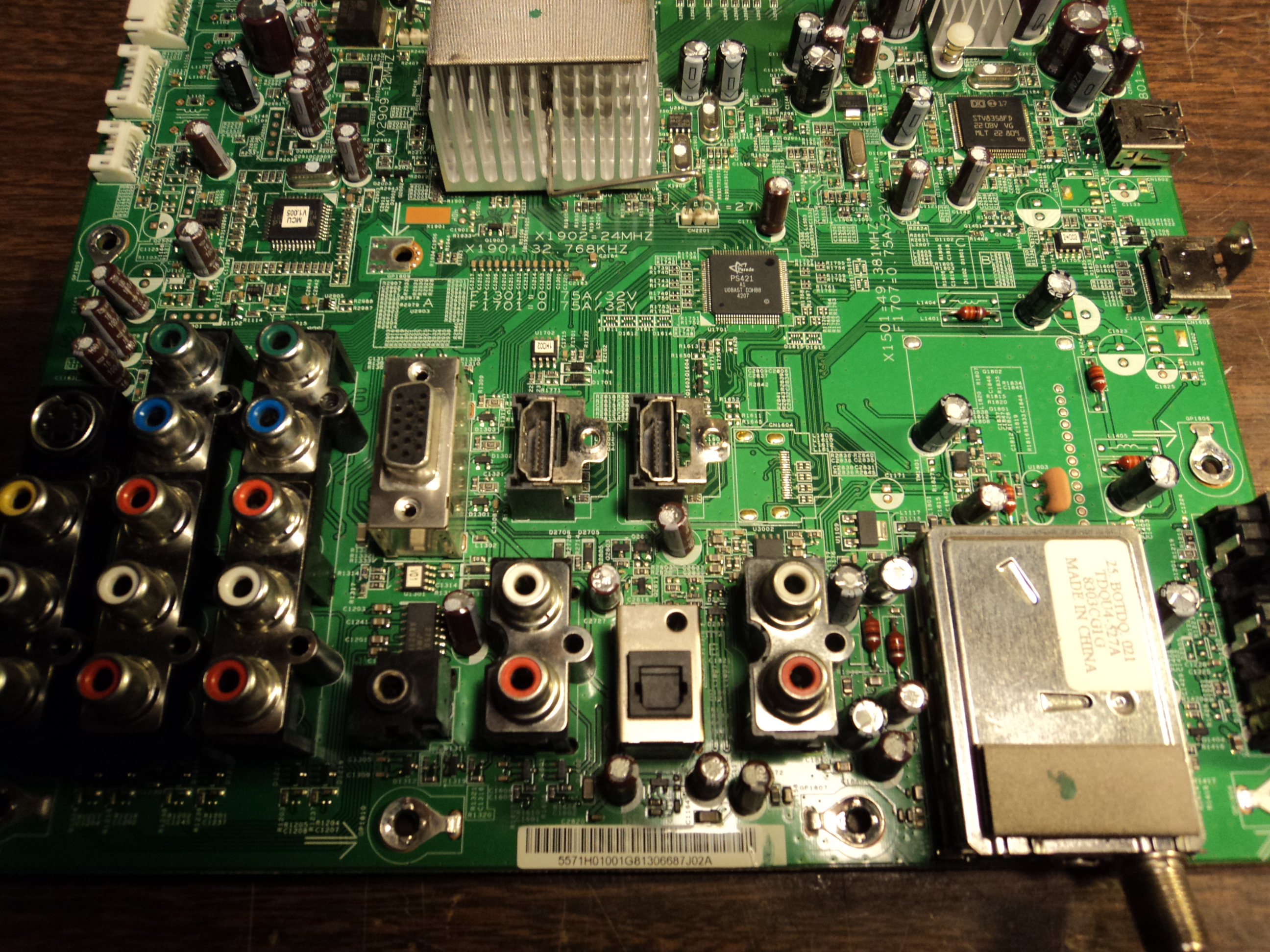

    Hi guys ;today during my morning exercise walk i came across a Sony Bravia
    KDL-46S4100 that was dumped on the side of one of those yellow dumpsters,i had to care it back to my house about a quarter mile on my back,
    turned it on and it clicks and get power on green led and the back light in on,so before i open it up please tell me it's worth to repair and where to start.
    For some research i suspect the A main board, which i can get from here
    http://www.shopjimmy.com/sony-1-857-...dl-46s4100.htm
    i appreciate any clues,thanks

              Hi guys i received from Jimmy parts today the A board for KDL-46S4100 - no picture and no sound but did get steady green light on and could power on and off,with back-light on, and installed and no luck same issue;how i know that this board is not faulty too?or should i look at other Board?thanks in advance.

                                        1- disconnect both ribbon cable from T-CON to LCD, and inspect them if there any line missing or became short not to the end of the cable.
                                        2´- keep them out and play signal from outsource to HDMI 1, you should hear the sound. if yes, get the ribbon cable back, if no Picture you have T-CON fault. or bad soldering, reflow it witth heat gun.. give try you will not lost ..
