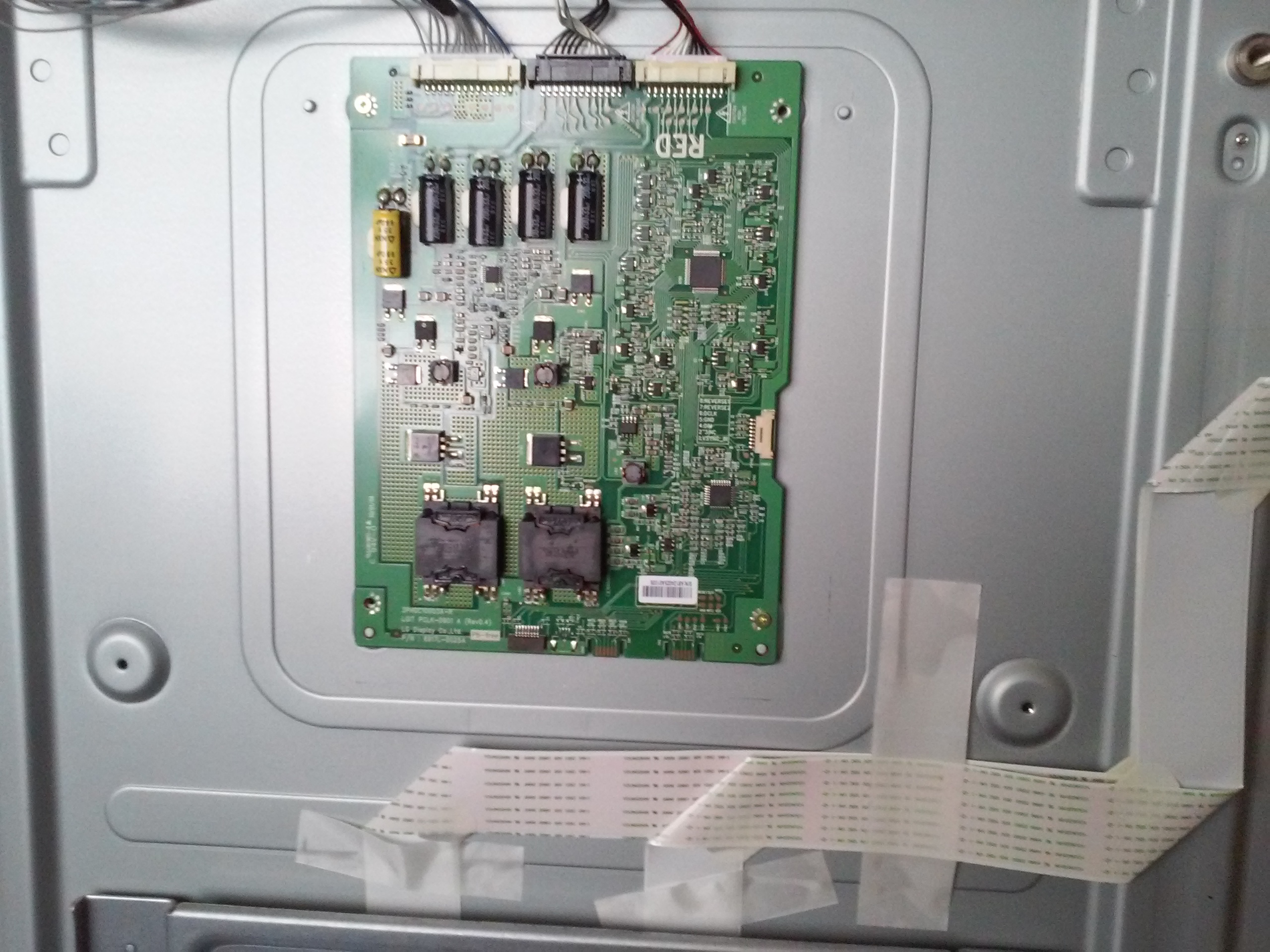

    I found this tv, and have no background info on it, heres what it does.
    I plug it in, touch the power button, theres a click, it radiates it's little lights, all the vol, menu, input, etc. touch sensors light up, the LG logo in center of bezel lights, and thats it, no backlight what so ever, not even flash for a second.No sound except for the when the buttons are touched, it gives a little feedback beep.
    I took the back off, the power supply looks ok, (everything 'looks' new)
    there is a little blue smd led on the driver board that blinks steady, and the green and yellow indicator lights on the ethernet port are dimly lit.
    There is no 'stby' power spot to check for voltage, least not labled as such.

    There are some test points on the led driver, only getting 24v at the spot where it has the high voltage triangle, and 0v on all the others, im thinking thats a clue.
    driver = 6917L-0025A
    p/s = LG EAY60908801
    mb = LG EBR66400202

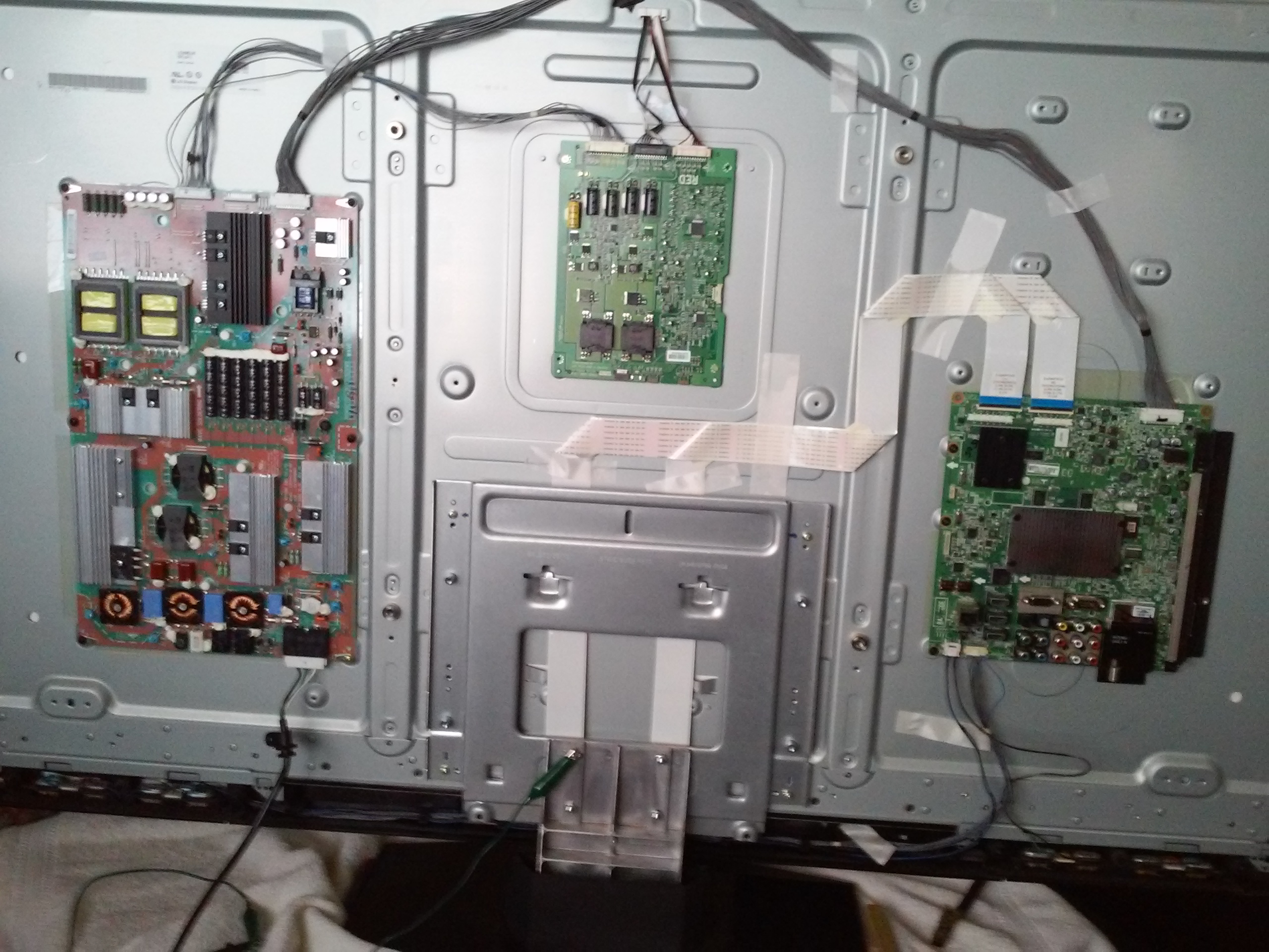

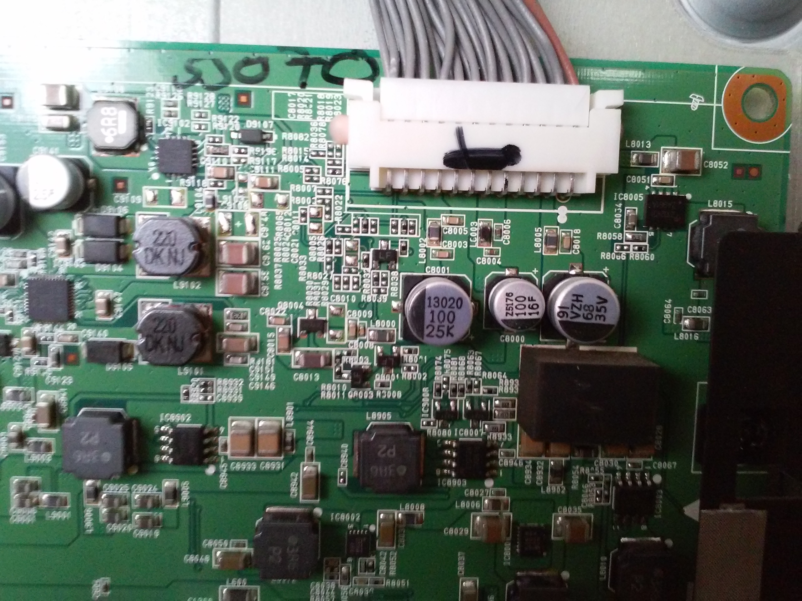

    Do your best with pics of your own tv. Take one pic of the complete back of tv with all boards attached. Also closeup pics of each board.
    The psu to main connector pins are labeled on the back of the board but even on the shopjimmy pics they are hard to read.
    Also I see a "ONOFF" pin on the led driver as well as a surface mount fuse(white) that you can check.

      Heres the pics.
      Lemme try this again...
      ONOFF reads 0v, im assuming the fuse is good since there is 24v south of it.

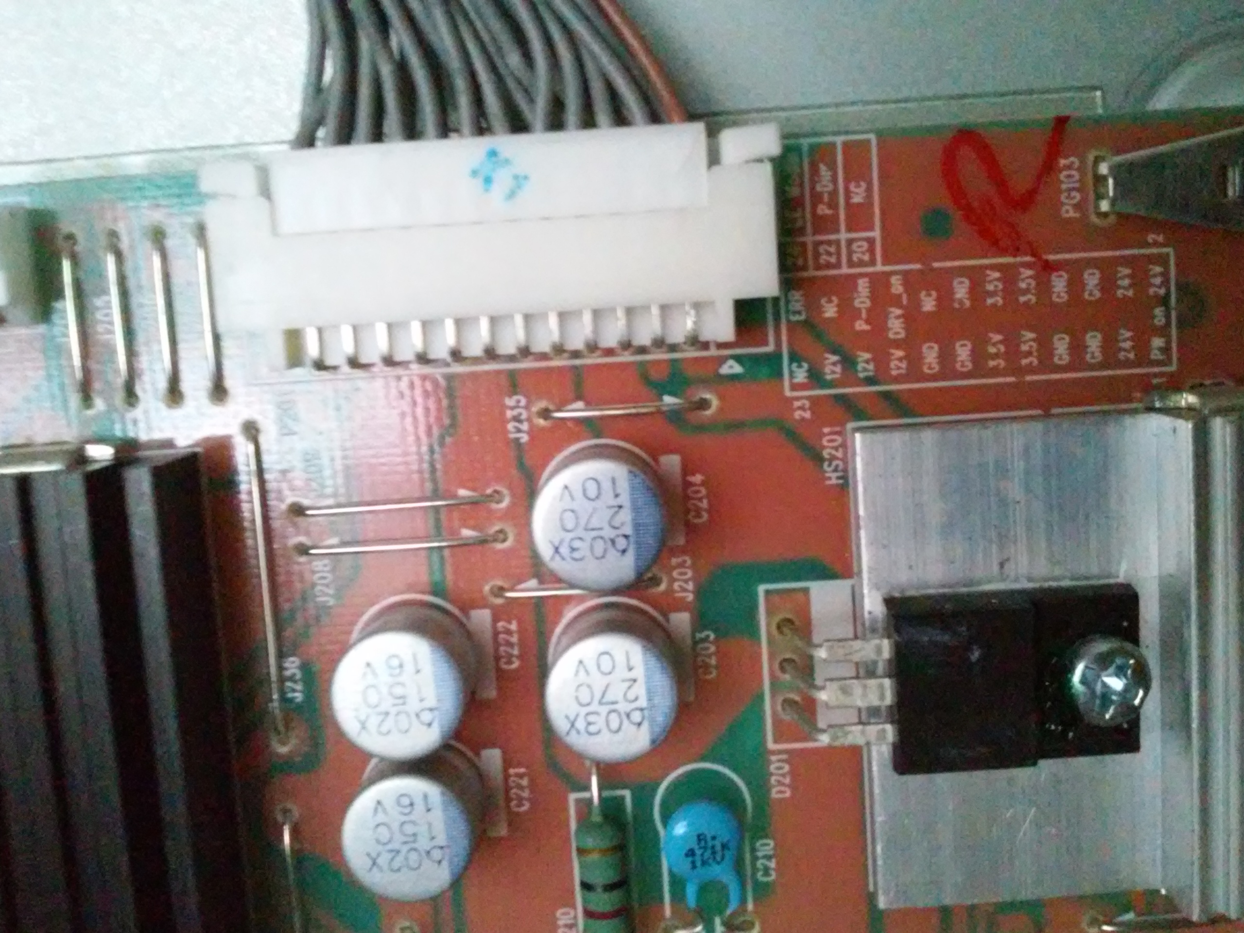

        On the bottom right corner of the PSU is a pin out with voltages. Measure those and report back with pin out name and voltage tested.
        • zyz
          • Nov 2013
          • 13
          Re: LG 55le5400-UC AUSWLHR No backlight
          Hi CapLeaker,
          I guessing you mean top right, as the mains power comes in at bottom right of psu.
          This is PSU to MB
          pin:
          1 PWon = 3.3
          2= 24.5
          3= 24.5
          4= 24.5
          5,6,7,8 =GND
          9,10,11,12 = 3.4 (when front panel power switch is on or off)
          13,14,15= GND
          16 NC = 0
          17= 12.2
          18 DRV_on = 0
          19= 12.2
          20 P.DIM = 0
          21= 12.2
          22 NC = 2.9
          23 NC = 0
          24 ERR = 0
          Not sure what that extra pinout above the 24 pinout means?

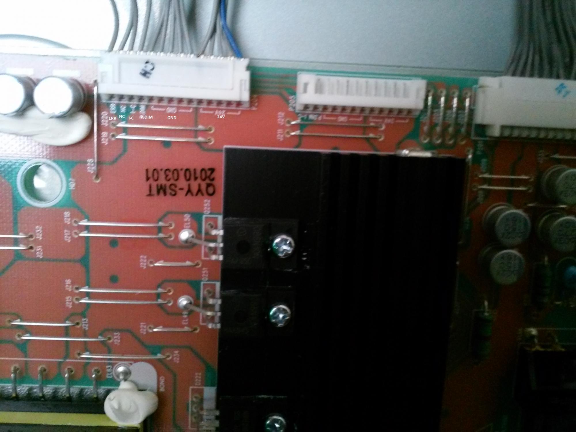

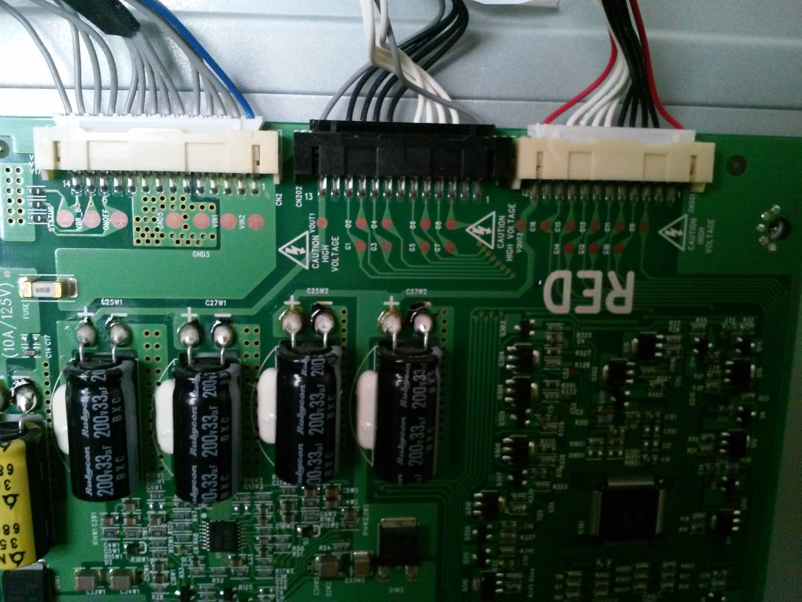

            Left connector on PSU to the LED DRV
            pin
            1,2,3,4,5 =24.5
            6,7,8,9,10 = GND
            11 P.DIM = 0
            12 I-C = 0
            13 NC = 2.9
            14 ERR = 0
            24.5v from pins 1~5 goes to the yellow cap, then down to the black trans.
            Thats as far as I went, not knowing what to expect on the other side of the trans. (if thats even a transformer?)
              18 DRV_on = 0
              20 P.DIM = 0
              No BL-ON , no Dimming control.
