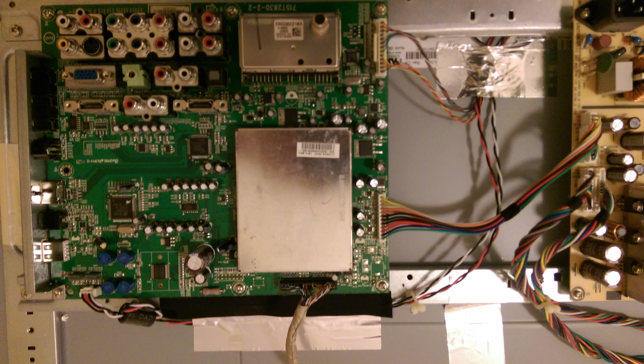

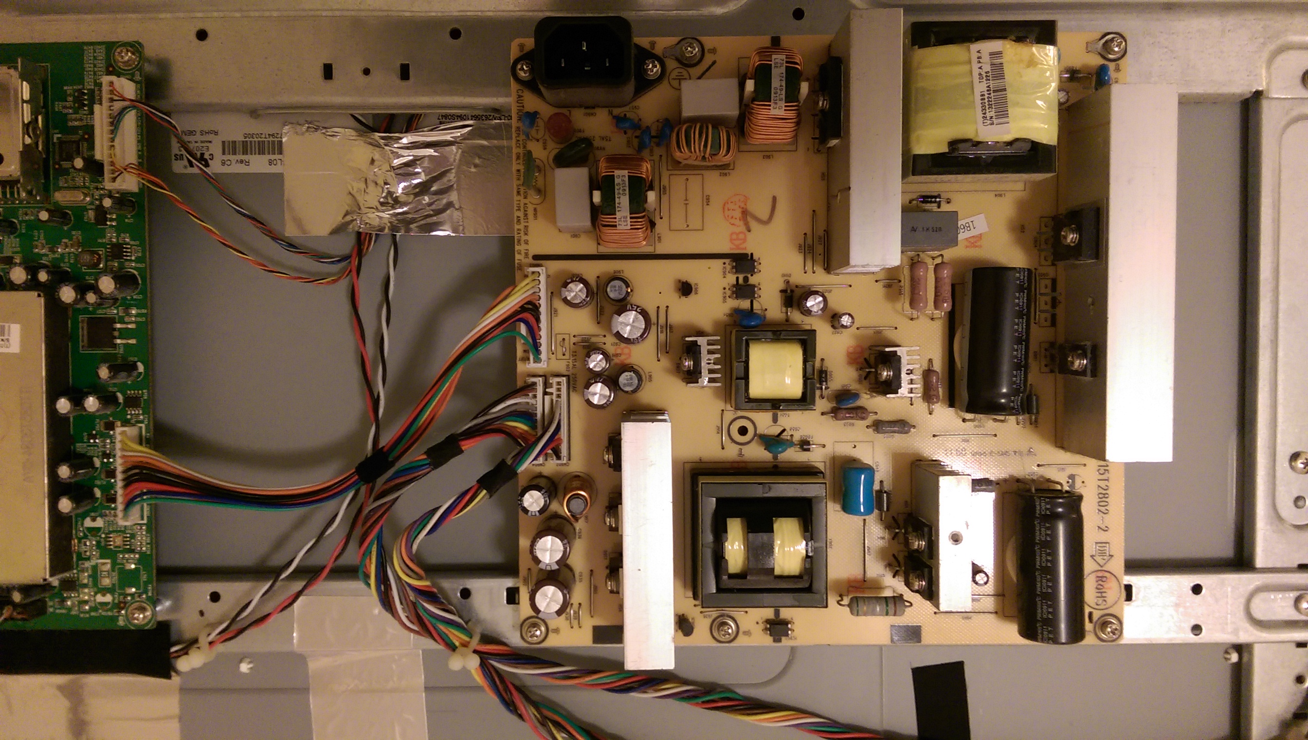

    I have come to a dead end on this and would like some help. Most of the repair I have done has been bad caps, so I don't know where to go with this one. When I check the voltages at the power board and at the main board they are all OK. I did the flashlight test and did not see an image. So I replaced the T-con board with a used one that I believe to be good and still no picture. Any help would be appreciated.

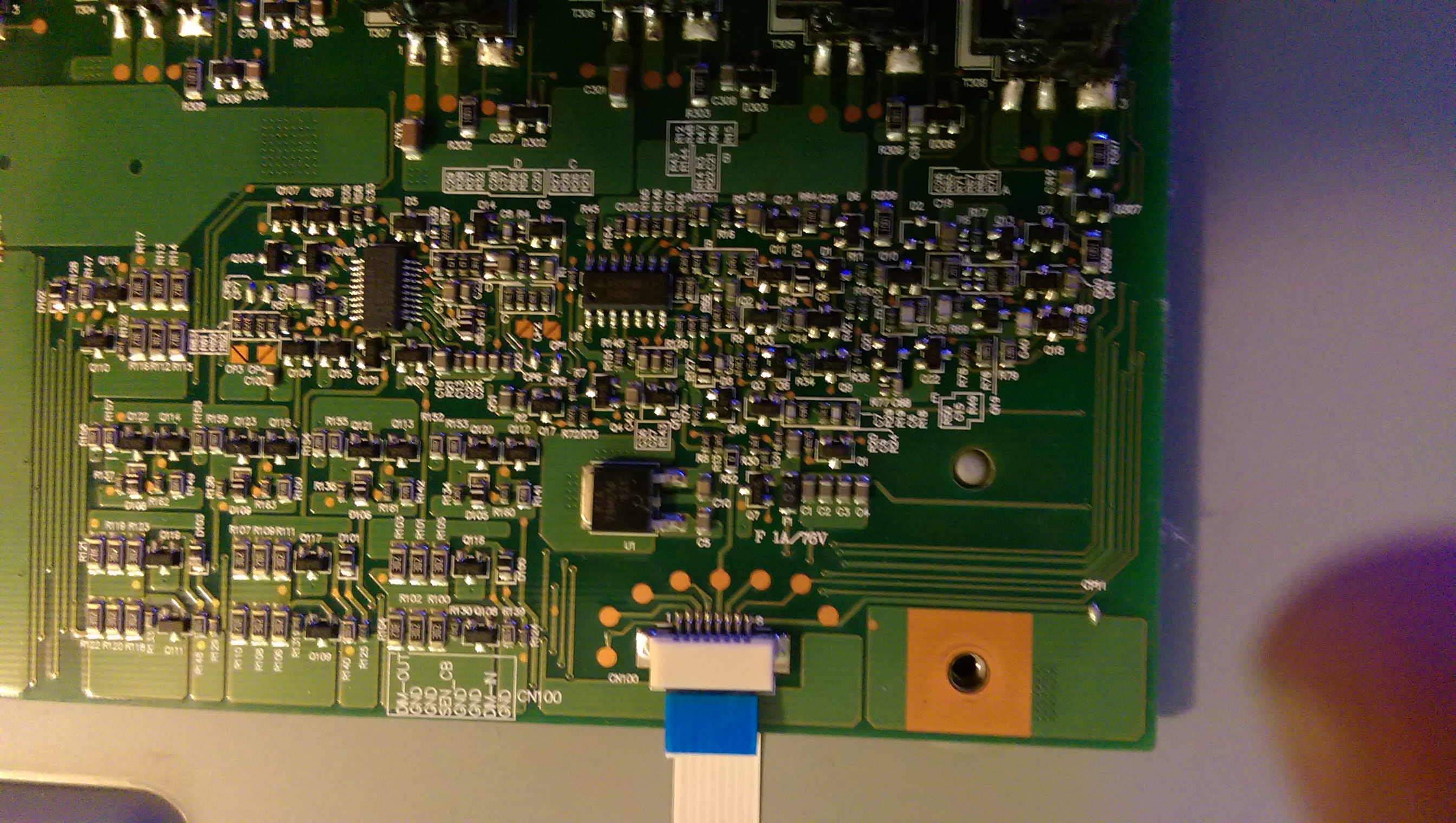

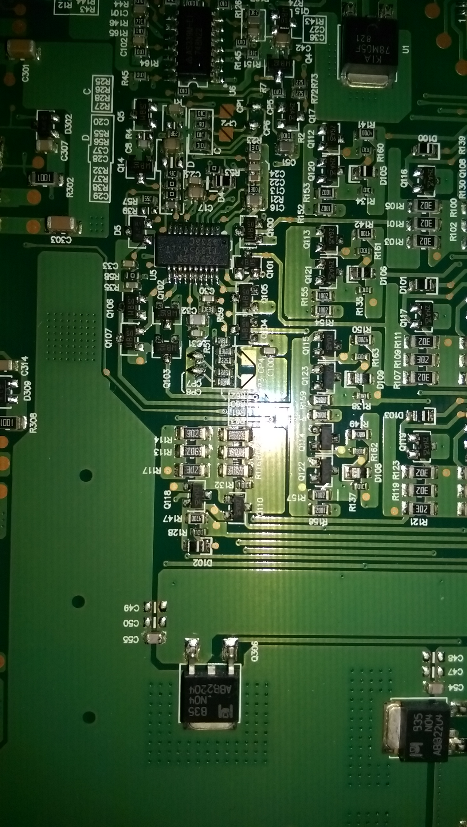

            Since I am not getting back lights I did some checking on the board. It seems as if the fuse located at C55 in the attached picture. On one side I get 24 volts, on the other side 0. So what would have caused this fuse to blow?

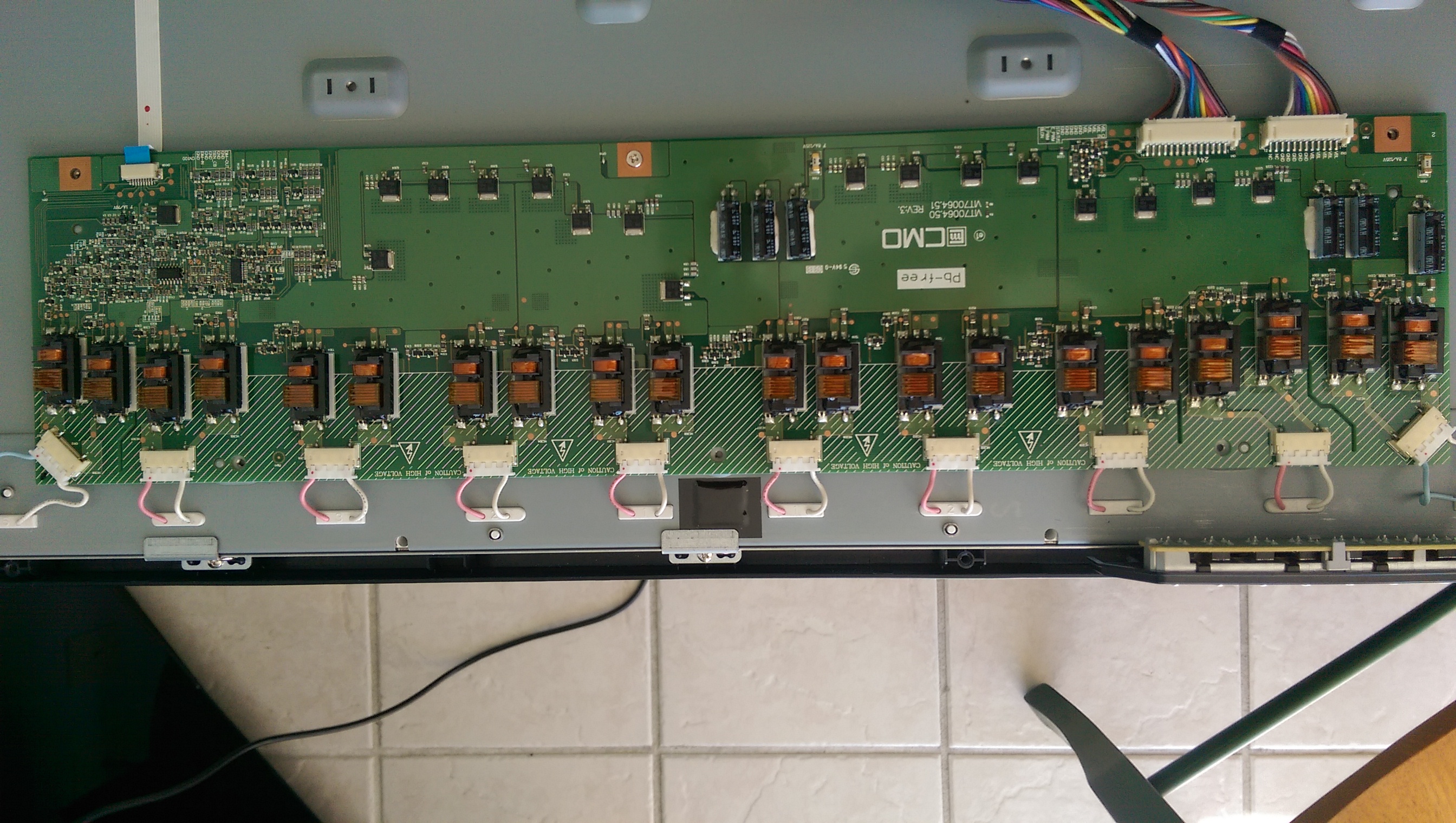

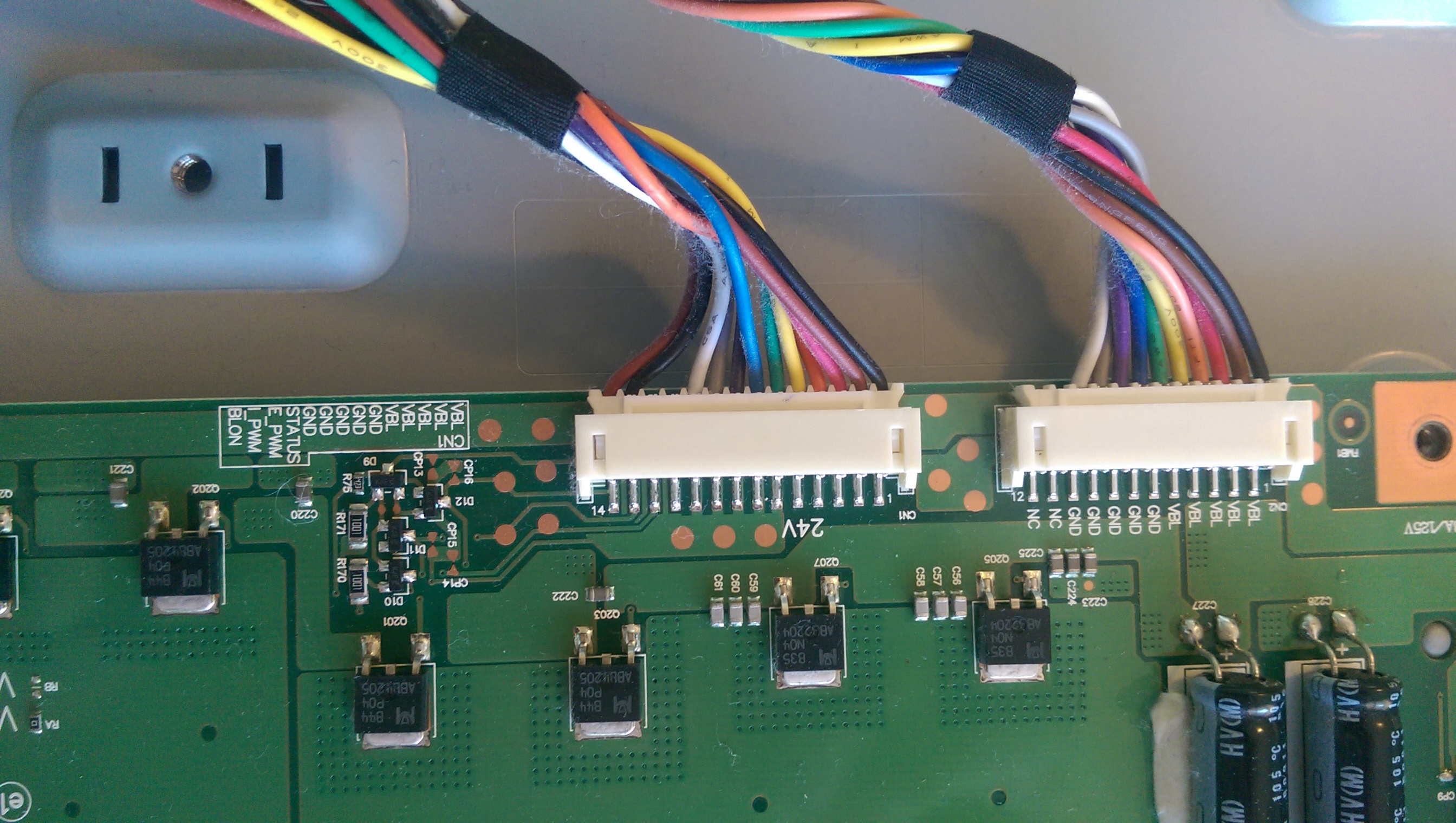

                You need to check the BL-ON signal on the inverter board, you need to remove that black cover so you can see if the pins of those two big white connectors are labeled or not.

                  Thank you for the reply. Yes, voltages are as follows.....
                  VBL-24.4v VBL-24.4v
                  VBL-24.4v VBL-24.4v
                  VBL-24.4v VBL-24.4v
                  VBL-24.4v VBL-24.4v
                  VBL-24.4v VBL-24.4v
                  GND GND
                  GND GND
                  GND GND
                  GND GND
                  STATUS-not used
                  E_PWM-not used
                  I_PWM-3v
                  BLON-3v
                    Re: Insignia NS-LCD47HD-09 no picture
                    OK, you do have all the needed signal for the inverter board to function, so I need to see good clear picture of the inverter board.
                    Thanks for the nice and clear picture in post 9.

                      BTW, that small black fuse with '20' printed on top shows < 1 Ohms of resistance?
                      https://www.badcaps.net/forum/attach...3&d=1455065642

                        Can you please point out to the fuse? What is printed on the fuse? I see C55 but I do not see any black fuse close by.
                        https://www.badcaps.net/forum/attach...1&d=1455064479

                          "It seems as if the fuse located at C55 in the attached picture"
                          The label is a giveaway, not a fuse rather a ceramic capacitor

                            Ah I see what he is saying now, he thinks C55 is a fuse. I also wonder what he means by this also in post 7: I did not find voltage at any black fuse.).
                            There is only one black fuse with '20' printed on top.

                                  You need to test that small black fuse I show in the picture in post 11.

                                    The black fuse with "20" on the top. Has 24v on the side toward the connector and 1.2 on the other side. Wow, that is small. I have never replaced anything that small. Please give me some idea where I get a fuse like that and how is the best way to replace it. Also, it blew for a reason. Have you had good results just replacing one and not being to concerned why it's blown?

                                      That black fuse is the common failure fuse used in CMO inverter board, I use PICOII through hole fuse in its place, done so many of them without having the TVs come back with the same blown fuse.
