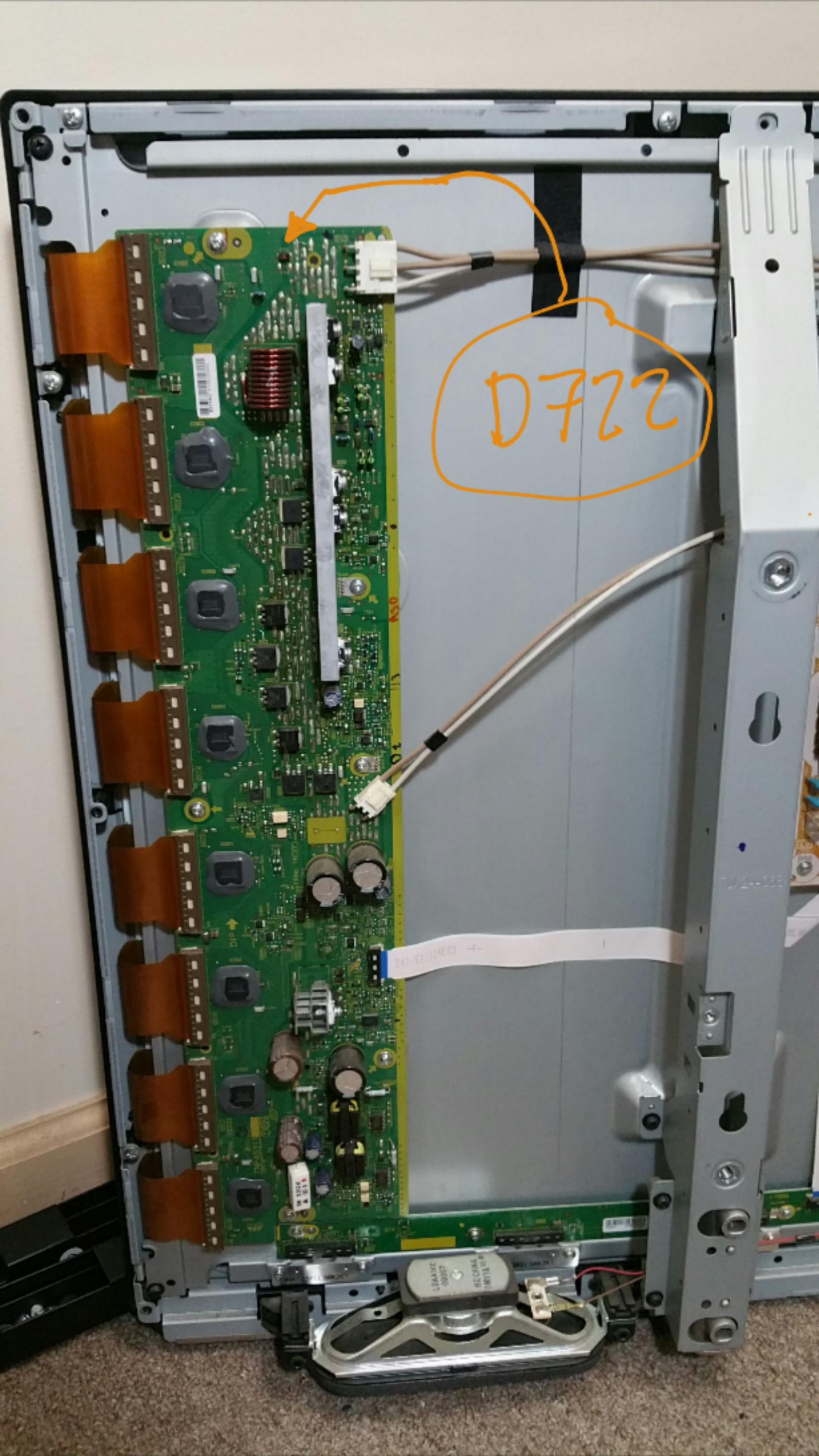

    Kids were playing with the plugs on the power strip when the TV made a loud pop!

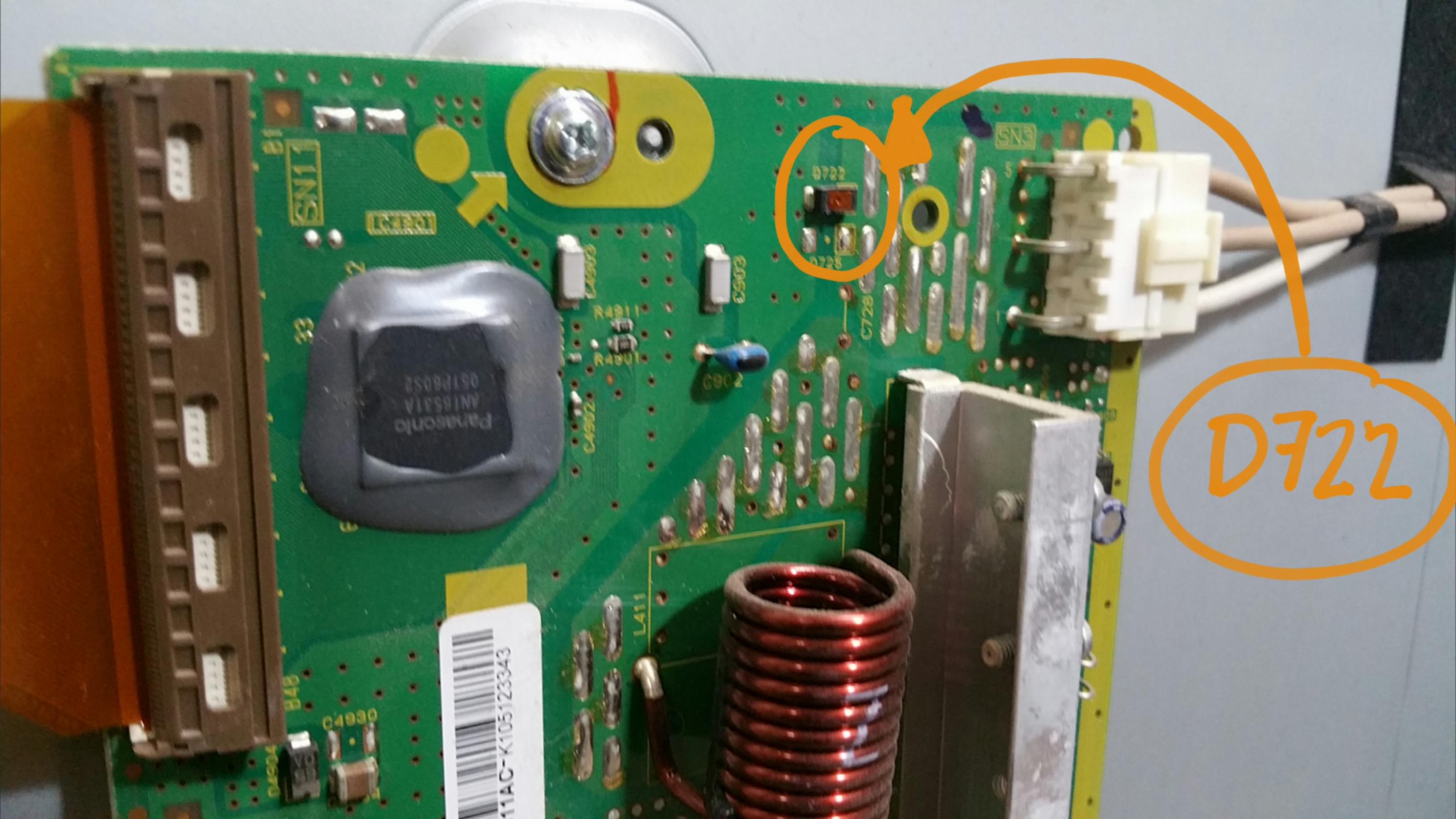

    I've identified what I think is the source of the pop sound. It looks like a blown component on, what my research shows as, the SN board/Y Sustain/Y Main.
    I've also seen the board referred to as: TNPA5311AC / TXNSN1PPUU / TNPA5311AE
    The only visible sign of failure is the component labeled D722. Problem is, I can't identify the component because it blew off all identifying markings.
    Can someone provide me with what this component is and its stats? It has to be cheaper to replace this single item, than to replace the whole board.

    So you could jump on to shopjimmy and have a look. appears to have a marking 72 or 73 and it'd be a Rohm product but how confident are you this is the only blown part? $19 for a whole board seems a good deal and even if you fix the old one, handy to have for when spares run out.

              That would potentially suggest Vsus is shorted on either the SN or SS. Going back to the orignal photo that diode is part of the ERC which that top lead connects to the SS.
              I would say the SS failed and took out part of the SN now that you say it still will not turn on.
              I would not apply power anymore, grab the SS and check across SS11 Vsus to gnd and see if shorted or just probe the RJP30H2 transistors as I'd expect them shorted if it's shorting Vsus.
