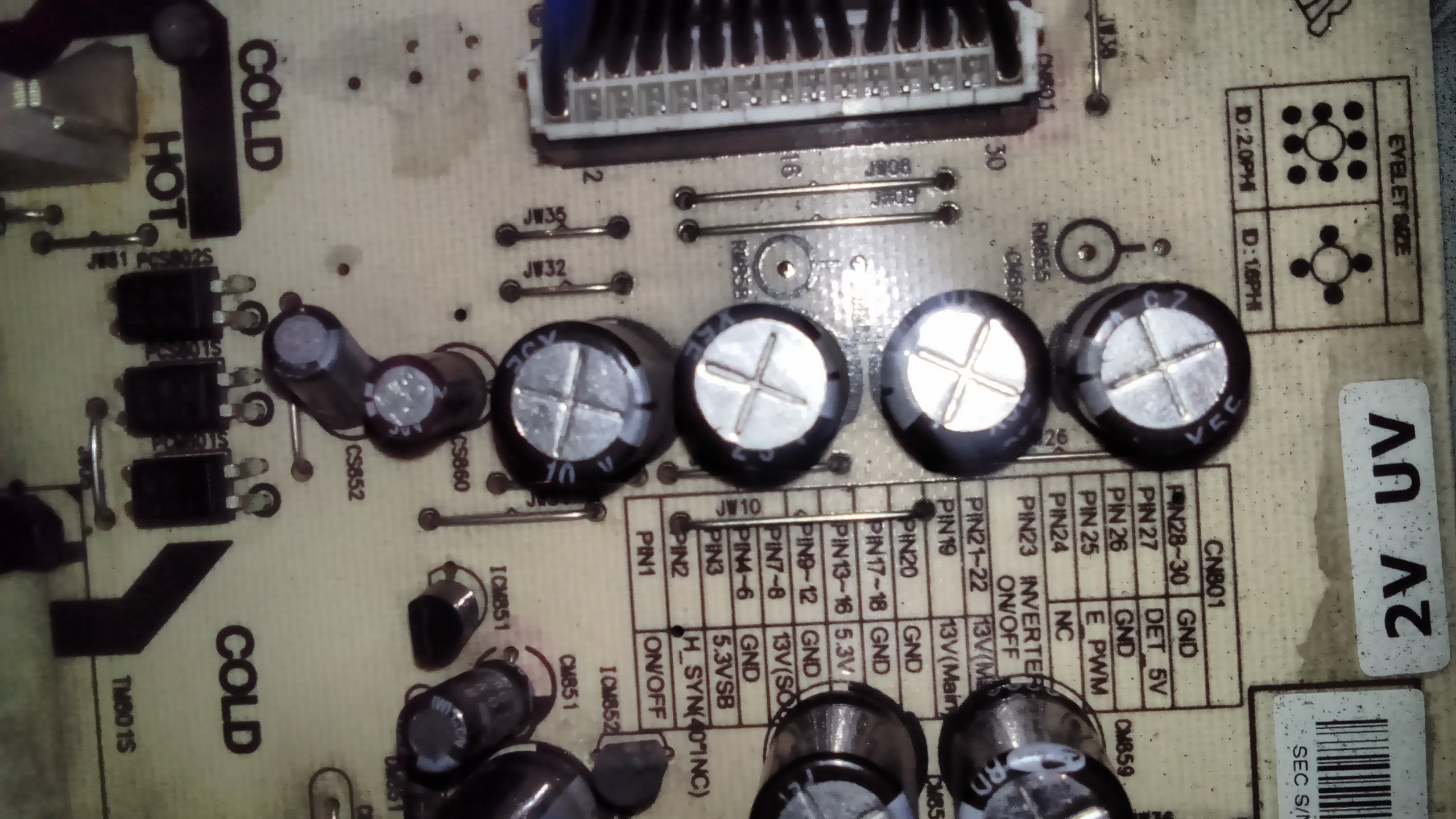

    I Have a problem with this tv, it happens that when I turn on the picture is normal but after 10 sec it turns black but sound or other functions work fine.
    I checked all caps with an esr tester and a cap tester so no cap damage was found.
    The voltage at the two main filter are:
    tv on 380 volts tv off 290 volts.
    Checked for any other component damaged ,resistors,diodes,mosfet and at first sight found none.
    As you can see in the picture where the connector is I took the voltages when the tv is on is as follow:
    1 3.17 v 16 5.22 v
    2 2.59 v 17,18 0 v
    3 5.2 v 19 13 v
    4 , 5, 6 0 v 20 0 v
    7,8 13 v 21,22 13 v
    9,10,11,12 0 v 23 4.46v13,14,15 5.22v 24 0 v
    25 3.34
    26,27,28,29, 30 0v
    I have some doubt about the reading at pin 23 inverter on/off, is this voltage correct? Besides at pin 25 what signal is E-pwm? and finally at pin 27 I have all the time 0v.
    I will appreciatte your comments about this problem or could be the lamps or one of them?

    Copying again the reading of voltages at connector CN801:
    1 3.17
    2 2.59
    3 5.2
    4,5,6 0
    7,8 13
    9,10,11,12 0
    13,14,15,16 5.2
    17,18 0
    19 13
    20 0
    21,22 13
    23 4.46
    24 0
    25 3.34
    26,27,28,29,30 0
    At pin 27 DET_5v voltage is 0 v? is correct
    thanks

      Please put the names of each pin after the pin number so we can see what Voltages, signals are missing.

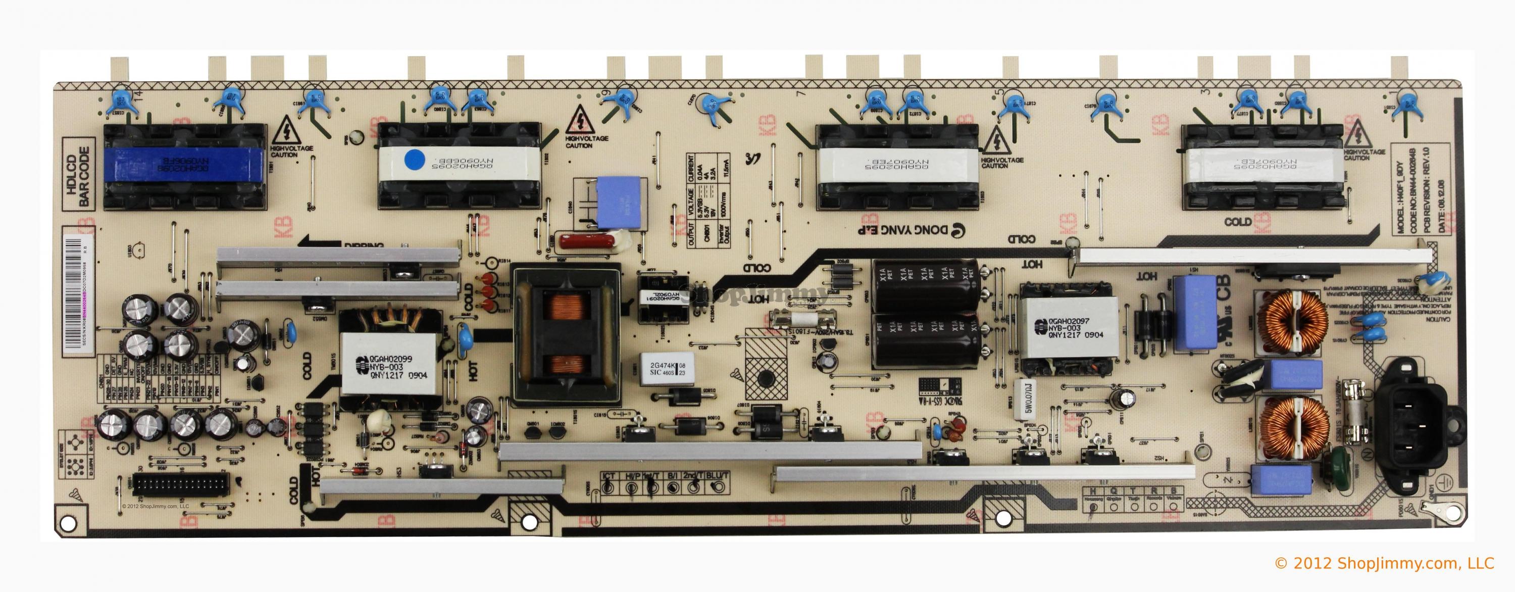

        It looks like this is PSU BN44-00264B, but I can't tell for sure. Check for cold solder joints/burn marks at the inverter transformers. It's also posible you have a bad CCFL, or more, inside the panel.

          Pictures are not well focused to read the board P/N, BN44-??????
          I suspect bad inverter transformer as well.

            Here are the name of each pin and voltage with tv on and effectively the board is BN44-0264B.
            1 3.17 ON/OFF
            2 2.59 H_sync
            3 5.2 5VSB
            4,5,6 0 GND
            7,8 13 13V
            9,10,11,12 0 GND
            13,14,15,16 5.2 5.3V
            17,18 0 GND
            19 13 13V(MAIN)
            20 0 GND
            21,22 13 13V(mAIN)
            23 4.46 INVERTER ON/OFF
            24 0 NC
            25 3.34 E_PWM
            26 0 GND
            27 0 DET_5V
            28,29,30 0 GND
            thanks for your help
            mloo55

              It has all the correct Voltages and signals, so did you look real close at the inverter transformers to see if one or more of them has a sign of over heated, you need to look at both sides of the board.
              You also need to check the resistance of the HIGH vOLTAGE Winding of the inverter transformers to see if one or more than one have bad readings.
              BN44-00264B
              https://www.badcaps.net/forum/showth...ht=bn44-00264b
              http://www.shopjimmy.com/qgah02095-i...ansformer.htm#
              http://www.shopjimmy.com/samsung-bn4...wer-supply.htm

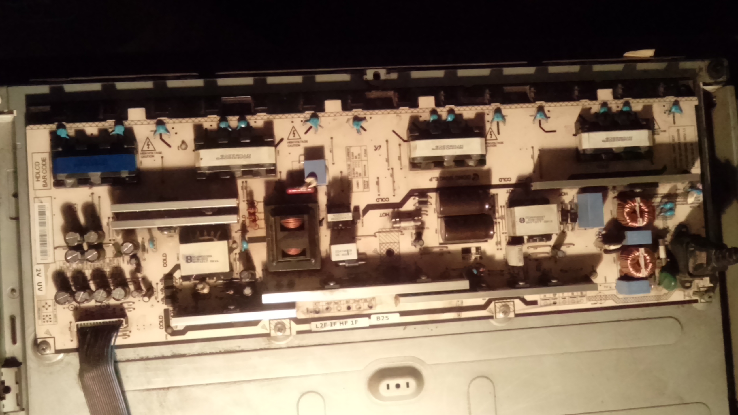

                    I checked all inverter transformer and no signos of spots por something like it, all hace the same resistance readings.
                    The voltage at the on/off inverter pin is the same all the time as the tv is connected to the outlet.
                    I resoldered several points but the problem continúe. By the way, I have not replaced any ñamp until this momento mayor you indicate the steps to reach the lamps forma this tv.

                      I'm betting you have a bulb that is failing or has already failed. Open the panel and take a look.

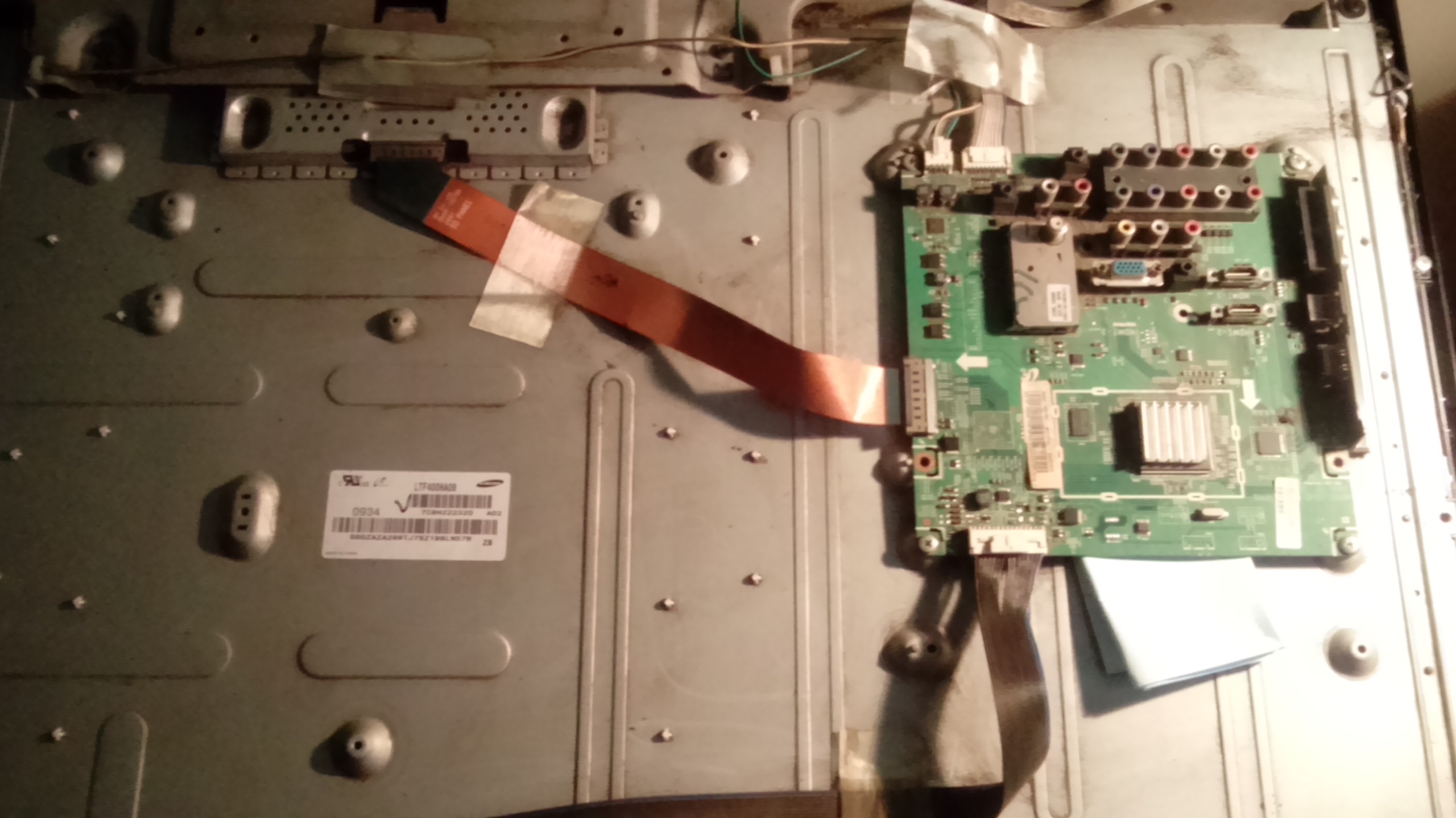

                        I need your help for this task, how to reach the lámps? I removed the back cover and found the two boards so can you letra me Know what is the next Step or Steps.
                        Rgds
                        Mloo55
                        • johnboy1313
                          • Nov 2012
                          • 1959
                          Re: Samsung LN40B530p7 sound ok picture inop
                          You'll need to remove the plastic frame from around the panel. This will expose a metal frame surrounding the screen. Remove all of the screws holding the metal frame on. Remove the metal frame. Carefully lift the screen and store it flat, away from any chances of being broken. You will then see another plastic frame that will need to be removed. Then remove all of the diffuser sheets. Keep them all in order. They need to go back in the way they came out. This will expose the lamps.
                          • MLOO55
                            • Jan 2016
                            • 14
                            • Peru from a city named Jauja
                            John, it means i have to remove the black bezzel which in the front so i can reach the lamps by this side no from he back,is correcta?

                              Correct, you'll have to go in from the front.
