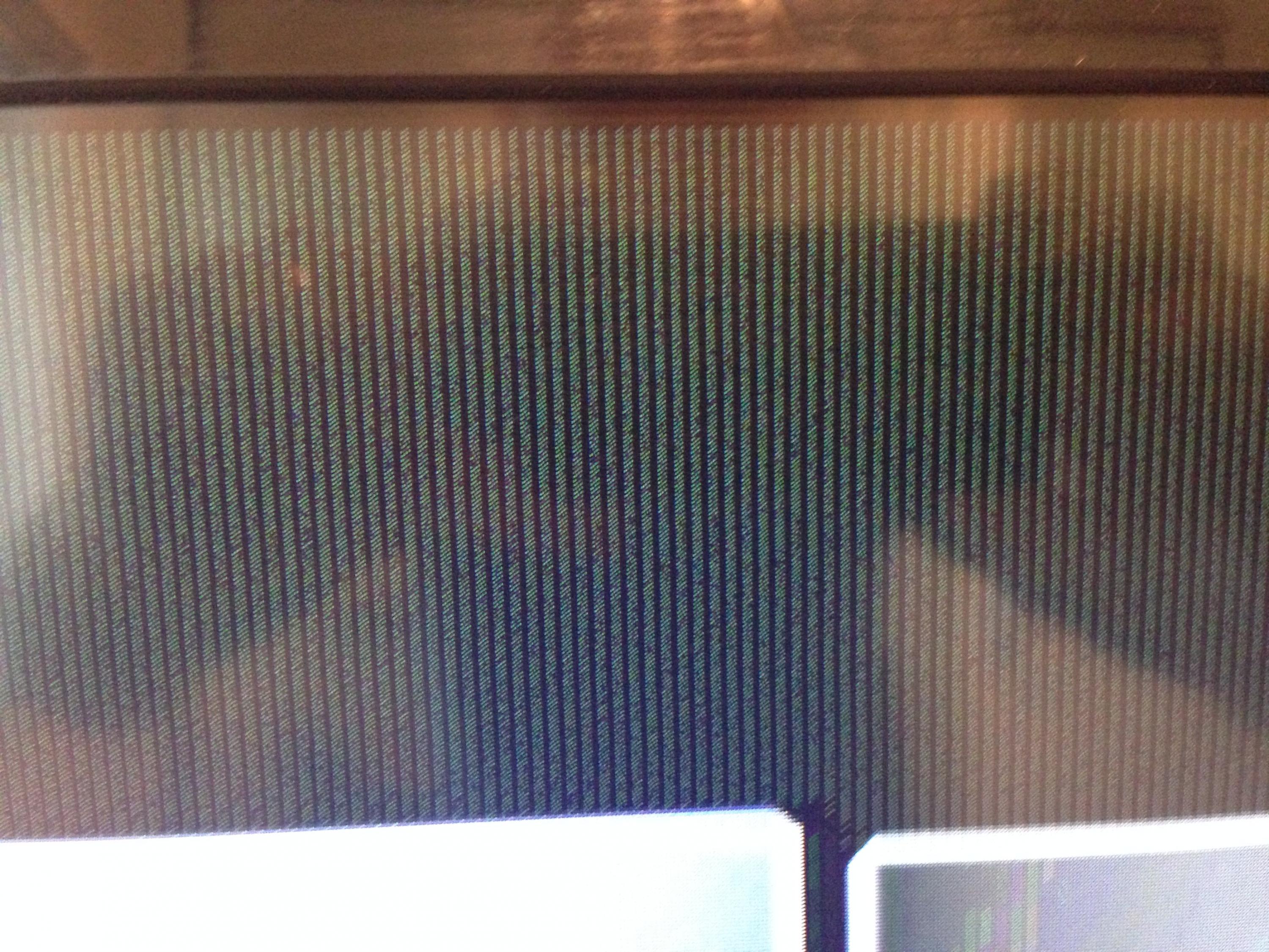

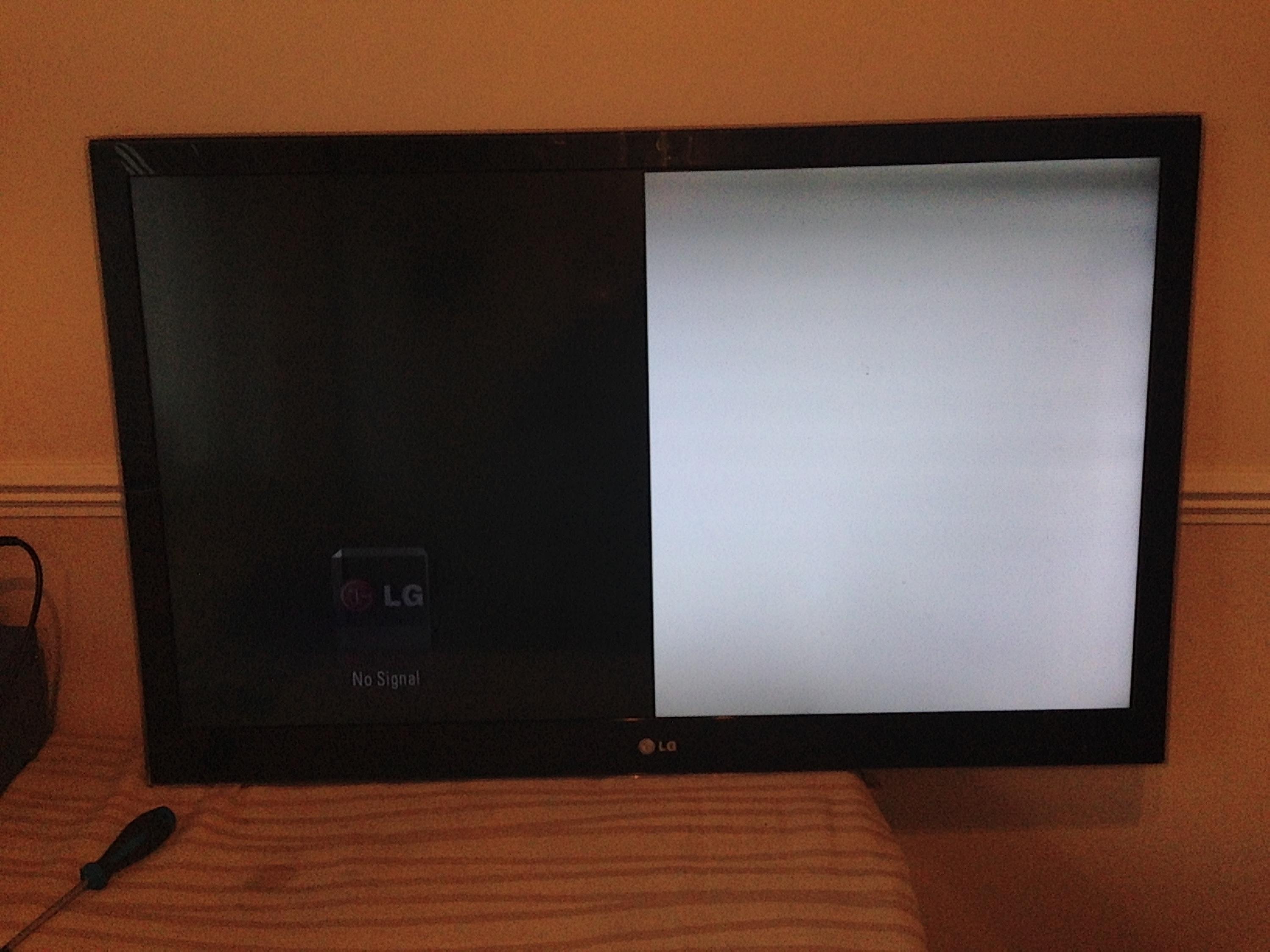

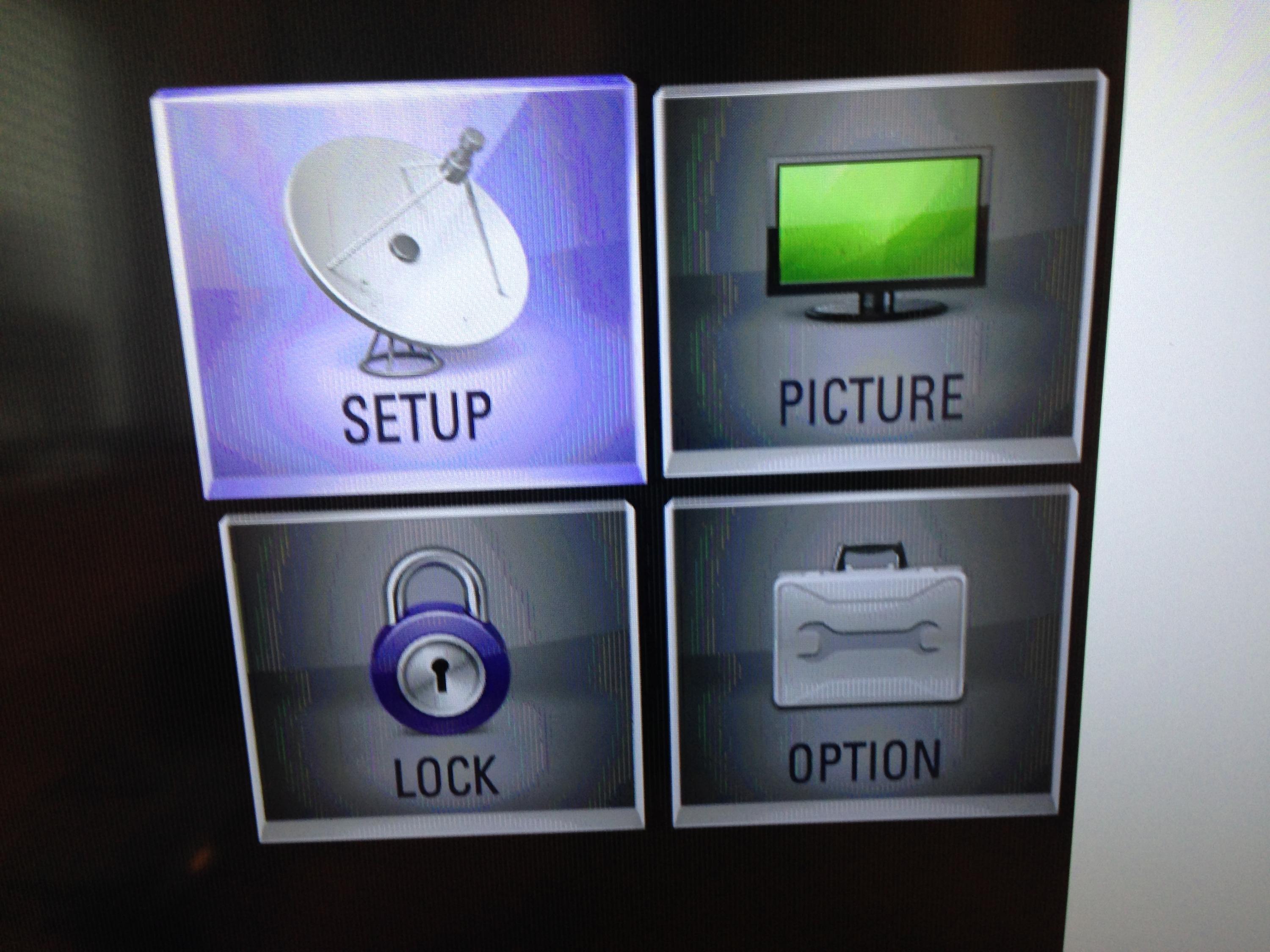

        ok, tryed removing ribbons from screen to t-con one at a time and got half screen picture,
        the side that shows the picture is grainy, very close lines running down the screen, i have now been able to get some pics up of it,
        so looks like a T-CON is needed,, would you agree ?

          Re: LG 42LW450U, no picture
          Bad Panel Fin
          • CapLeaker
            Leaking Member
            • Dec 2014
            • 8340
            not good... lines on the black side = bad panel.
              Originally posted by ReeceyBurger123
              Bad Panel Fin
              yep, agreed. down the dump with it tomorrow then
