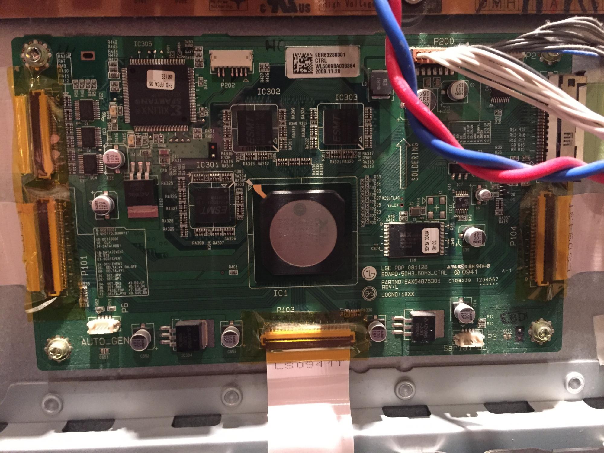

    Hello everyone.
    First time repairing a tv. As above my LG 50PS3000 has suddenly stopped displaying the top half of the screen, like the attached picture.
    After a little reading I figured it would be the top buffer board so I replaced it but still have the same problem.
    I watched a video on YouTube about how to test a buffer board and have tried testing them both and they both seem to be ok. Not sure I was doing it correctly though!!!
    My question is, what else could it be? And how do I test to see what it is?

    Most likely it would be something wrong with the signals going to the top buffer since you have ruled out the buffer itself, that would point to control board or possibly main board. It is also possible a damaged or loose cable could cause this so it is worth checking those. (The cables can corrode if the air is humid, or come loose if the TV is moved or over time due to thermal expansion.)
    Can you see if the white lines go away on a completely black screen?
    Have you tried activating the test pattern mode? (It requires putting a small jumper wire across some pins on a board.)

        Can you post a picture of your control board?
        It's the green board in the centre of the set - has a load of white ribbon cables coming out of it.
        Also, check that you connected the cable between the two buffers correctly. If that's loose weird shit can happen.

            Ok so I checked the connections and all seem OK. I did notice however that the lines on the screen are far less with the replacement buffer board than the original one. I don't know if that means anything or not? I have included pics as well as a pic of the control board.

                Run the test patterns like Tom said.

                      Remove Lvds cable, on cntrl board there are a few pins that stick up jumper/short them out thwn turn Tv on. Screen will flash Red,white, blue etc.

                        its the white block that has AUTO GEN under it, in the bottom left of the t-con, as in your picture, but cant remember the 2 pins to short,

                                Ive had that fault--Replacement y-sus fixed it....
                                I think it as one of the octal-buffers on the y that had gone...

                                      So i decided to get a new Y-sus board and fitted it this morning.
                                      It has worked but I now have a single black horizontal line right in the middle of the screen!
                                      Any ideas?

                                        Reseat the buffer-tabs from screen to buffer-boards in line with the defect--they are quite a fiddle to do--And delicate....
                                        --They dont click in when fully home--they sorta 'nunk' in--You'll know what I mean once you've done one right...
