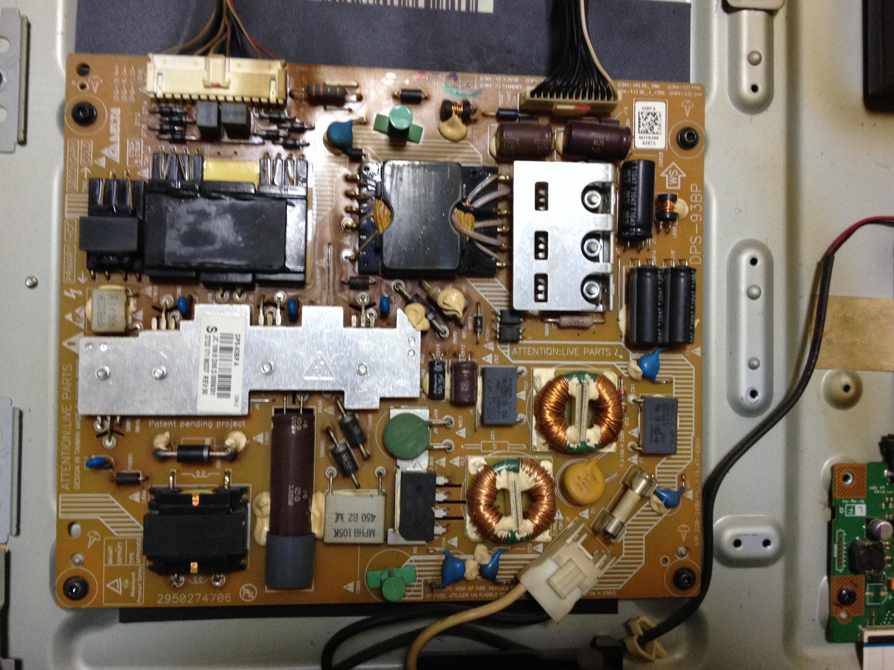

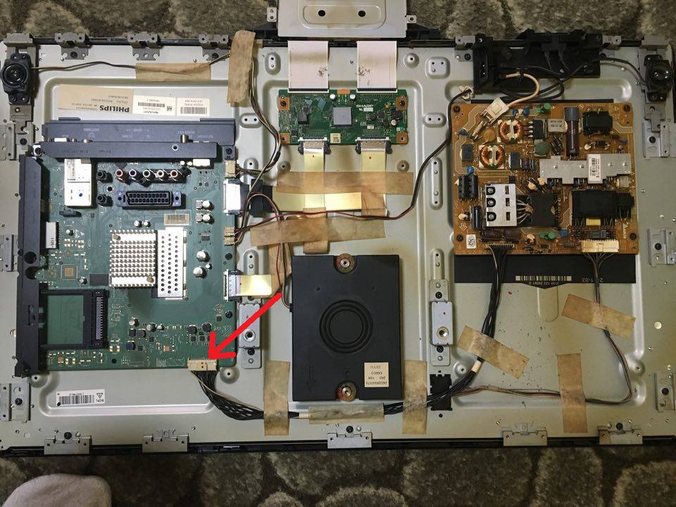

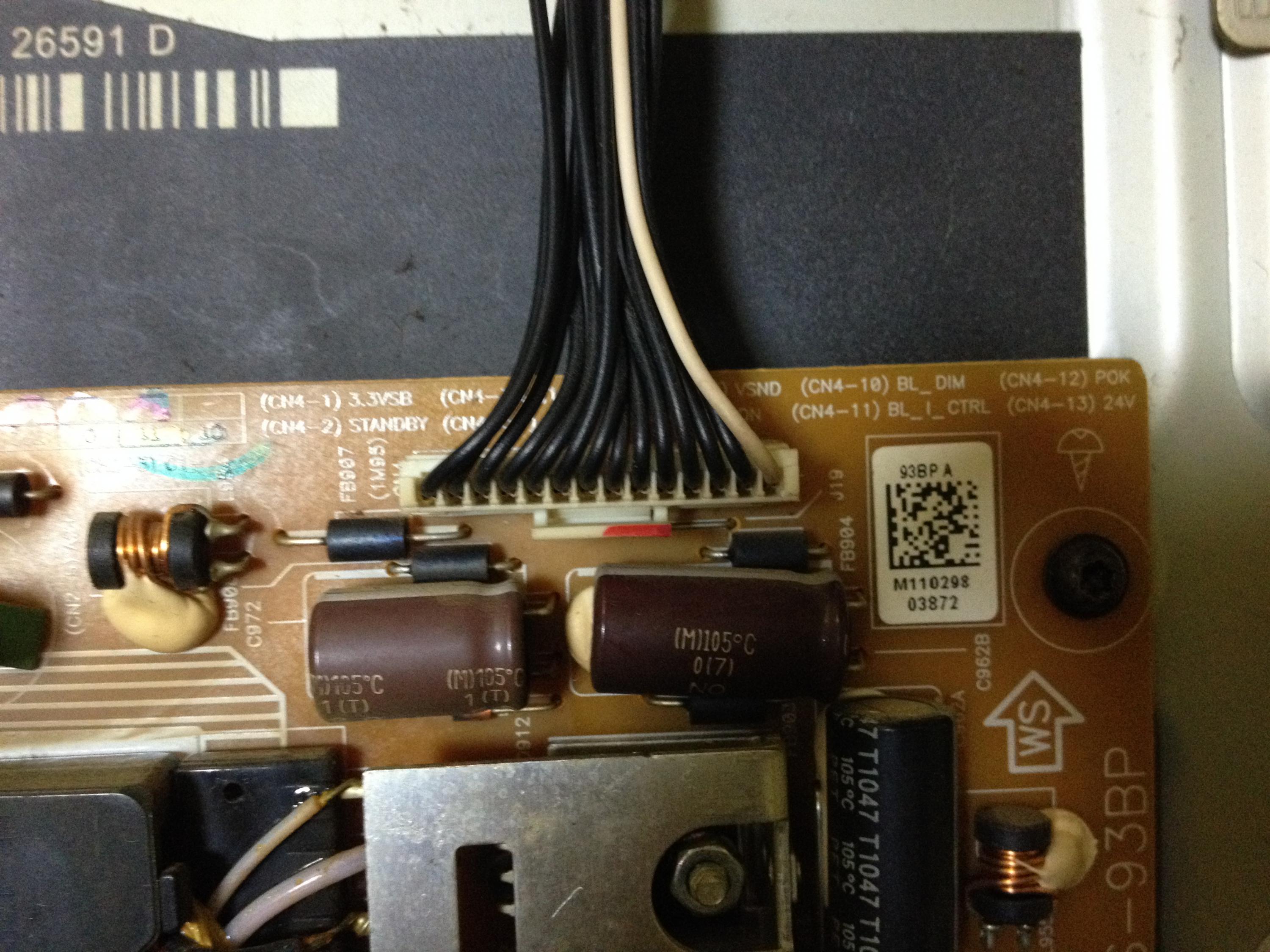

      So i checked the voltages here(as i shown on the picture).FIrst pin should be 3.3V , fifth and sixth 12v and 13th pin 24V. When I turn the TV on all the voltages are good,but after 1min all except the first(3.3V) give me 0V.Maybe there is a problem with the power supply board ?
        Re: Philips 32PFL6606H/12 problem

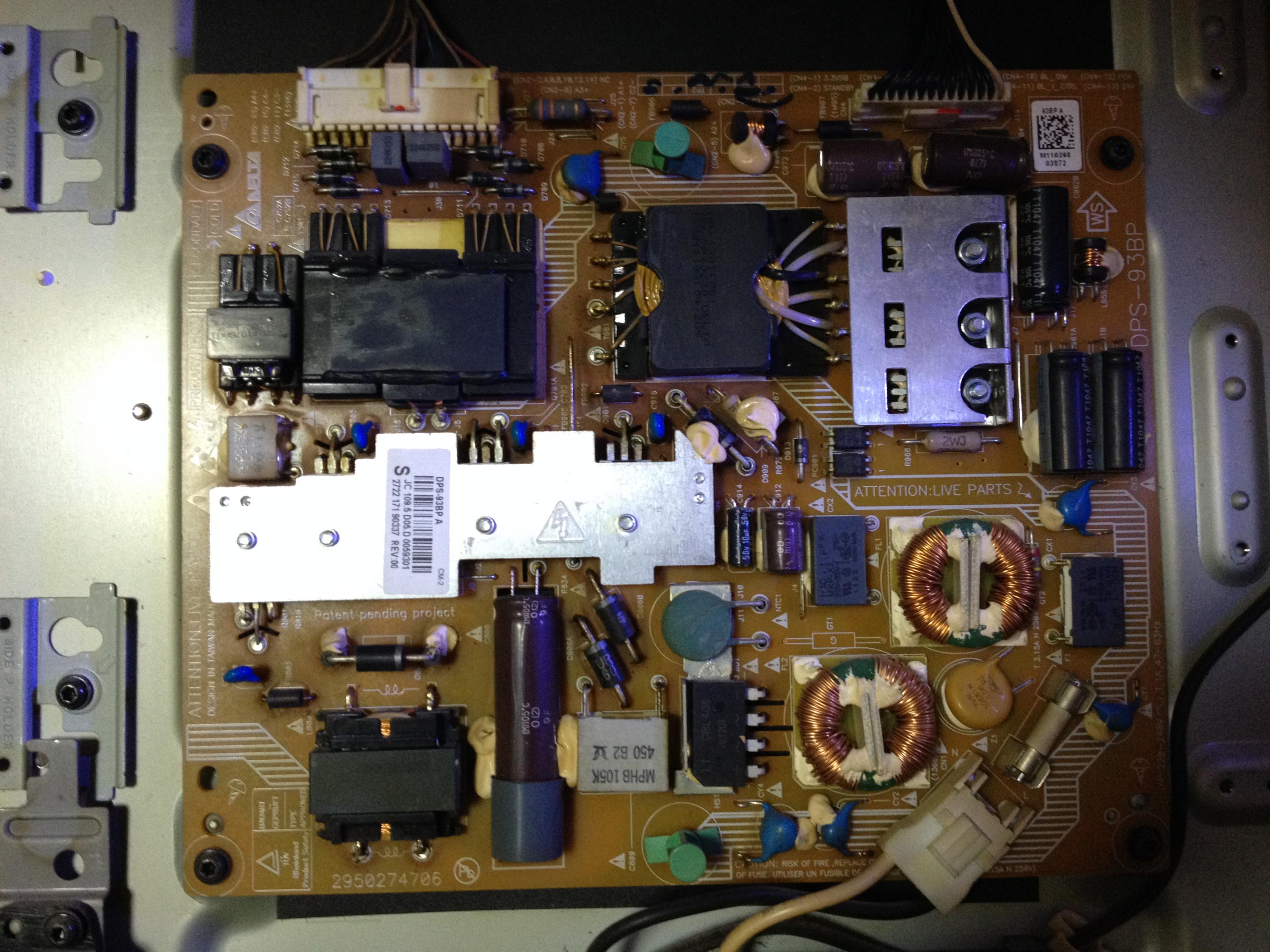

        I think its a powersupply problem , well at least the inverter in the PS. Can you give us a close up of the PS?
          supply

            Sorry,my mistake. The TV was on stand by when i checed the voltages. When I turned it ON from the remote, all the voltages were fine! So I guess that is not the problem.What else can I check?
