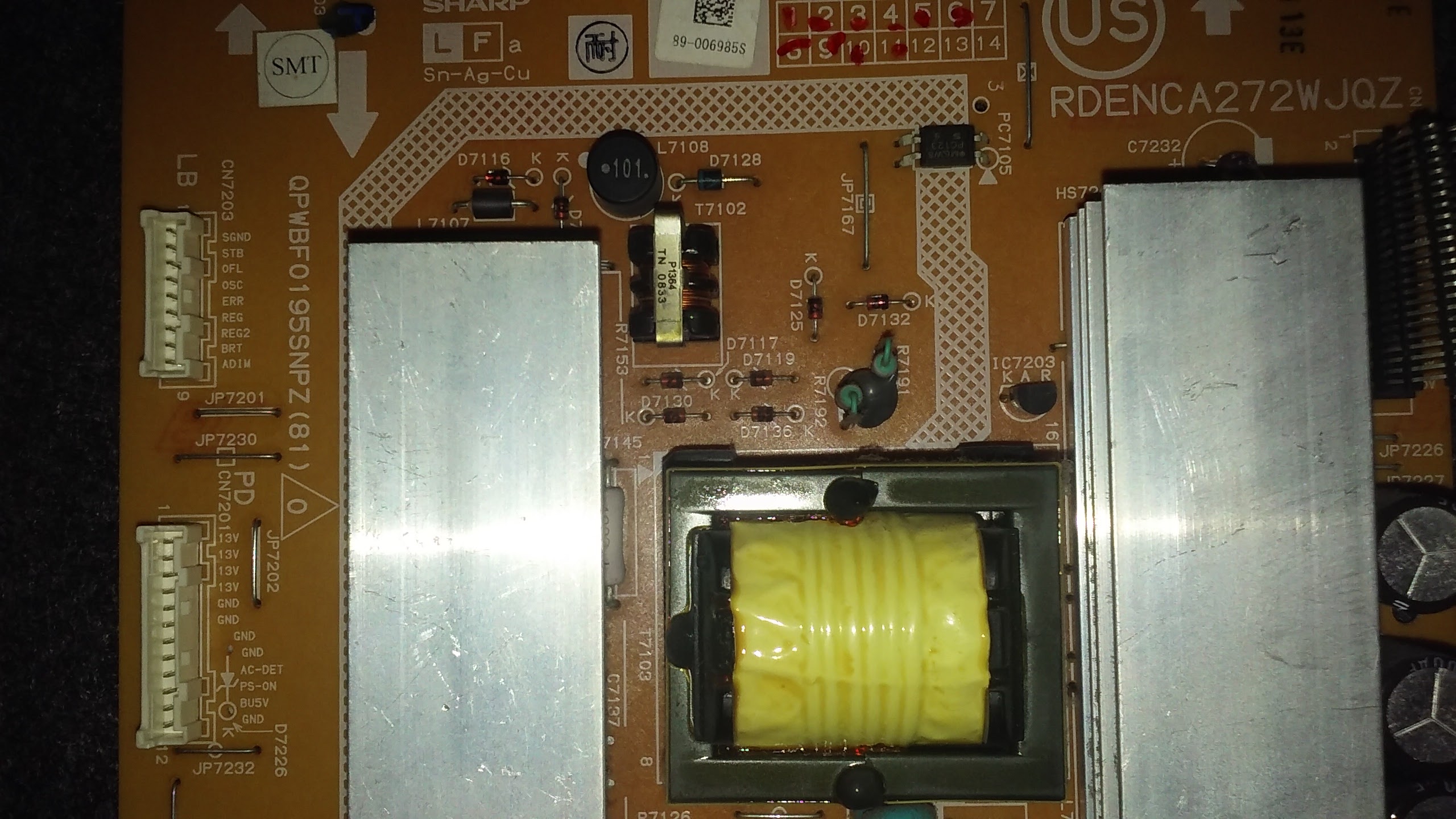

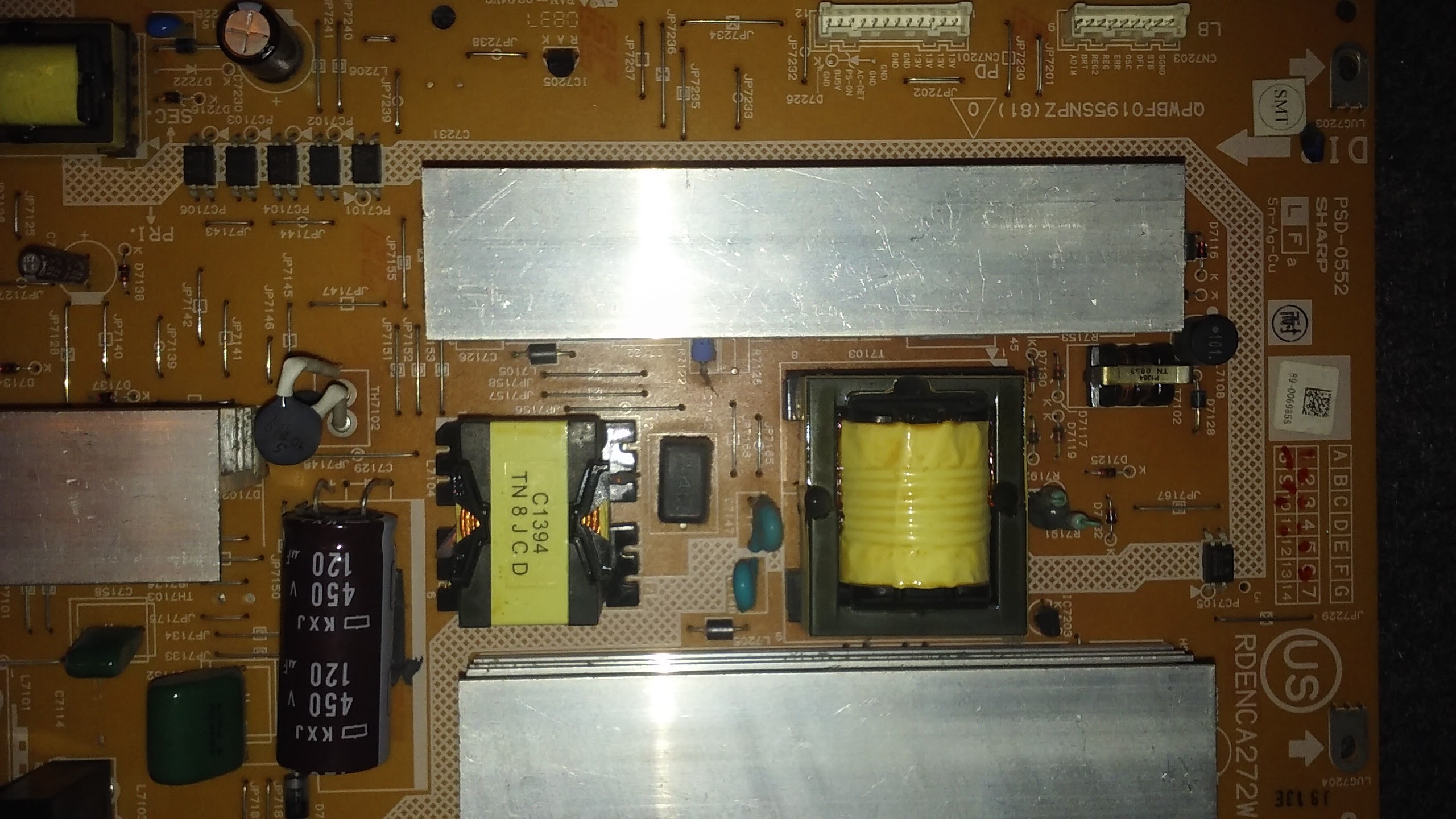

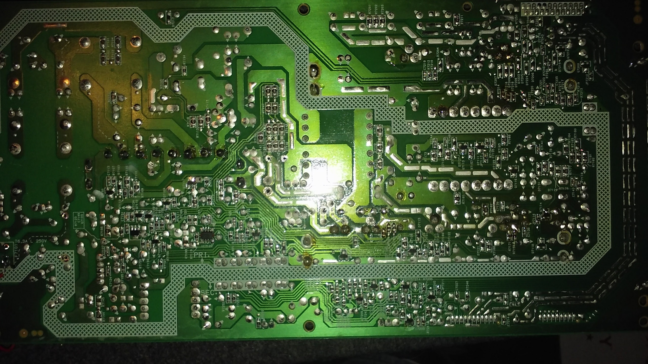

    the televison does not seem to power on i guess i am wondering how to go about troubleshooting the power supply board as this one is a bit different than others i have troubleshot or dealt with when i plug it in the power light blinks steady off and on for one second if i hold the power putton the power light turns to red and if i hold it again it turns to orange and makes a clicking sound as if it is trying to power up i do not have any voltage coming out of power board to processor/tcon board unless the orange light is on i have tried unplugging the inverter and then the power button will not make a change i am affraid of testing the power going to the inverter board as it seems to be un insulated wires and i do not want to short it out

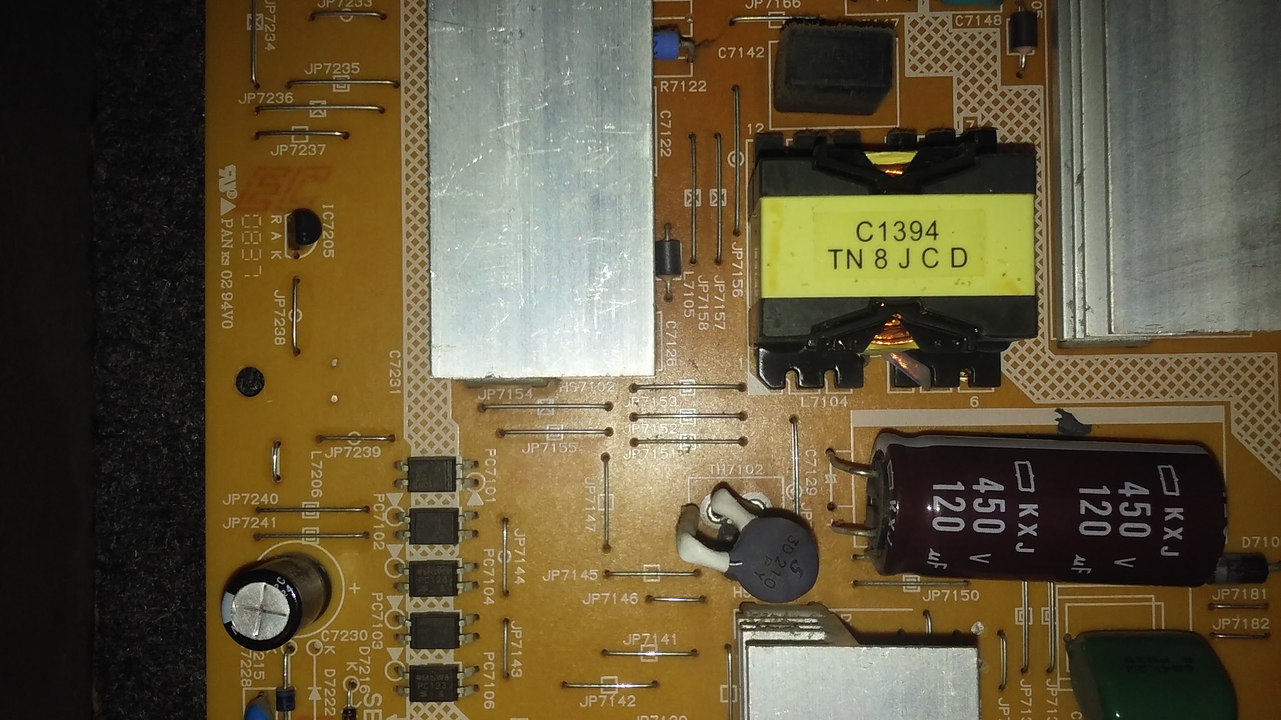

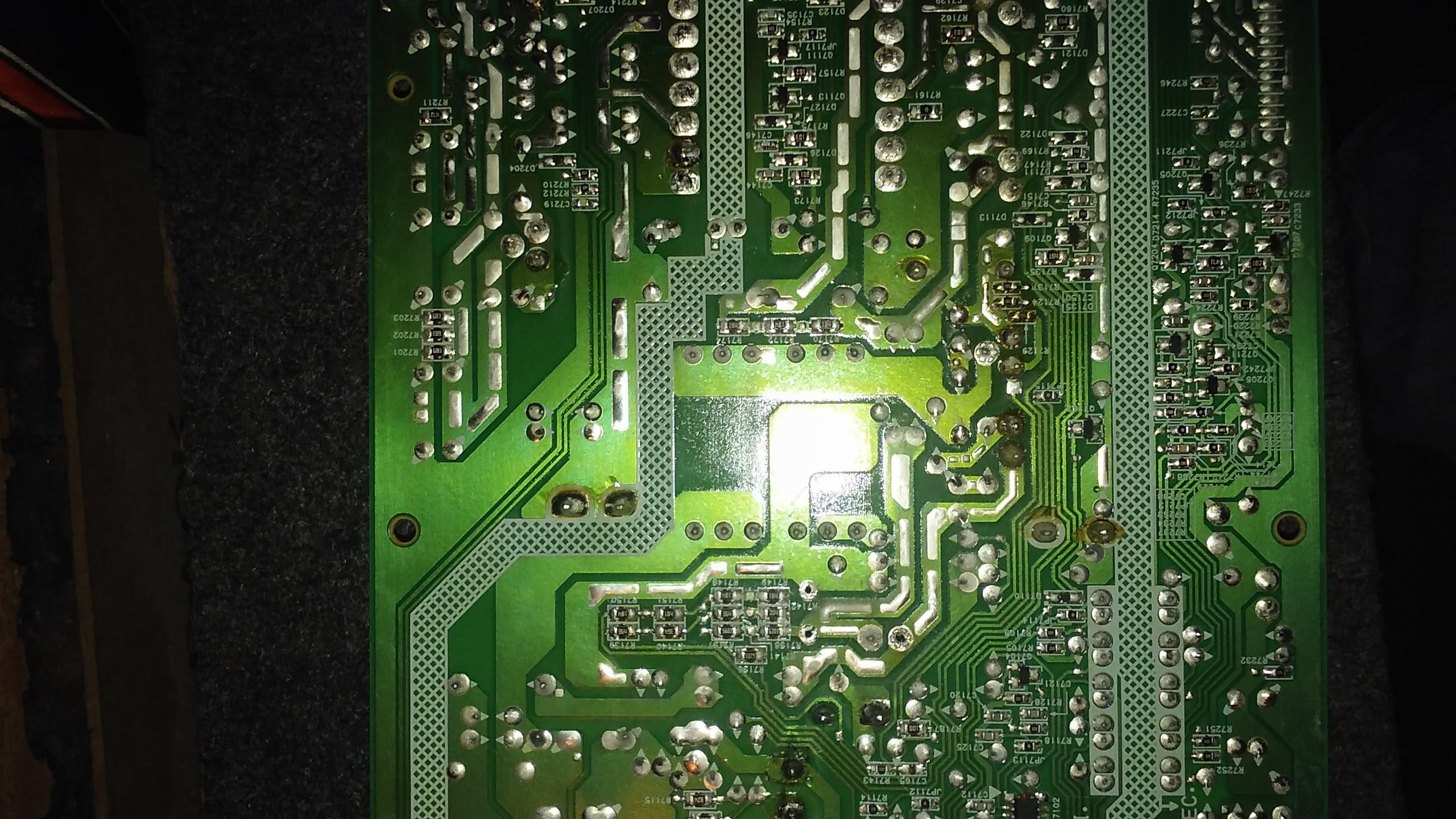

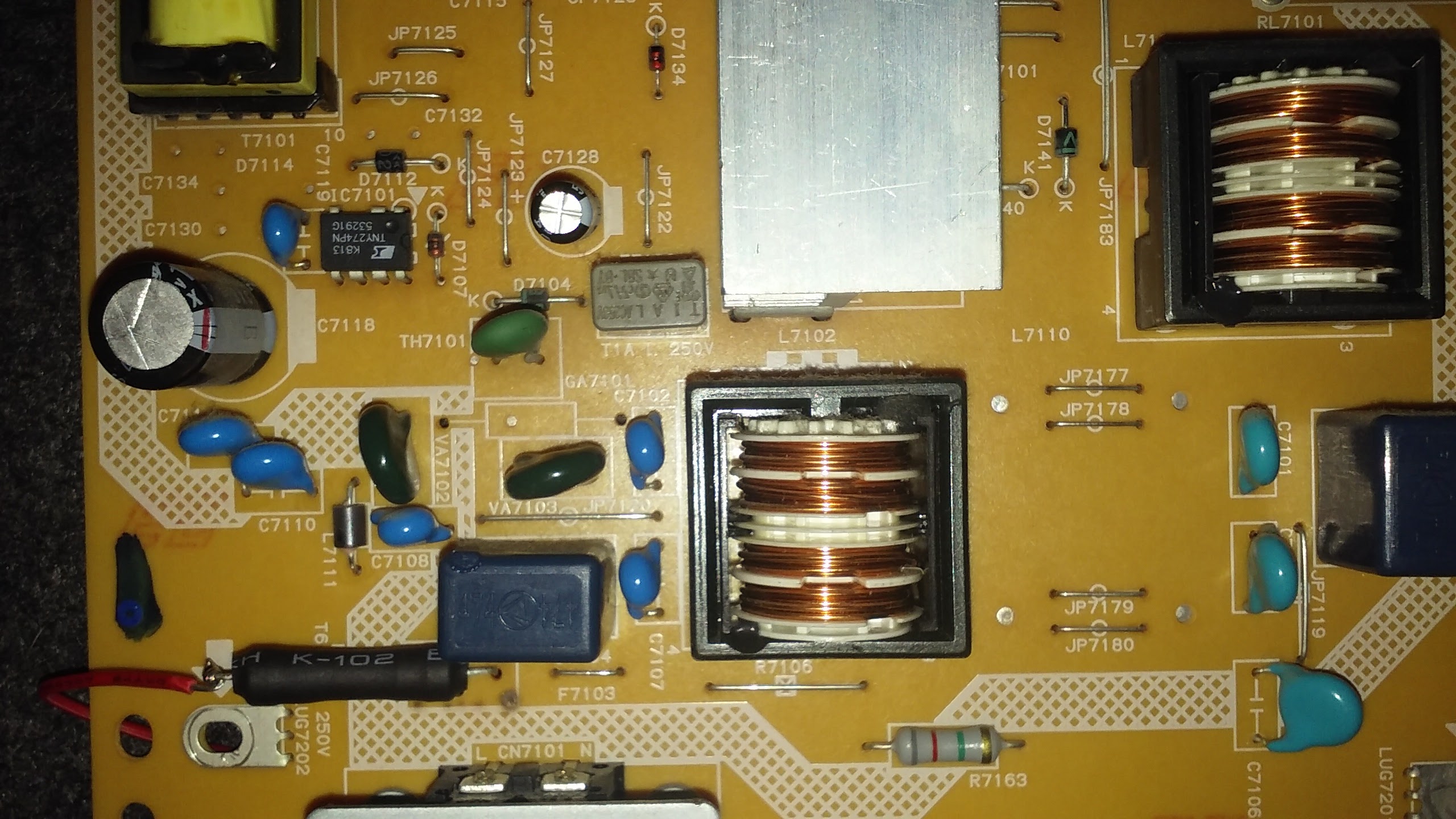

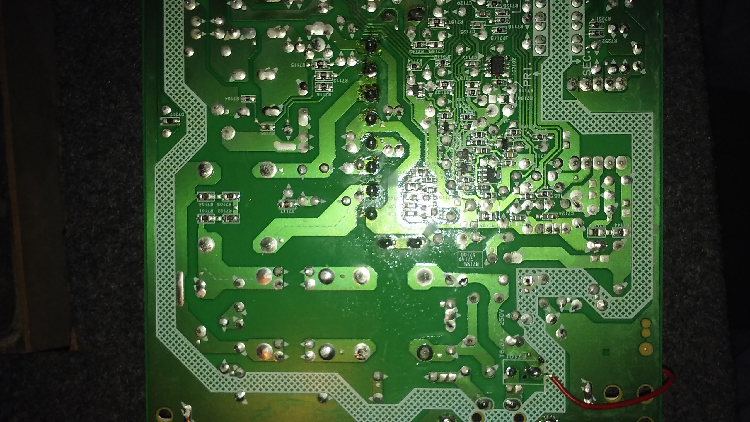

      on the power supply i an not getting any voltage at the filter capacitor i am getting 150 out of the bridge rectifier and cannot seem to find what is in between (im a noob) any help would be awsome
      the thing that has me stumped now is how does the led on front blink with no power to main filter capacitor

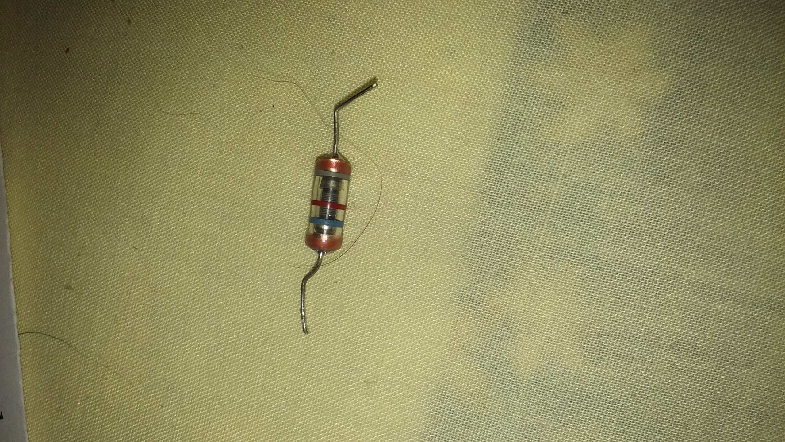

      also attaching a picture of compoinent i found with no ohms
      i did bump ground when measuring the bridge rectifier and blew the fuse (didnt have a square only buss type so i soldered on board until i get replacment

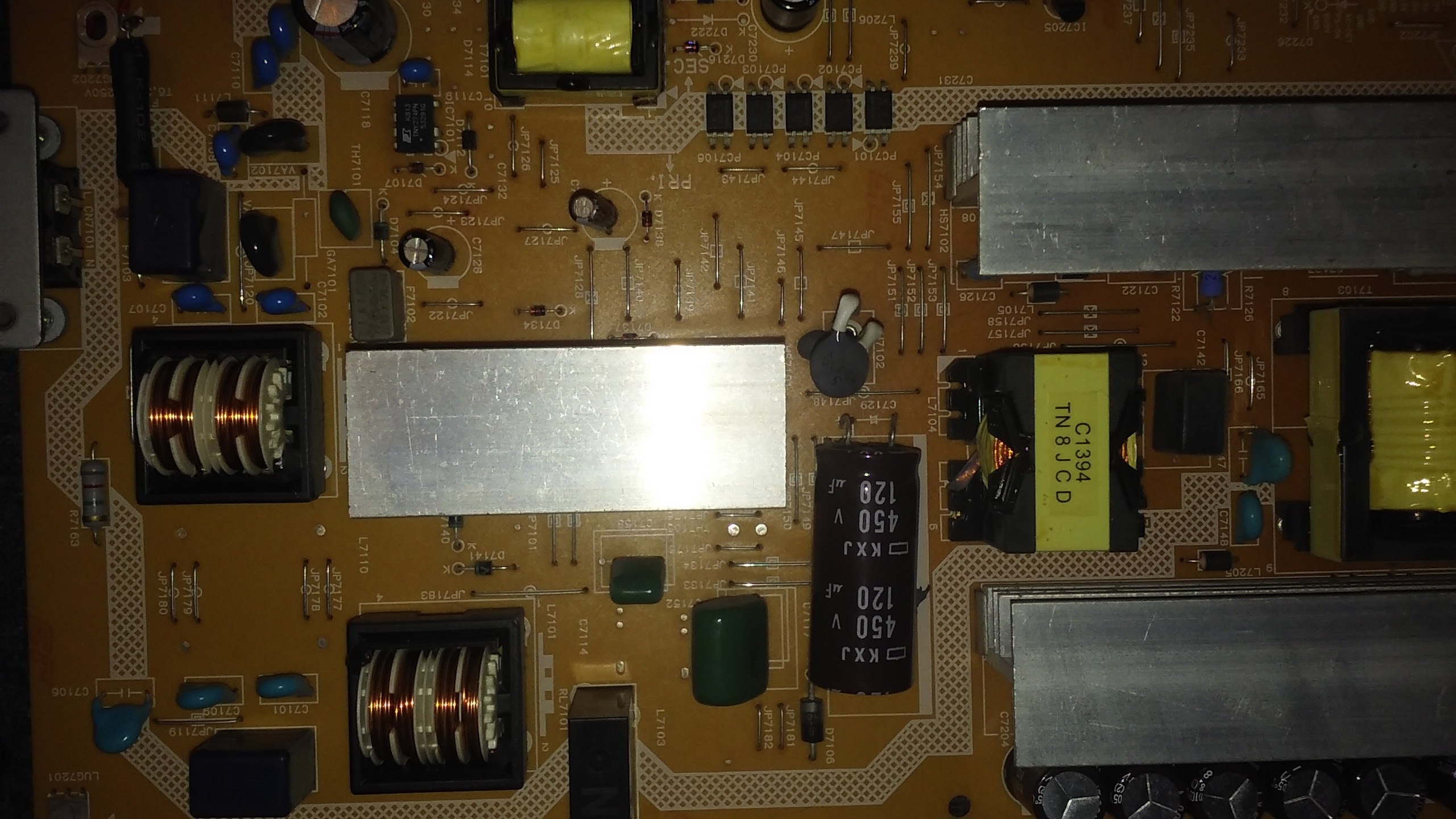

        i have tracked down that the relay that turns on the filter capacitor is not closing to get voltage to the filter capacitor....i have had no luck in finding a proper service manual for this either if any one has any direction i can go or knows where to get service manual

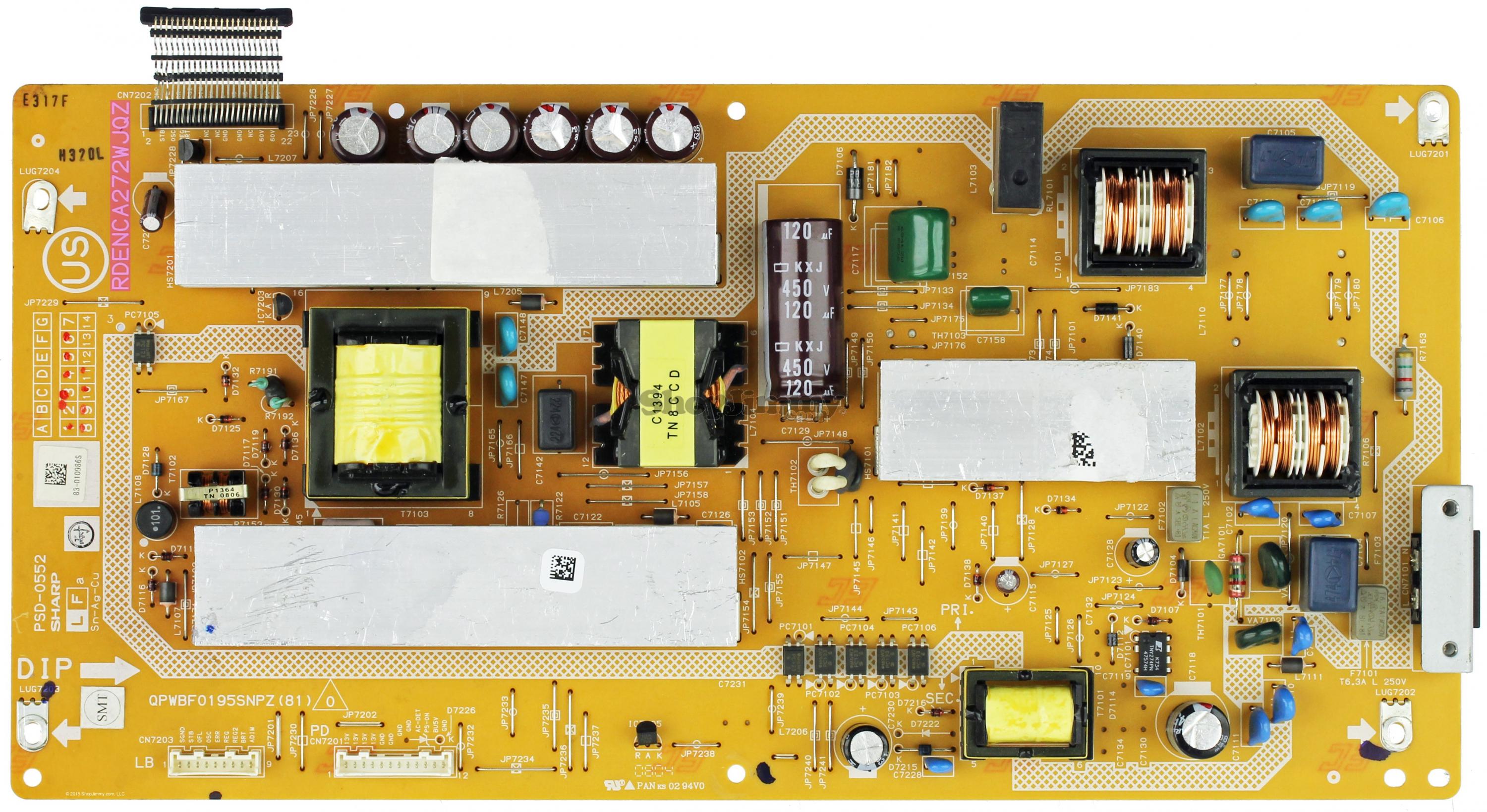

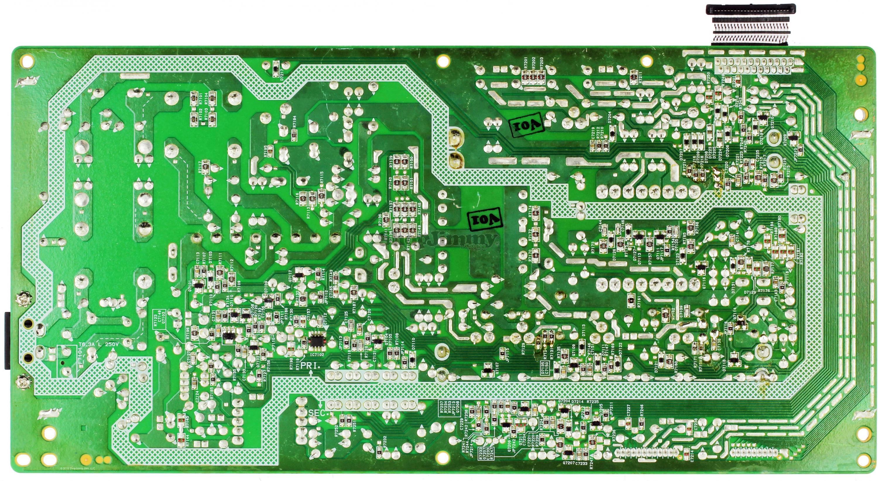

          The relay RL7101 will not turn on until the main board sends the ON signal to the STB pin of the CN7202.
          http://www.shopjimmy.com/sharp-rdenc...pply-unit.htm#
          Sharp RDENCA272WJQZ (PSD-0552) Power Supply Unit.
          Pictures provided by shopjimmy.
          So what DCV do you have on the STB pin?
          This is going to be tough without proper service manual.

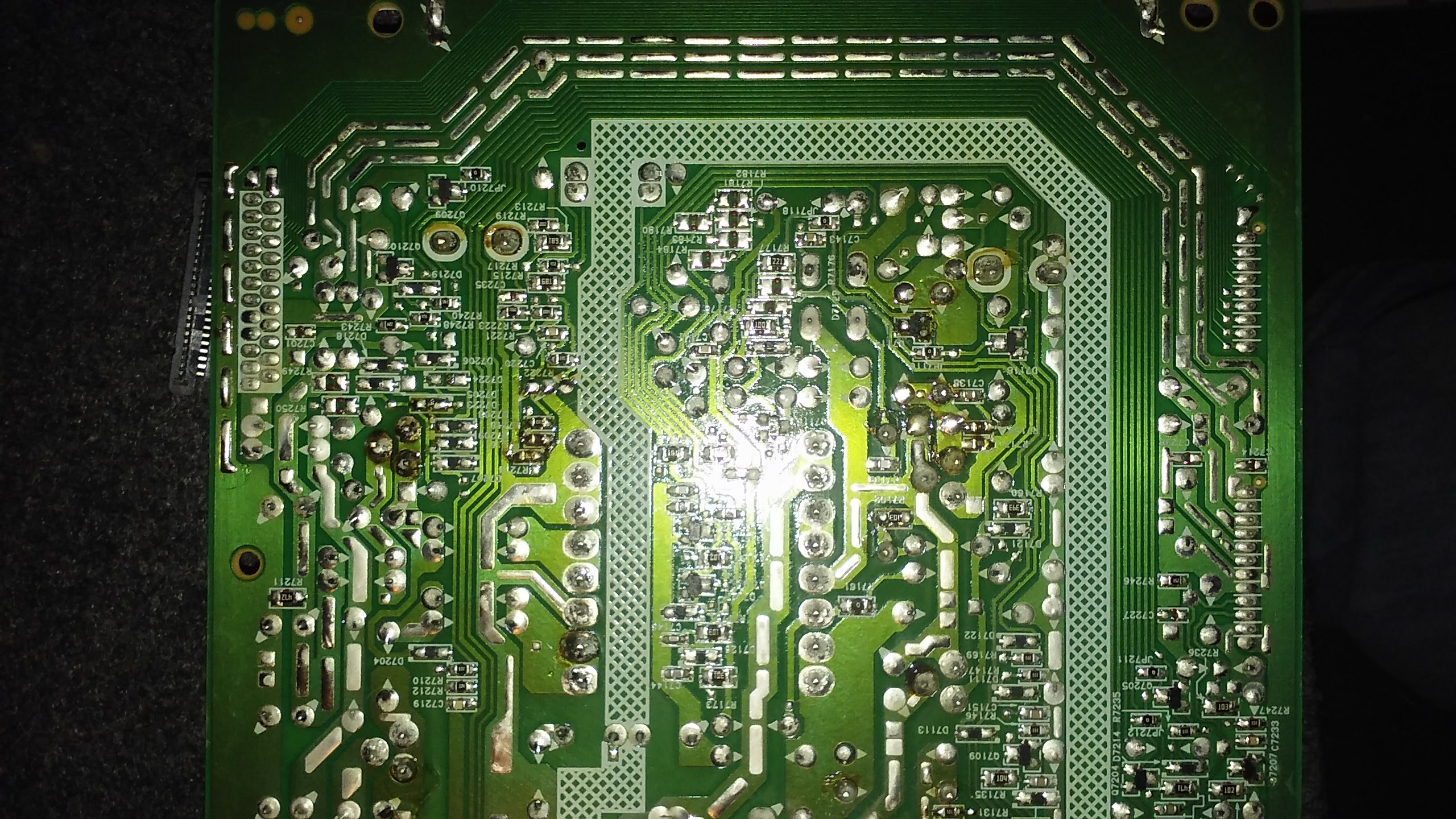

                    There is no power supply board circuit in that service manual you attached, look again, I already has that same manual.
                    See post 5 for the pictures of the board we are trying to troubleshoot.
                    Or you can upload the circuit of that power supply if you have it so we can get on with troubleshooting.
                    See the extracted PDF of SCH and PCB layout from your service manual.

                        No problem. Most service manuals will not include the pwoer supply section due to most of them use OEM power supplies made by other companies so they are not allow to release the diagrams.
                        Elektrotanya is a great place for free SCH, Tom66 the member here also has lots of diagrams.
                        Without diagram I will end up tracing the board using the pictures provided by the people that ask for help, it is very time consuming process.
