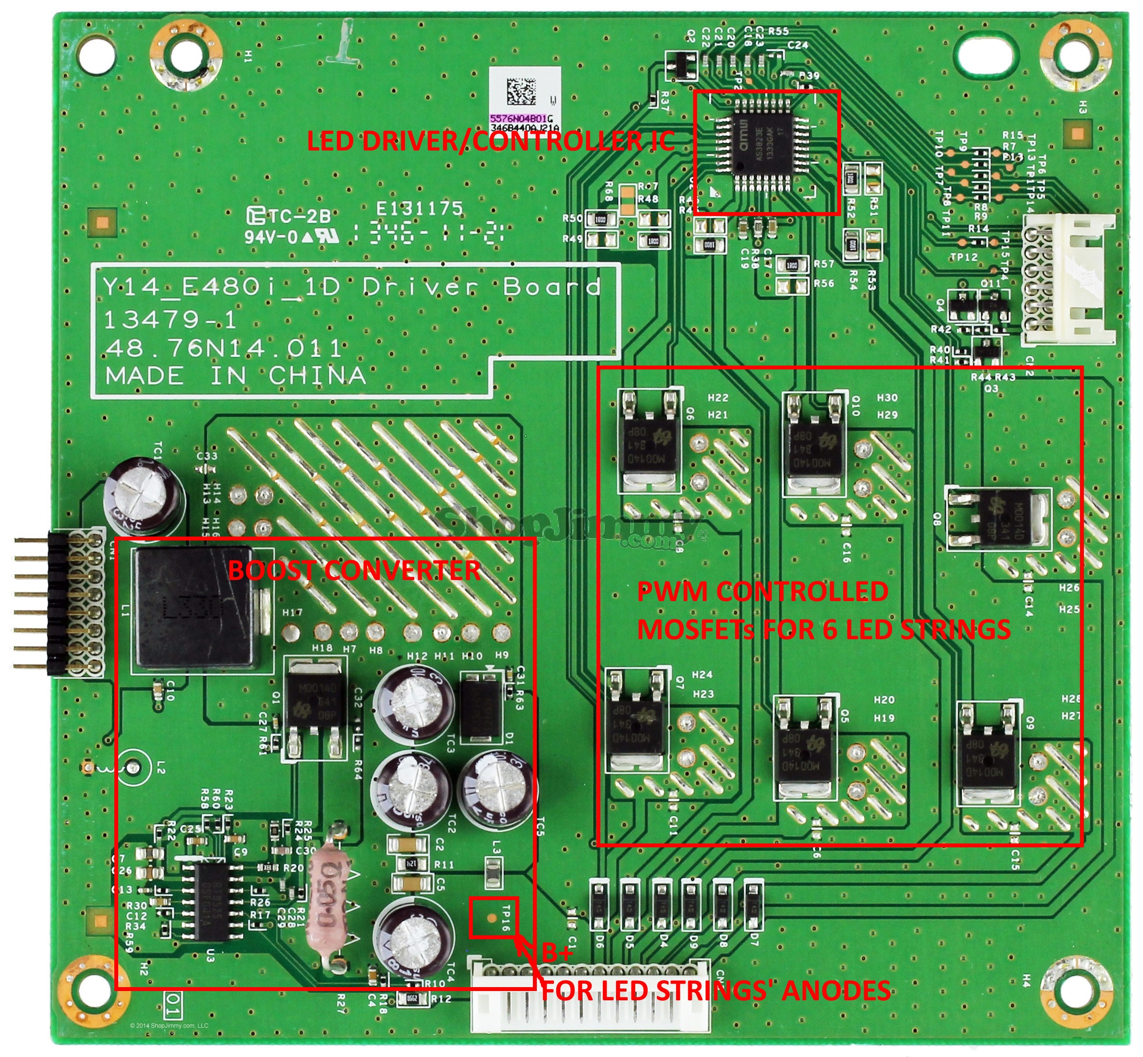

        Q1, L1, D1, Caps TC2~5 are for the Boost converter circuit to supply the Boosted B+ (connector CN3 PIN 1~6) the six LED strings ANODES (there six PWM controlled power MOSFETs).
        So put the DCV meter between CN3 PIN 1 (or Test Point TP16) to se the DCV jumps from 24VDC to much higher Voltage when the TV power switch is activated.
        Pictures provided by shopjimmy.
        BTW, please tell the rating of the caps TC2~5.

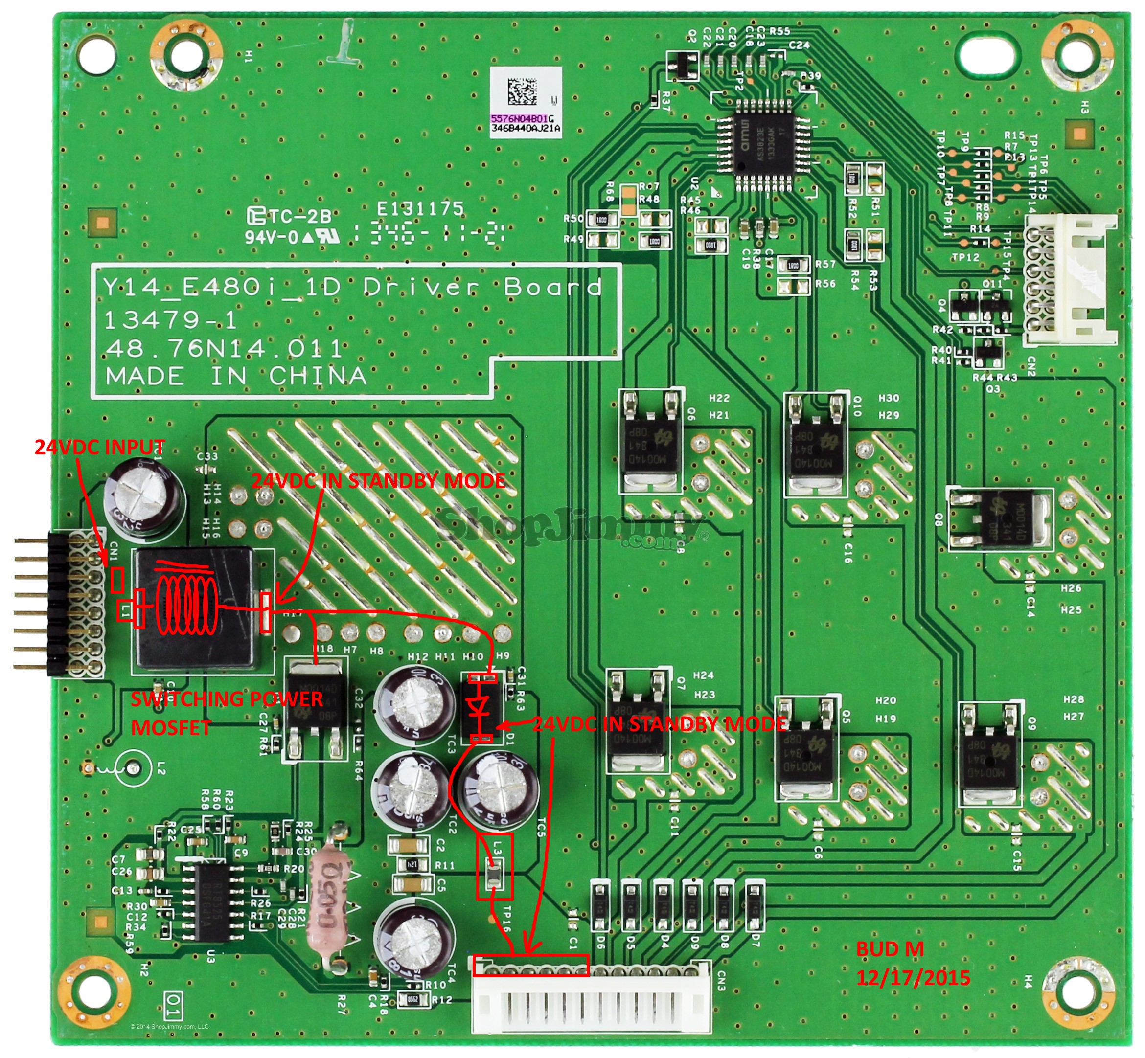

                      L1 i s the big black box that has Inductor symbol I draw on top next to 24DC input connector. The main key is do you get 24V at those points I marked in the picture.

                          So I just double checked and no I dont get 24 volts at those points except for the one side of L1 facing the connector.
                          • Nick's Tvs
                            • Jan 2014
                            • 621
                            Re: E480-B2 no backlight
                            Weird thing just happened. After soldering the l1 and l3 back in circuit and double checking my last post about the 24 volts not being at those points, the leds turned on. However I am getting 37 volts on those points. Not 24. So L1 has 24 volts on both sides d1 has 24 volts on l1 side but then changes it to 37 volts on l3 side and then pin 1 if connector 3 is 37 volts as well.

                                As I explain before, the circuit we are testing is Voltage boost converter that converts 24V to higher Voltage to drive the LED strings, if the circuit is not boosting, the output will be the same as the input Voltage as I have shown in the diagram and on the link that explain how the circuit functions.
                                So do you get backklights now? I have a feeling you have bad solder joints on L1 inductor.

                                    Great, glad to hear that it is working now, the Boosting circuit was not working due to bad connection on the Boost inductor L1.
                                    So now you know what to expect at each path of the circuits next time when you see boost converter circuits.
