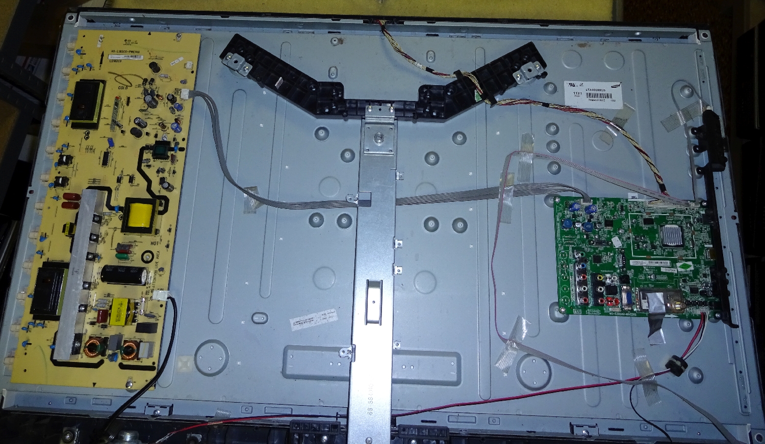

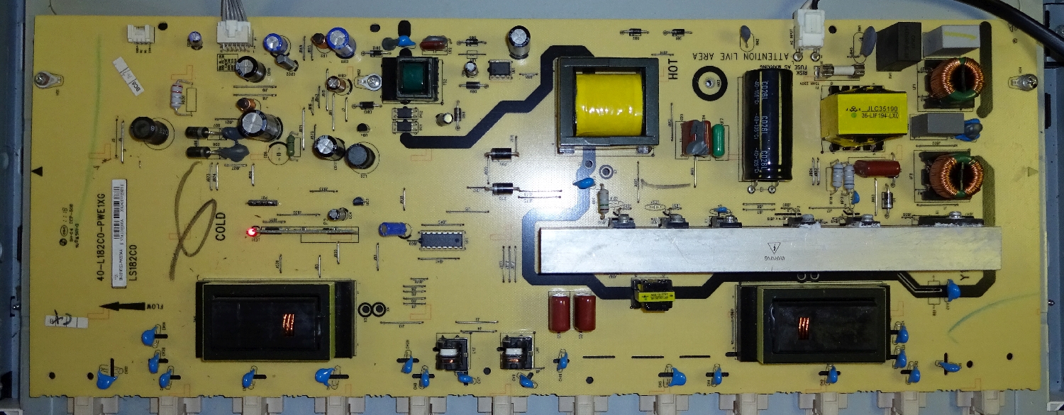

    I have a TCL TV and from what I can find out I think it's a L40FHDF11TATBAA but not positive as the sticker on the back is missing. Anyway this TV came in dead totally but I found a bad mosfet and a bad diode so I changed those and now it still looks dead except there is a LED on the power board that gives 3 long flashes and one short over and over. The set still shows nothing on the front for signs of life. I have 365v at the big cap and I only have 3.5v standby otherwise no 24v or nothing at PS_ON or BL_ON. I was wondering if I ran a 1k resistor from the 3.5 to the ps_on and bl_on if it would force backlights on?? Not sure how to go about this one since I never heard of TCL and can't find any guides. The power board is 08-LS182C0-PW200AA Much appreciated for any advice.

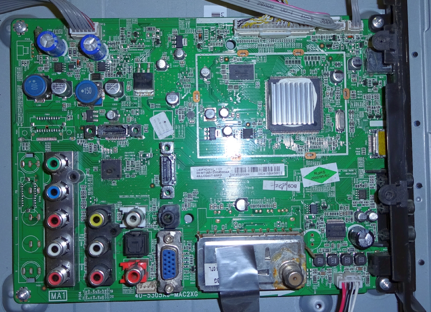

          I see a chip on the mainboard that has a chunk blown out of it.
          It's at the middle of the left hand side of the picture, by the HDMI ports.
          Edit: Looks like there might be an 8 pin chip that is burnt as well, on the far right side of the image (on the mainboard pic). It has a little bump on it ... might just be dust or flux, but I just wanted to point that out.

            Good eyes ben7 you are correct. Don't know why I did not see that, must be my old eyes.

              That chip with hole--looks to be HDMI Controller....
              Typical issue when people plug/unplug HDMI's when the things are powered up! HDMI ISNT HOT Plug/Play--No matter WHAT they say!
              Prob not worth sourcing/replacing the chip--there'll be other damage I guess too. New Mainboard time...

                  Yep, out of stock and only 1 on ebay out of the country and the TV is not worth the repair so another one hits the scrap heap. Thanks for the help guys!! Always appreciated!
