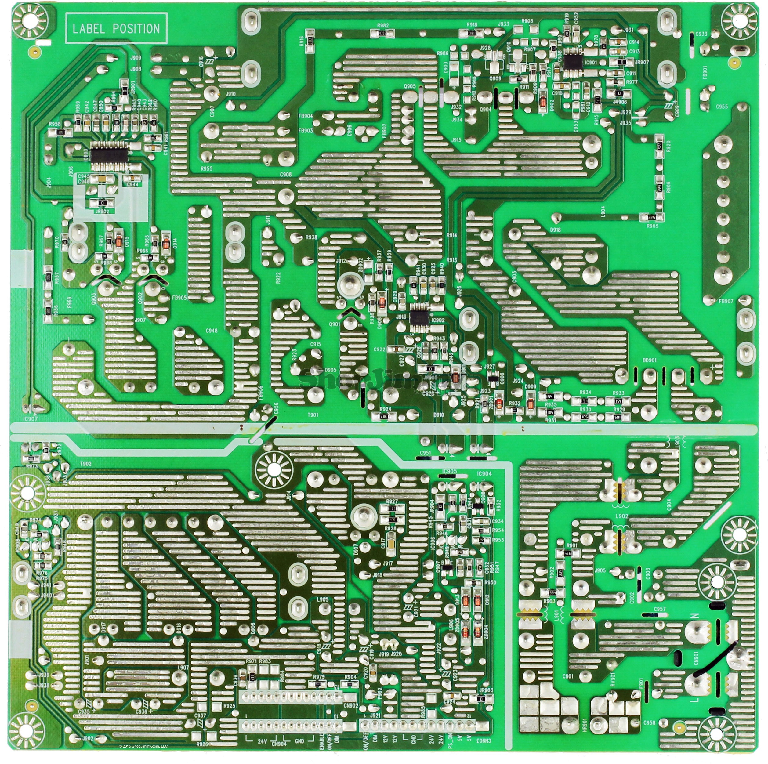

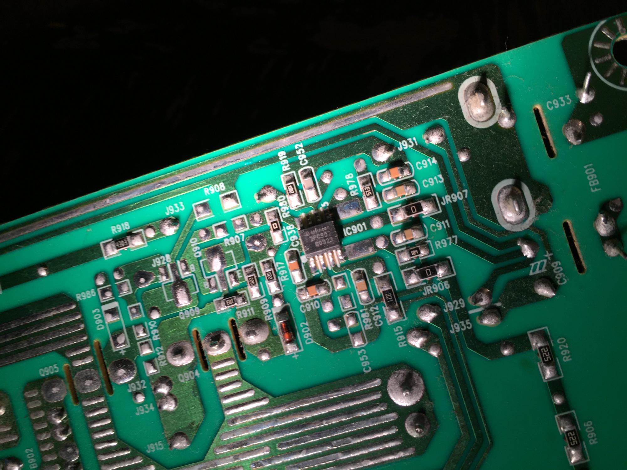

    I took a picture of the item I think ur talking about. I can't make out the first line which seems to be the brand but the second line is 2PCS02 and the third line 60923.
    I assume it's this?
    http://m.aliexpress.com/item/768011167.html
      Re: INSIGNIA NS-L47Q09-10A dropped now black screen
      ICE2PCS02' Check the DCV between VCC PIN 7 and GND PIN 1 when power switch is activated (PS-ON is present). You will be making Voltage measurement in the hot side so do not touch anything with your hands or body, you should at least plug the TV into the GFCI outlets.
        I got 13.4 when testing pin 1 and 7
        • jason424
          • Dec 2015
          • 187
          Looking at your pdf budm I assume that this passes since the doc states "The
          operating range is between 11V and 26V". Where do I go from here?
            ICE2PCS02G
            VCC (Power Supply)
            The VCC pin is the positive supply of the IC and should
            be connected to an external auxiliary supply. The
            operating range is between 11V and 26V. The turn-on
            threshold is at 11.8V and under voltage occurs at 11V.
            There is no internal clamp for a limitation of the power
            supply.
            Check the VINS to see if it is OK or not
            VINS (Brown-out Sense Input)
            This VINS pin senses a filtered input voltage divider
            and detects for the input voltage Brown-out condition.
            A Brown-out condition of VINS<0.71V, shuts down the
            IC. The IC turns on at VINS>1.5V.

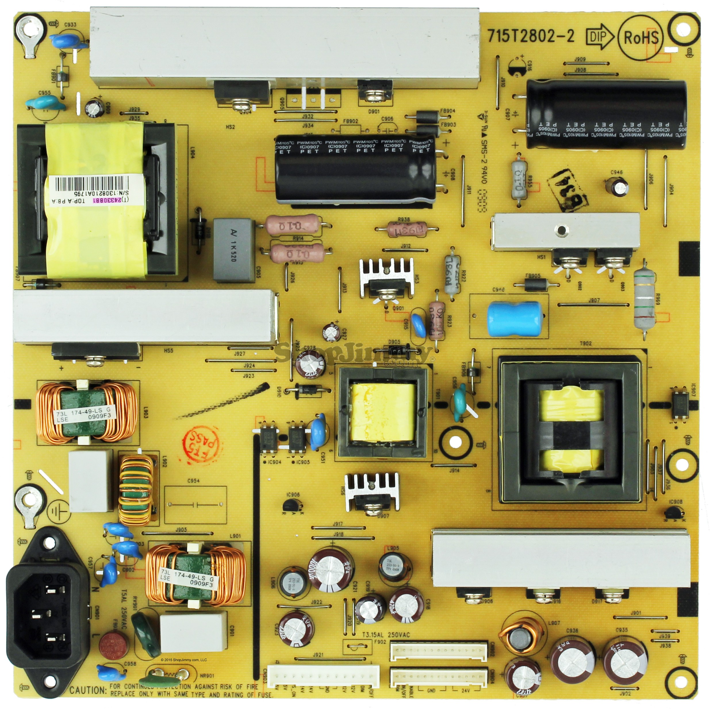

              Power supply bd. Insignia ADPC24330BB1 (715T2802-1, 715T28021) PS
              http://www.shopjimmy.com/insignia-ad...upply-unit.htm
                                OK, so the boards I'm seeing have stamped on the 715T2802-1 but I have 715T2802-3
                                Does this matter?
                                • jason424
                                  • Dec 2015
                                  • 187
                                  #36
                                  Does this matter?
                                  Any one know if the last digit matters before I order?
                                    #37
                                    What are the numbers on the bar code sticker?
                                    Per shopjimmy: Partial part number (24330BB1) is found on barcode sticker.
                                    • jason424
                                      • Dec 2015
                                      • 187
                                      #38
                                      (T)24330BB1
                                      But when I look at the board for sale compared to the board I have, the printed number is different so I assume this doesn't matter.
                                        #39
                                        The number on the bar code is the one you should try to match., the number represent the PCBA (Printed Circuit Board Assembly, blank board stuffed with parts), the blank circuit board can be stuffed in many ways to create the PCBA for particular TV requirement, so the blank board can be stuffed to be used in more than one model of the TVs.
                                        I.E. one PCBA may have 10 resistors installed, but another PCBA may have only 5 resistors installed because one model of the TV may not require all those parts to function nut the other model does.
                                        • jason424
                                          • Dec 2015
                                          • 187
                                          #40
                                          OK, thank you very much. Ordered a replacement board. Hope this is it and it's not truly the panel.
