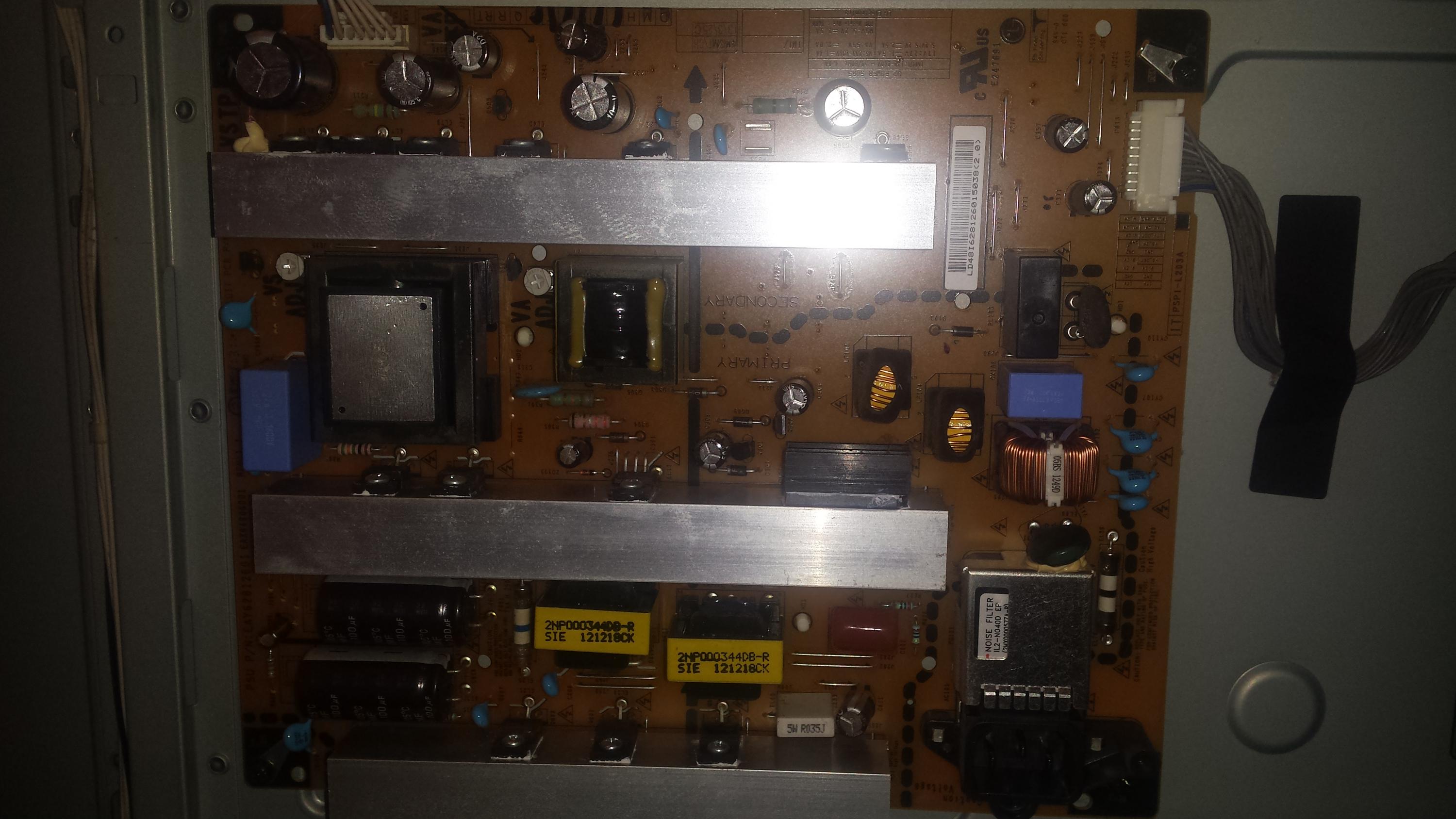

    Hi guys got an LG 50PH660V Plasma Tv here when plugged in it just starts clicking like hell... i have unplugged boards going to the psu appart from the mainboard. the PSU is EAX64906001 Rev 1.1 but i cant find any info online about these tvs with any common faults.. i will test voltages if i get any and will post results but has anyone had any dealings with this tv or the PSU ?

    ok tried to test voltages, i was getting numbers just bouncing up and down as it clicks on and off every second so cant test voltages, after i unplugged tv it continued to click alot slower for 20 seconds or so. what can i do to test further ?

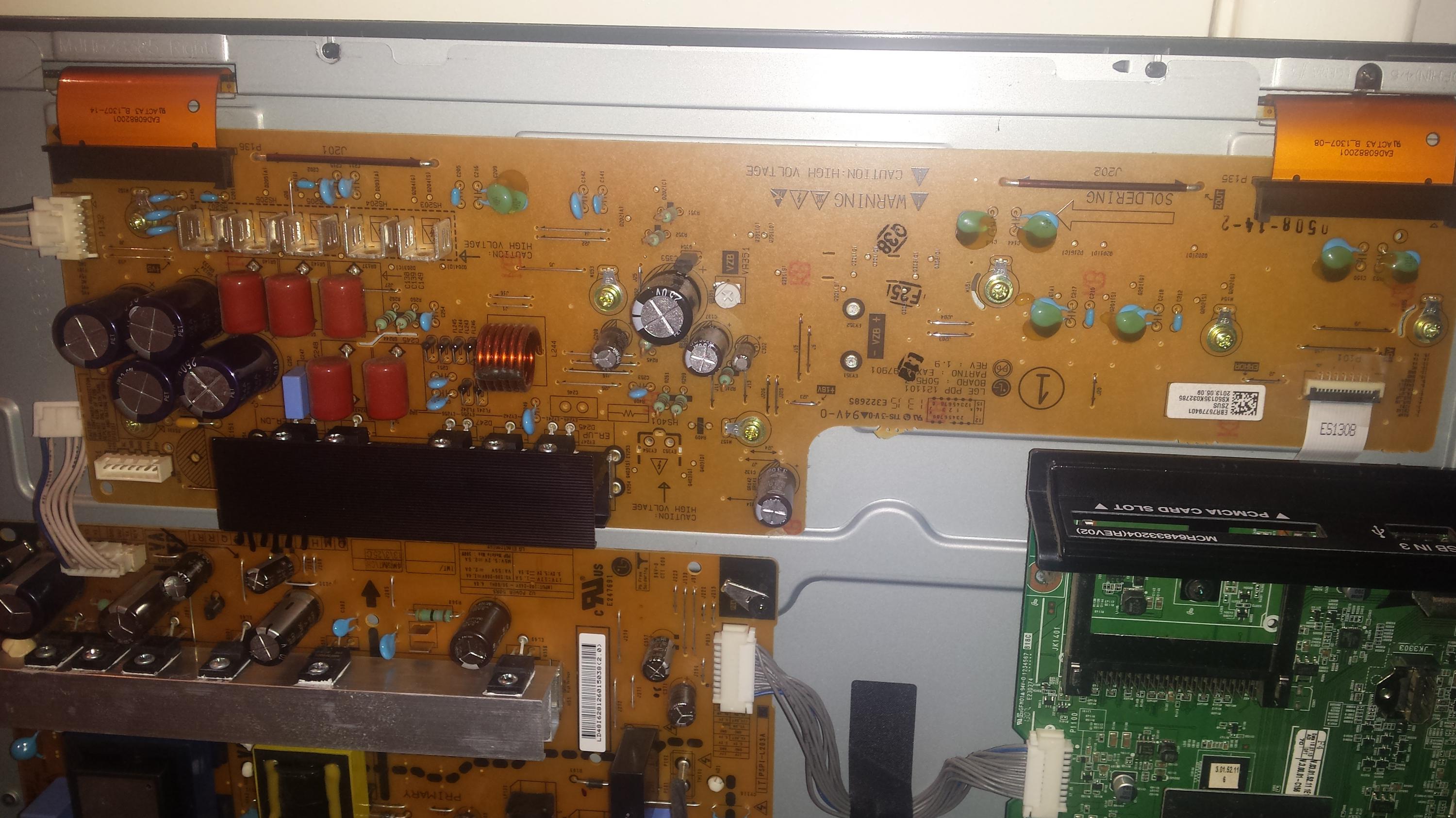

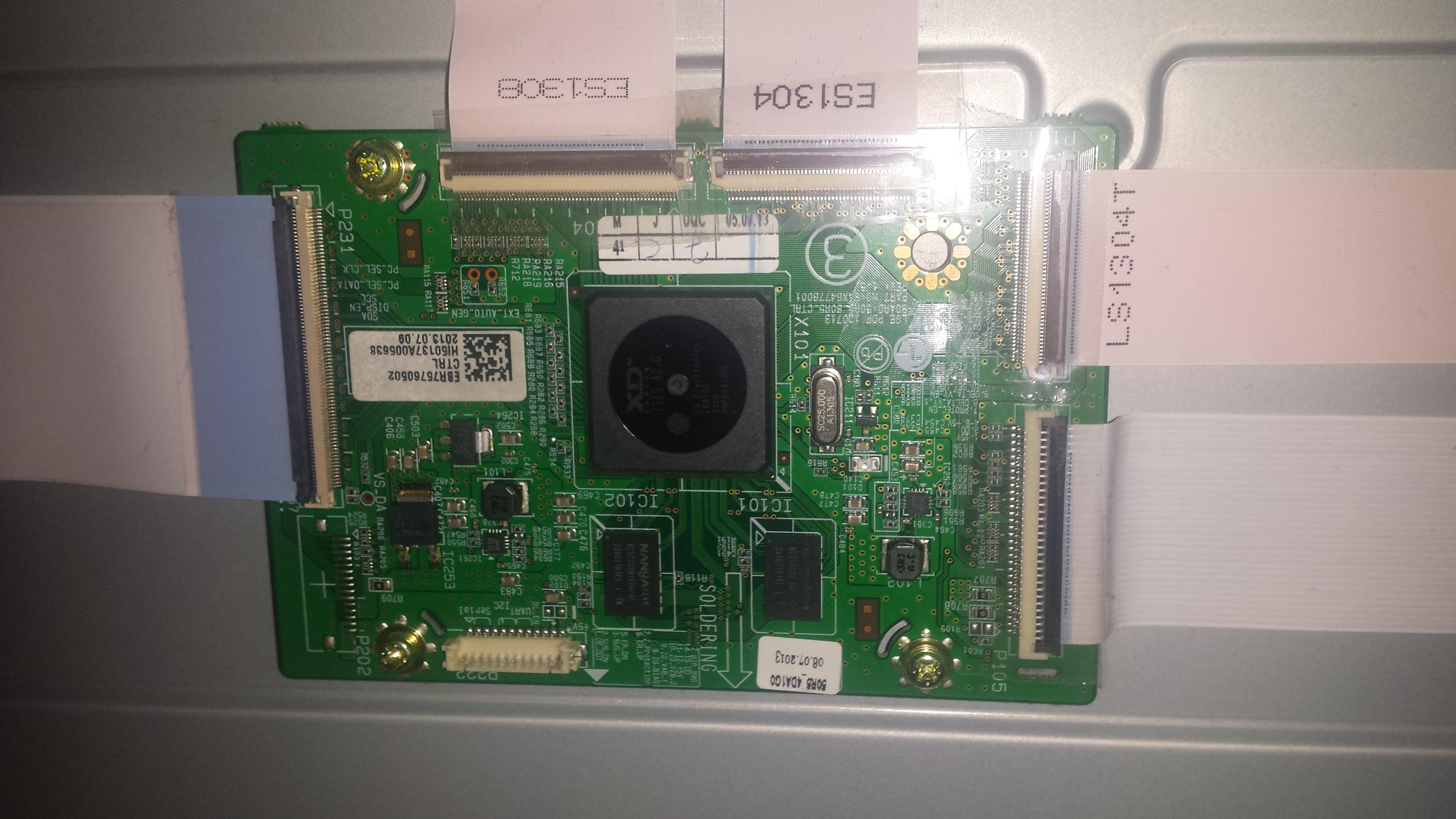

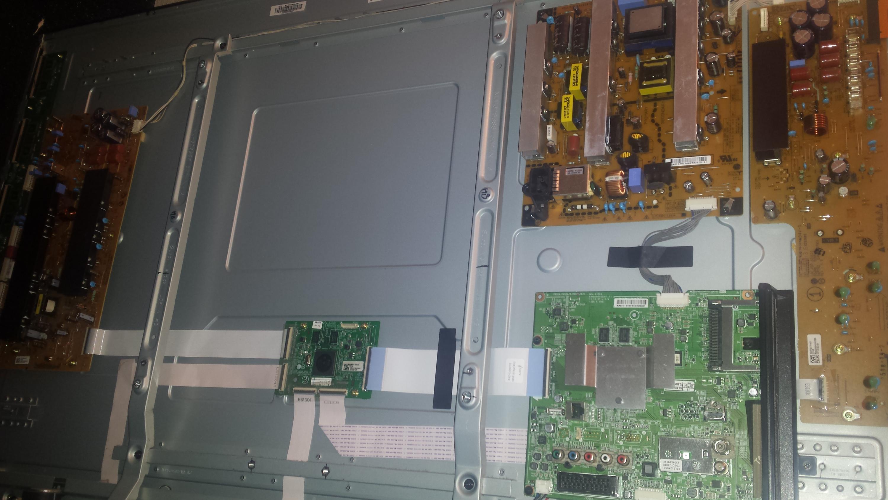

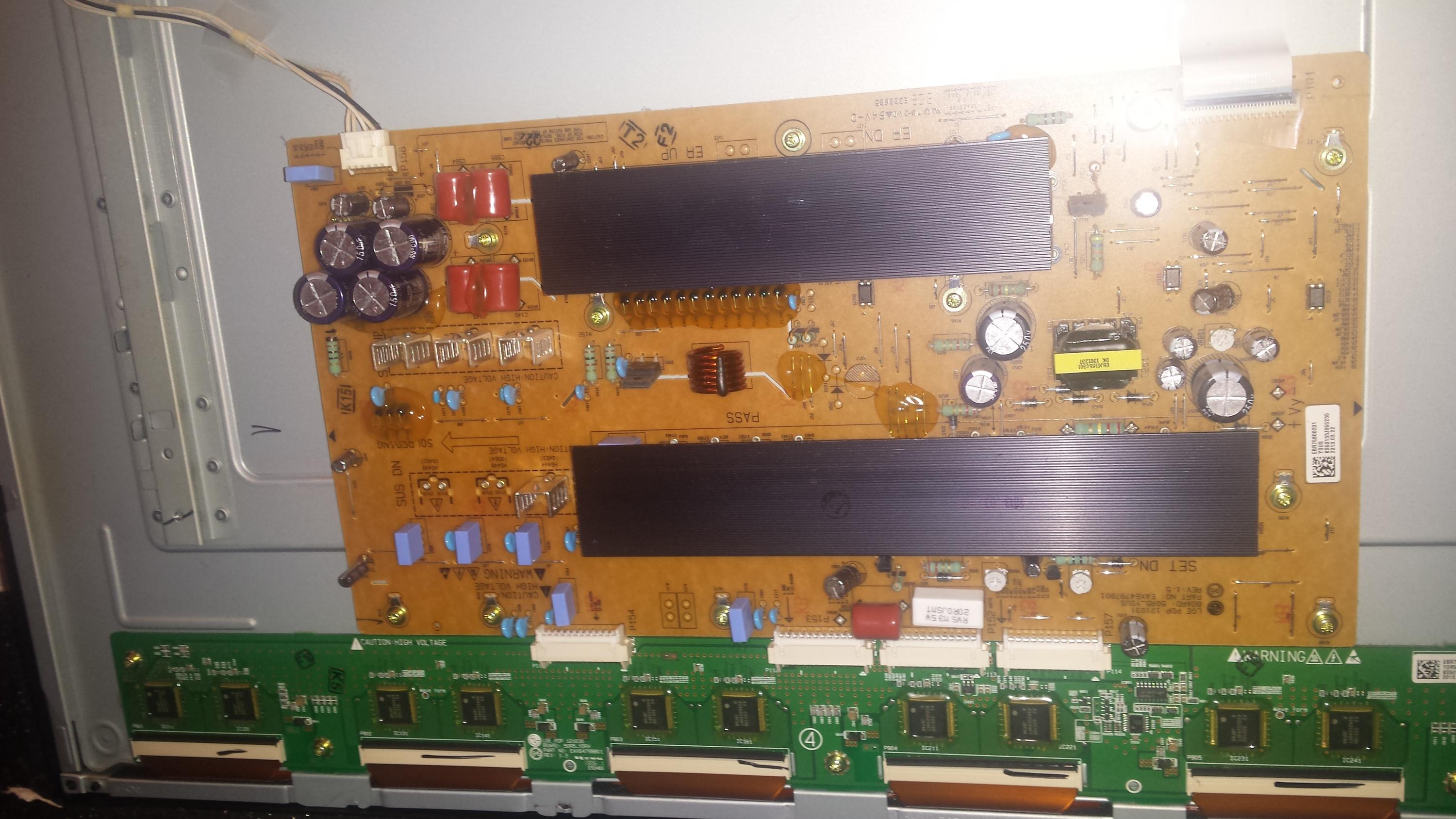

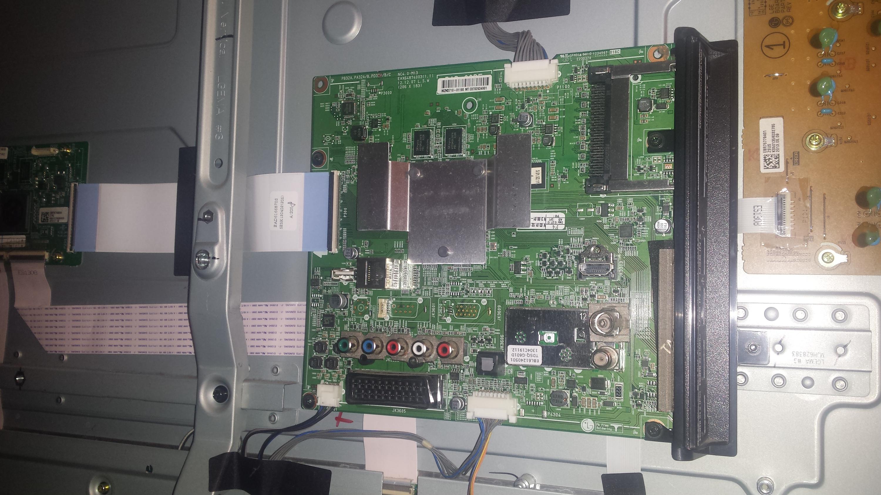

        hope these help.

          With sustian boards unpluged does it still click like mad ?
          • Mikeyboy2007
            • Mar 2013
            • 745
            • Scotland
            Re: LG 50PH660V Clicking
            yeah mate as pictured i disconnected those boards and it still goes mental.

              Have you started taking voltages ? Check the Vs and Va also check the lower voltage rails going to the Mainboard they will be listed what pin should have what voltage in a little chart near the connector. Let us know what you find.
