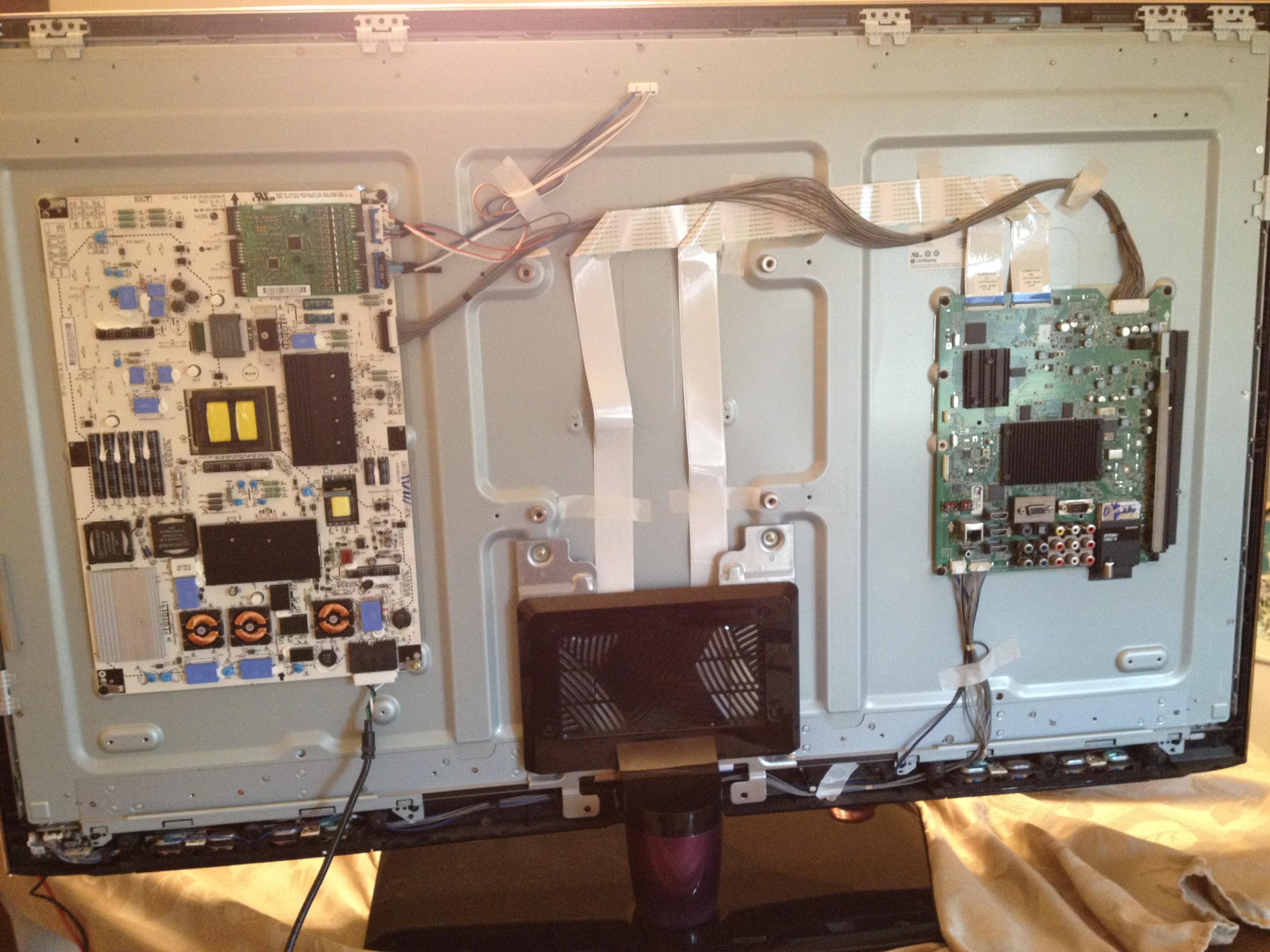

      Please up load good clear pictures of the whole back side of the TV so we can see how all the boards are connected together, then the pictures of each board.
        Re: LG 47LE5500 dark screen possible no sond
        Ok, just got back working on the set. this is m first time trying to attach pictures so hopefully you will be able to see everything

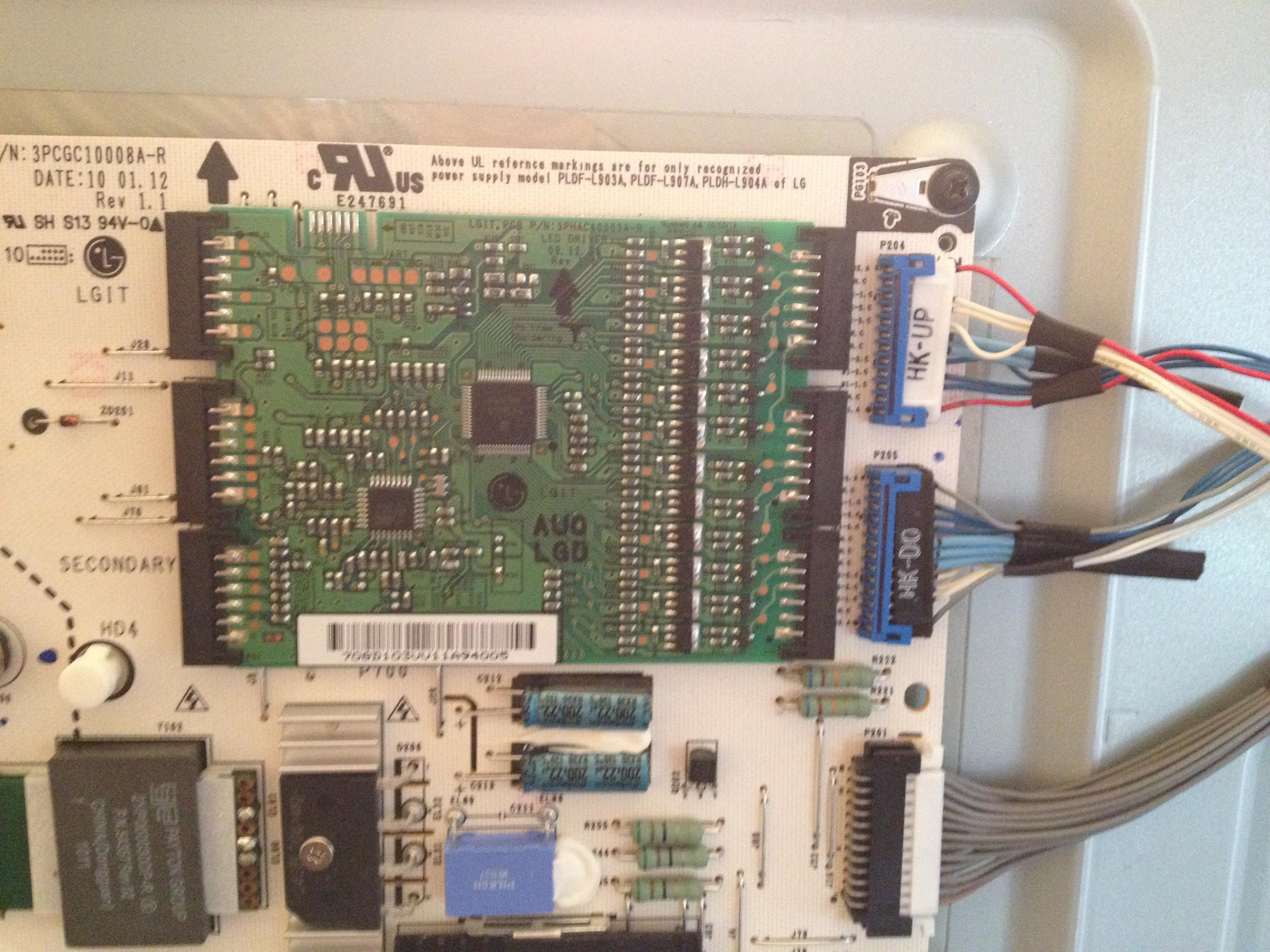

        First picture shows back of set opened up. there are only two boards that are visible. the power board and the main board. there are 3 connections at the top left edge. One takes power and signals to the main board. the very top left connector marked p 204 has wiring that goes directly into a slot at top of tv which i would guess feeds led matrix. This connector is in direct alignment to the LED driver board which is a motherlike board on the power board. I do have voltages on these 12 pins as follows
        (I cant tell if first pin id is a letter or number but i think it is a 0)
        From top to bottom:
        02-1A 126V
        nc
        02-1C 21.9V
        02-2C 20.6V
        02-3C 21.9V
        nc
        nc
        01-3C 21.75V
        01-2C 21.9V
        01-1C 21.2V
        nc
        01A 126V
        Next is connector P205 which also goes to back of set and is also aligned with the led driver board.
        voltages as follows
        from top to bottom
        04-A 126V
        NC
        04-1C 21.8V
        04-2C 22V
        04-3C 21.8V
        NC
        NC
        NC
        03-3C 22.6V
        03-2C 21V
        03-1C 22V
        NC
        03-A 126V
        so it appears that the led driver board is putting out drive voltages, just don't know what they should be.
        also when powering up the set there is no flash of light on the screen

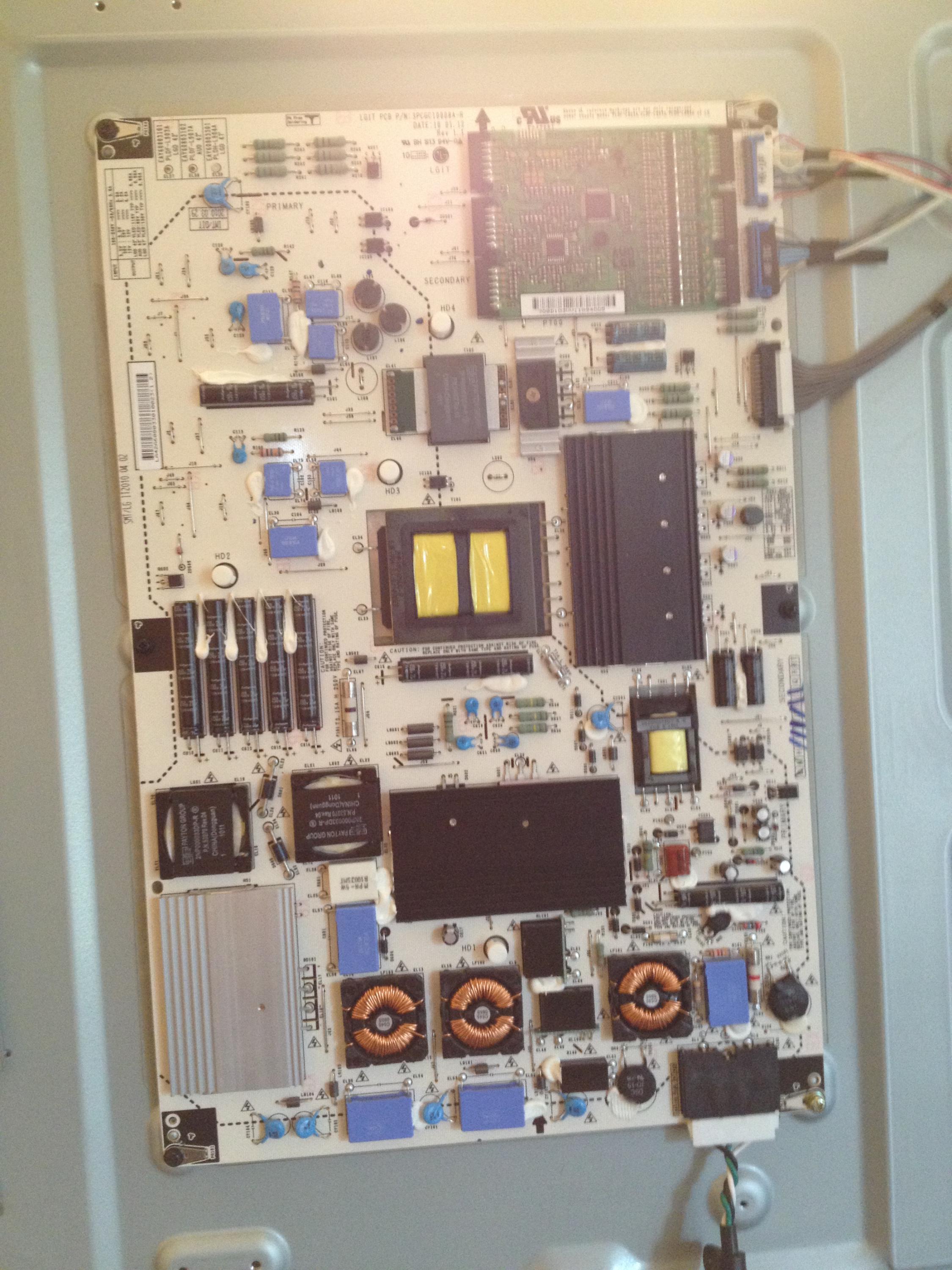

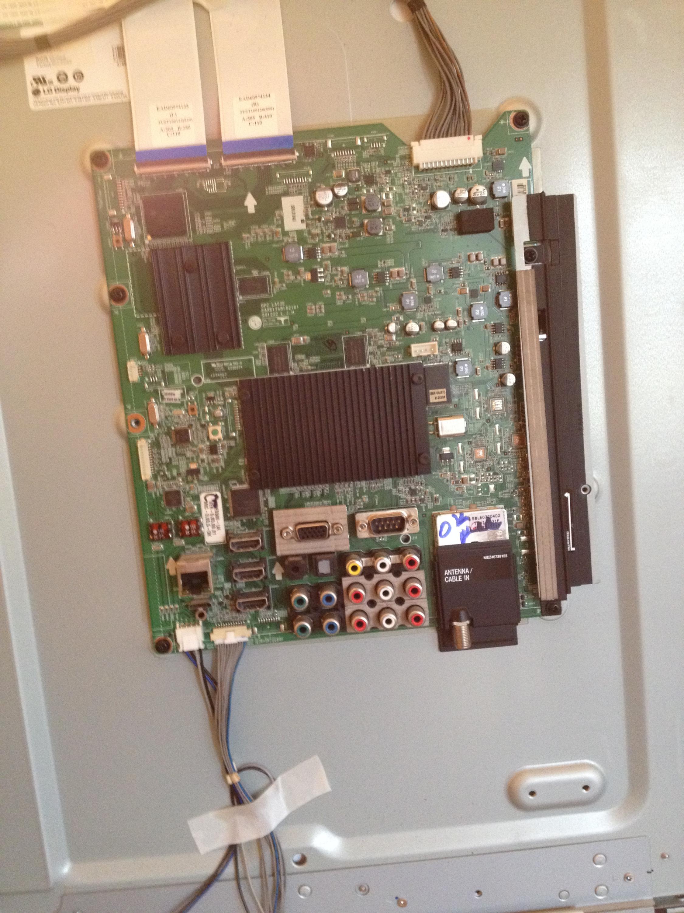

        next picture should be the power board and then the close up of the LED driver board, then the main board.

          that should be the top right of the power board.

                I fixed my LG 47LE5500 today. It froze during normal operation, restarted and gave a black screen, no flashing, no back light, no sound, not detectable by a PC. It could turn on and off, LG logo would turn on, on-screen control and the remote seemed to work, but that's it.
                Basically the symptoms are almost identical to the ones described above, well 2 years ago. I've got similar power supplies and LED driver readings (maybe slightly lower - 18V instead of 21V on LED driver).
                The way it died (with reboot) made me suspect the main board - EBU60904703, getting solder ball cracks in CPU BGA. I removed the heat sink and did a re-flow with a preheat, some flux around the BGA, and a heat gun to ~210C. Read this post for more details: https://www.badcaps.net/forum/showpo...&postcount=107

                  The entire LE and LX series are infamous for bad main boards with cracked solder joints on the BGA chip. They can cause either no hdmi ports to work properly or tv turns on and off button and remote work, but you won't ever get any picture, no back-light, or sound from the set. I don't think I ever have seen one of these TVs with any other issue than bad main board.
