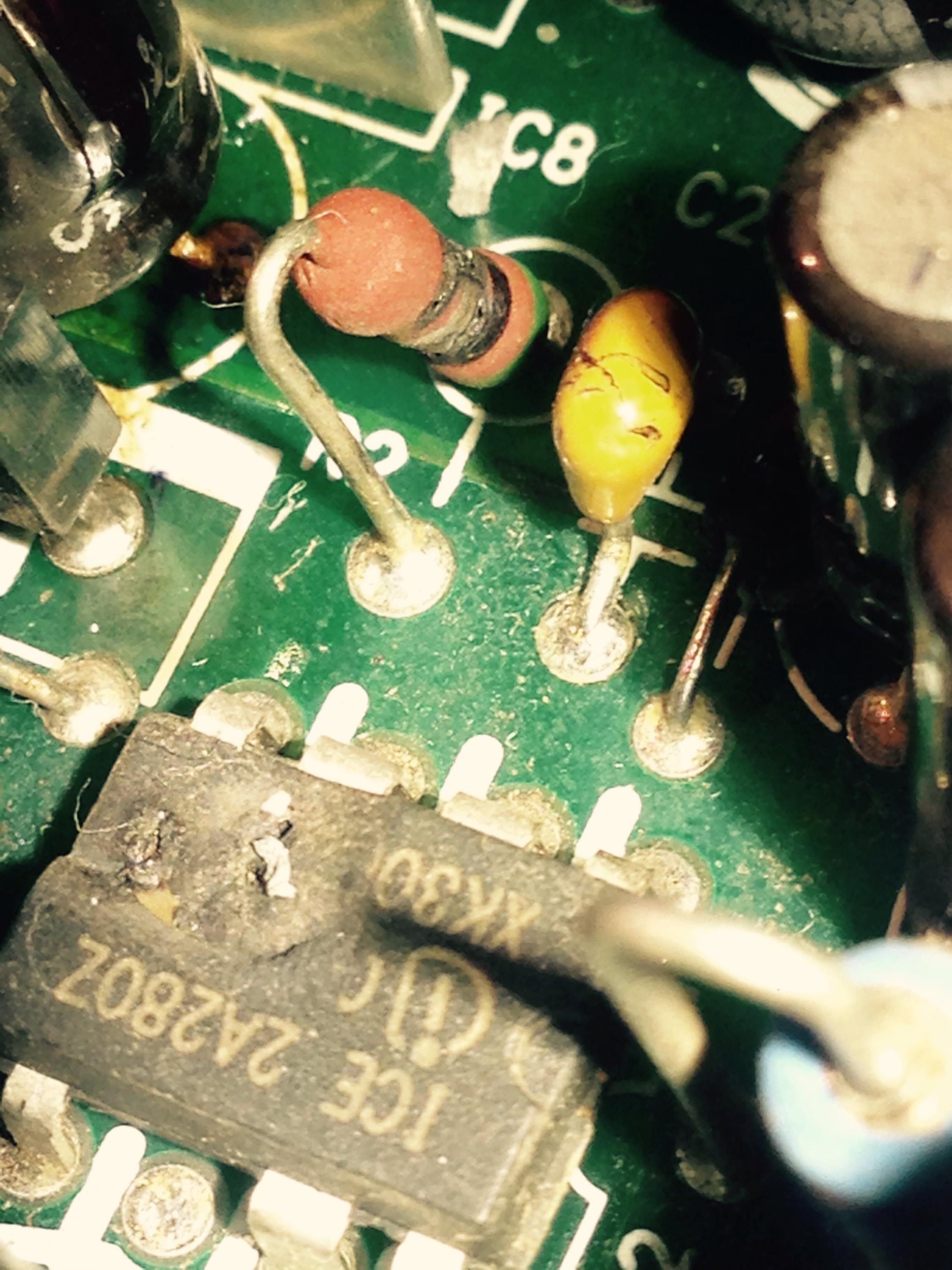

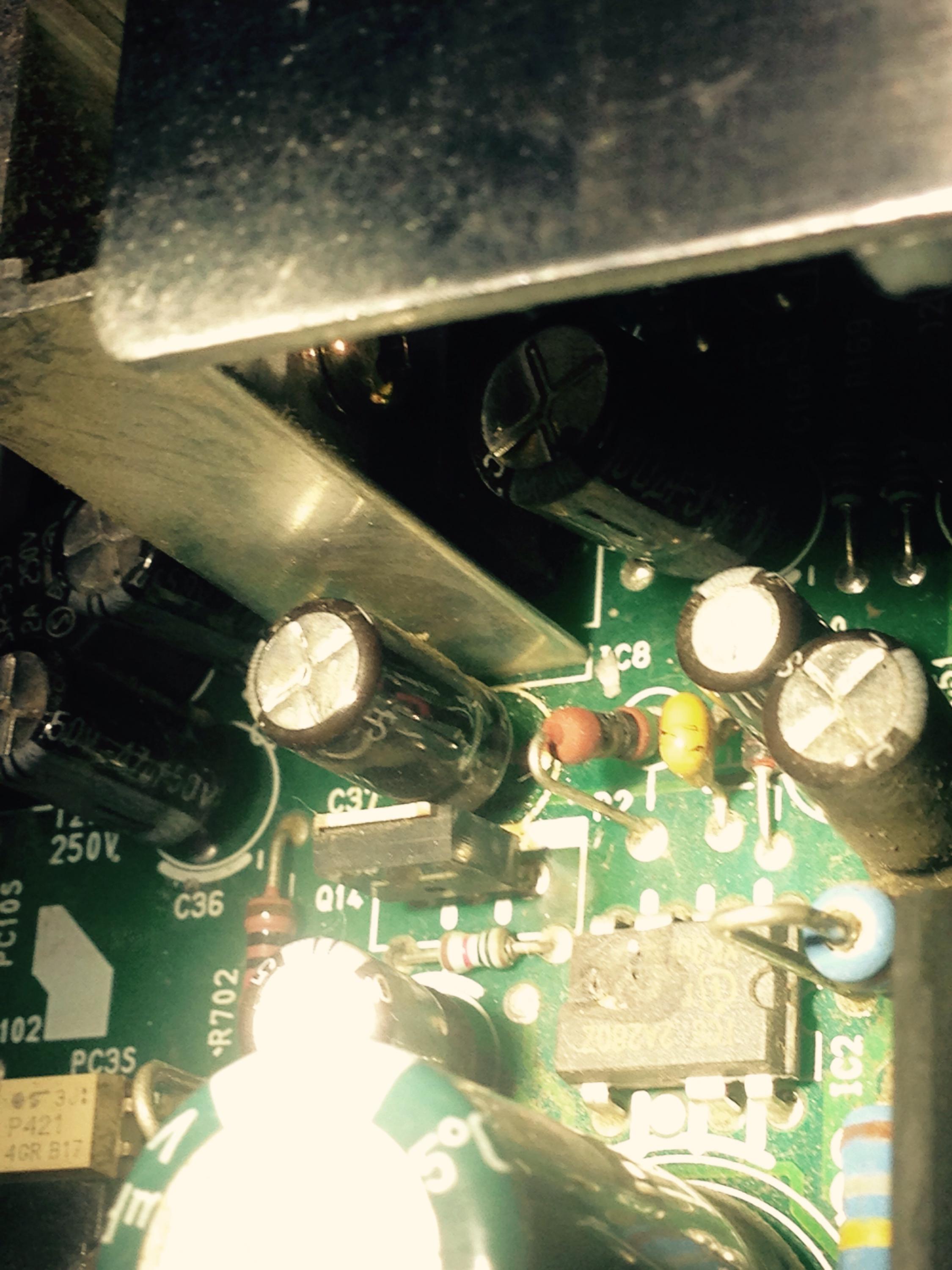

    A few days ago I was watching TV when I heard a loud POP sound! My TV shut down, everything went black. The standby light was also shut off. So I unplugged the TV took the back off, and started to check for power on the power supply board. the model number is BN96-00249A. Everything I checked on the power supply board was getting NO power whatsoever. So I unhook the power supply board and started looking around for the culprit. Then finally I found the problem it was A burned out 8 pin IC Chip. Looking at the chip I could barely read the markings on it because a piece of the chip blew off. On the IC chip it has ICE2A280. I don't know if this means anything. Also when looking at the chip it only has 7 pins! Is this normal ?? Then next to the IC chip there is a carbon film resistor. That is also burned out. I can barely make out the color bands on it. I think the color bands are ( Green, black, white, gold ). So I went on the Internet and tried to get the schematic for this particular power supply board. The only thing that came up for this resistor was 0.5 1W. After looking at various websites trying to find these two pieces, I was unsuccessful then I found this website and forum. I also went as far as finding a company on the Internet that had my Power supply board. So I ordered the power supply board , The company stated it was new. They fooled me. They did reimburse me for my money I paid but they did not give me all of it, And it was there fault. Then after they gave me my money back they told me to keep the power supply board they sent me or throw it out. Crazy stuff but it's the truth. As soon as I got the board I looked for the pieces that were damaged and burnt on my power supply board and The new board that I just purchased had the same problems as my board a burned resistor and burned out IC-Chip. Then I finally found this website which I am grateful for that it exists. So if anyone out there could help me find the right pieces so I could fix my power supply board, I will greatly appreciate it. Like I mentioned above when I plug in the TV there is no power, or No standby light, nothing,it's dead. Here's a pic of my power supply board model number BN96-00249A. Sorry about the picture. I was holding a flashlight when I took the picture and the light made it a little too bright. Lol. You can really only see one side of the IC chip. But if you look hard you can only see 7 pins. There is no 8 pins?? I am thinking this is a special kind of IC-chip. IDK. Then you can see the resistor but the color bands on it you cannot make out.

      Here's a better picture IC chip and resistor

          Diagram.
          R2 is 0.5 Ohms 1W Metal Oxide Flame proof resistor.

                      Hey, I had a question. Instead of using a .05ohms 1W resistor. Whould I burn the board out or what would happen if I used a 10 ohm 1W resistor. I know that's s big difference but what would happen?? I tried looking this question up but found no answers. Thanks
                        Re: I need help with my power supply board model number BN96-00249A
                        The circuit will not function properly and will think it has over current condition. That resistor is the current sensor/Source resistor.
                        BTW, it is 0.5 Ohms NOT 0.05 Ohms
