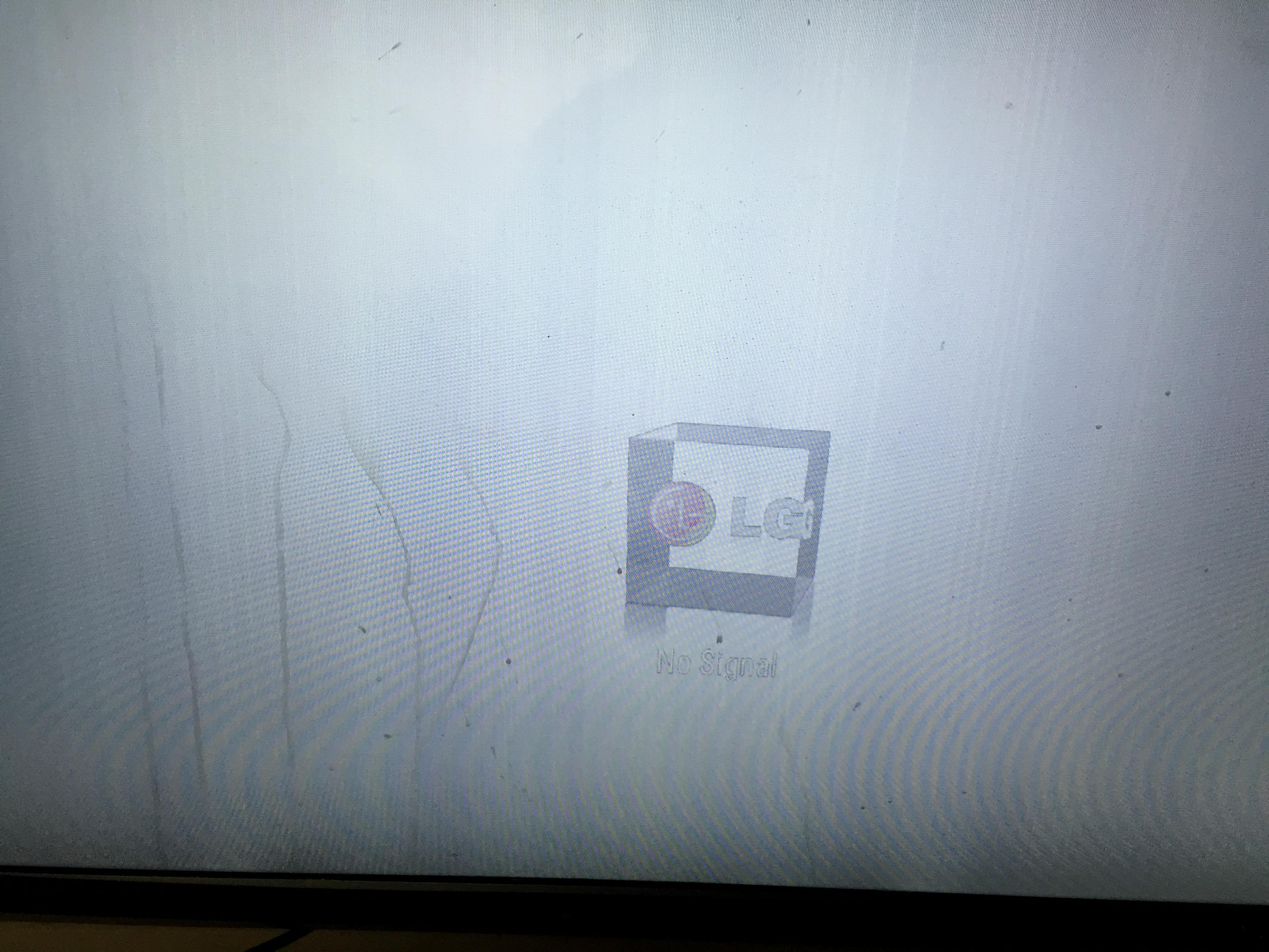

    I have an LG LCD Tv that has a picture problem. The picture is very bright white, possibly a contrast problem. Would the T-CON be responsible for this or the main board? See pic of screen below.
    Re: LG LCD 47LM5850 Contrast/Picture very white
    Looks like bad GAMMA ref Voltages on the T-CON. Pictures of the T-CON BOARD?.

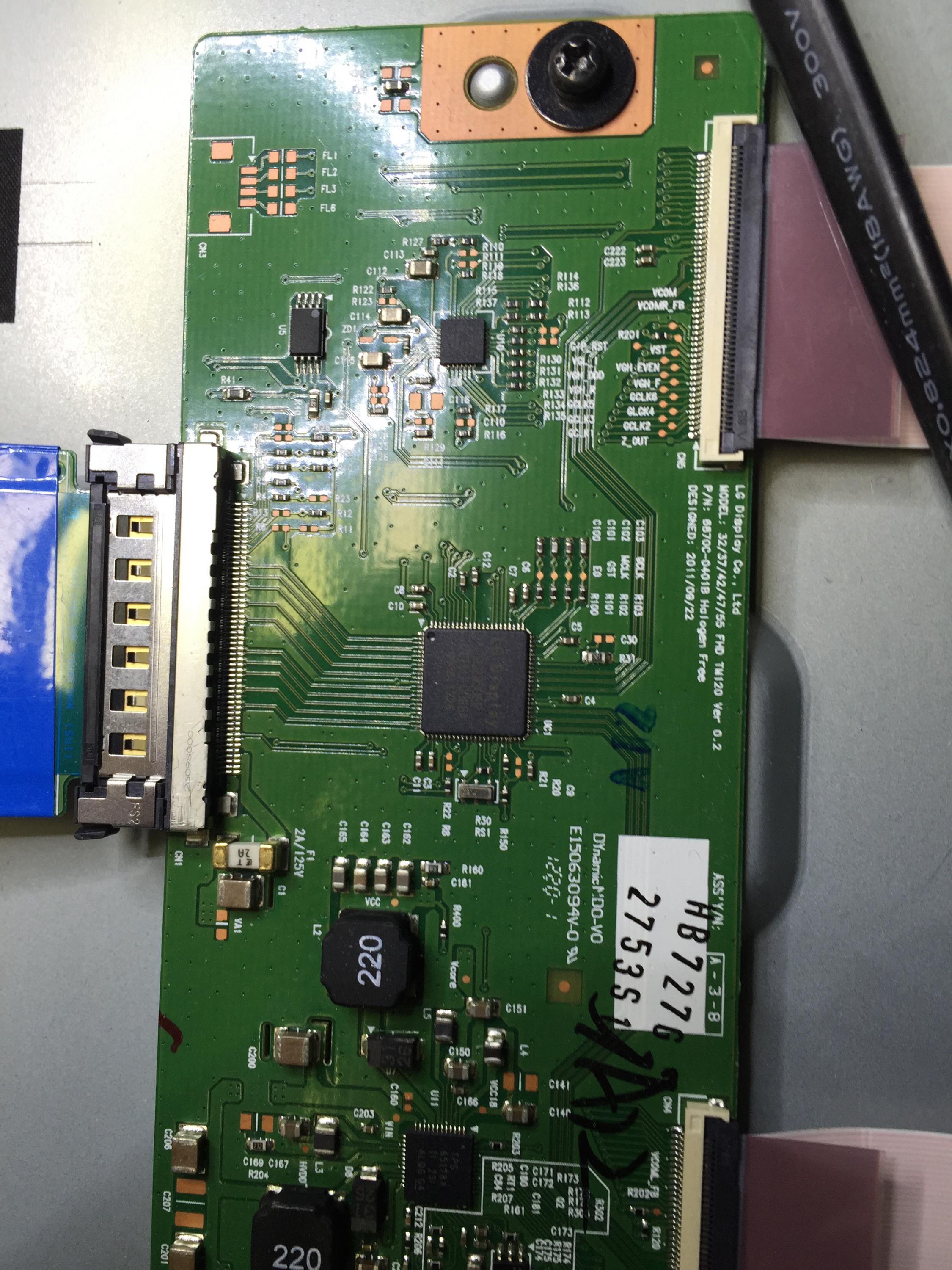

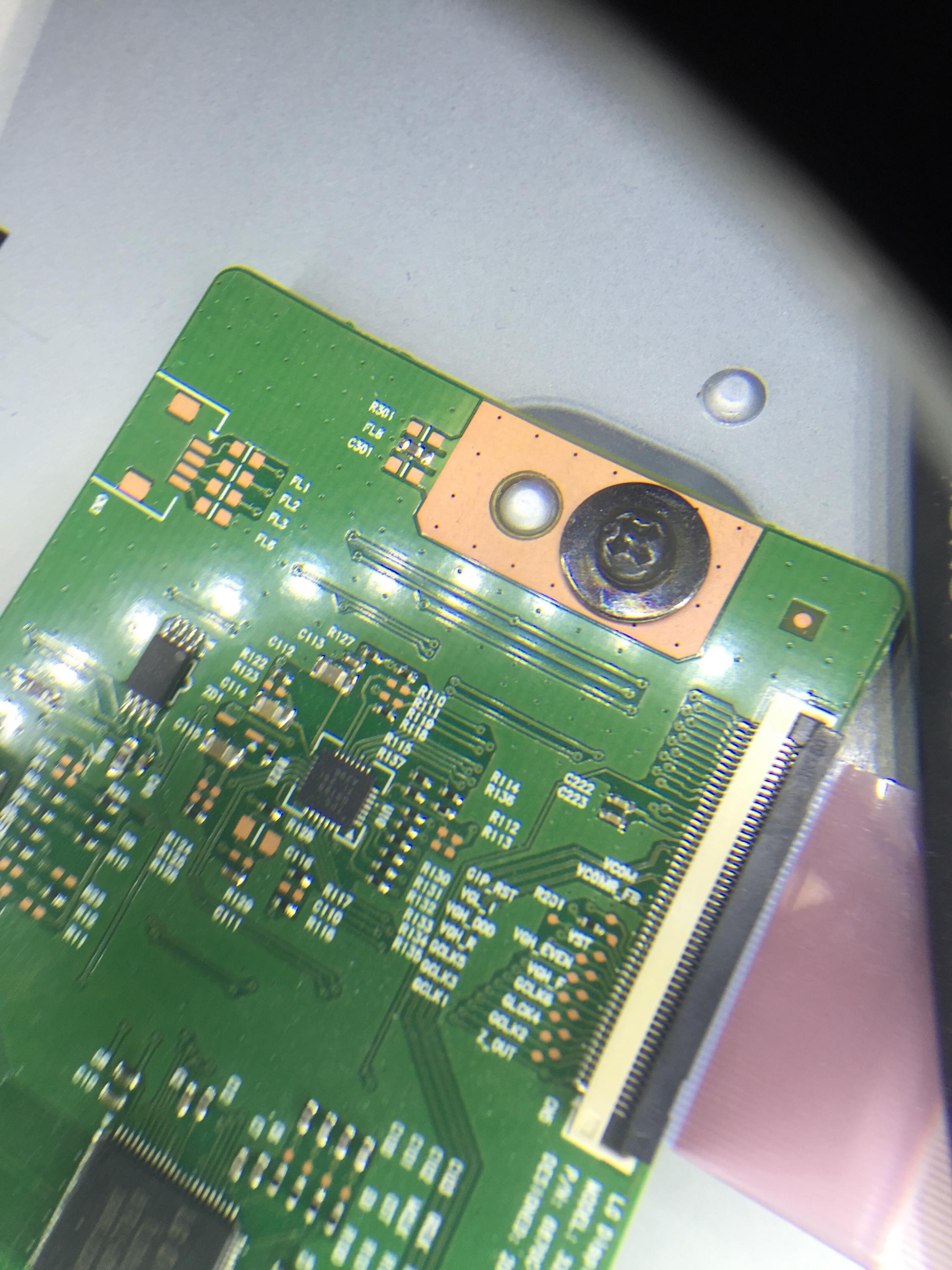

              That is why I asked for the pictures of the T-CON board on post #2 to check the Voltages.
              'Looks like bad GAMMA ref Voltages on the T-CON. Pictures of the T-CON BOARD?.'
              • tech2014
                • Aug 2014
                • 807
                Sorry budm, I was having issues with my computer yesterday. Here are the pics of the TCON.

                    Too bad, there are no known test points for the Gamma ref Voltages.

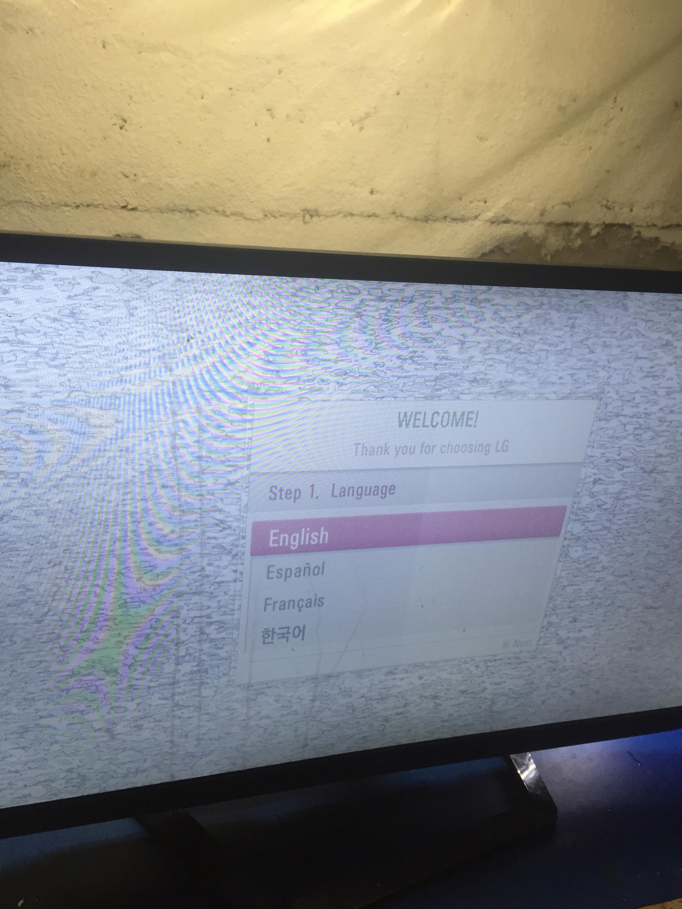

                      Hi guys. I replaced the TCON and Main board in this TV and the screen is still the same. What are the chances of it being the LVDS cable from the main board to the TCON?
                      Is there a way to rule out the LVDS?
                      See pic below. There are a lot of vertical lines on the screen. Sorry about screen, customer brought it in this way.

                        Why did you replace mainboard ? Check the tab bonds see if they are intermittent.
