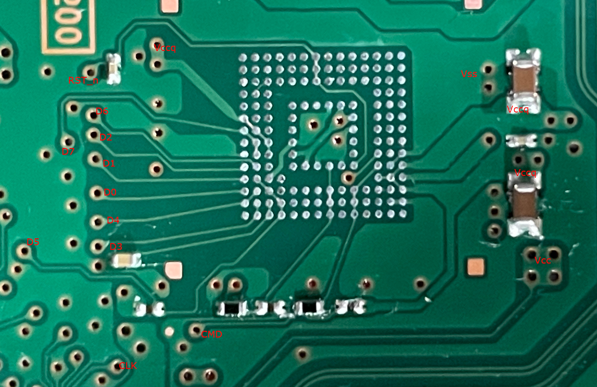

    Since I can't do much with this mainboard right now, I removed the eMMC and mapped out the vias to the associated pins. In theory should make in system programming possible. Going to see if I can make a valid dump of the new board I have coming in before I start messing with it.
    Oh and if anyone has any advice for getting useful data out of the emmc dump, I'd appreciate it. This emmc does appear to use the boot0 partition as well as the rpmb, so you'll need a PCIe mounted SD reader or something like an rt809h to get a complete dump

      Okay, got a second board with attempting to pair to an A80J tcon instead of the A8H tcon... and exact same sequence of events. I did manage to mount the partitions in the emmc dump noted above, but unfortunately the interesting stuff is encrypted, and the keys appear to be securely stored on the microcontroller itself. So can't really analyze anything there. I give up at this point.
      At least I gained some bga skills out of this adventure. I'll eventually just get myself the 77" A95L and move this tv to the bedroom
