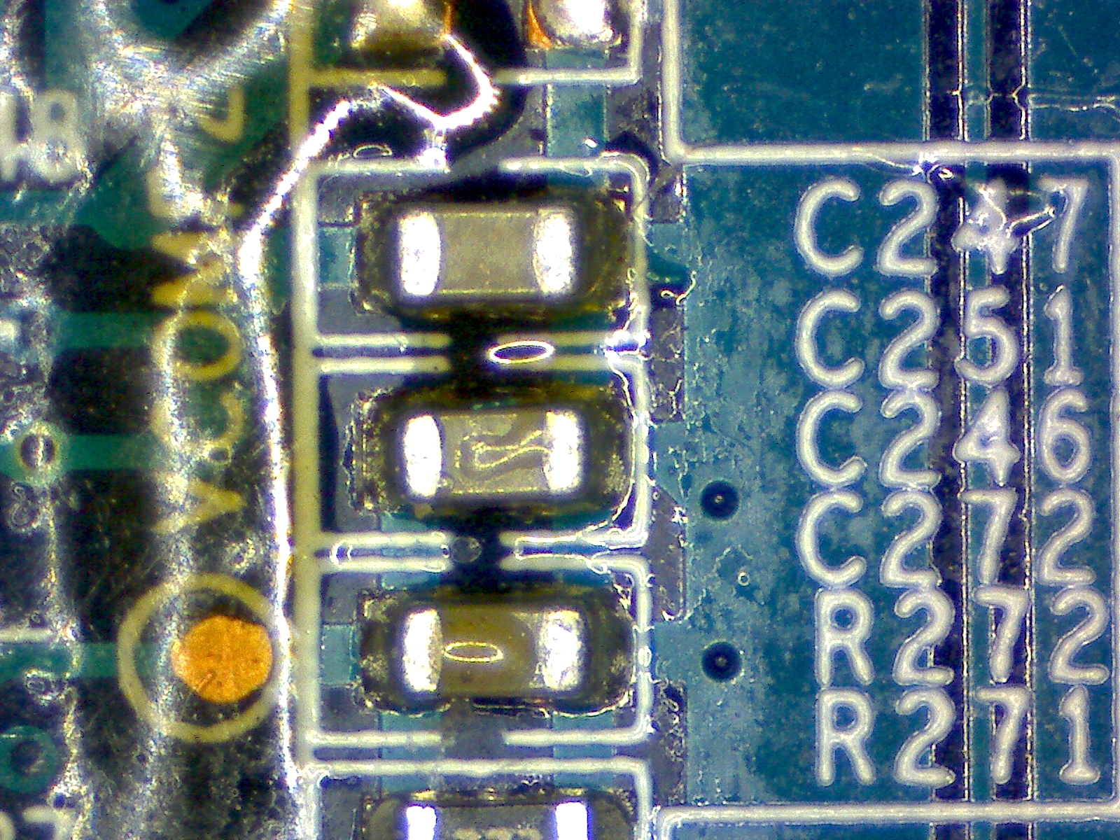

    I was to repair the TCON ,t -con t370hw02 V402 37t04 - c02.
    Change the CHIP AS15. when removed chip , one capacitor
    SMD C246, is desoldered i was loose and lost now do not know the value. The card is operational with new chip just missing the capacitor , someone say what the value of the capacitor ?

    The cap is for decoupling it will probably be fine with out it.
      Re: TCON ,t -con t370hw02
      C246 is connected in parallel with C272 so they are the same value, they are filter caps for VCOM+ on pin 39 as suggested.
        same C212 parallel
          same C212 parallel - 100nF
