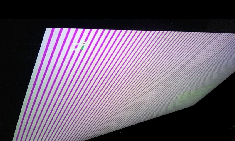

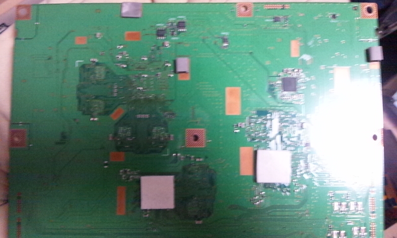

      • Dogcatdog
        • Sep 2015
        • 76
        Re: Vertical lines, kdl-40lx900, i susect tcon
        here a picture of the fault,
        and another one of the backside of the tcon, i found some test points and in 2 of those there is a voltage jump from 2.xxV to 3.xxV not sure if that is normal, but i think its not, both of those test points lead on the backside of the board connected to a 8 pin chip with markings "4256bwp ST k008h" i wonder if that is the culprit, i know that tcons are in generally fixable as long as one can find out what the problem is, like for example some sony have a as15-f chip that needs replacing and that fixes it, this tcon does not have that chip on board so i wonder what the problem is, it could also be something else.
        thank you very much in advance

        • ReeceyBurger123
          Never Give Up !
          • May 2014
          • 7325
          • Britain
          That isnt an As15 or gamma Ic fault. I would say mainboard tbh.

                        • 3743
                        That does look like a 3.3 volt RAMDAC problem on the tcon board and since you mentioned the 3.3 Volt is jumping all around I would suspect a problem there.
                        You can try applying heat to the cheek on board to see if the problem disappears but I don't think it's going to it looks like a shorted RAM module

                            • Dogcatdog
                              • Sep 2015
                              • 76
                              thx i gave it a read, i have tried to warm up the tcon with a hairdryer for a few mins to see if there is any change,and same with the mainboard, there was no change, have not tried it with freezing it yet.
                              • Dogcatdog
                                • Sep 2015
                                • 76
                                i tried what you have suggested to apply heat to the tcon board, but im not 100% sure to which component i should do it so i did it over the whole board with a hairdryer for about 5 mins. there was no change, did same with the mainboard same result. i wonder if i should do the freeze thing with an aircan and see if there is any difference? or should i rather not do that, since some ppl say its not good to do, some say you can do it, its fine.

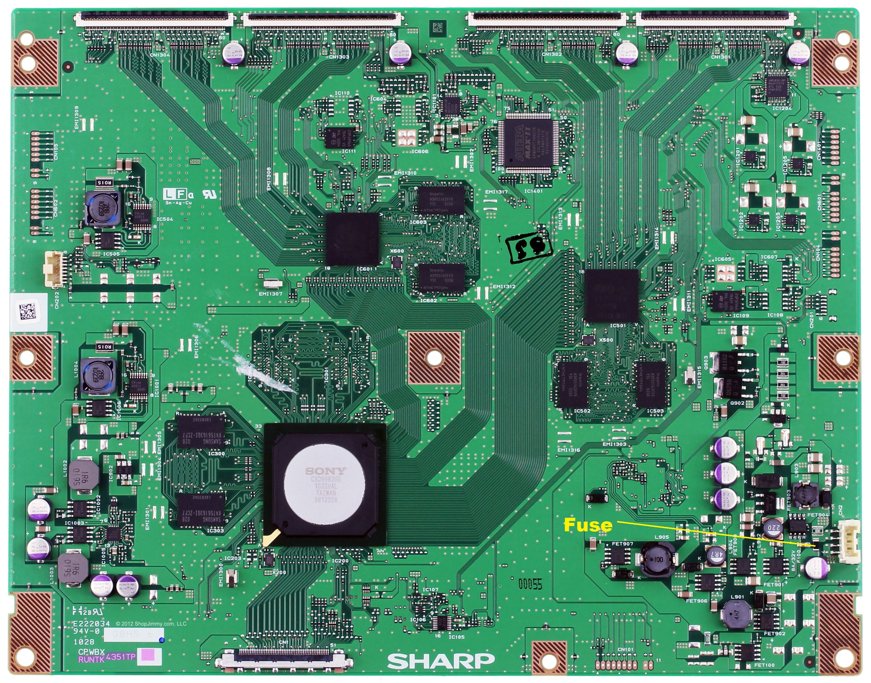

                                • freakaftr8
                                  • Oct 2012
                                  • 3743
                                  Can you post a picture of the front of the tcon board?
                                  • Dogcatdog
                                    • Sep 2015
                                    • 76
                                    i hope those are good enough, i could not upload on the forum the files were to big or something is wrong with the forum it did not work i got error, so i uploaded here > https://mega.nz/#F!jRhzHI7Z!grnpZ9eeuAEWH4KV8Blr9g
                                    • Dogcatdog
                                      • Sep 2015
                                      • 76
                                      i have also found this picture, it is the same tcon board CPWBX 4351TP ZF or CPWBX4351TPZF made by Sharp, the picture is in really good quality it makes it easier to see
                                      • freakaftr8
                                        • Oct 2012
                                        • 3743
                                        Ok apply some heat to ic303 and ic300 then test.
