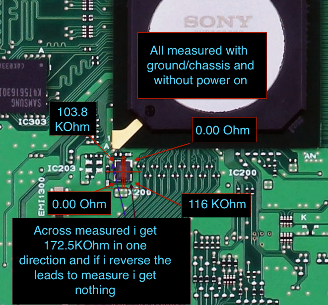

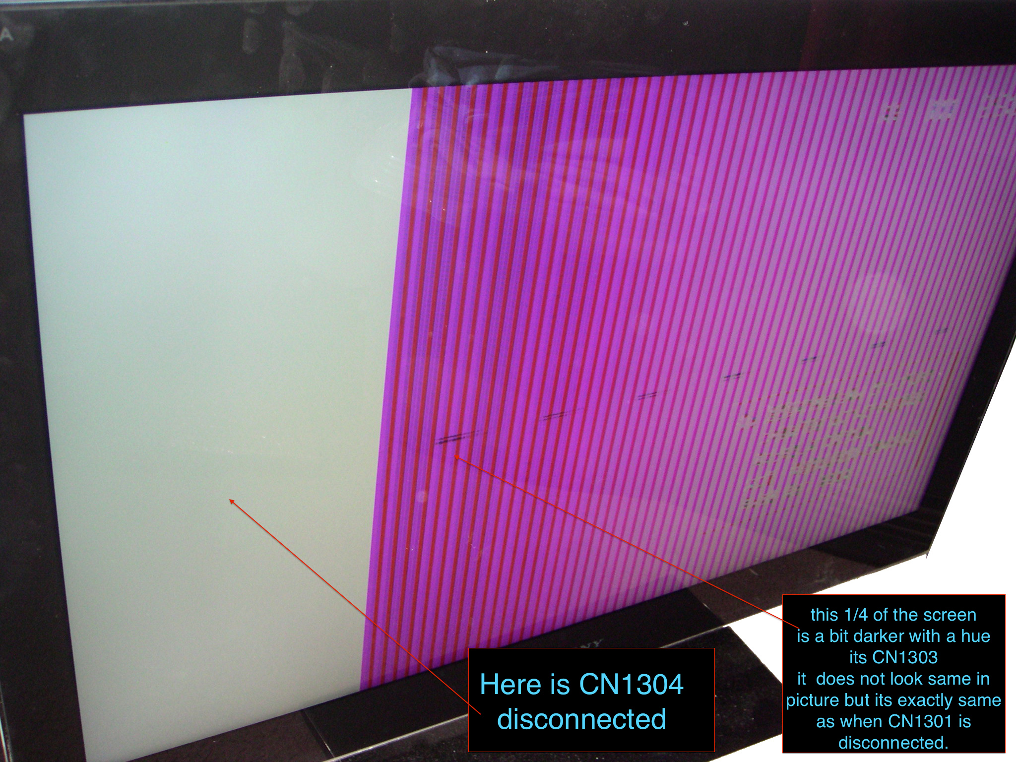

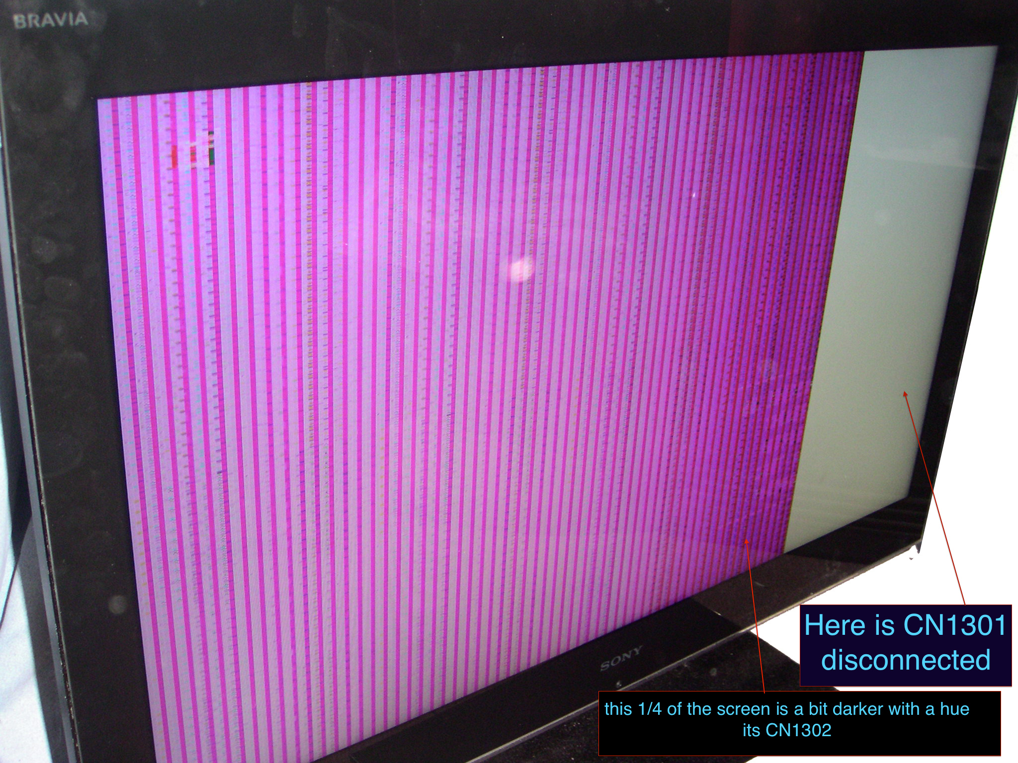

              i just did what you asked, the far right one is disconnected and the other 3 flex connected gives me the same side blank white i.e. 1/4 of the panel, and the rest has same pattern pink/white vertical lines, and the other side around on the far left if i repeat the same, gives me the same, although one of the sides the left one i.e. CN1301 if i disconnect that then the picture next to it is a bit darker then the rest of it, but still same pattern.
              also i did the resistance measurements, without power, i attached a picture, to show what gives what value. of what i measured.

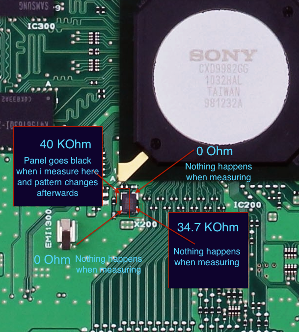

                did same measurements with power on. i attached picture

                  ok... not sure what to say... what does "nothing" mean.... you should watch your terms closely. Nothing means "0". High resistance is something else... but certainly not "nothing".
                  Anyways, you make some interesting observations about the screen when you disconnect one cable depending on the side. Do you have a picture of this. Further are you able to feed a signal to the set? If so, are able to find any test dvd that you can get a well defined pattern displayed to help with evaluating the screen?
                  Sorry for all the questions but its hard to "see thru your eyes and hands" with the internet between us... :-) and lack of full schematics and design for the set.
                  Having said that "bit darker" doesn't sound good based on my very limited experience.

                    The sounds about right. Your panel is ok. I am under the assumption that you have a bad processor or nvram on the tcon. You still have to look at this fact. Your 3.3v is jumping around. Should be steady. Something loads down the 3.3v feeding the nvram. Is one of those heating up and the other stays cool?
                    These in question are ic301 and ic303

                      OP... are you saying there is degree of "darkness" but its the same regardless of which cable I have disconnected or that one side is darker than the other? Pictures will help.
                      As freakaftr8 indicates, you still need to look at the varying 3.3v if that is the case.

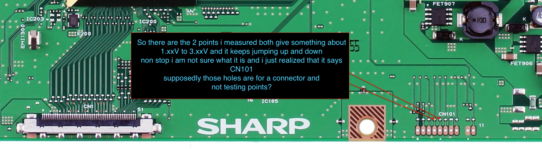

                        thank you very much for the reply, both ic301 and ic303 have about the same temperature, none of them seems more warm then the other, but they are almost cool barely warm i attached a picture of the points where i did
                        those measurements, just in case so there wont be confusion, it is labeled CN101, so im not sure anymore if those are testing points

                          thank you for the reply, i took today picture of the panel while the flex cables are disconnected, please see attached pictures
                          what i meant in post #47 is that when i measure the resistance where it says
                          34.7 Kohm that the display does not turn black and nothing happens, unlike the other side where i measured 40 KOhm it turns black and when i take the DMM probe away the display looks different, the colors have changed , but not better.
                          btw. which 3.3V notes are you referring to in the PDF? can you tell me what page you have seen those please?
                          thank you in advance
