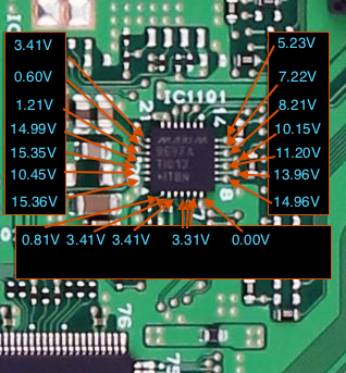

              there is a chip marked MAX17079 http://pdf1.alldatasheet.com/datashe...17079_10.html_ on the tcon, is that the gamma chip?

                Re: Vertical lines, kdl-40lx900, i susect tcon
                here are the Volt measurements i got for MAX17079
                Pin 01. - 1.70V
                Pin 02. - 0.00V
                Pin 03. - 1.70V
                Pin 04. - 0.00V
                Pin 05. - 1.70V
                Pin 06. - 0.00V
                Pin 07. - 1.70V
                Pin 08. - 0.00V
                Pin 09. - 1.70V
                Pin 10. - 0.00V
                Pin 11. - 1.70V
                Pin 12. to Pin 15 - 0.00V
                Pin 16. - 5.94V
                Pin 17. - 4.81V
                Pin 18. to Pin 32 - 6.08V
                Pin 33. - 0.00V
                Pin 34. - 8.12V
                Pin 35. - 7.39V
                Pin 36. - 15.35V
                Pin 37. - 0.00V
                Pin 38. - 3.41V
                Pin 39. - 3.26V
                Pin 40. - 0.00V
                  hrmm seems like this is the Gamma chip, i could not find the datasheet, its MAX9697A https://www.maximintegrated.com/en/p...l/MAX9697.html i attached a picture with the measured voltages, since i dont know which is pin 1.
                  so this is the best i came up with.
                  thank you in advance

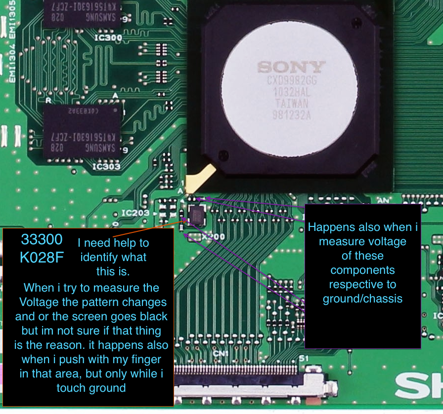

                      i found something.
                      there is an smd part marked, 33300 K028F,
                      When i try to measure the Voltage the pattern changes and or the screen goes black but im not sure if that thing
                      is the reason. it happens also when i push with my finger in that area, but only while i touch ground (chassis)
                      but same happens when i try to measure "capacitors/resistors"? around there
                      not sure what they are, cause there are no markings i will point them out in the picture
                        You're pushing a small signal current into those test points changing the pattern on the screen from obviously varying the voltage to the main Sony processor. I would be under the assumption that either the main processor which is that big Sony CXD9982GG either has a bad BGA connection to the board or its bad itself. I would try to heat it up and see if the pattern changes at all.
                        And yes that Maxim chip is the gamma processor. Sharp likes to use those for their panels

                          #32
                          so... shove it in the oven for like 5 mins at ca. 200 Celsius? or higher and or longer?

                            #33
                            well if you put enough time into it and you've got nothing left for it when I say go for it 450 degrees Fahrenheit for exactly 8 minutes. Then open the oven door turn the oven off let it cool for another 15 minutes before you touch it. And of course prop it up on something so the bottom of the board is not touching any metal surfaces
                                    so... shoved it in the oven for 8 mins. the tcon board, and thought well lets see, and well no change at all, then i thought, well lets try the mainboard, and hrmm still same no change at all in any kind, the symptoms are exactly the same, so i wonder, can it be caused by the power supply??? i cant imagine but who knows? what do you guys say? and if it is the SMPS what part of it could it be? what to test and what to test for?
                                      You should try and trace the tracks going to and from the component in question. That might provide some clues (ie. are they going to grounds, power, interconnection to other ics, connection to resistors, etc?
                                        which component are we talking about? "33300 K028F?" ? im not even sure what it is, i know that 2 terminals lead to ground of that and 2 lead somewhere into the processor since its a BGA i cant check where
