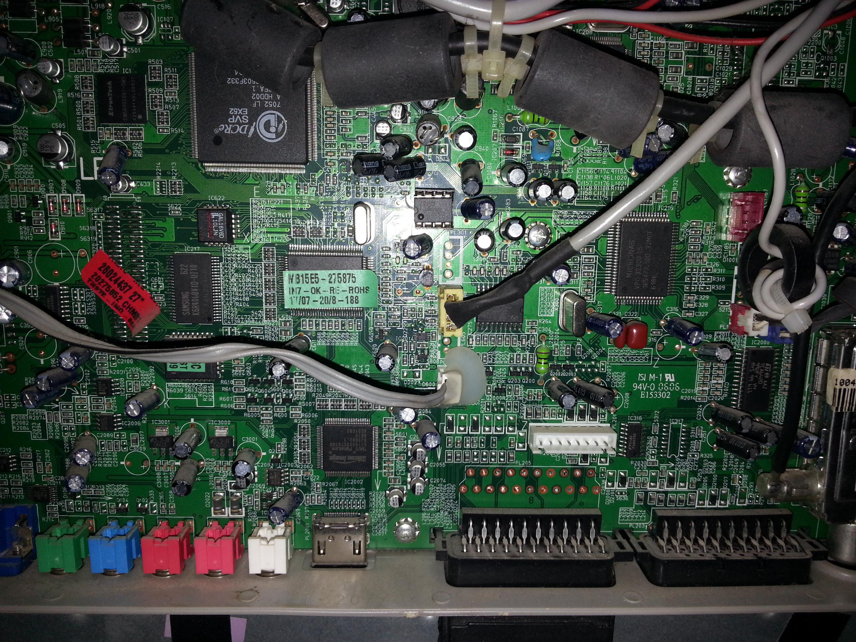

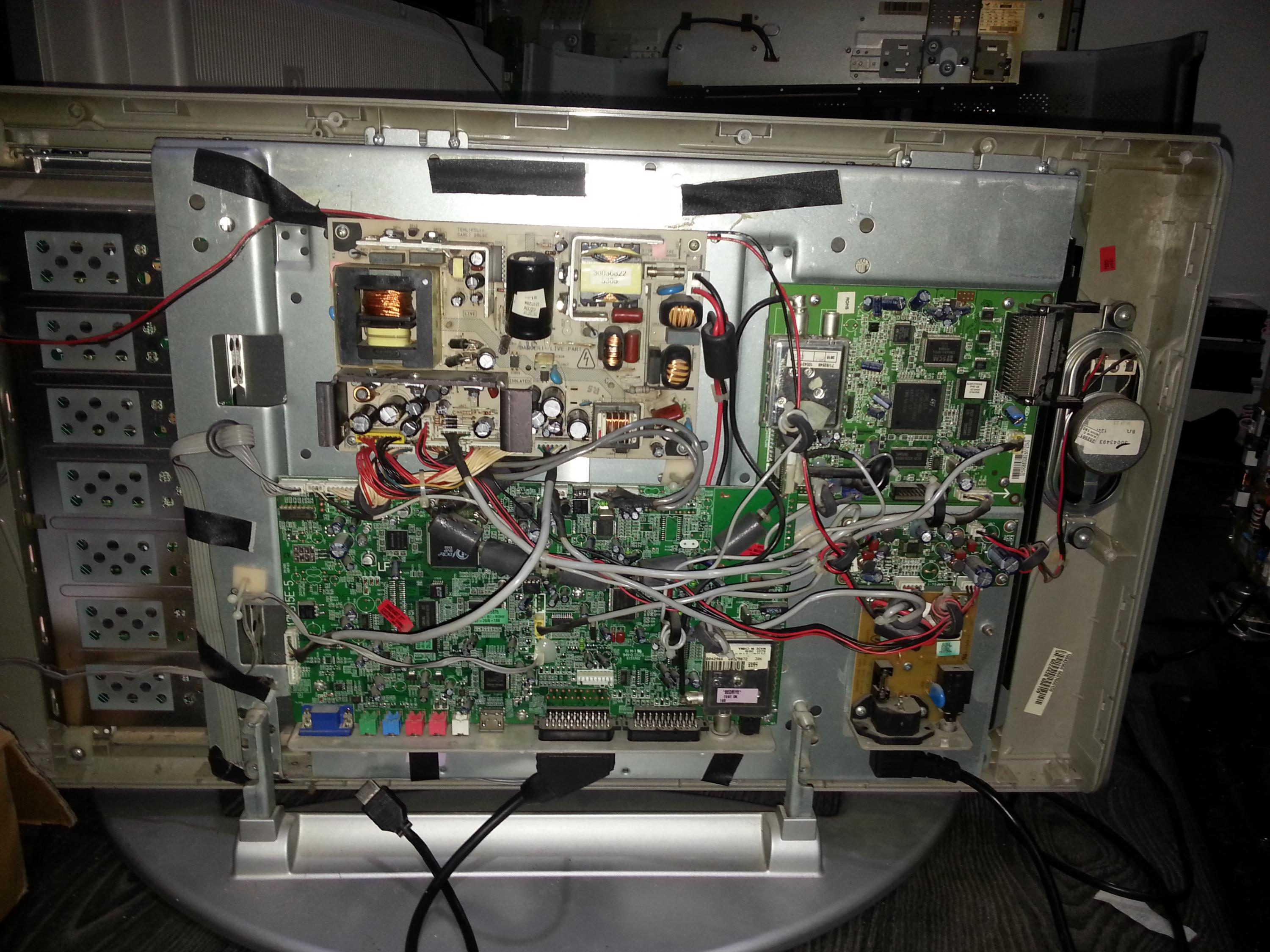

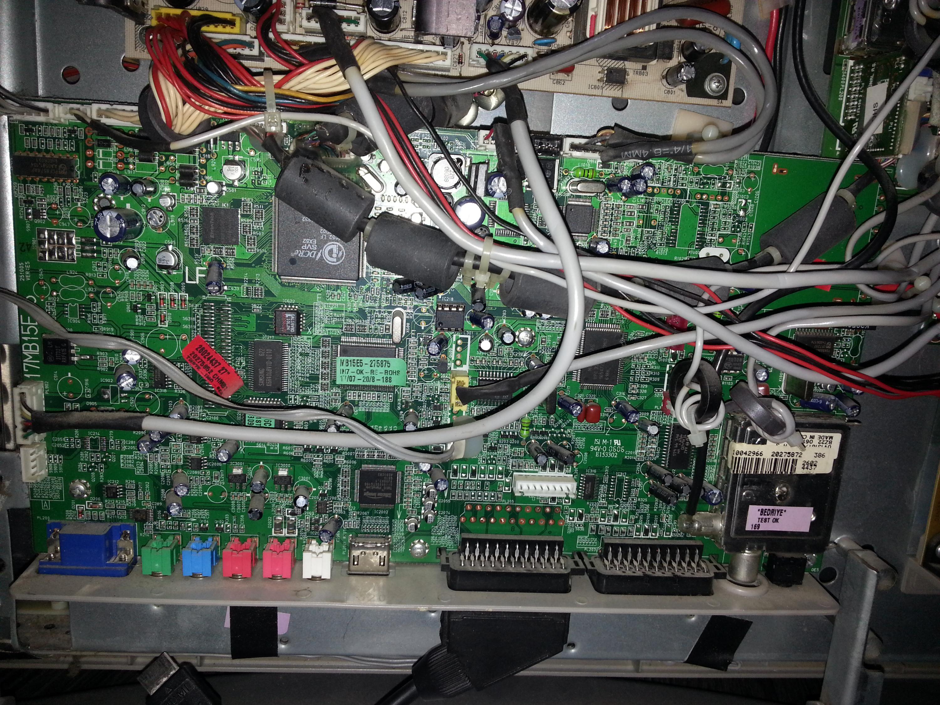

    I have the first ever TV i recapped back with me after lending it to a friend.
    Connected with scart the TV works with sound and picture, however when i connect through HDMI i get a picture but no sound. instead there is a rhythmic pulsing ever second or so.
    It's using a 17MB15E-5 mainboard.
    Does the main board need recapping or is there anything else i can check ?

          Cheers RecceyBurger, i've just tried that and it's definitely hardware failure. Still no sound and as i increase the volume on the remote the volume bar display freezes in sync with the pulsing buzzing sound.
          Could it be a partially damaged HDMI chip ? The picture works with HDMI and if i connect the TV through scart the sound works great.

            Hmm does sound like the Hdmi controller or a bad cap on the decoupling stage for it. Possibly you could try heating it to see if audio comes back ?

              I'll try with some heat tomorrow, just seems strange i get a picture and no sound. I've encountered blown HDMI chips in the past but they were no sound and no picture. I might test a few of the small caps around that area to see what they are like.
