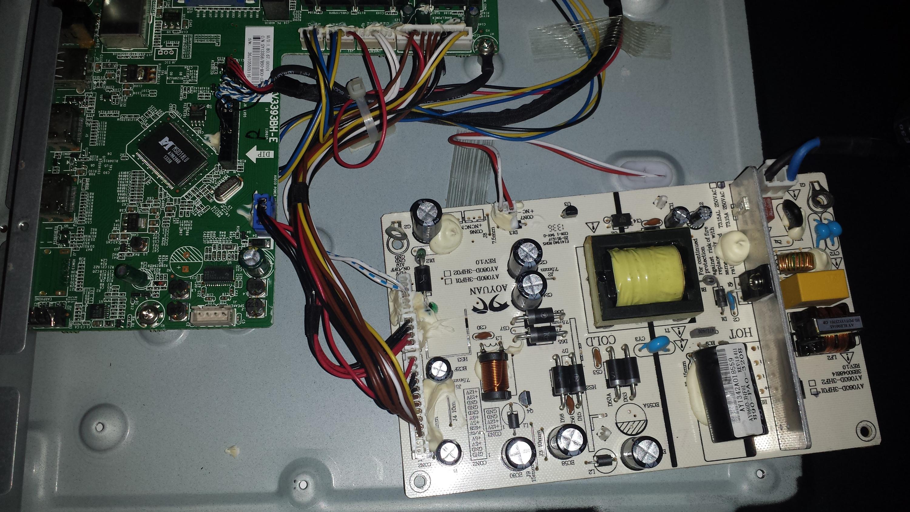

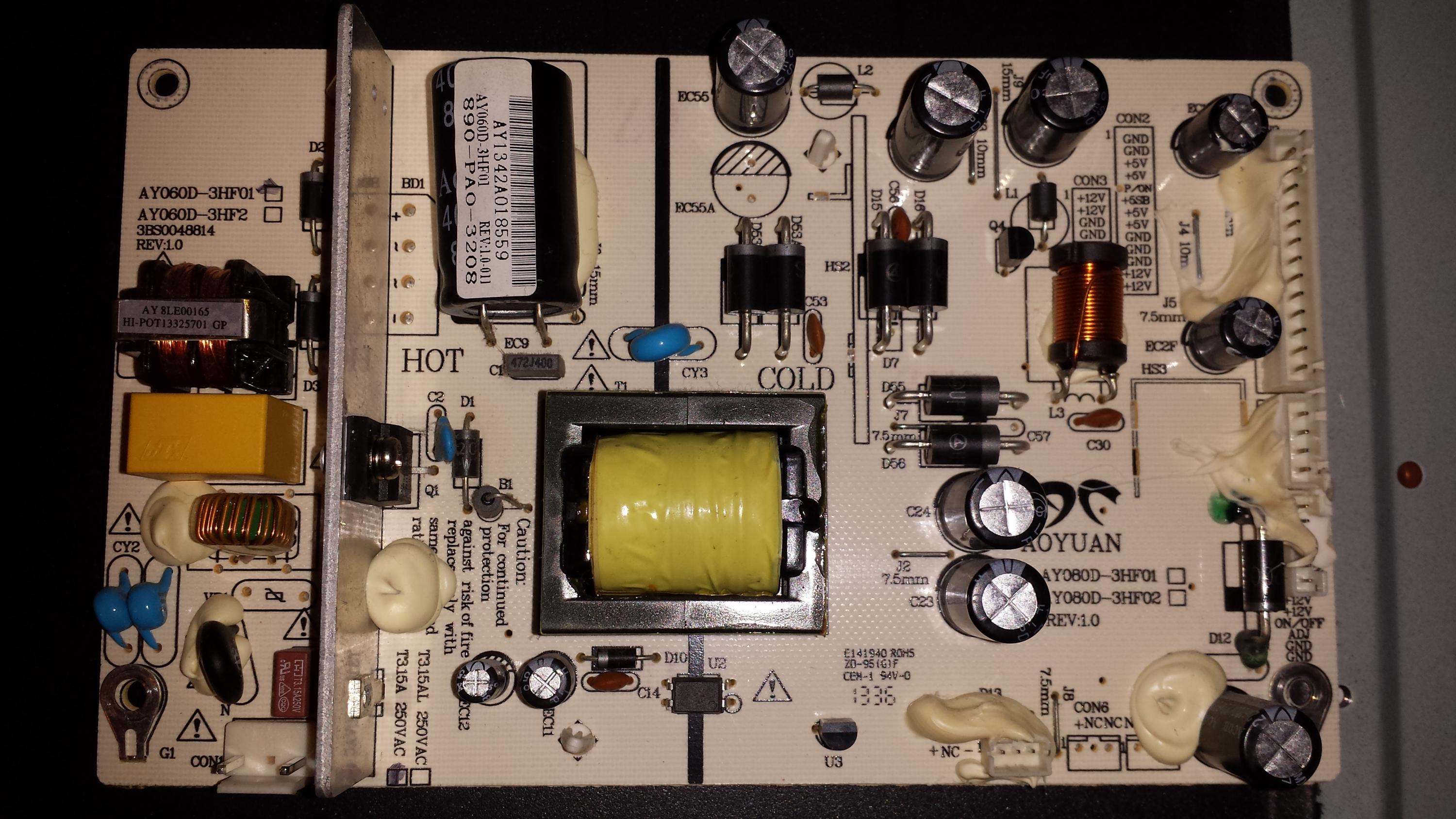

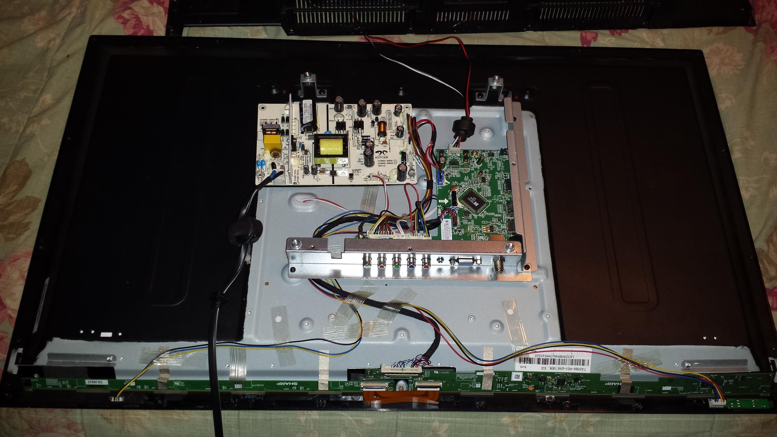

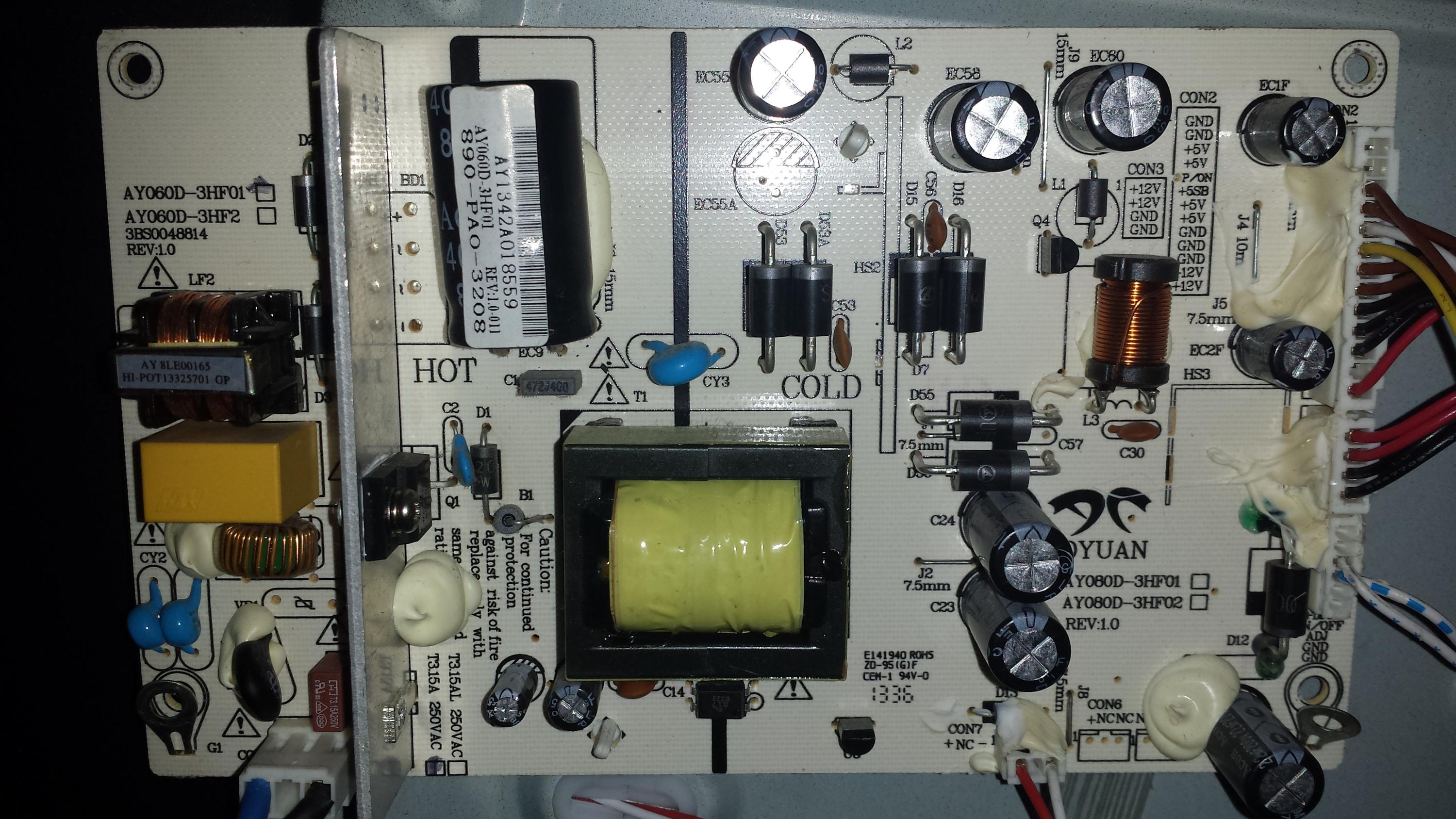

    I have this Insignia tv and all I get is the standby light continuous red power button and remote has no effect, took it apart and it has what appears to be a power supply and a main board. I am wondering where I can start in troubleshooting it with multimeter. I have included pictures of the boards. Thanks in advance.

    Update I found out how check for voltages I learned that you have to use a ground from cold side all my 12v have 14v all my 5v have 5v p/on had 5v even if you pressed power on/off had .04v even with power button pressed. Please point me in the right direction. I think its the main board myself.

      tallica2002 please post picture of the whole back of your TV and individual board so we can see all your connections .

        That can't be, unless the PSon is active low. You would have to verify that. So measure all voltages again and post them here with the pin out names, tv on, tv off...

          Ok you are right as you see I am still learning I have checked voltages again and I also have a new update while trying to get these voltages the tv actually powered on and all the 12 volts went back to being 12v instead of 14 or 15 so all the on voltages i have listed are when the tv would not actually power on but pushing the power button would change the voltages. I hope you guys understand what Im talking about cant seem to get it to act up again but my mom said the picture would be scrambled sometimes and getting it to come on would be hit and miss.
          connector 2
          OFF On
          GND 0 0
          GND 0 0
          5v .01 5
          5v .01 5
          p/on .07
          5sb 5
          5v .01 5
          5v .01 5
          GND 0
          GND 0
          GND 0
          12v 0 14
          12v 0 14
          Connector 3
          off on
          12v 0 14
          12v 0 14
          gnd 0
          gnd 0
          connector 4
          off on
          12v 0 14
          12v 0 14
          on/off .01 .04
          adj .01 .04
          gnd 0
          gnd 0 0

            guess i edited once too many the adj on connector 4 was .02 instead of.04 after power was pressed and p/on was 4.94 after power was pressed and all the 5v were actually 5.18

                  on/off .01 .04. This the Backlights ON/OFF pin, it is not getting the command form the main board.
                  adj .01 .04'. This is the Backlights diming control pin, it is not getting the command from the main board.
                  So you do have main board problem, so as others had indicated, EEPROM or something else on the board went out.

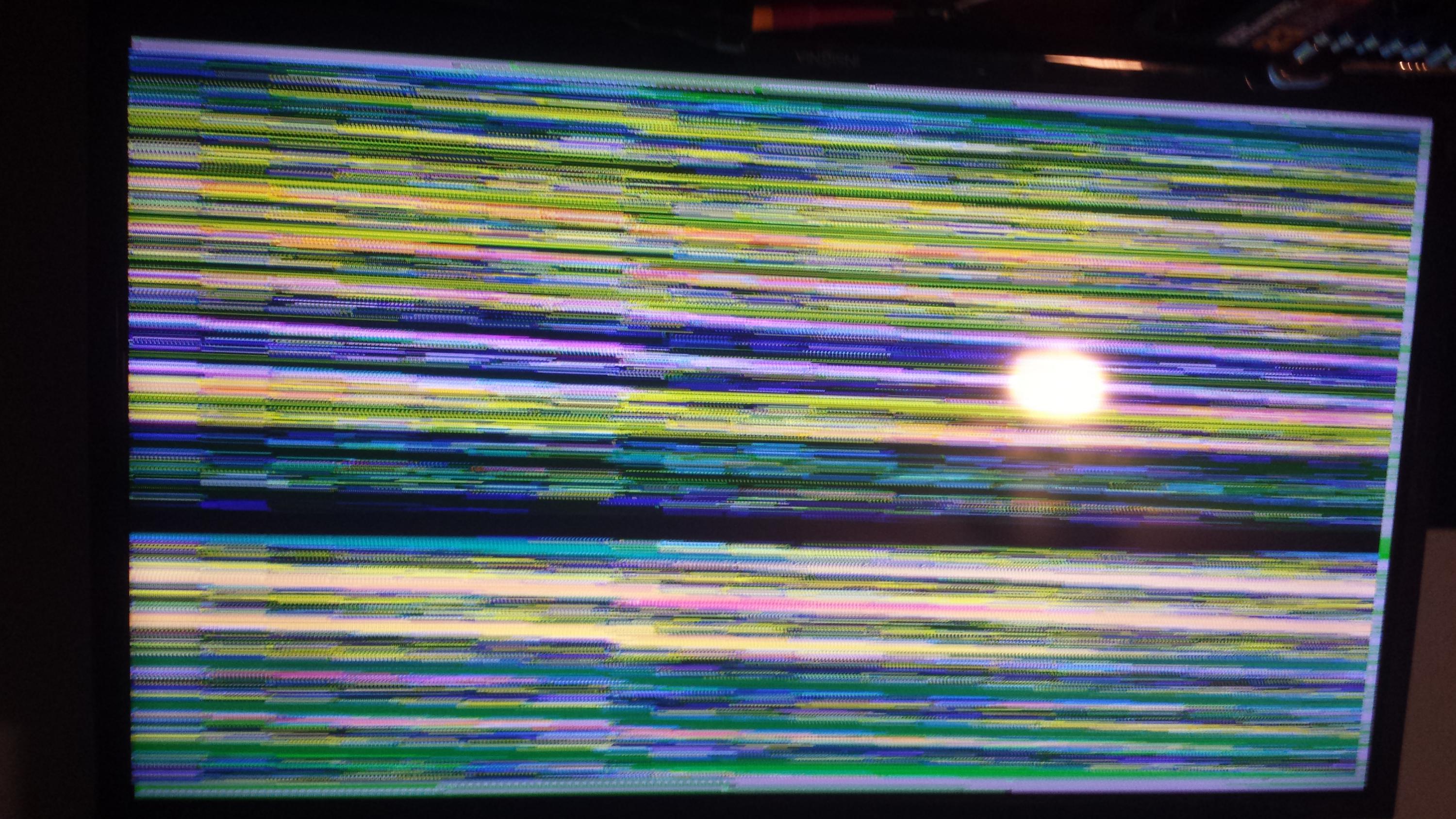

                                I have an update tonight after the tv has worked fine for the past few days it decided to freak out it made a pop noise which I think came from the speakers it turned green and scrambled picture I tried to take a picture of it but it cut off before I could and then it restarted and everything was fine again.

                                  Re: Insignia ns-32d20sna14 wont power on
                                  Sounds like a intermittent voltage reg on the Mainboard.

                                      I was finally able to get a picture of it doing what I described it did this 3 times in a row scrambled picture and restart.
