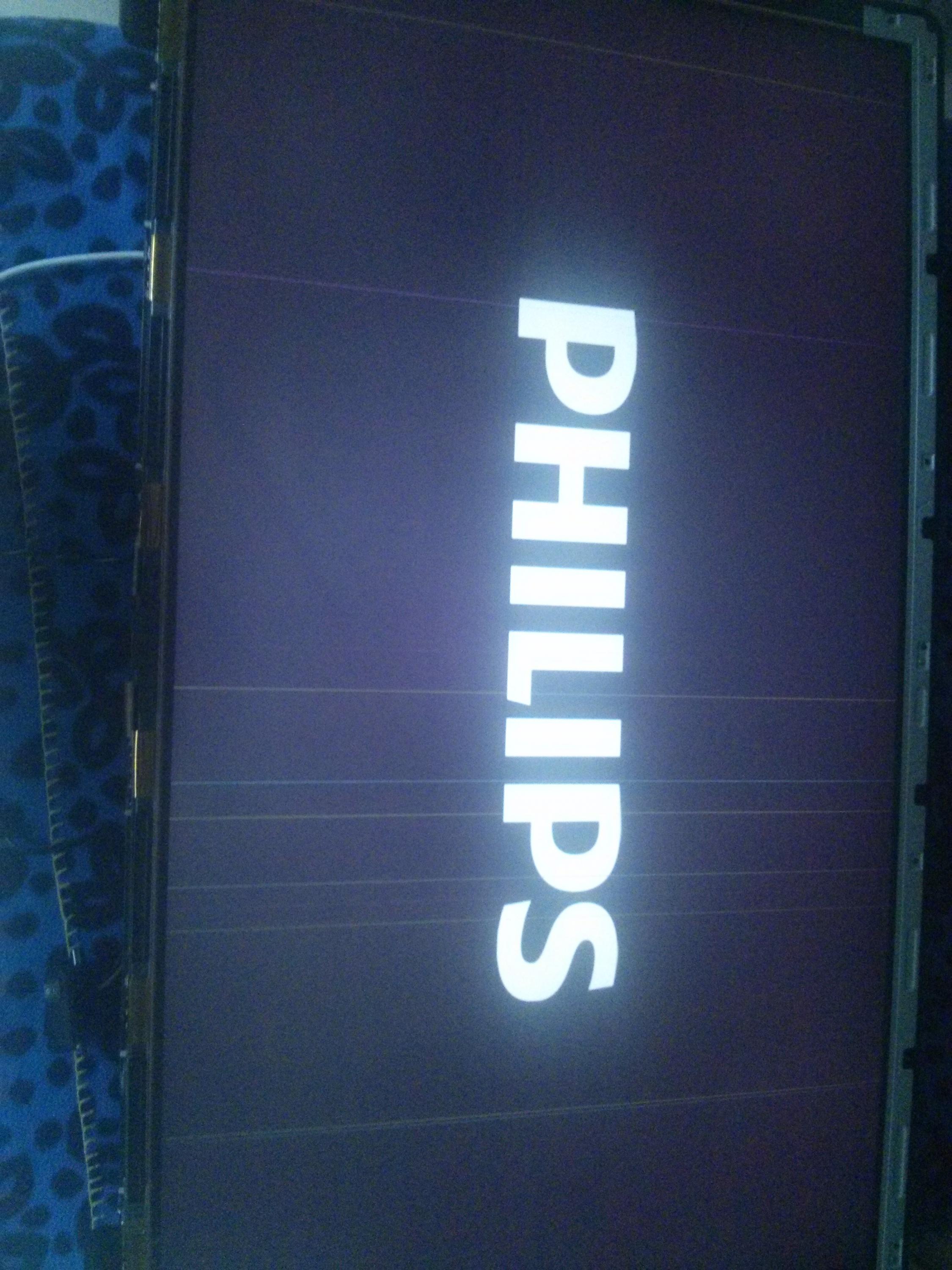

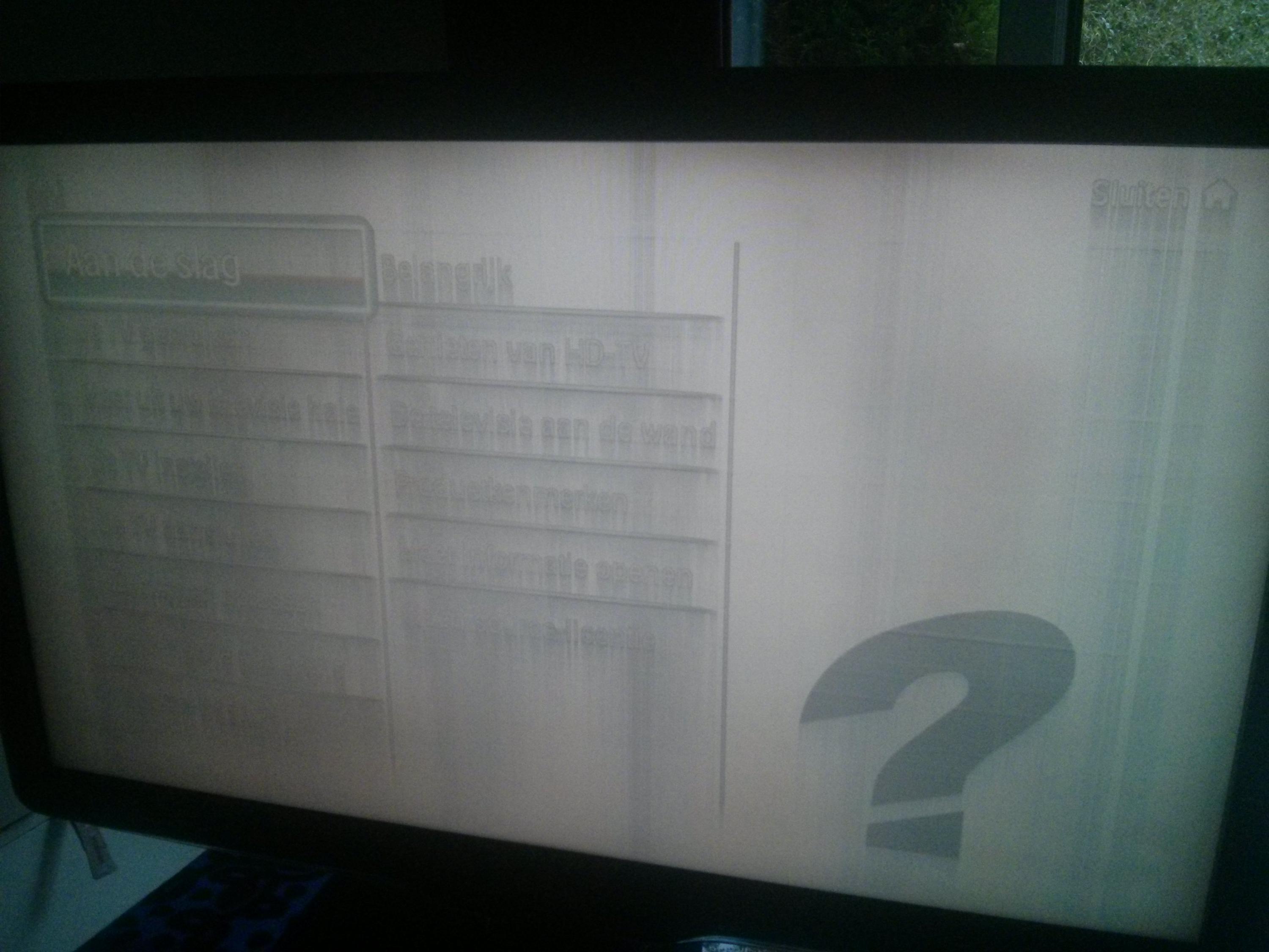

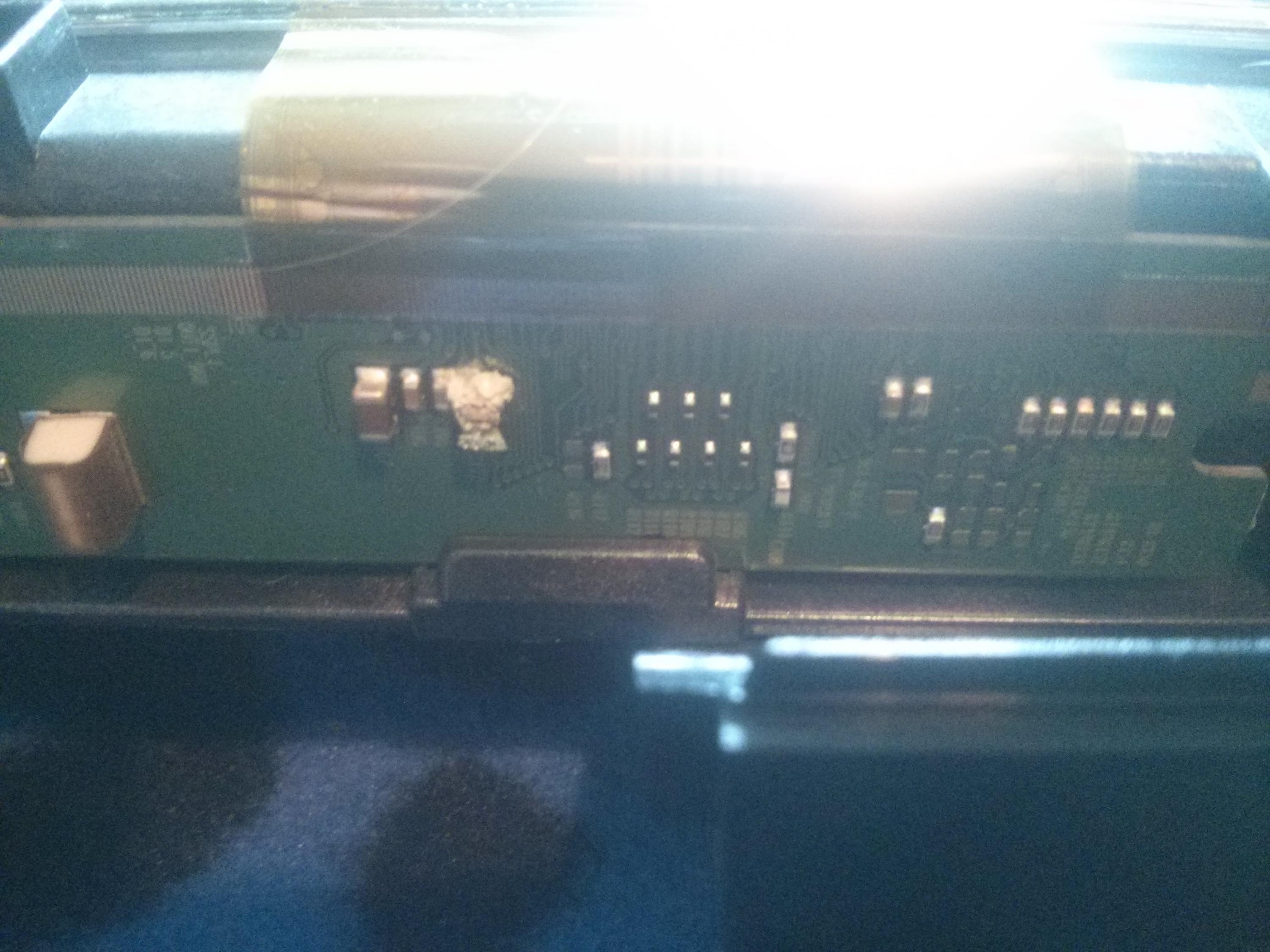

    I have this tv displaying a solarized image.
    The source of the problem wasa distroyed capacitor because of the water. I replace it with another capacitor having the same size only, don' t have a clue about the value.
    After that, i still have some vertical lines în the screen, and when black, i can see the image flickere.

    Re: Philips 42pfl5405 solarized image
    More than likely the Lcd tab bond driver is corroded as well, probably not fixable.
      I don't mind the lines, while it's running you can hardly observe it.
      But the flickering is annoying.
        Do you know how to preform a tab bond repair it could be a lose connection caused by the corroded copper trace ?
          I have pushed on the tab bond but no change on the image.
          I don't know how to repair that. Any suggestions?
            Ok have you tried cleaning the area with Ipa ?
              Yes. but no change in image.
