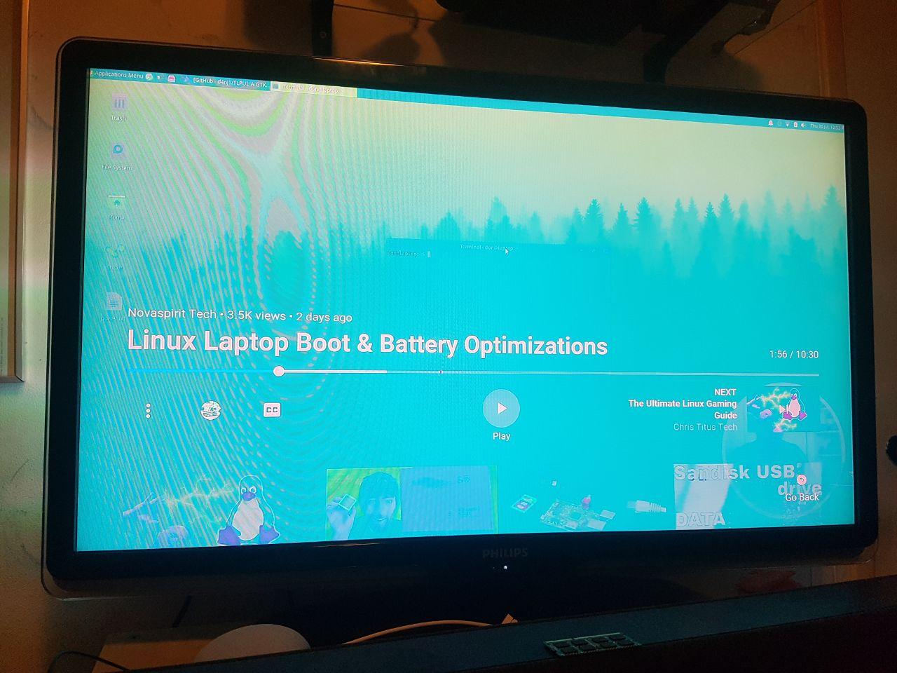

    I got here an philips 37pf8404 with a solarized image. image one
    First guess its a bad as15f. so I replaced it with another. Same issues
    So I replaced it again with a rm5101. Same issues

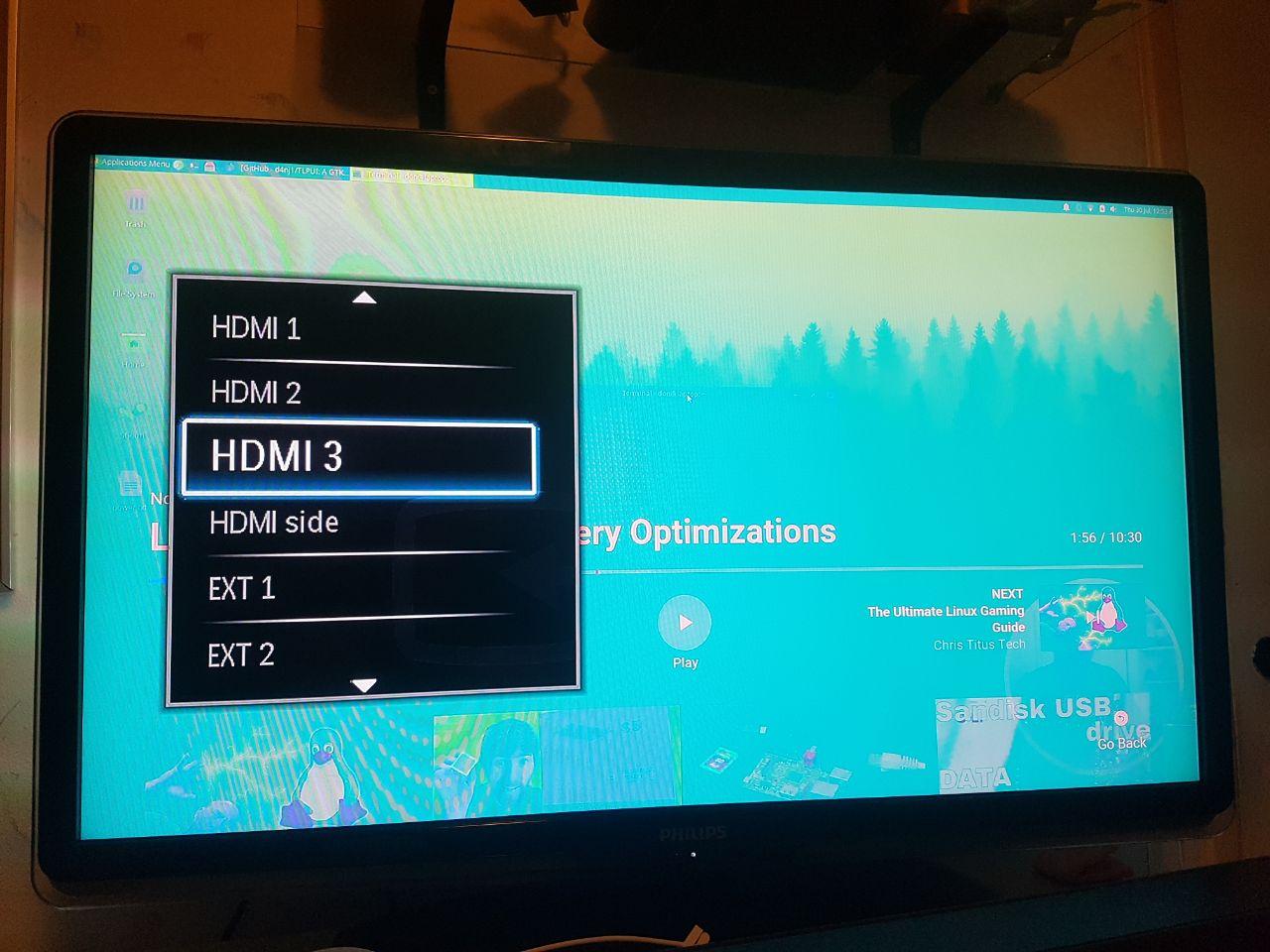

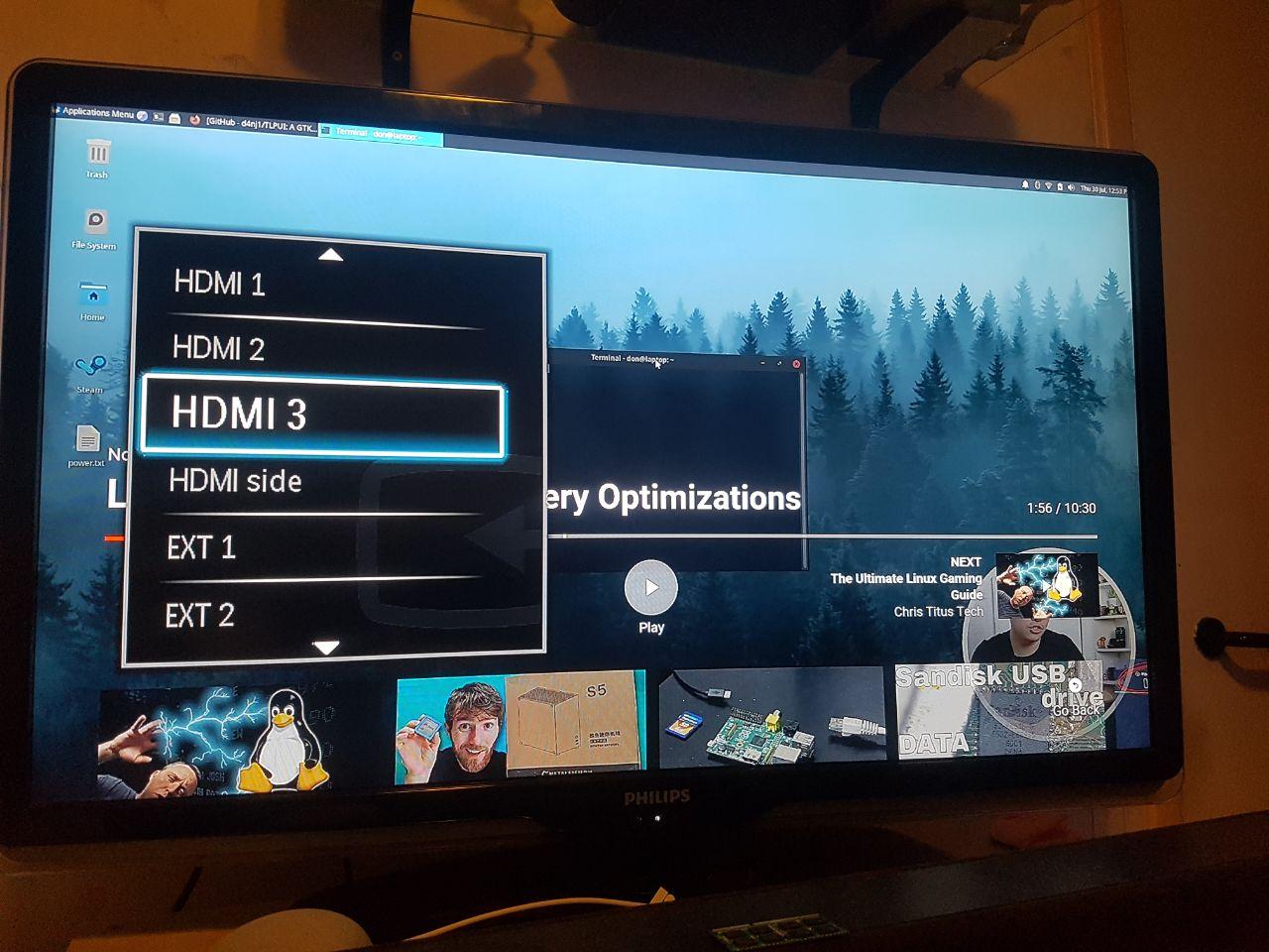

    Problem is that is projecting a solarized image irregularly. When I pull the hdmi cable and put it back all is okay for a undetermined time. It also helps if I change the input from one hdmi port and back.
    One thing thats weird and I don't remember if it was the case with the previous tvs I repaired.
    When the image is solarized it doesn't affect the menu.
    Would it be someting else or would it be another as-15f chip (to solder)

          But does a badly soldered as-15f give a good coloured menu and an bad image
