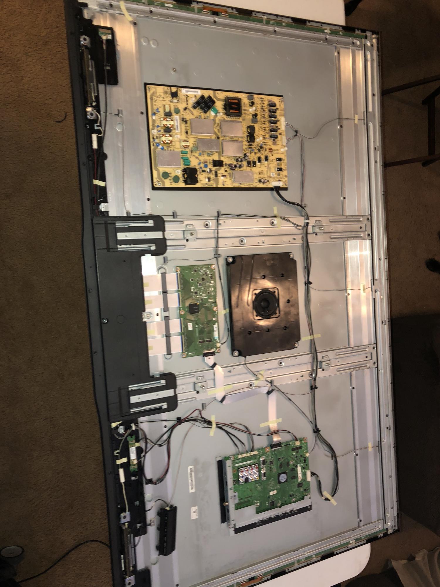

        Which screws on this should I remove? Should I remove the bottom row as well? Any direction you can provide is appreciated.

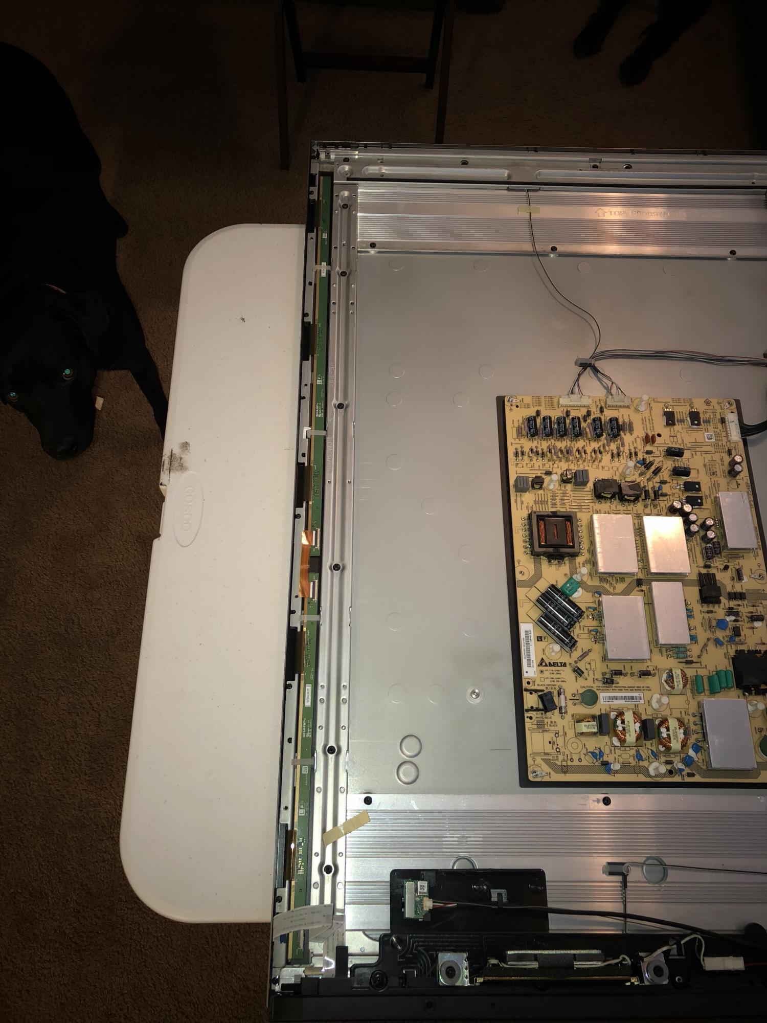

          I am having a hell of a time removing the bezel, I don't see what is holding the dam thing together. I removed all the screws that I can see on the sides, and there is not much play at all. I really don't see what I am missing with this thing.

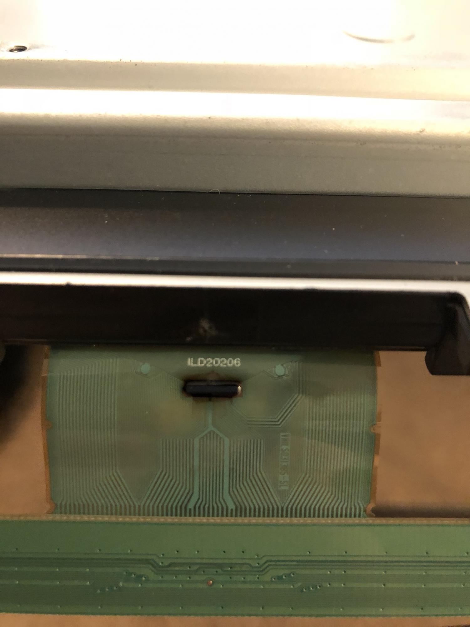

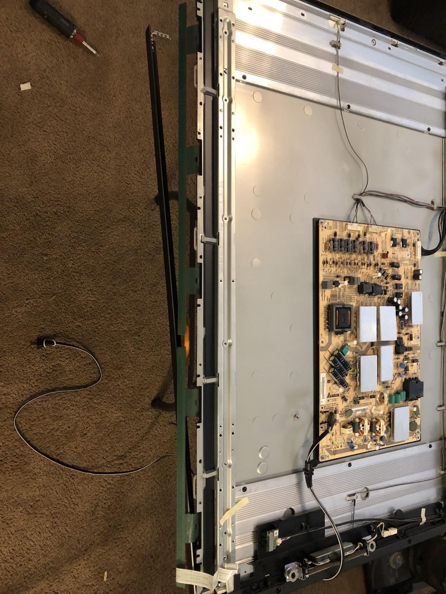

            OKAY! So! I figured out that all I had to do was pull the bezel DOWNWARDS and I was able to get it to separate. I did also check both sides of the tabs. As you can see in the second picture, I was able to find one tab that is hot to the touch and also appears to be singed.
            My question, should I just cut that one tab or remove the whole side? Not sure if there is a particular advantage of cutting one.
            Thanks!

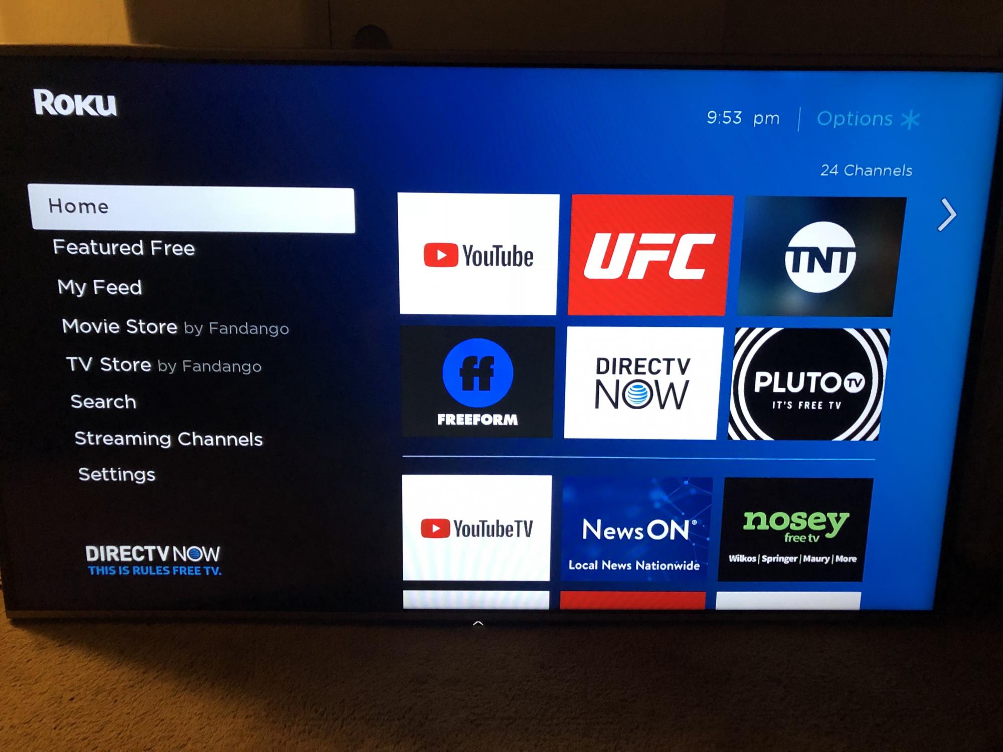

              Alright! SO, I found the issue, removed all tabs on that side and reassembled the bezel and everything. After everything is said and done I got it working!
              woooo hoooo! I'm so shocked that it actually worked. Couldn't be happier, Thanks budwich and lessQQ for all your help!!!!!!!!!
