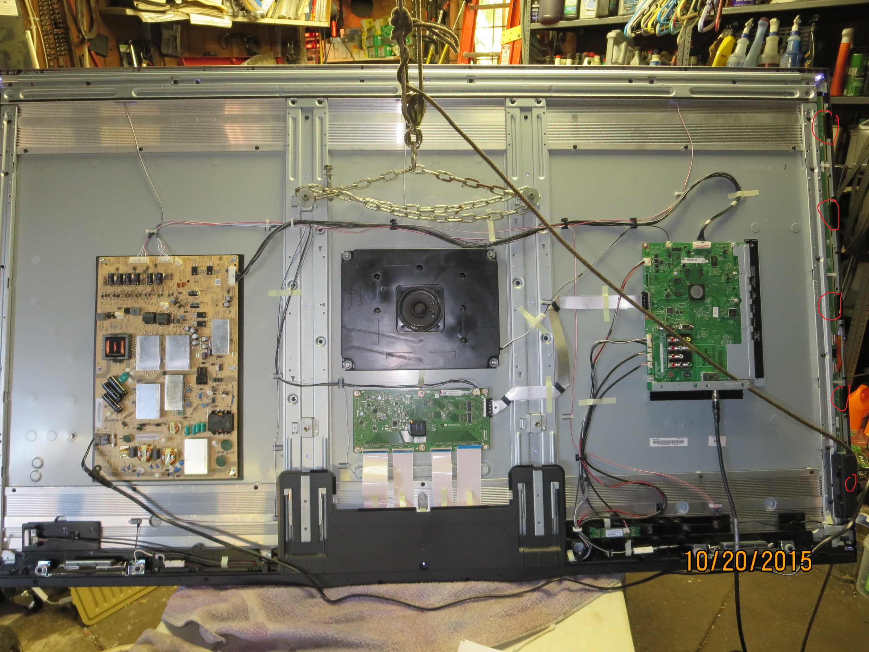

    Turn opc control off. Go to standard mode and crank backlight all the way up. Then play around. You will be surprised at the pic quality you will get. of course probably never is good as a plasma but close second.
    One thing I have found out about sharp panels is that they have a lot of white bleed viewing on the angles. It's just the way the panel is made. Now I have seen the sharp elite versions almost diminish this problem completely. So I think it has a lot to do with quality control.
    On a side note with your TV I realize that you disconnected the left hand driver tabs. Others including myself have removed the right side. So this verifies that the panel will still operate with either side still cconnected

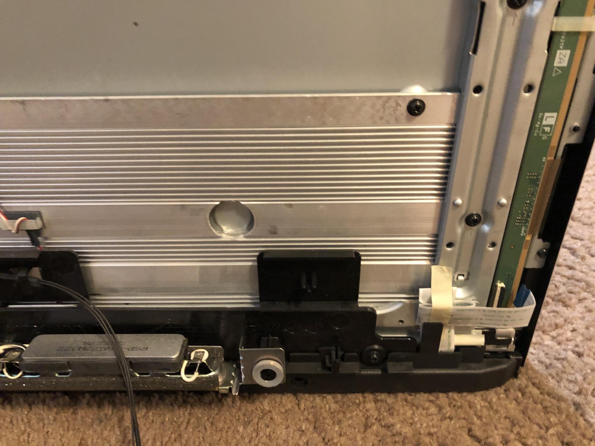

                          Hey All,
                          I just picked up one of these TV's (LC-70LE857U) last night that has the exact same issue ajshoe had. I took off the back and unplugged the right side T-CON ribbon cable and got the TV to power on. I plugged it back in and got a full picture before it started stuttering. I unplugged the ribbon cable to the right side buffer tabs and got the same full dark picture as ajshoe.
                          My question is, are the ribbon cables in the picture I attached the "buffer cables" that people are referring to? If so, can I just cut them with a razor knife from the board they are attached to or do I have to take the TV apart more and remove them directly from the panel?
                          This is my first TV repair and I just want to be absolutely certain before I start removing anything that I won't be able to reattach.

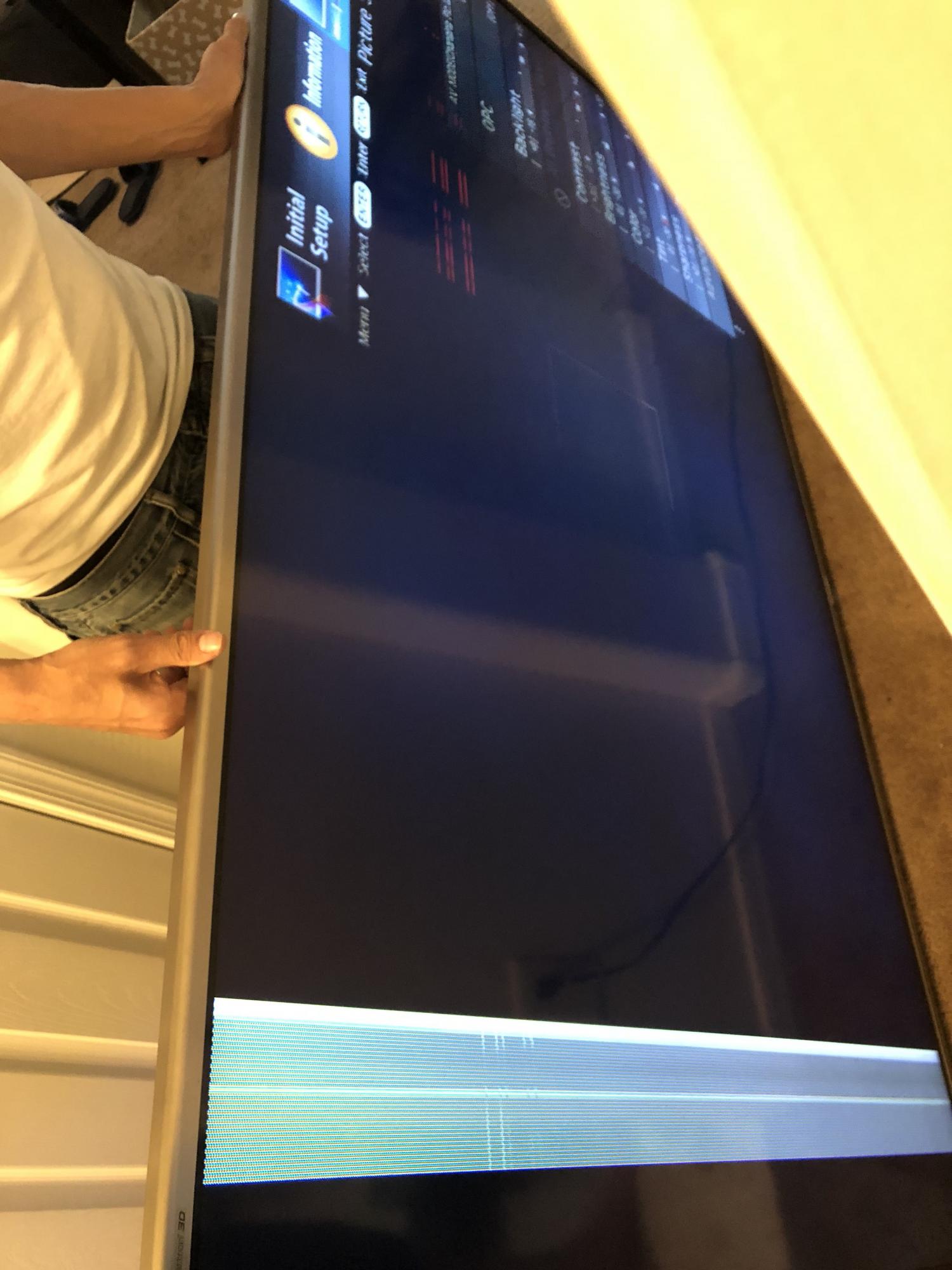

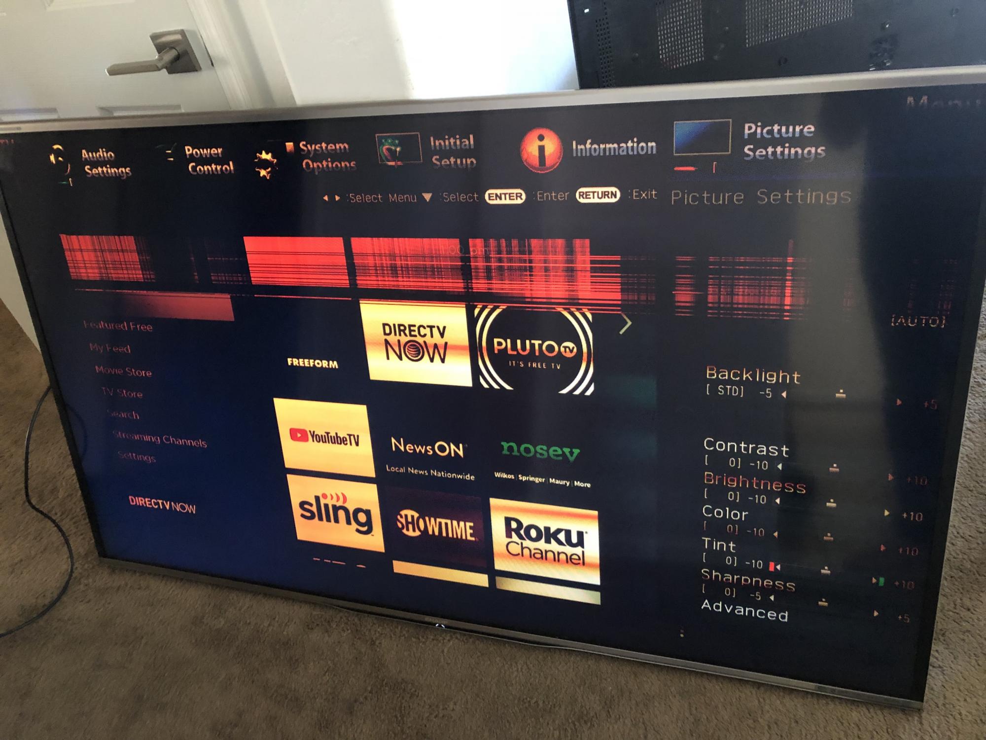

                                Wow I am so glad that you responded so quickly. So here is what I have found out since I have been tinkering. I have been through the process of disconnecting different TCON cables. I get the closest result when I unplug just the left side ribbon cable in the first picture. The whole screen shows but flickers.
                                So should I cut the right side driver tabs?
                                EDIT: ignore the white tab on the left, one of the TCON cables wasn't fully connected so I am getting the flashing line now but a full picture with some weird distortion with a red bar.
                                • Hardpumps2147
                                  • Apr 2019
                                  • 10
                                  #36
                                  Re: SHARP LC-70LE857U 2 - 5 blinks
                                  Just a correction, from looking at the back of the TV the RIGHT side ribbon cable is unplugged, which would be the LEFT if your are looking at the front of the TV.
                                  As you can see in the third picture, I have a red bar on the LEFT side (from the front). So should I cut the RIGHT ribbon cable (from the back)?
                                  Also, what screws do I have to take off to get the bezel off? All of them on the top and side? Will cutting the RIGHT side (from the back) resolve the flickering and red bar?
                                  Any help is much appreciated! Thanks!

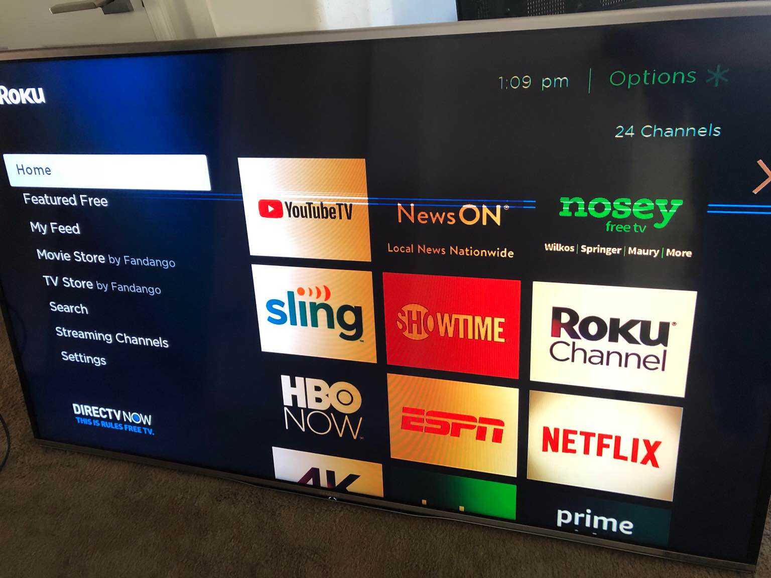

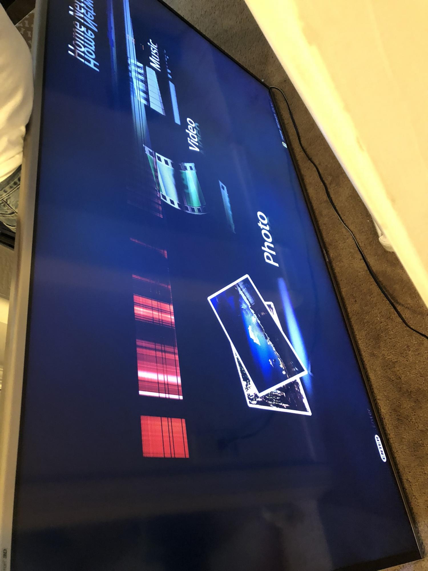

                                      Okay I went back through and re seated all of the tcon cables. Currently I am getting this picture with the RIGHT ribbon(from the back) disconnected. I am getting somewhat of a full picture but you can see there is flickering and a red line at the top of the screen.
                                      This is with the LEFT ribbon (from the back) disconnected. You can see there is a much better picture, but there is still a line across the top and the right side is darker than the left.

                                        ok.... interesting. :-) on the first picture, the display is worse because the "good side" was disconnected leaving the set to run on the "less than good side". In the second picture, the display is better because the "bad side" has been mostly disconnected while the set is running using the "better side". Although when these "tests" are done, normally, the set will not provide any picture on way and the other will be "good" with some darkness.... so it is a bit different.
                                        It would be wise to take off the front bezel to get access to the side edge boards / tabs. Then, you can look at the tabs and gently touch them especially near the area of the horizontal linings. You might see / feel a tab getting warmer that others. This is might confirm the issue better.... but it looking like the side disconnected in the second picture is the "bad side". Since you need to access the tabs anyway to go further with the "save", I would still do as suggested to get confirmation before going too far as the removal process is NOT reversible.
                                        One more question... this thread /post is about a 2-5 error code which you don't appear to mention... are you seeing this code?
