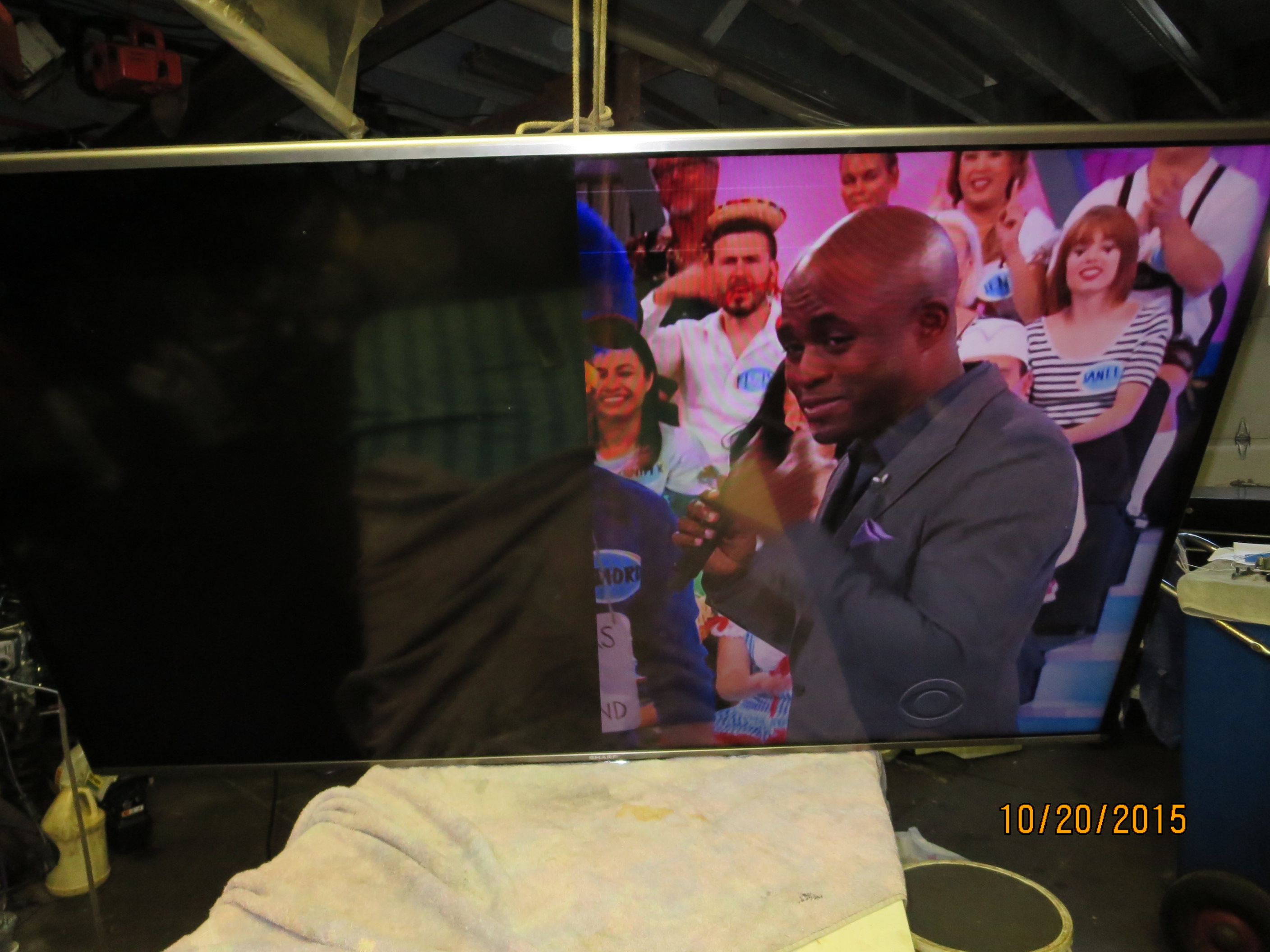

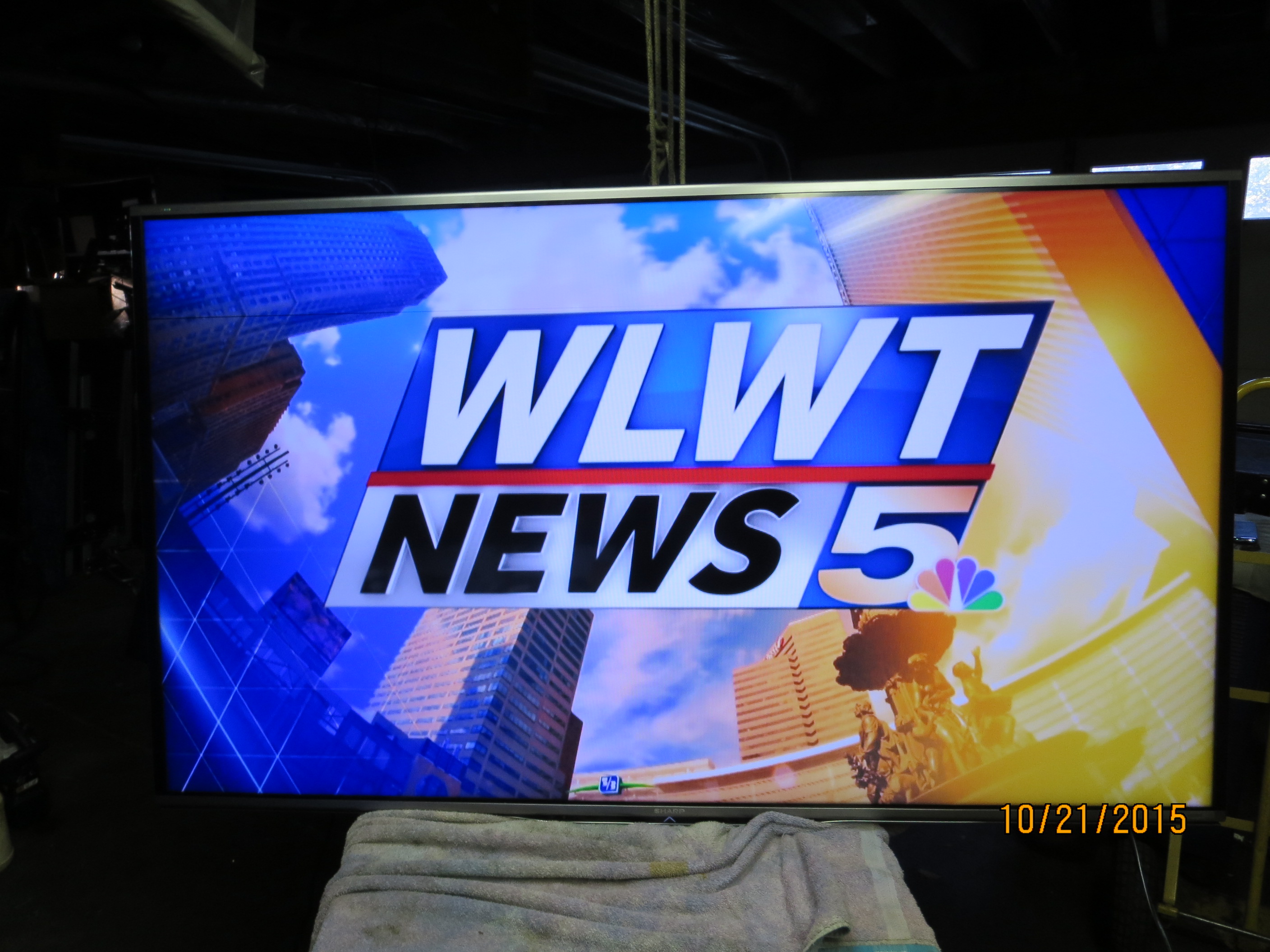

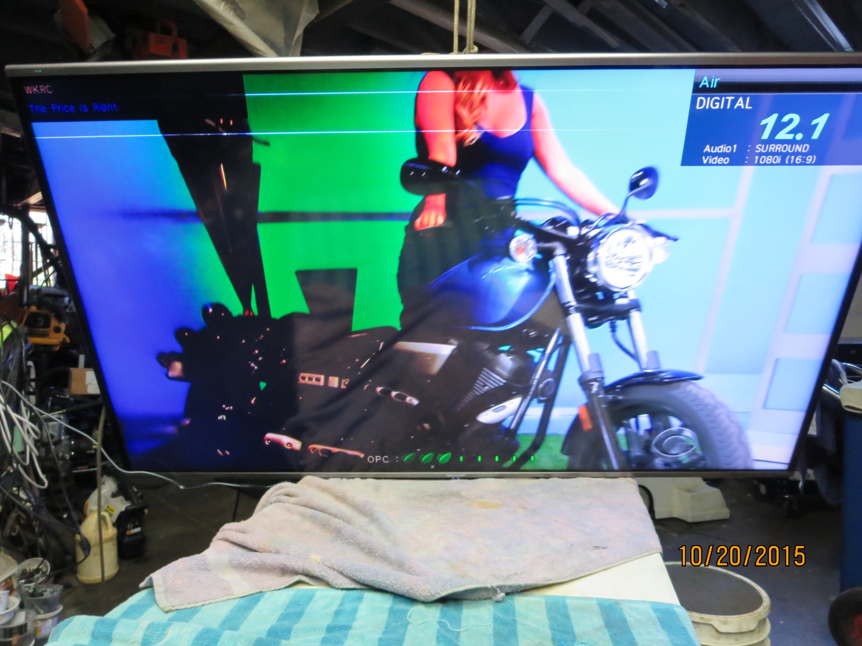

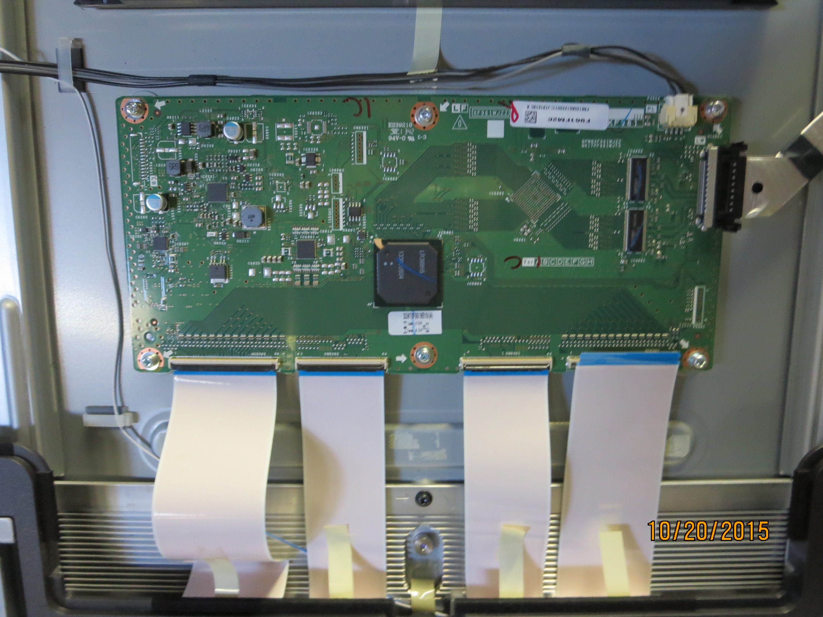

    Have a SHARP LC-70LE857U found on craigslist (free) - given the 2 long blinks - 5 fast blinks code. Spent some time reading all the blogs about this - dis-connecting T-CON cables (4) got the set running. With 3 T-CON ribbon cables in (pic 3) right side (from back of set) ribbon cable is out. right side of screen display is good (pic 1). reconnected 4 T-CON cables and disconnect right side ribbon cable (from back) going to side buffer tabs - have screen display but darker on left side (pic 4).
    I assuming I need to "cut" right side (from back of set) buffer ribbon cables off ??

    Yep.... good find. My neighbor's set that we did the "operation" on has been stellar for over a month of regular use with the "bad drivers" removed on the other side.

      Yep. This is what you need to do. Sounds like you are on the right path.

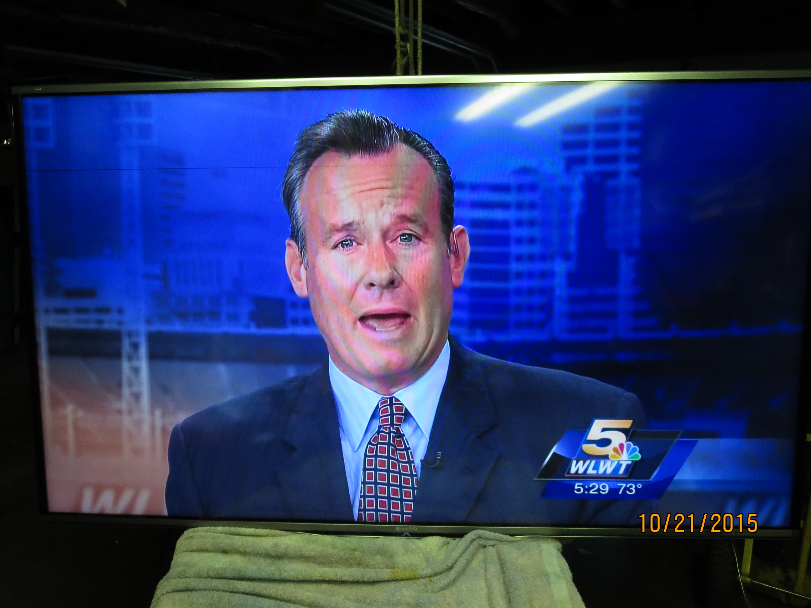

        "operation" complete. any idea what 2 horizontal lines on left top of screen ??? Lines are wider on left and disappear by the time they get to right side. they were there before I started the "operation" set has been on for an hour - no problems.

          my guess is you "cut" the tab flex cables instead of pulling them away from the panel... maybe. Take a close look at the tabs in the top portion on that side. Hopefully the actual "tab pad area" is clean.

              If u look at the first post pic #4 - you'll see that those lines where there before I cut and lifted the tabs.

                  I did cut and then lifted the tabs (5 of them) off gently. left no "pieces" that I could see.
                  look at first post - pic #4 = lines were there before "operation"
                  Have a feeling these lines were present before set went into 2-5 blinking

                    Yes there may be a chance that the tab on the other side controlling this line is damaged unfortunately. Thing is thou you need those. See how long it lasts.
                    Actually I retort my previous statement since the right side is working and the line disappears by the time it gets to the right side still tells me that there's something going on there on the left. My thoughts would be you could try to take a pencil eraser and gently clean the area as there may be some residue or a temporary short on the spot where the tab driver was once connected in that area resulting in the original problem. Of course do this with the set turned off

                      I'll examine that tab tomorrow. let u know. You're probable right that this was the original start of the fault on this set. I noticed these lines when I was first started playing with the T-CON ribbon cables to get the set to turn on partially. .
                        Re: SHARP LC-70LE857U 2 - 5 blinks
                        Yes this seems to be the fault in Sharp lcd panels when a side driver fails. You will see the spot that is causing the issue when you get the cabling right to power up.

                            I think that those lines are still likely associated with one of the tabs that was removed. I had similar lines on the set that I worked on. Once the tabs were removed, they did go away. Perhaps lucky as Freakaftr8 seems to think that perhaps the driver on the other side was "weaken" by the failure that you have removed. Hope it is not true (ie. about the opposite side)... look closely at the remove tab "pad area" and also if you can, perhaps try placing some light pressure on the opposite side remaining tabs (likely the top one or two)... maybe with the end of a pencil / eraser end to see if you can cause a "good change".

                              played with it some more - the removed buffer tab end - got one line fixed. Tried everything but that last faint line won't go away. Line is about 40 pixels down from top left of screen- hard to see in pic. It only goes about to middle of screen. I'll try applying some pressure to other side buffer tab. Pic is very nice but still not a good as my plasmas. My opinion !

                                      lifted bezel enough in corner to examine buffer tab area. there was a small piece of ribbon cable still left. cleaned it and bigger line disappeared. Just tried other side buffer tab - massaging it - pressed it all along connection - no help. Line is very faint - had tv pic on - froze it so I could see line constantly (tv feature) but couldn't get it to disappear. Going to live with it.
                                      thinking back - both lines diminished from left to right. problem is probably still on lifted tab side. I just don't see the short or damage and I looked for 30 minutes on it.
